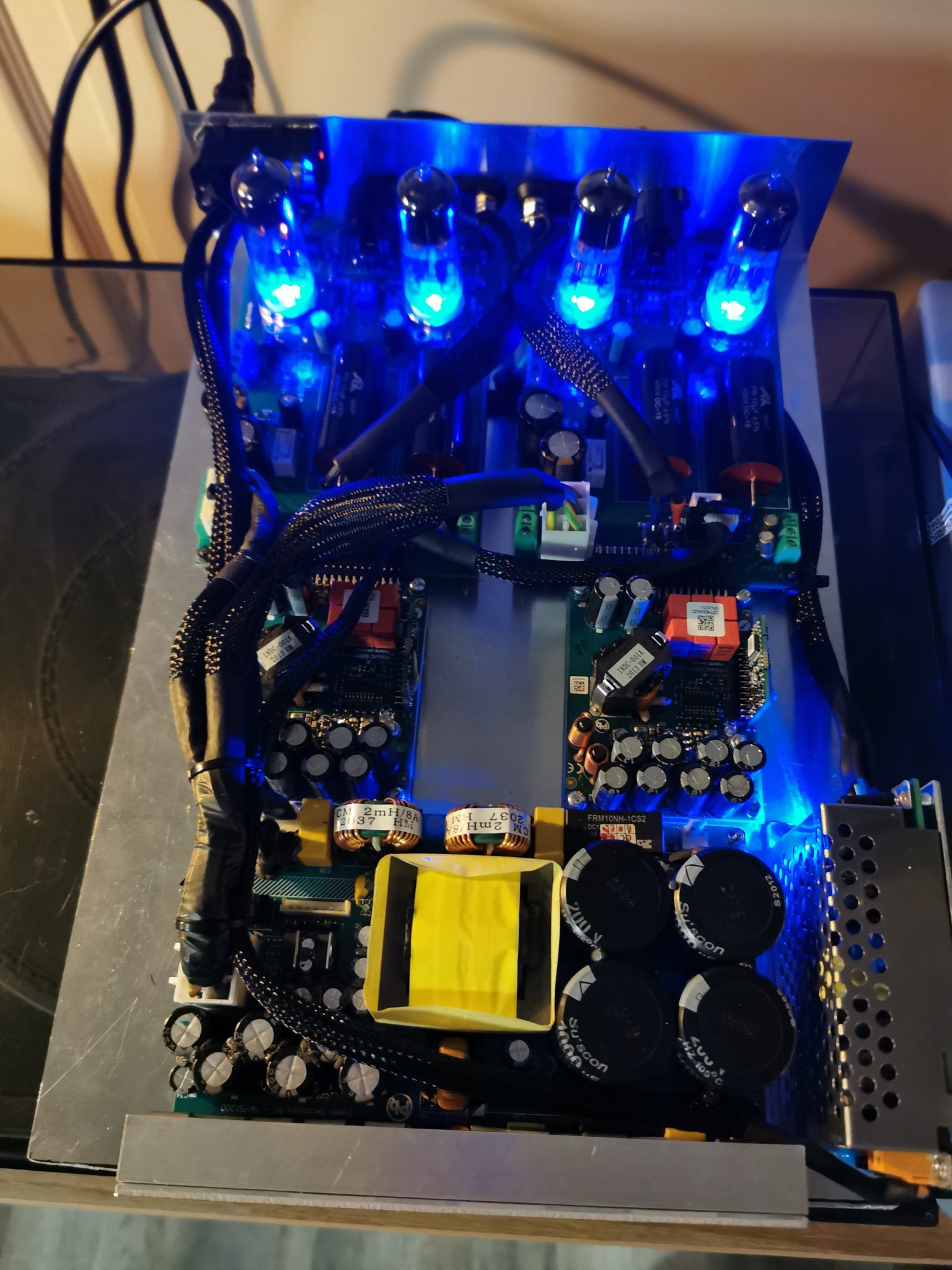

The smps is for tube preamps. For the classd part i have a very good hypex smps1200a400.

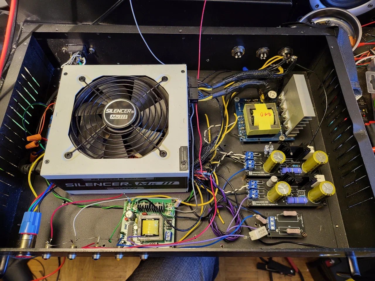

I do the same but 12V/50A ATX and I've used it to power a KT88 PP stereo amp.
I wouldn't even mind designing an SMPS for a tube amp that made 12V from the line for heaters and the DC was boosted from 12V but all on one board 🙂

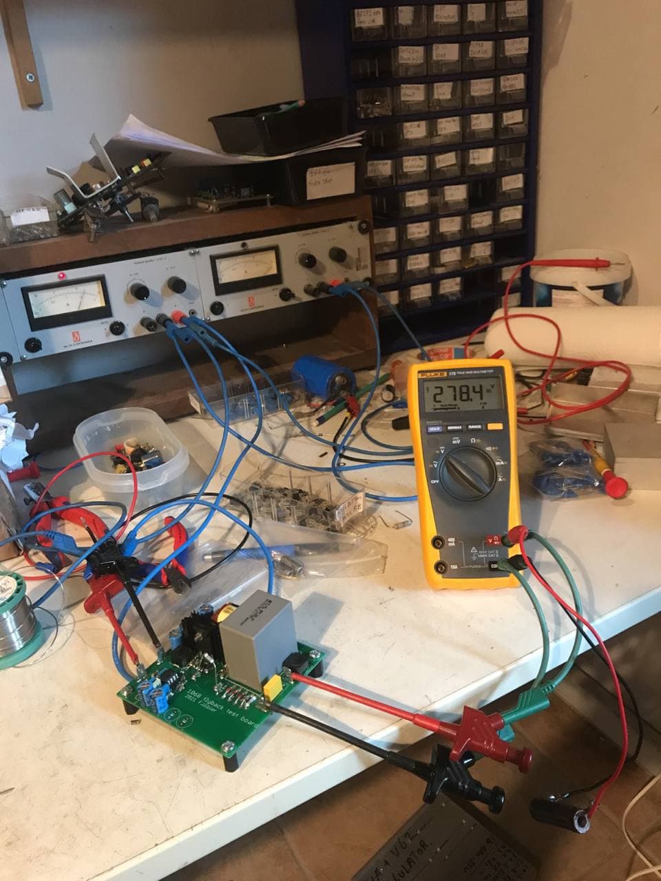

I made a 12V=>450V board some time back.

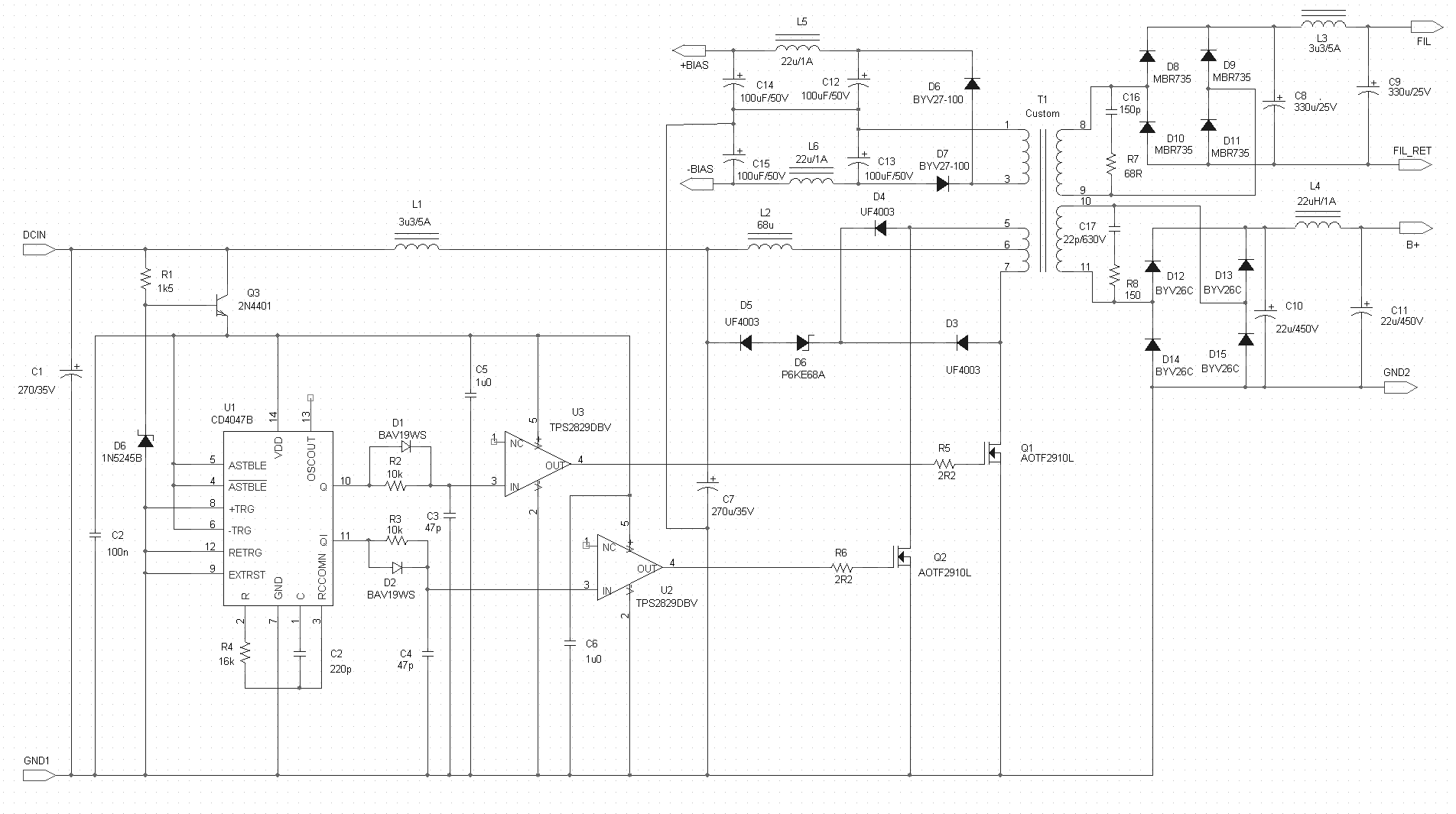

This is the general form of the DC-DC converter I've been using to power various vacuum tube projects. I have various boards including the outputs necessary. For example, for a headphone amp project, the board will be a small one, with only the HV output, set for +150V, with the filaments of the project running from the switching adapter used to to power the project in question.. The higher power converter I'm using to power my 6L6GC/6AH6 single-ended amp uses the filament output at 12V and the HV output, set to 400 VDC, with a larger transformer to handle the power in question.
The DC-DC runs near 100% duty cycle, with a small amount of drive overlap programmed in so that the current-fed push-pull works properly. The regulation comes from the regulated SMPS used to drive the converter - this works well in practice, and the regulation is superior to that obtained from a conventional 60Hz transformer-based design.
T1 is unregulated...and its output depends entirely on the load. a resonant converter takes 2...4 trz , a coil and a capacitor plus same T1 and it's output is a sinus while having similarly regulated output only by the load.Your noise depends on the 12v source noise...
It's not a resonant converter at all, it's a current-fed push-pull The design is unregulated. It gets its regulation from the switching adapter that feeds it.I wind my own transformers. I've been designing switching power supplies of various sorts for over 40 years.
