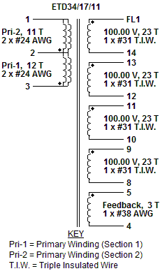

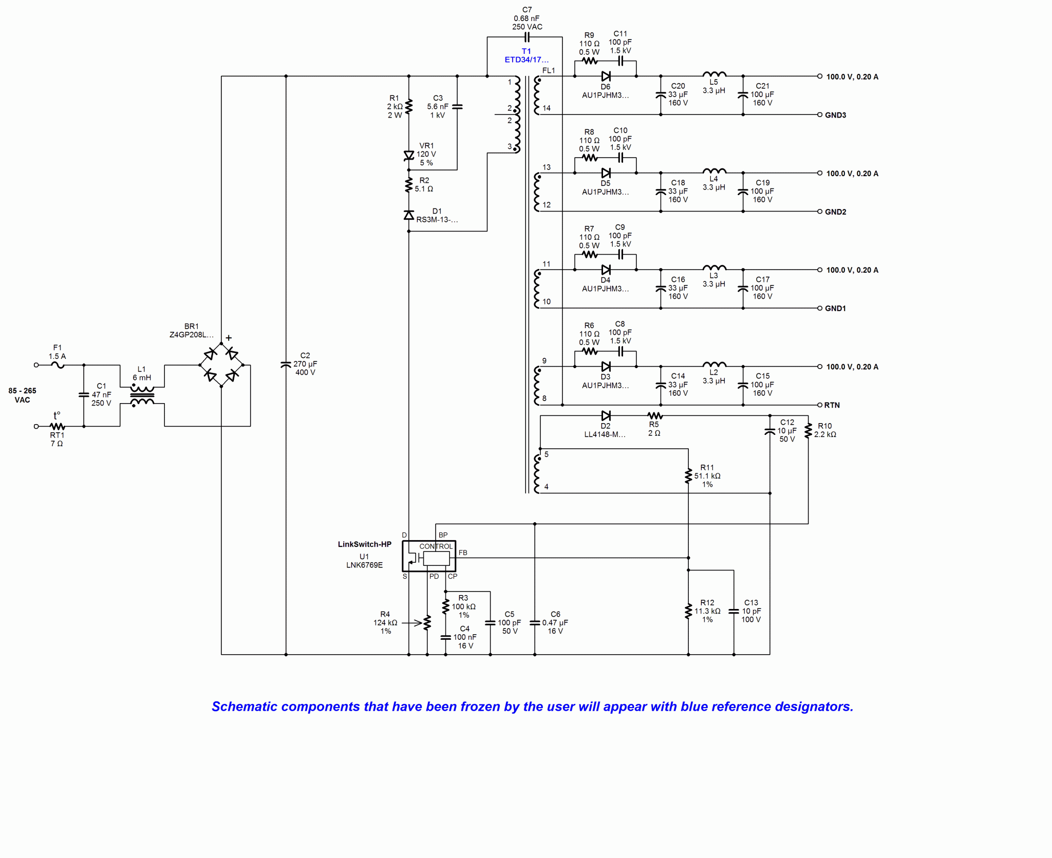

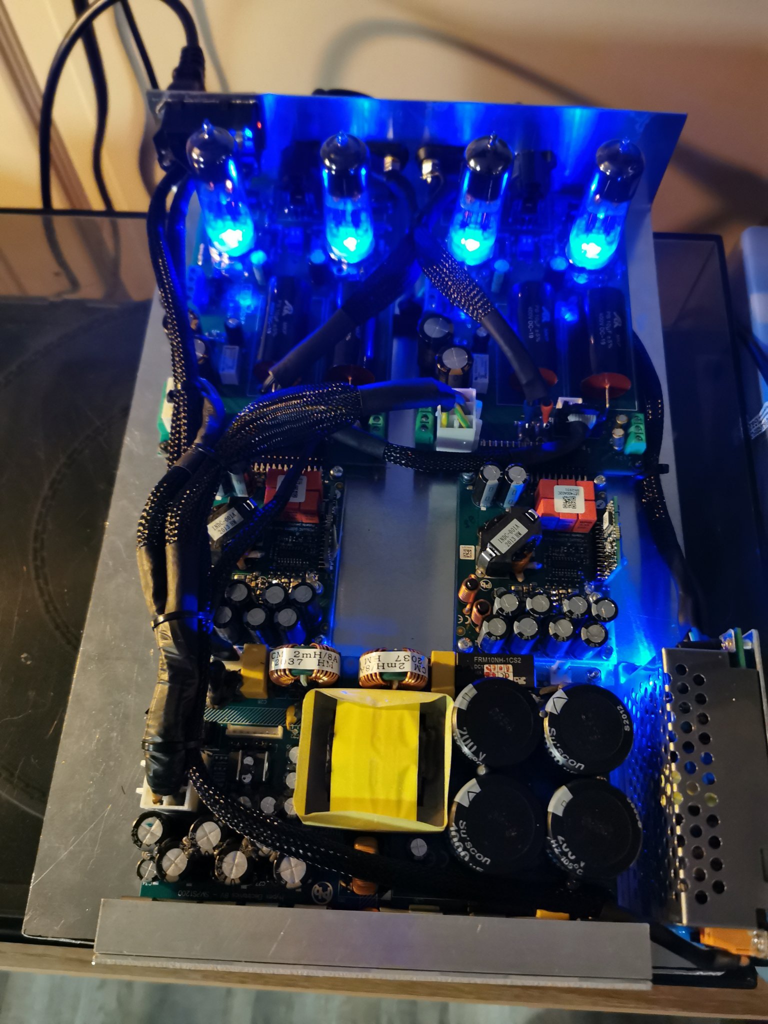

Today i looked at the side of Power Intergrations.
They have an online smps design app called PI expert.
I tried to design HV smps but the limit was 100V.
But connecting 4 windings of 100V get you 400V.
I would connect them with a switch to choose 100,200,300 or 400V output and only one output filter.
Maybe behind the smps a Kubota HV regulator.
Schematic below looks promising to use.
I only have to find true hole parts.
Making the transformer also looks easy.

The absence of 50/100hz resp 60/100hz products. No 50/60hz transfer true housing to microphonic tubes.
With all do respect, ignorance is the bliss.
SMPS of any kind is a rather low loop gain class D amplifier powered with high ripples DC source. You will get 50(60)/100(120) and a multiples of thereof as well as intermodulation products on conversion frequency. Most ferrites for power electronicsc do have substantial magnetostriction thus you getting mains' modulated vibrations @ conversion frequency and multiples of thereof. Glass envelopes, having high stiffness so to speak will transfer this to the electrode system -> electrons do not have inertia in that case. Thirdly, if not resonant, the converter of yours will provide you with a lot of conducted and induced EMI. To beat those will be the art of its own.
While it's feasible - high sensitivity scopes are the best example - it's not the sensible way to go.
Often than not people report harsh sounding of amps due to intermodulation that comes from unusual sources like detection of EMI, self - oscillation or HF ripples from PSU.
If all of the above would not stop you from proceeding, I would go to ONSEMI/TI and check what they have on LLC.

Your supplies aren't regulated and the danger and are only referenced by a single voltage feedback. It's possible to overload a non-regulated supply and the SMPS will not be aware of it. Not sure of the secondary winding isolation if you connect them all in series. I'm assuming it's rated at continuous 400+Vdc.
You'll start finding currents for 24Vdc to 400Vdc boosting become very large for the inductors. So it's probably better to run a mains PFC SMPS -> DC link voltage (say 380Vdc) then run separate DC-DC converters off the DC link. You still have the issue of overload but the separate boost/bucks can take that into account. The PFC then monitors the link voltage.

Are there some remarks about the schematic i posted before?

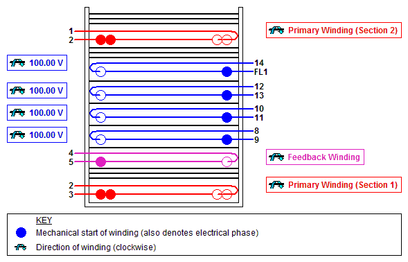

Let's start with the x-former. There's such a thing as Dowell, you need to partition windings horizontal (per picture).
I would add shields if you do know what to do with them

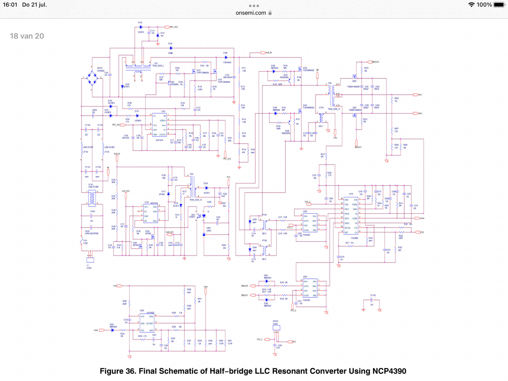

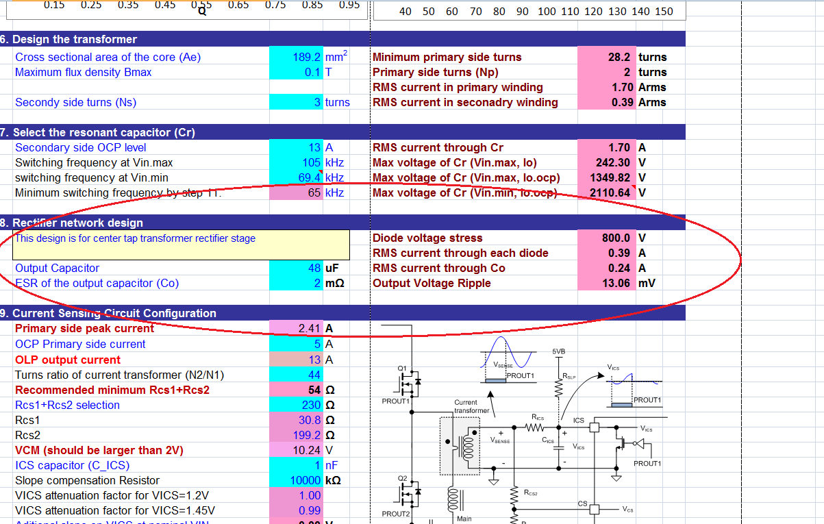

LLC topology looks nice, but a lot op 400V schematics have 5 to 10V ripple. 😇
I've spent 3 minutes on onsemi site. attached is the results in terms of ripples.
People here are genuinly trying to help which some won't accept.
Design done for 400V 0.5A. 13mv 50W yeilds 8mV at 20uf film cap as output filter.
It's highly unfortunate that you need to be given a fish instead of a rod, but here it is:
https://www.onsemi.com/design/resources/technical-documentation?rpn=FAN7688
LLC-Resonant-Half-Bridge-Converter-Design-Tool-for-FAN7688 xlsx
https://www.onsemi.com/pub/Collateral/AND90061-D.PDF

But there is quiet impressive schematic.

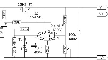

As you seen i started with a unregulated SMPS witch also have overload protection according to the manual. And after that i like to use a linear regulator to get ripple below 1mV. Maybe 100uV is possible.
Schematic of linear regulator.
This looks a lot easier to achieve.
@NickKUK The way with the DC/DC converters is not my thing. It looks like the kodabmx build. I like to have one nice PCB( max 100 x 100mm)..

Alexberg, i like to reply on this one. I measure when using the SMPS with the classD amp between 20hz and 20khz no interference products higher then -100db or even lower. About HF i shall make some measuements after my vacation. I have done already a lot of linear vs SMPS comparisons. And i could not hear the difference between linear or SMPS.

The point's it's easier said than done as well as not seeing smps shortcomings
(specifically if you were mere comparing products on the market, not self made ones).
Are the topic still tube preamp or class D power stage?
SMPS itself is the class D power stage and not the one you are used to:
in self-oscillatory ones loop gain is rather "high" to say the least
which is not the case for PSU where only DC performance may be on par.
alexberg
2009-10-01 2:25 pm
Schematics shown has two auxiliaries and sync rectification which are unreasonable unless you're after the power density per say, especially @ 400V Uout. Using secondary type controller may require some start-up aux ps but you can always salvage wall-wart from older phones to make things easier.
P.S. I would recommend to look for Nicola Rosano on LLC in particular.

View attachment 1073726 View attachment 1073727
Thinking about this further - you could simply stick with 100V on each winding, connect in parallel and then use a voltage multiplier diode network to get to 400V. The load would be spread evenly and you get smoothing built in from the voltage multiplier network.
I still don't like that it's only using a feedback coil and not voltage based feedback on the load..
