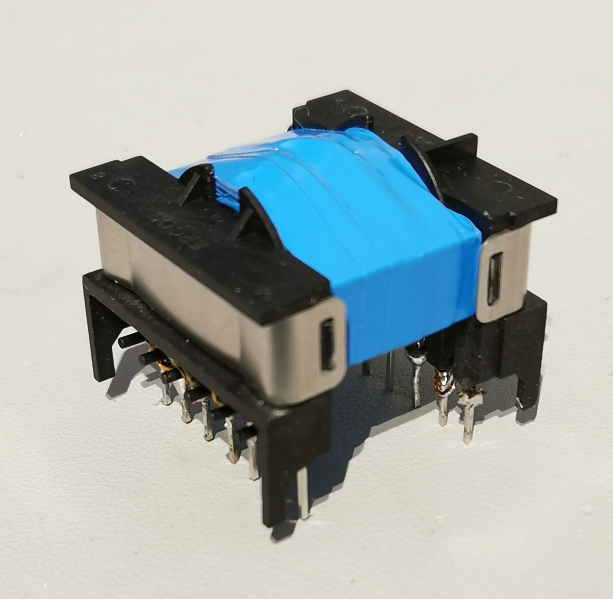

Because every new build has other requirements it becomes more difficult and more cost(custom made transformers) to get the right transformers.
So i like to learn to build my own SMPS.

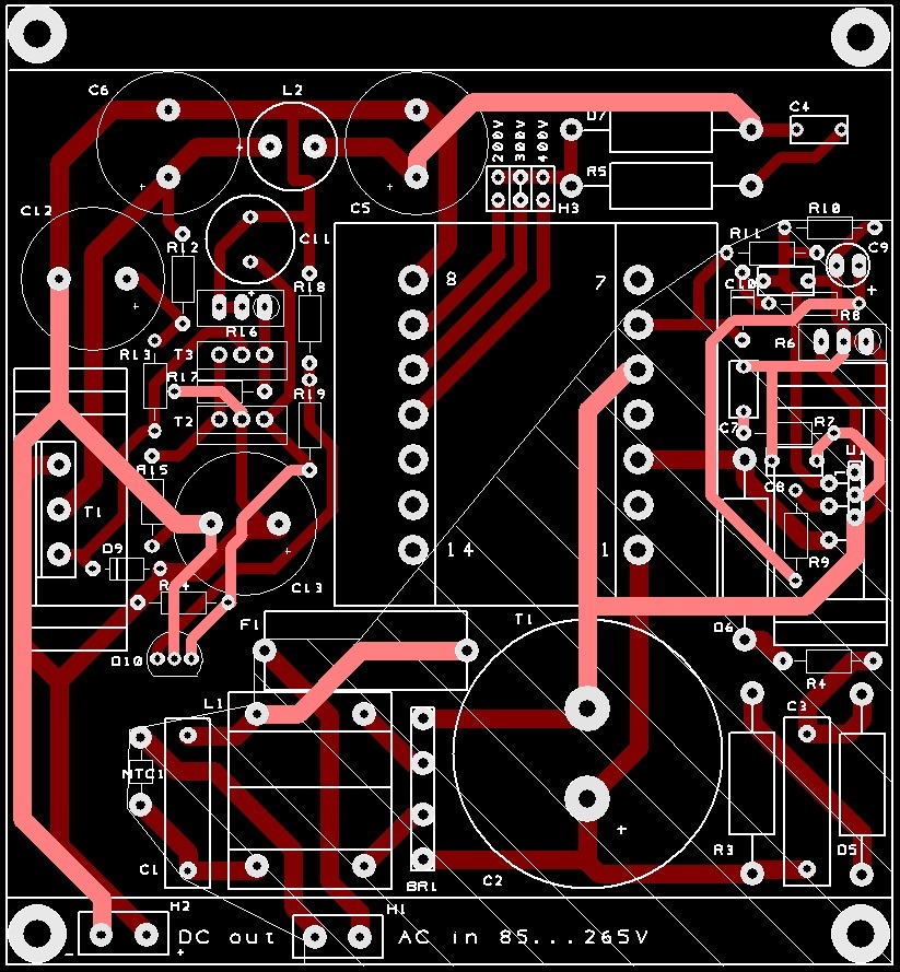

Just made the PCB design. I have taken in account that it i possible to use a perforated metal cage and still access the board connectors.

Im so looking forward for thisJust made the PCB design. I have taken in account that it i possible to use a perforated metal cage and still access the board connectors.
Also, with any board design with switching signals, a good solid ground plane is basically mandatory (because of EMI), as well as adequate slits to keep proper mains isolation.This SMPS switches on 132Khz. About parallelling smalls caps for low esr is a good suggestion.

I don't know about the current dimensions, but 4 layer boards are very cheap these days for everything that is below 100x100 mm

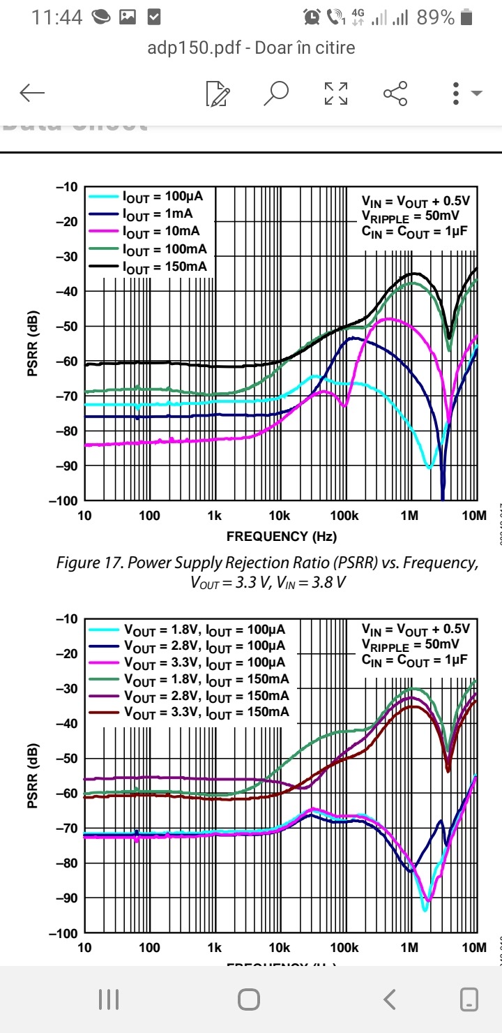

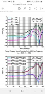

The adp 150regs were used in a project i was involved to filter 400khz switching noise to reach a very complex 32 bits adc-dac and xmos board into electrostatic headphones amp and the only noise we heard was damn 100hz hum bleeding through both 230c ac:24v dc smps followed by a 400khz smps getting us the 3.3, +-15 and +500v lines we needed from 24 v .
Do you see those ADP regs very capable of reducing 400khz (precisely 470khz ) ripple?

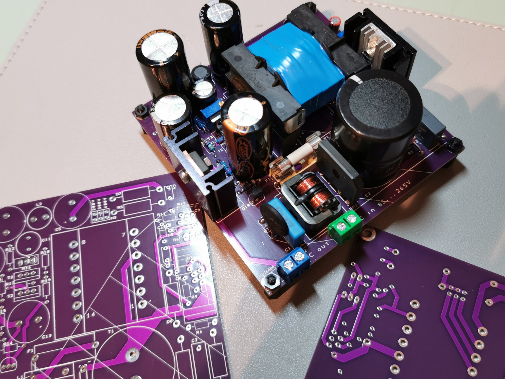

Got today the pcb's.
And assemble one.
Tommorrow i will try it out.
