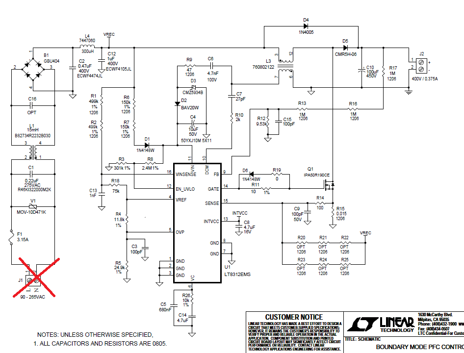

To keep it simple, I would go for some kind of PFC stage, that keeps the voltage relatively steady for the following stage.
If you want to keep it straightforward, you could have a look at the IR(S)2153
Above 70W, PFC is required.
The IR(S)2153 will work without PFC, but regulation is rather poor.

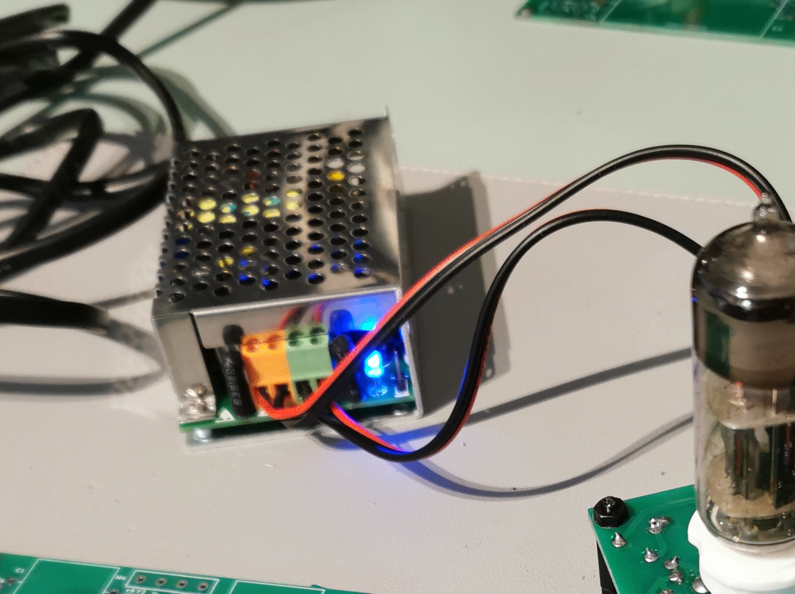

I have just bought this. There is a nice delay (20 secs?) and then the HV comes up slowly. This latter is very good.Ad the moment i use this one.
https://www.aliexpress.com/item/100...daa,tpp_buckets:668#2846#8115#2000&pdp_ext_f={"sku_id":"12000015963231639","sceneId":"30050"}&pdp_npi=2@dis!EUR!!45.69!!!!!@211b5db316551372258983283ee191!12000015963231639!rec
But heater and anode supply share ground. It is not possible to lift heatersupply.
There is a 30mV rimple at 62Khz. I like to compare if there is a change in sound when rimple is below 1mV.
I already tried LR8N with fet to bring down rimple, but rimple just got 15mV down(-3db).
Further i have not found a good smps diy design with great specs for hifi gear.
less good is the shared ground. That is, they are interconnected.
there are other boards that have a floating filament power. Much better.
I will feed through a standard tube power supply choke to get all residue away.
and many Riaa or pre boards etc have a HV section with a HV smoothing series transistor; that will help if the ground plane is clean . .
several years ago I used an simple SMPS for the filament in a RIAA amp. The residue was visible in the output . I dropped the whole idea. [do I fall in the same trap twice???]
I use the same. Because of the shared ground and the 30mV ripple i want to build my own smps without shared ground and lower ripple.

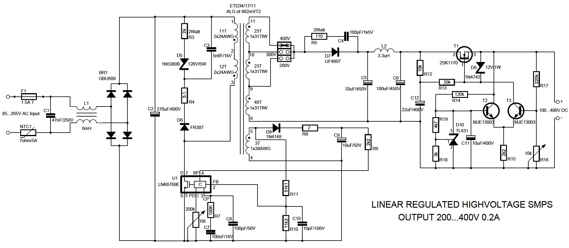

Today made a schematic with through hole parts of a Isolated linear regulated highvoltage SMPS.
The LNK6769E Offline switcher has over/undervoltage and current protection, slow/auto start, primary side regulation and thermal shutdown.
Swiching frequency is 132khz. And frequency jittering reduces EMI.
After the transformer you can preset unregulated voltage (200V,300V,400V) to reduce power dissipation of the linear regulator.

And how could we increase to 2 amperes? Run 10 of them in parallel? LOLToday made a schematic with through hole parts of a Isolated linear regulated highvoltage SMPS.
Your right, at the output i forgot an electrolytic capacitor.
C5, L2, C6 were not so expensive or do mean something else?
Tomorrow i get all the parts and i will make a prototype for testing before i design the PCB.
At the moment estmated cost are 45 euro.
