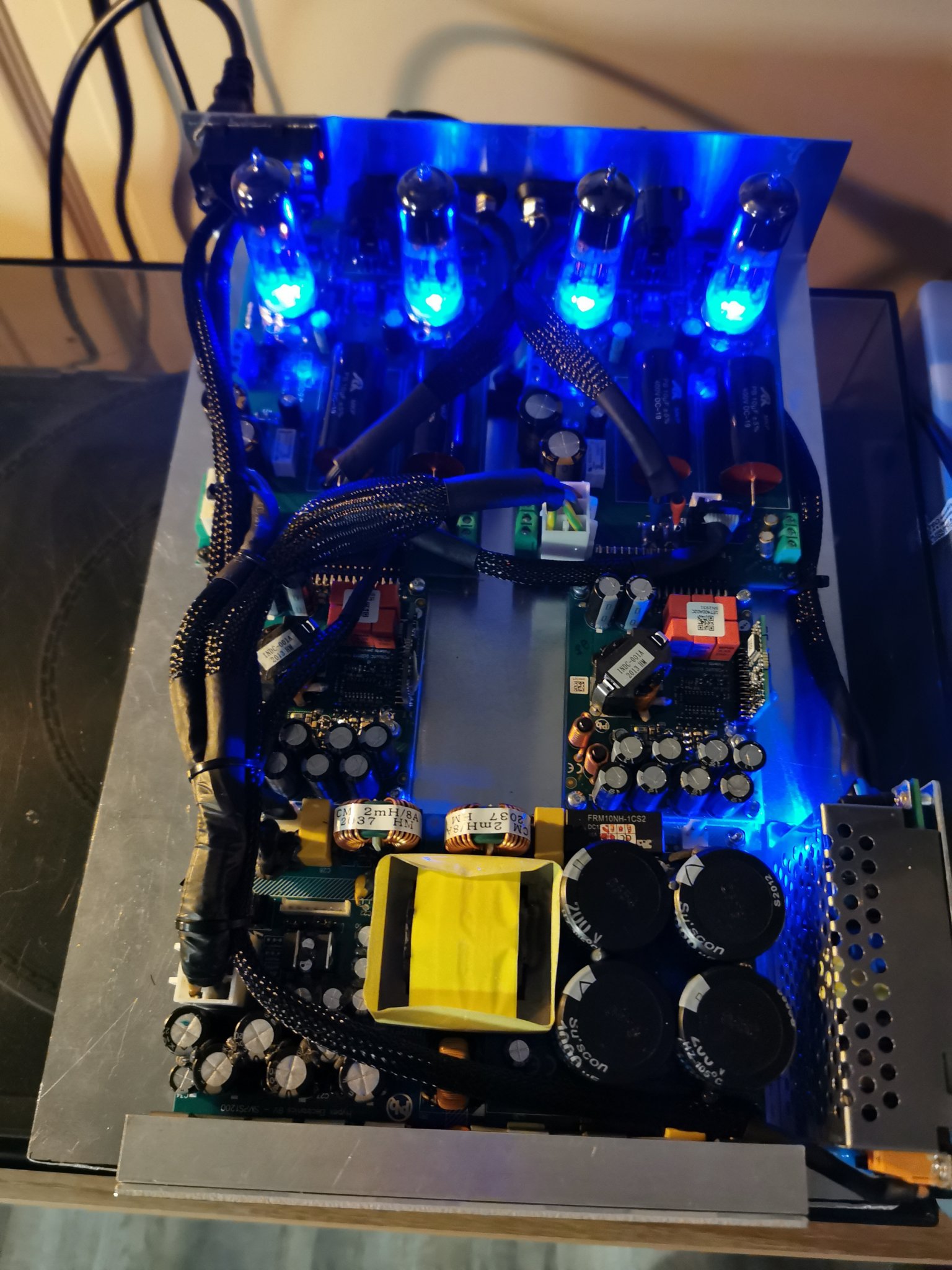

Has anyone used SMPS successfully as anode PS in tube amplifier?
I'm thinking about using modular SMPS 2,5kV PS for GMI-30 amp. Any checked solutions? air purification, microvawe oven SMPS?

What is the ripple level o this SMPSs? any audible buzz?
Do you use additinal LC filtering?

About 50mV in the 30kHz region. No humm. No extra LC filter only small C.What is the ripple level o this SMPSs? any audible buzz?

And fixed bias.

Price of HV SMPS is much cheaper(30 euro) then linear supply(75 euro) for same preamp.
And it is just plug and play. And it sounds super.

I use this one https://www.aliexpress.com/item/100...order_list.order_list_main.103.43031802rPhF3X
No hum!!
