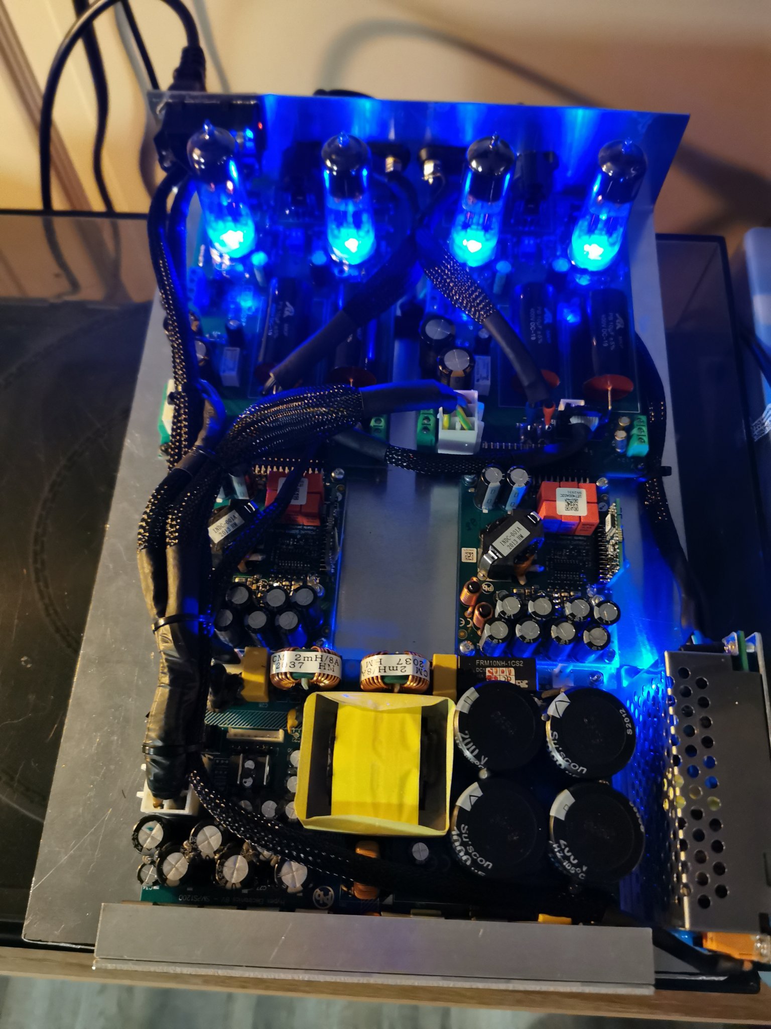

SMPS is smaller when using just one. See also my picture of a 2 x 400w class d with tube input buffer.

First the choice for an expensive buffer because of the choice for tubes. Then executing it cheapest way. That makes the tubes more a gimmick isn't it?The absence of 50/100Hz resp 60/120Hz products. No 50/60Hz transfer trough the housing to microphonic tubes.
