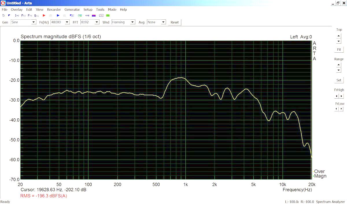

Here's the B200 SP1014 frequency responses off that site. I have no experience designing crossovers, but does this look like you could use a first or 2nd order crossover coming in at above 500Hz? There are loads of B200 units available used in the UK so it would be useful to know.
It looks like being able to cross to tweeter at the usual frequencies, and historically, there have been kits like that.
Find a tweeter of the same sort, with the same info graphs, and we are in business.

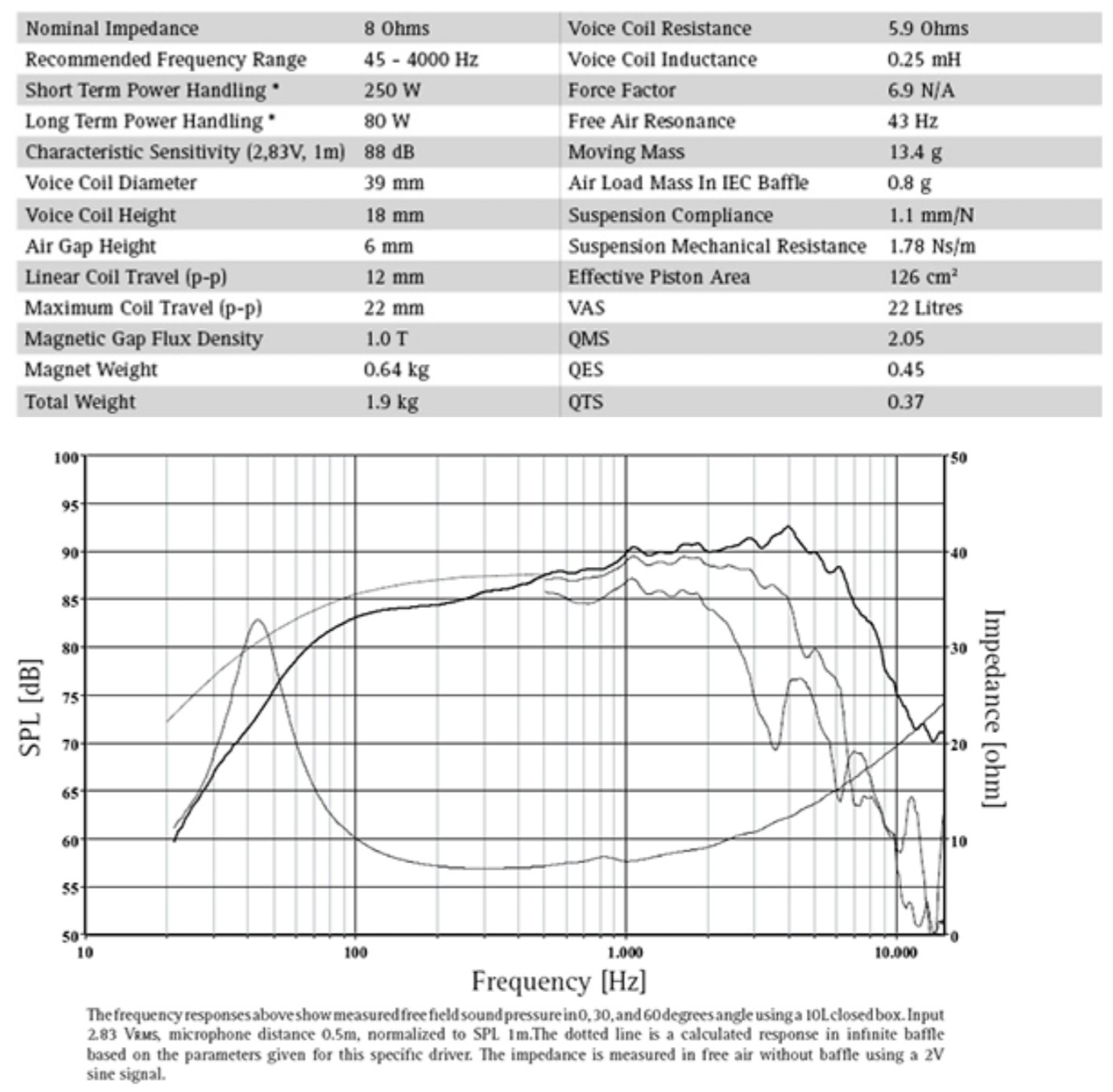

This is the spl plot of the woofer
https://sbacoustics.com/wp-content/uploads/2020/02/8-SB23NRXS45-8-GRAFIK.jpg
You can see some of the factors mentioned about 8" woofers are apparent that tend to reduce with smaller. Beaming - I prefer the pictorial view Visaton provide but clearly it's starting at 1k on that one. This one is similar to the SB unit but maybe a touch smoother.
