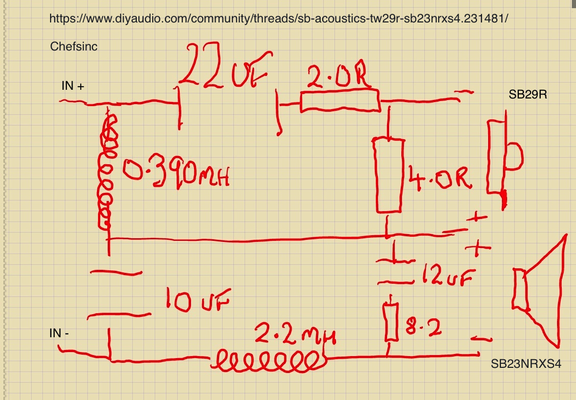

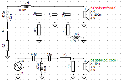

Thanks for that. I have a starting point crossover which will get it up and running, see pic. After that I'll have to look at some tools for analysis. I have a good studio mic so needs some software for my mac. I think I should use my SE tube amp since that's what will be driving it.
What would you choose between SB29RDC and SB26ADC for this? The crossover was for SB29RDC but maybe the SB26ADC is a better sounding tweeter? Xover is around 1.8K to 2K.

The crossover you show is a good example why you should use a stable, short and stupid load safe amp, not your valve...
If you use the capacitor and coil in the input and change values, such a crossover may represent a tough load without you noticing.
Maybe stick to a conventionel design and leave the series crossover for later.
Also, get a setup to measure impedance values.

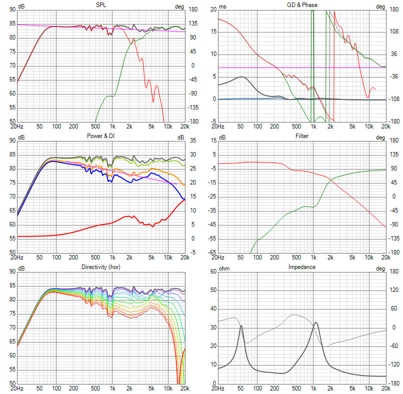

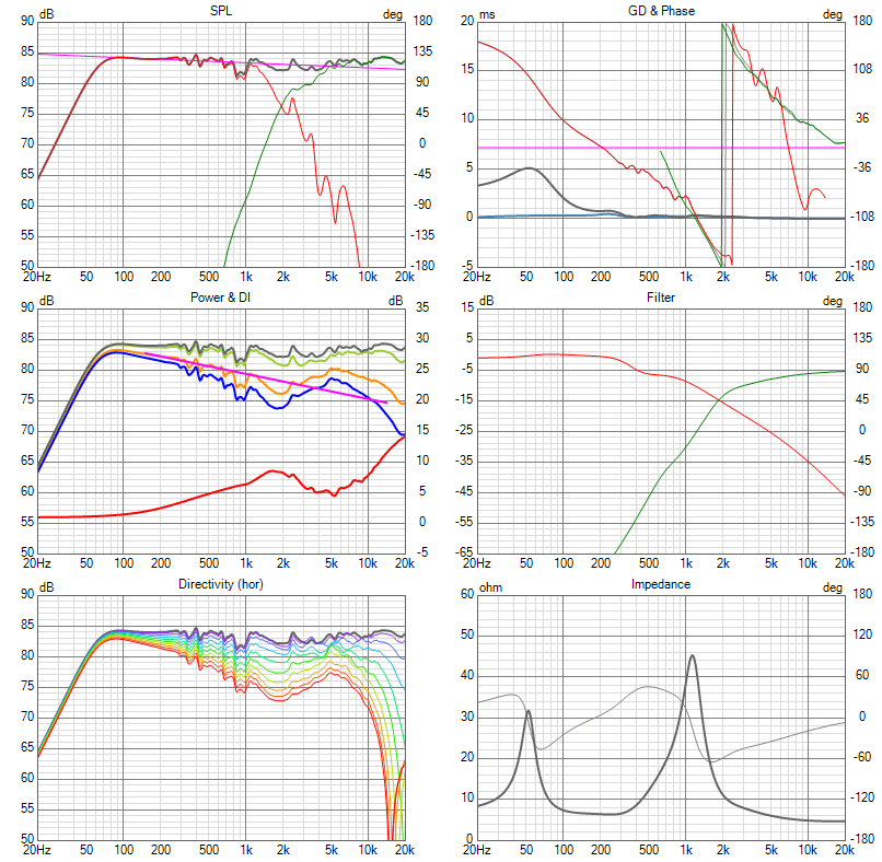

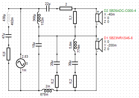

I have simulated both series and parallel x-overs with the adc tw for the baffle size you posted above.
W is 130mm from bottom, T is 330mm from bottom and 40mm to the left.
The phase is better with the parallel version and you have break-up with both x-over. The amplifier load is quite easy.
The power response is not optimal because a TW with waveguide is almost mandatory with these drivers.
The LCR group on the left of the generator is for tube amp only. You can use the cdc tweeter too.
Remember that these are just simulations and real measurements could be different.

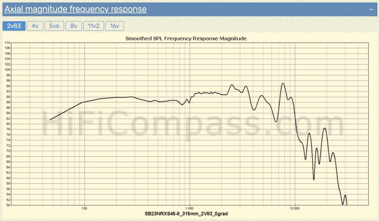

The response curve of the SB23NRX is a bit too rough in the mids for my tastes. I dont think this driver will perform as clean as some others and still require steep, lower cutoff slopes to bend into shape. That means a higher xover parts count and cost as well.
The main problem for me is the large surround to cone reflection wiggle around 1k. Thats very audible on this driver. The other irregularities can be worked around with a low and steep xover, but the tweeter won't have it easy.
Most people are ok pushing a tweeter harder with a low xover, but for my ears its too rough sounding, even if THD measurements suggest otherwise. I personally would cross a 1" dome at least 2.3 - 2.5k 2nd order, even if power response suffers a little. I guess it depends on one's priorities of the design. Using a WG definitely helps here as long as the low end sensitivity gain is there for the tweeter to reduce dome excursion.
These days it seems most people prefer the best possible power response over any other performance aspect. I understand this, but having a crossover point smack in the middle of the midrange demands much more critical design work in the xover, which becomes more expensive.
Agree with everything you said. I also do not like the combination of an 8 inch woofer in a 2 way and, besides, the simulation of higher slope filters is much more complicated and unreliable if you do not have actual measurements.
Anyway the response of the Seas U22 you suggested above is smoother and easier to cross over.

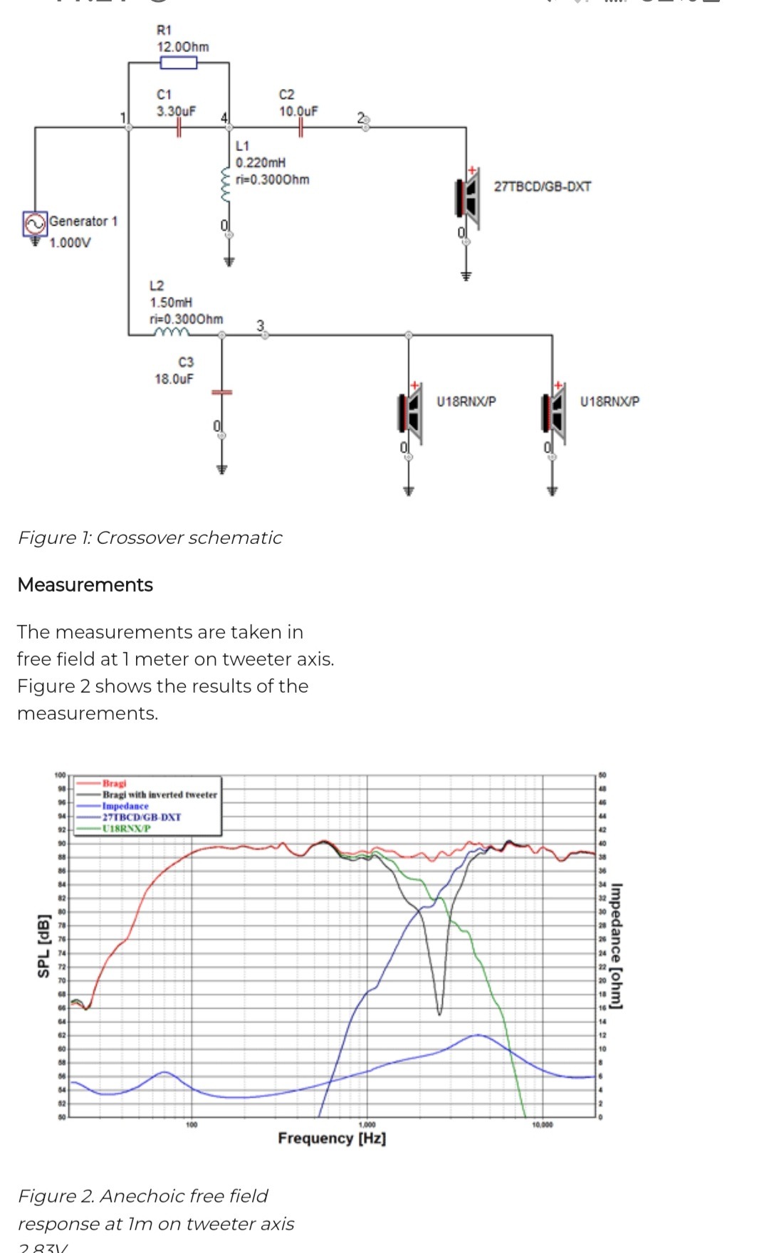

U18RNX/P - 6.5" in 8L box - very linear and smooth
U22REX/P-SL - 8" in 21L box
I'm glad your mind is open to other drivers. The SB tweeter you have is a good one. You'd want at least a hard paper cone to gel with it. That means the Seas CA22 is a good option given you can get rid of most of that upper end breakup peak, which likely isn't a difficult thing to to.
You may want to look at the Seas U22 I mentioned earlier, mainly because its an easy woofer to work with in the mids, very efficient, mates well with your Alu dome SB tweeter and can be EQed for lower cutoff in a sealed enclosure. Even if you design the box for a critically dampened sealed tuning, the low end will be extended with room gain and you can do a passive line level EQ with an RC filter on the front end if DSP isn't your thing.

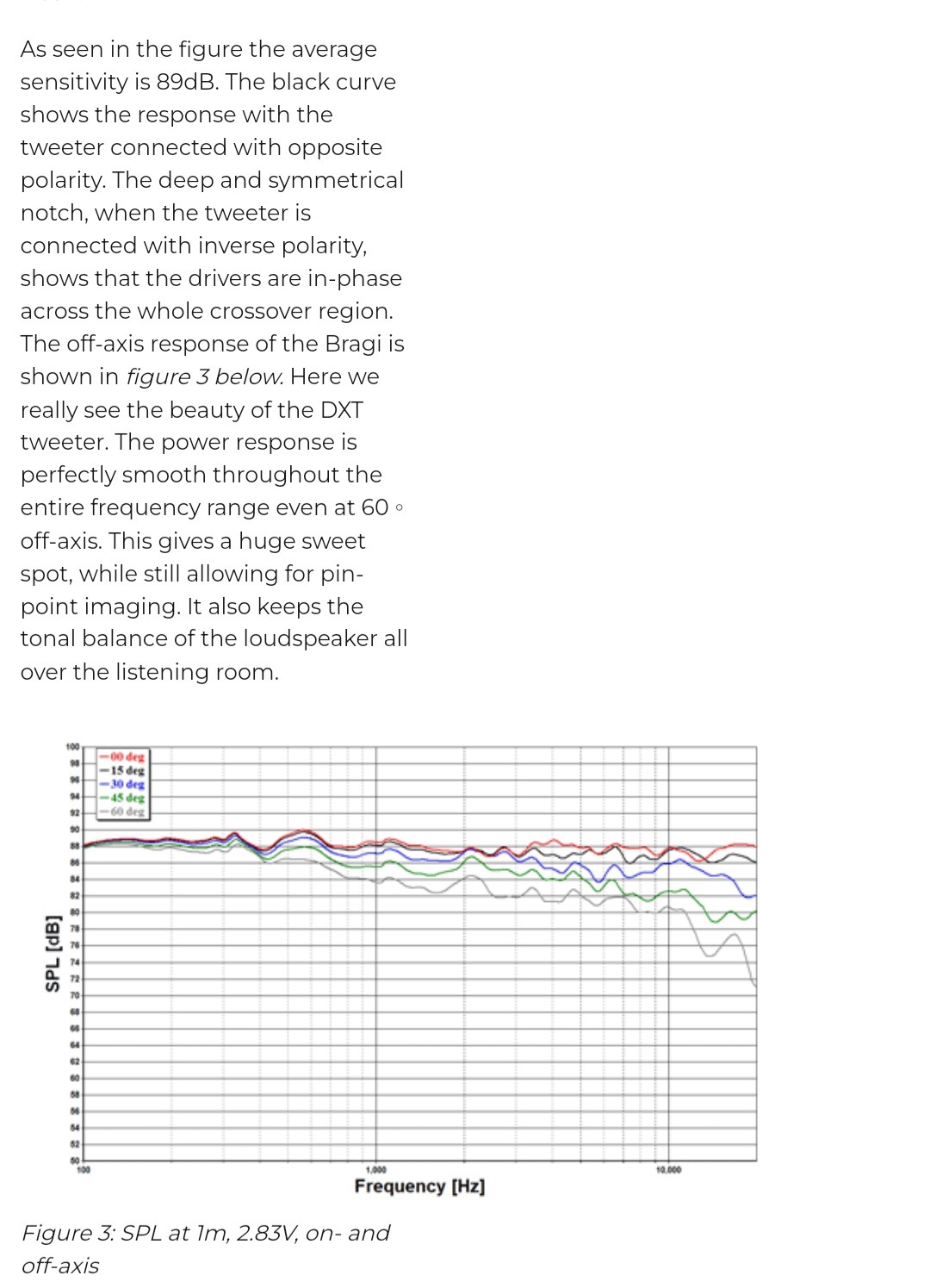

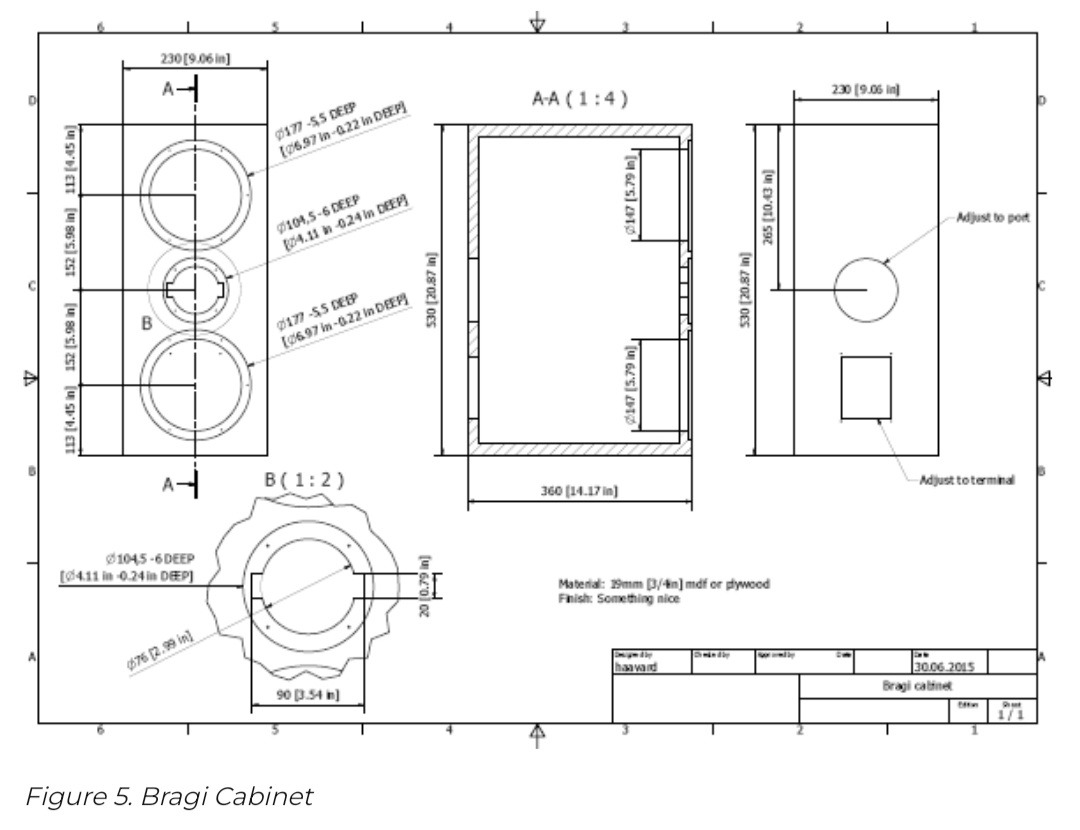

The U18RNX-P in an MTM is another option. Seas has their Bragi speaker kit with these woofers available along with crossover specs. They did a nice job getting the power response right with this design and I believe your tweeter in a WG would work well instead of their suggested DXT tweeter. This tweeter is good, but a little shy on the extreme top end and lacks the sparkle I prefer, which Alu/Mg domes are known for. They make up for this in the xover design with a CD EQ consisting of a small cap bypassed with a resistor (see below). You'd have to do this with a WGed tweeter anyways.

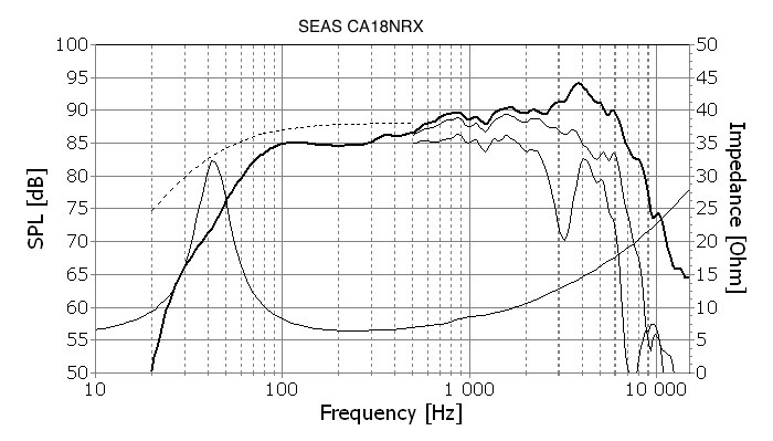

I was looking at the SEAS Mimir, which uses the CA18NRX. The Fr looks very close to the CA22NRX and maybe this crossover would work as a starting point if I bought the CA22NRX?
SEAS CA18 fr.jpegSEAS CA18NRX Mimir.pngSEAS CA18NRX Mimir1.pngSEAS CA22NRX.png
Using the larger driver with the same crossover layout won't likely work due to the peaks being 1k apart. The driver location on the baffle is also different, which also will throw a wrench into the existing crossover being designed for a specific anf driver baffle layout.

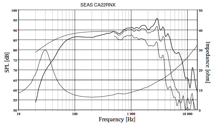

Does the response curve of the SEAS CA22RNX look better than the SB23NRX? They're quite similar.
View attachment 1242941View attachment 1242942
The peaks are in different places and the amplitude is not the same. The peak will be the biggest influence on the driver's audible characteristics. This must be dealt with, otherwise you'll have a very fatiguing speaker which isn't enjoyable to listen to. Luckily the driver only has one dominant peak, so its just a straight forward solution. Drivers with multiple or wider, asymmetric peaks can be very difficult to straighten out. This is mostly the case with undampened Alu or Mg cones and some others like kevlar sandwich, carbon fiber and textreme composites. These drivers sound good in the lower end being very rigid, but need very complex xovers to play well in the midrange. More often than not, you'll still be able to hear the breakup modes with a critical ear when playing piano and female vocals.
Harder paper cones are usually my preferred cone material, but some plastics can sound very clean as well. Not all poly cones behave the same way, especially with different cone profiles. Just infusing them with minerals and other fibers can change their dampening characteristics as can varying the material thickness over the cone profile. Harbeth swears their poly cone material and profiles sound more natural than other materials, which I partially agree with. I used to dislike most poly cones aside from a few Dynaudio, ScanSpeak and Seas drivers, but having owned my first set of Harbeth monitors changed my opinion. They of course use complex xovers, which causes its own set of issues if not carefully designed.
The LCR notch needed to reduce the main breakup peak in the mids is fairly simple to calculate based on the manufacturer data and fine tune with experienced ears using pink noise. Measurements sure help and are the preferred way of doing things, but a good ear can do it as well. I catch alot of friction from some people on here saying this, but I wouldn't suggest it if it wasn't easily achievable. Its pretty easy to hear FR anomalies. You can even use EQ to isolate it as well, then translate the EQ into the LCR needed to flatten the response.
Yes, the CA22RNX is absolutely more suitable for a 2 way design than the SB23NRX. This driver has been around for a while in various other incarnations, but its still a very good driver by today's standards. Troels used it in the Poor Man's Strad, which is a very nice sounding speaker in many regards. Being a 3 way design, it doesn't run the woofer nearly as high, but the bass quality is very natural and extended, which is the typical behavior for many Seas paper cones. I've built monitors using CA22RNX, mainly as 3 way designs using dome mids, but if you tread carefully, this woofer can sound very good in a 2 way to just above 2k with a very capable dome tweeter.

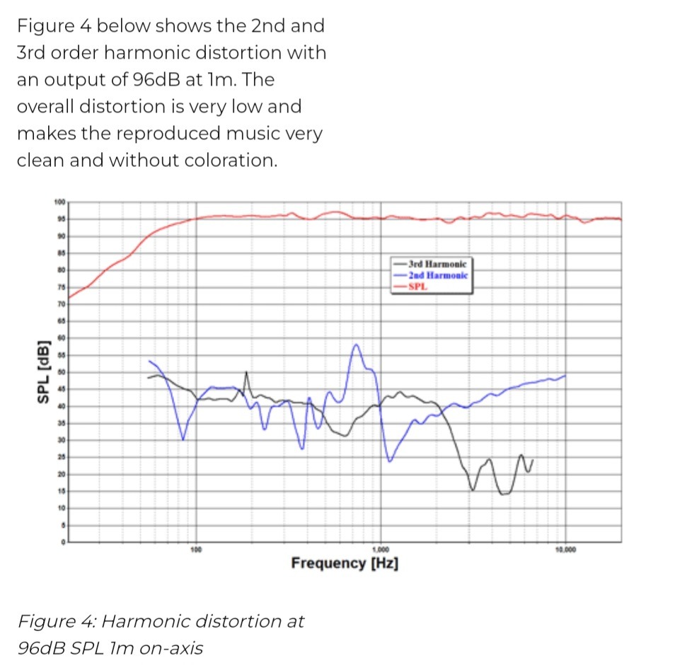

😉 I wondered about starting my own thread concerning Xmax queries but there are lots of these and no clear answers really. Some even say measure it when distortion is a concern. Part of the reason for wondering is a Visaton part. They spec one for 10% distortion in the data sheet, a recognised standard yet load 3mm when the driver is loaded using their data included in Boxsim. LOL a bit of a black hole between to 2 figures but more info.
