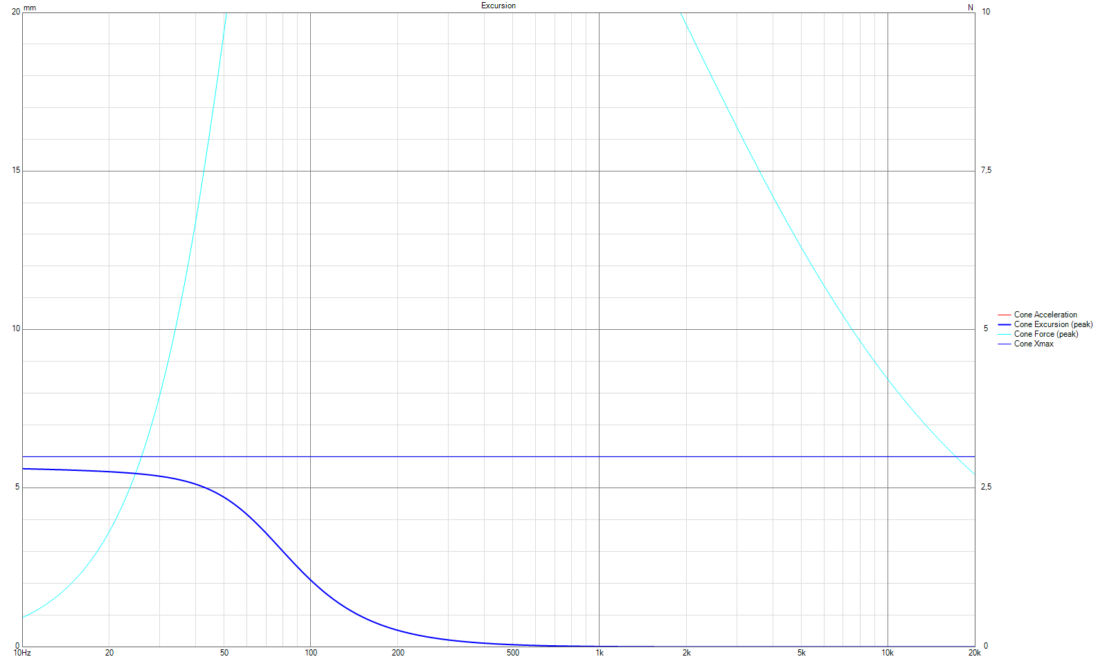

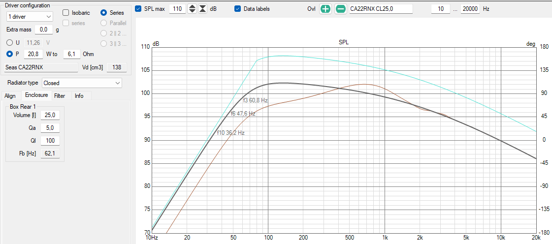

As to Xmax you can use VituixCad panels in the Enclosure tool that gives a lot of info.
Seas CA22RNX in 25L box: the max output level (light blue curve) is reached at 20W
Cone excursion at 20W is below Xmax so you are fine.

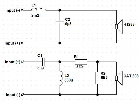

By sheer persistence in going through all the relevant threads on DIY Audio I unearthed a crossover for the CA22RNX plus Morel CAT308. This is the closest I have come yet to a crossover I could use. I think xover is 2K? What do you think? I now have a pair of SB26ADC to use. They are 4 ohm, the CAT308 is 8 ohm so some modifications look like they need doing........

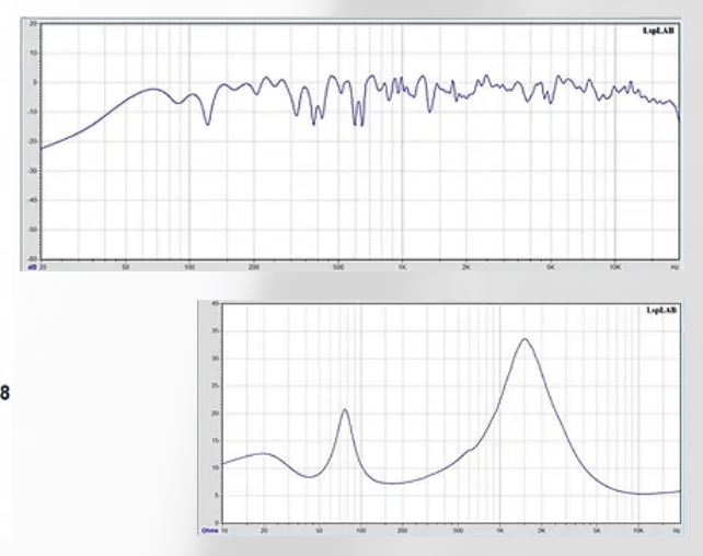

I think it's 3-4k and the woofer will operate in break-up at that frequency.I think xover is 2K?
In the attached zip file you find the FR and impedance file of the drivers you chose, input in a simulator like vituixcad and play with them.
< I think it's 3-4k and the woofer will operate in break-up at that frequency.
What suggests 3-4K? The impedance curve shows a big peak at 1.5K. I can't see the crossover frequency mentioned in the text, but my Russian is rather basic.... ah, just read the xover is 3K. Also says "filter is of the second order." That's too high. Needs to be 2K. Back to the drawing board.
The impedance peak in the system's final curve won't be an accurate indicator of actual acoustic xover frequency. Thats what really counts and the electrical response itself isn't the whole story.
Using a non WG tweeter has completely different xover requirements than a direct radiating dome in terms of filter slope, phase behavior, level and EQ needed to get a flat-ish response. You won't be happy with the results if you just copy the HP filter of one design, combined with the LP of another. Thats a complete waste of time, other than just for experimental purposes.
You'll need to cross the CA22RNX around 2k in a 2 way, otherwise you'll have weird off axis behavior, power response and beaming, plus running the woofer in breakup as explained above. That amounts to a waste of good parts due to a lack of proper xover for the specific drivers. You won't be happy with the results. I can guarantee you that.

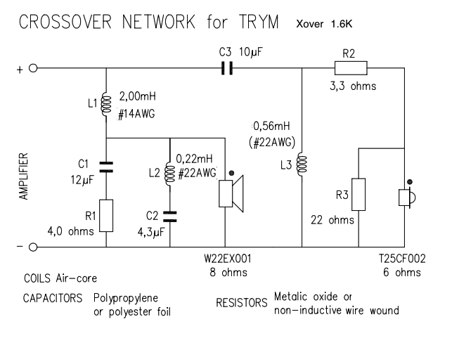

I hear all your misgivings, but the plain fact is I need some sort of crossover to start with just to get sound. No waveguide in the SEAS Trym design and crossover is 1.6K so we are in the ballpark at least. Different drivers beyond my budget but it could be a point of departure. I haven't yet found any crossover that crosses the CA22RNX around 2K so I'm waiting to buy a mid-bass until I have a crossover in mind. I need at least something pretty close.

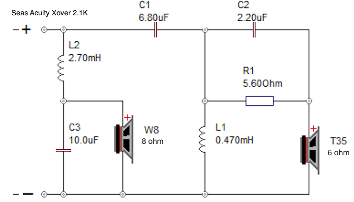

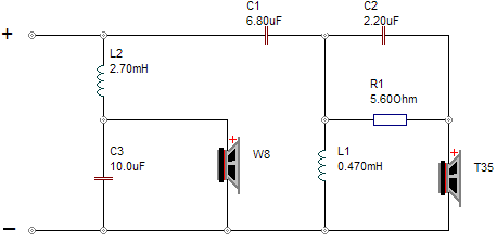

There's also the SEAS Acuity, another 8+1 with a crossover at 2.1K
https://www.seas.no/index.php?optio...-acuity-kit&catid=66:seas-diy-kits&Itemid=345
https://www.seas.no/index.php?optio...id=384:trym-seas-diy-kits&catid=66&Itemid=250

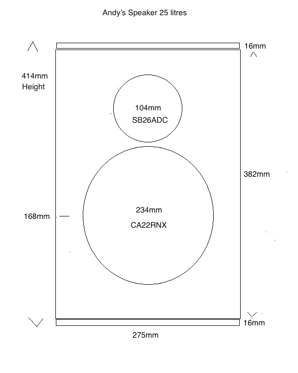

Are you settled on a 2 way with the CA22 and SB26ADC (without waveguide)? I can give you a passive crossover simulation (assuming you're going passive) if you're willing to wait a week or so. What I need are:
1. baffle dimensions
2. Whether the edges are rounded or squared or chamfered / faceted
3. driver placement on baffle for each driver
4. enclosure volume and (if vented) tuning (Fb / port size / length if vented)
5. How much baffle step compensation you want (I'll go for ~4dB if no preference)

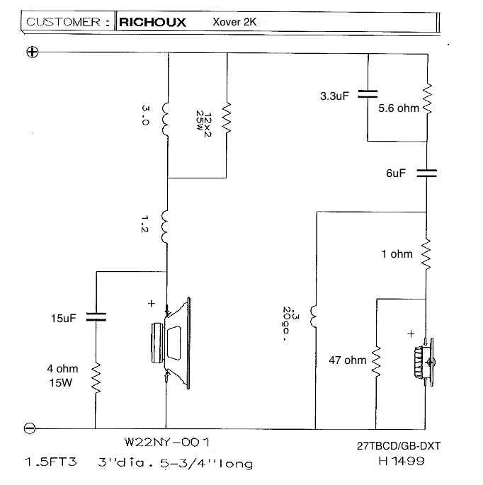

There's also the W22NY plus 27TBCD 8+1 with a crossover at 2K
https://www.madisound.com/library/stacks/LEAP-W22NY-001-H1499.pdf
And as mentioned before the chefsinc crossover for the SB23NRX, though this was done by ear and has various mods...
Thanks Dave, that would be great. I'll scare up some drawings for you.Are you settled on a 2 way with the CA22 and SB26ADC (without waveguide)? I can give you a passive crossover simulation (assuming you're going passive) if you're willing to wait a week or so. What I need are:
