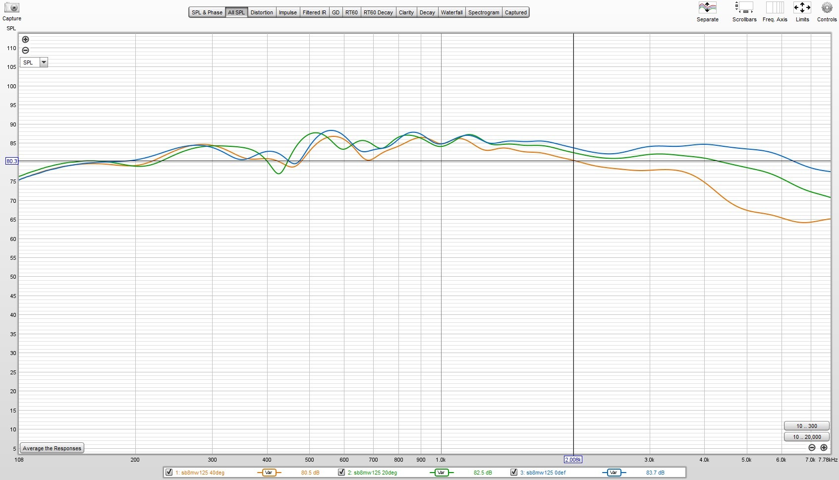

I am experimenting right now with a SB Audience 8mw125. It's a experimental 3 way design with 8mw125 is working from 120hz to 3.5khz.
It will soon be limited to 120 - 800Hz range in a 4-way design with a dome midrange. Attached is a quick and dirty sweep in box in not so quite environment.
1st pic: in box sweep at 0,20,40deg.

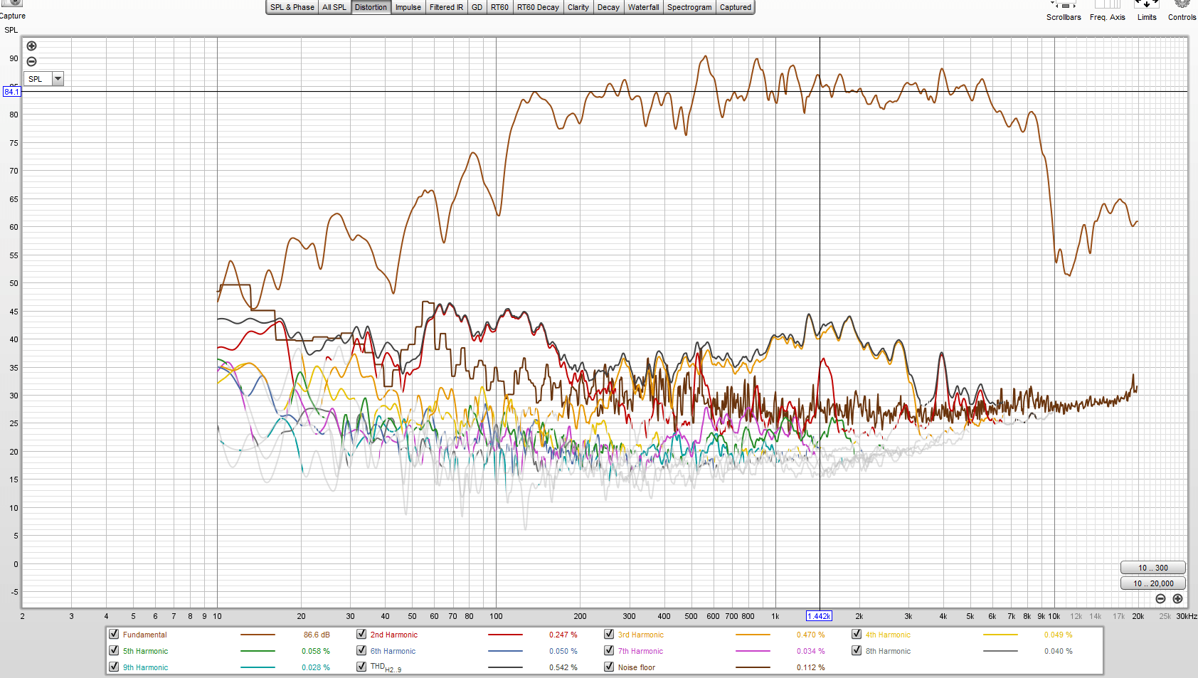

2nd pic: in box distortion. I don't know what my interface(quad capture), box or tda7297 is introducing in its own distortion to the mix. Especially the 3rd harmonic which is quite high. May be I need to do some loopback test. So take it for what it is.
Another worth noting is due its to natural roll off 8mw125 midrange is right now using only a single inductor(paralleled with a small cap) in its path.

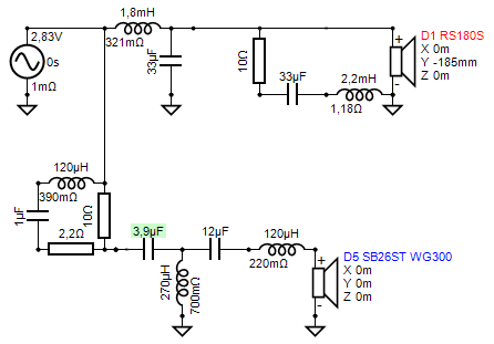

How would you rule the Bafle step around those 500 hz/700 hz, please ? I have a 26 cm width front baffle...
First, let me say @profiguy is right about considering the environment and placement of the speakers. So consider if you need a full BSC, e.g. speakers against (or in it certainly) the front wall might need none.
Second: there‘s info on this at various places, I believe even TG wrote about it. The general approach is to treat the BSC and the lowpass apart -in a way-. There are more options, but in the past I mostly used a tuned series LCR branch in parallel to the woofer. Like in the example added. This way you lose less voltage on the woofer (typically around 1-2dB higher system sensitivity), at the cost of lower impedance in the midrange. Nothing‘s perfect, but all my small (2-way) designs ended up with such circuitry, even back in the late ’80s and early ‘90s when I fooled around (anechoic room and old-fashioned Neutrik equipment at hand, we didn’t talk about BSC then, man, those were times 🤣).

@markbakk Yes, the separate treatment of BSC makes the situation far easier to deal with in a few ways. That was my point in the last post. There are of course multiple ways to tackle the BSC, with or without integrating it into the LP.
I like the way you think. Your use of an LCR for BSC can be very advantageous and actually refine the correction curve more accurately to the specific speaker placement. The biggest complaint i usually have with more narrow baffled floor standers is they end up sounding "chesty" or congested in the lower mids when placed close to a wall but away from corners. The closer the LF driver is to the floor, the more sensitive the speaker is to placement.
Sometimes I integrate switchable lower mid EQ into passive networks with a multiple tap inductor I wound myself. This allows for alot of placement flexibility. You simply use a double deck rotary switch with one section for the inductor taps and the other for the capacitors. A second single deck rotary switch selects the amount of attenuation at the chosen center frequency.
