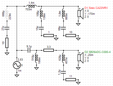

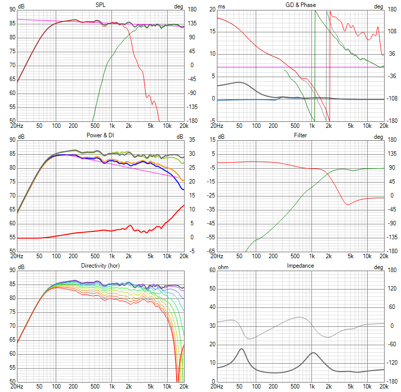

X-over for your baffle (275x415mm): FR of the drivers have been manipulated with the diffraction tool to generate off-axis responses.
Woofer position: 168mm from bottom side
Tweter position: 338mm from bottom side/118mm from left side (20mm offset)
CtC is 170mm
Check that the drivers position is correct for your cabinet and remember that this is just a simulation.
CtC is 170mm

Thanks for that! The Heissmann claims -3db at 49Hz. How is this possible? I have to look up high pass cap. No doubt it has downsides or everyone would use it.4ohm version is used up to 1600hz LR4 in a closed-box Heissmann 2-way https://heissmann-acoustics.de/en/suzie/ with the high-pass cap (GHP; geschlossen mit Hochpass-Kondensator) trick popular in German DIY to squeeze a db or so more out of the bass. A lot can be gleamed from the example construction PDF on the page.
Seems a very capable driver that is easy to work with in some sims I did some time ago. The horn-tweeter used in that Heissmann design is not expensive and doesn't need a waveguide, although it needs a lot of padding with its very high sensitivity.
Generally, inserting a series cap about 560uf or greater into the woofer of a particularly volumed closed box interacts with the impedance such that the low-end response is boosted at the knee. It is not an exact science but can be modeled in Vituixcad and then tweaked in practice. Example here and in the thread linked before.
Not sure why it isn't used more often, maybe just cause closed boxes are not the fad.
Edit - I simmed it working in VCad with the 10" version.
