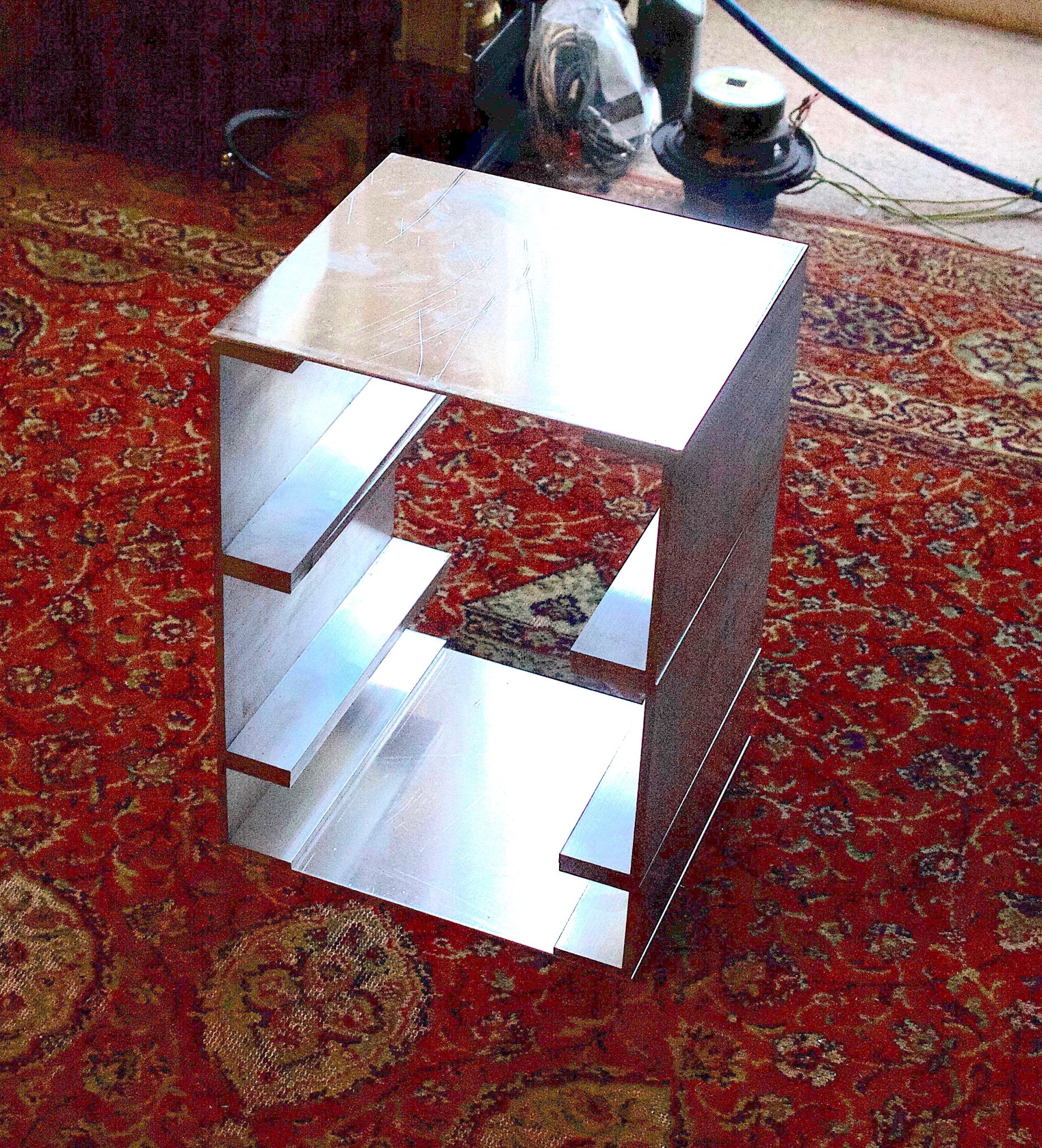

I'm debating whether to add a little more height to the aluminium sides. This would take the enclosure size anywhere up from 20 to 30 litres.
It's mostly a case of being able to use an 8" driver with a tweeter in a waveguide. But looking at Fr graphs of waveguided tweeters they all appear to have a suck-out around 10K. So I'm asking myself if waveguides are really the solution or just a kind of fashion accessory.

it is better cause it is easy to reduce the volume if needed by adding plain bricks or sand bags . Make once, spend once !
However as already talked in the thread a ready made design is made for a precise front baffle dimension. So the design of the filter must be reworked according the size of the new enclosure.
