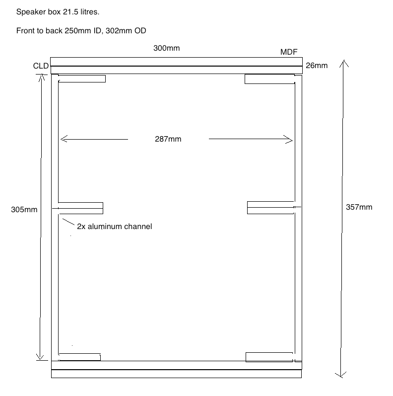

Thanks! I'll post exact plans for the cabinet ASAP. By "kit" you mean the tweeters, woofers and crossover design? I can source the inductors and capacitors. I have quite a lot of each.Maybe if Andy would post exact plans for his cabinet, someone could design a matching kit? So far there has been no real hit in the kit lottery.

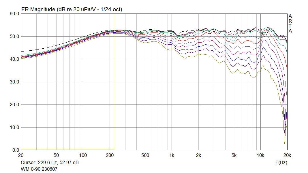

Interesting - but also suggestive of needing a very small driver under all circumstances if you care about the lower plots.On IEC baffles...
This is the response of a RS180S (at least the part under 1,5k, in 10 deg steps) in a real life box, some 8,5" wide. Now this is a 7", what do we think an 8" would do at 700Hz?
It would be interesting to see what a tweeter does as well.
Is it my imagination or is there 11 plots?
It looks to me that 60 degrees is the red plot And it seems down a fairly constant amount between 1k and 3k. I can only assume edge diffraction effects?
It actually is the plot of a two way comprised of the RS180 old shielded version and a SB26ST in the WG300 waveguide in a small monitor speaker. You see all kinds of diffraction effects, notwithstanding the waveguide. Larger baffles likely show less, but I wanted a simple rectangular baffle just around the units.
I see 11 plot lines too, should have been 10. I think I added a 45 deg measurement, but I would have to look it up.

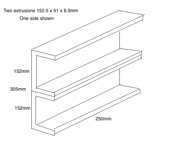

so the baffle shall be 305x250mm? Thank you for posting in Millimeter!
Can you make coarse cut outs in the aluminum? Maybe by placing many drill holes side by side or with an angle grinder?
Sorry, got that wrong somehow. Anyway, not the "usual" baffle shape.
6.5mm extruded aluminum is quite silent in such short cut's. A coat of semi elastic material like SIKAFLEX should make it sound dead. You could use a reasonable coat SIKA and top it with some alu-butyl. This works perfect for damping and will stick to the aluminum (eloxal?) for ever.
Don't waste too much volume, money and time on damping. This is no wizzard art work, even as some treat it like that. Dead is dead, you can not win anything with double or tripple kill.
