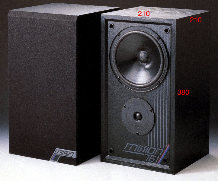

That misson sure is a good speaker of it's time, maybe throw out electrolytics and Benic caps. Looking at the x-over is the best you can do to them.
I once bought a something similar pair for a professionel singer, she wanted to practice at home and had not that much money to spend. Worked fine for her.
Not a good idea. The Misson speakers have been tuned for the volume. 20% more may be acceptable, but twice as much will make them loose character. Bass will be less, in a region you need and use.
If you plan such a transplant, first take one speaker out of the cabinet and measure the TSP. All it needs is your time, a free software and a simple resistor of maybe 20-50 Ohm. You have anything at home, right now. Then simulate and see what might be an improvement.

Why going so large width for a 8" ?It would be better to put 30° recess around the front baffle. The soniicresult will be smoother than a squared aluminium imho. I would just choose the aluminium for the front plate and make the rest wood to have recess. Then 300 mm makes sense this time as width but after the extra of the recess. Illustration : 24 cm alu front baffle width with 3 cm recess 30° on each side of the front baffle. Total width 300 mm.

Or keep the mission and double them with aluminium and sikaflex in between if the first item of the list is to have an aluminium enclosure.
I think indeed it will be deadier because those Mission cabinet is made the cheap (and chip wood) way. And keep the monney to put good resistor voice coil and caps in the Mission you will tune by ear for the tonal you like.

Needs to be 300mm wide for the 8" unit to fit. I measured it with a Kef B200 I have. Remember the ears sticking out in the aluminium channel pieces.Why going so large width for a 8"
Btw : fellows, what are the woofers Mission picked up in this loudspeaker ?
The units were and are good. Vifa C17WG that Troels liked a lot in C17WH form, paper cone and foam surround. And Vifa D19 that was a very widely used 19mm. For their era they were good choices.

Nothing wrong with the Vifa C17 and D19 (although the textile D20 is waaaay better). The combo however pretty certainly leads to quite some sound power at 3-4kHz or an on-axis dip. A fellow DIY guy over here used to dismantle Missions and build better speakers with the drivers and an optimized crossover. The stock system measured, eh, not that good. So I think it can be done better.
Andy, your baffle size sure has potential. If you want to use the C17 drivers, consider getting the DXT tweeter or even better, the W148 waveguide with an appropriate tweeter. But you’ll have to find a means to measure the raw acoustic response of the drivers. If you stick to Visaton, you actually could sim the high section pretty well without measuring. But you are on your own with that C17.

Sorry but there are better choices than the DXT for a good sounding tweeter : cat378 (fabric- >2000 hz) , SB26CAC (>1800 hz) or STAC (>25000 hz), 22 TAF/G (>2000 hz but better > 2500 hz). And all are less expensive and can be horned but the TAF/G (cat378 is already : see OrangOutan and the link I provided for the sound above in a post).
if we have the datasheet of this Vifa, we can predict circa the cut-off and the Qtc according the volumme cabinet chosen hoppping it is = or < 0.707 .
Damping can increase artificially up to 20% the volume.
