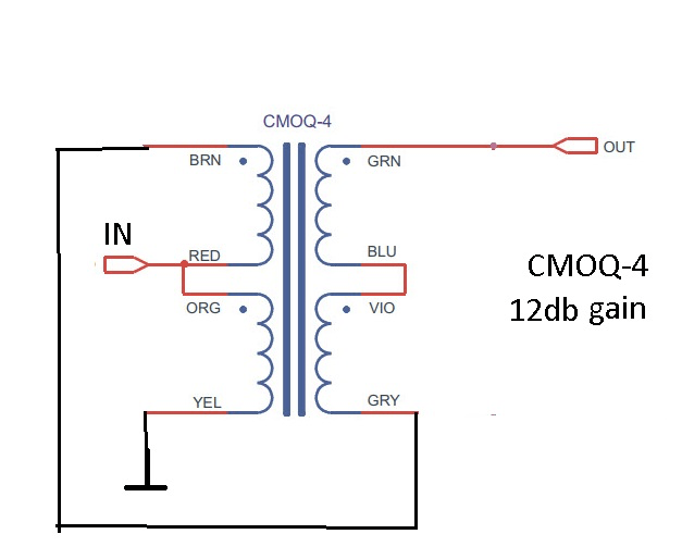

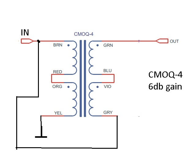

Hi, I’m trying to find some info on the different way to wire the autoformer to have different gain settings. Is there any other ways to wire it other than the 6db and 12db like in the iron pre. Let’s say to have 0, 3 or 9 db of gain? I’m don’t think that I fully understand the two wiring diagram here.. 😅

Im using the cinemag. It was just out of curiosity not that I need more gain. Thank you ZM.
Since I will only have two sets of inputs, I’m planning to use one of the three remaining relay to switch between 6 an 12db of gain. Is it a bad idea? Any problem that I could ran into with the relay circuitry / relay psu to energize more than one relay at a time?
Yes ironpre se. I think I’m good, not too complicated. I will begin by making it work properly as is than will add the switching. Thank you again
Good idea.
I can't tell you how many times I've popped the lid to switch the gain setting jumper. I guess I haven't been bothered enough yet to wire a proper switch on the front panel....Just Lazynessss :rofl:

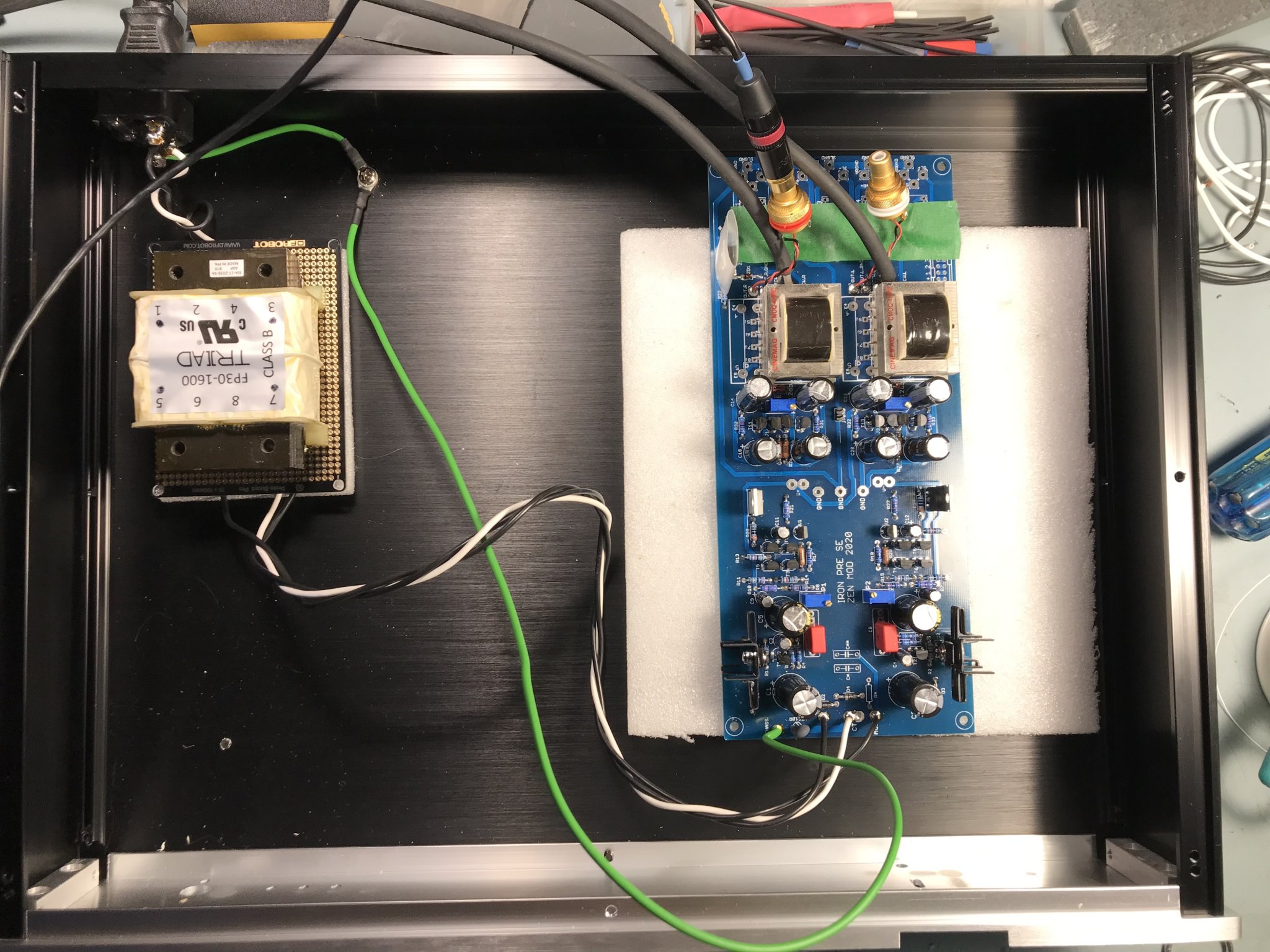

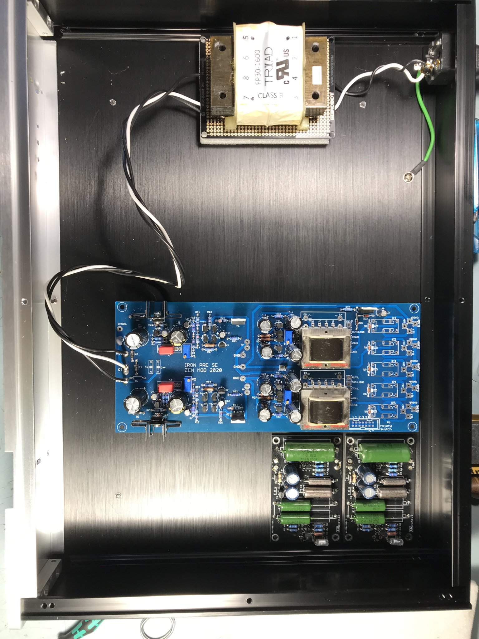

Progress, finally received the chassis. I’ve hooked up the iron pre to the transfo. Everything seem to be ok, +15v -15v and offsets easily adjusted.

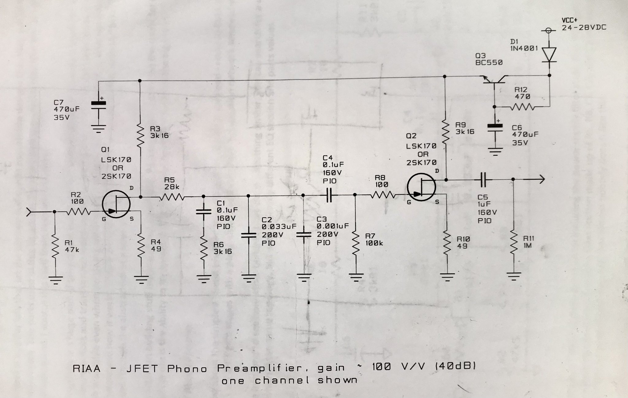

I have some riaa filter board that I want to add. So question for ZM, would it be detrimental to the good Gemini to hook up my riaa boards to the V+. Pretty simple design, 2x2sk170 + cap multiplier per channel. I’ve included a schematic bellow.
Hubert

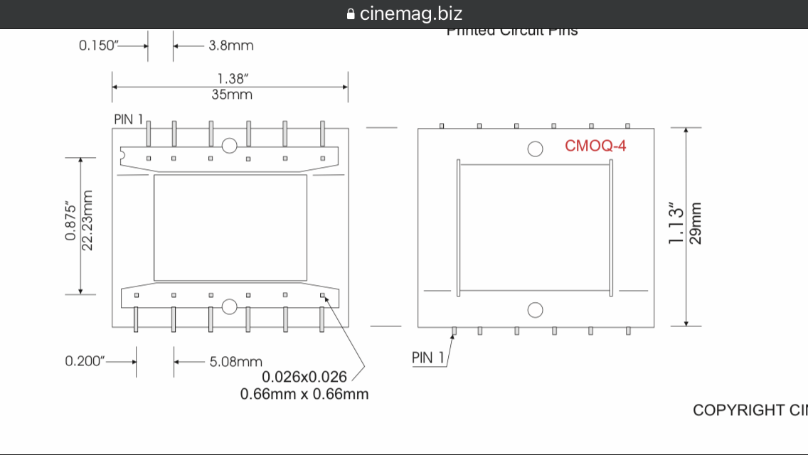

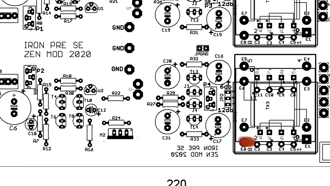

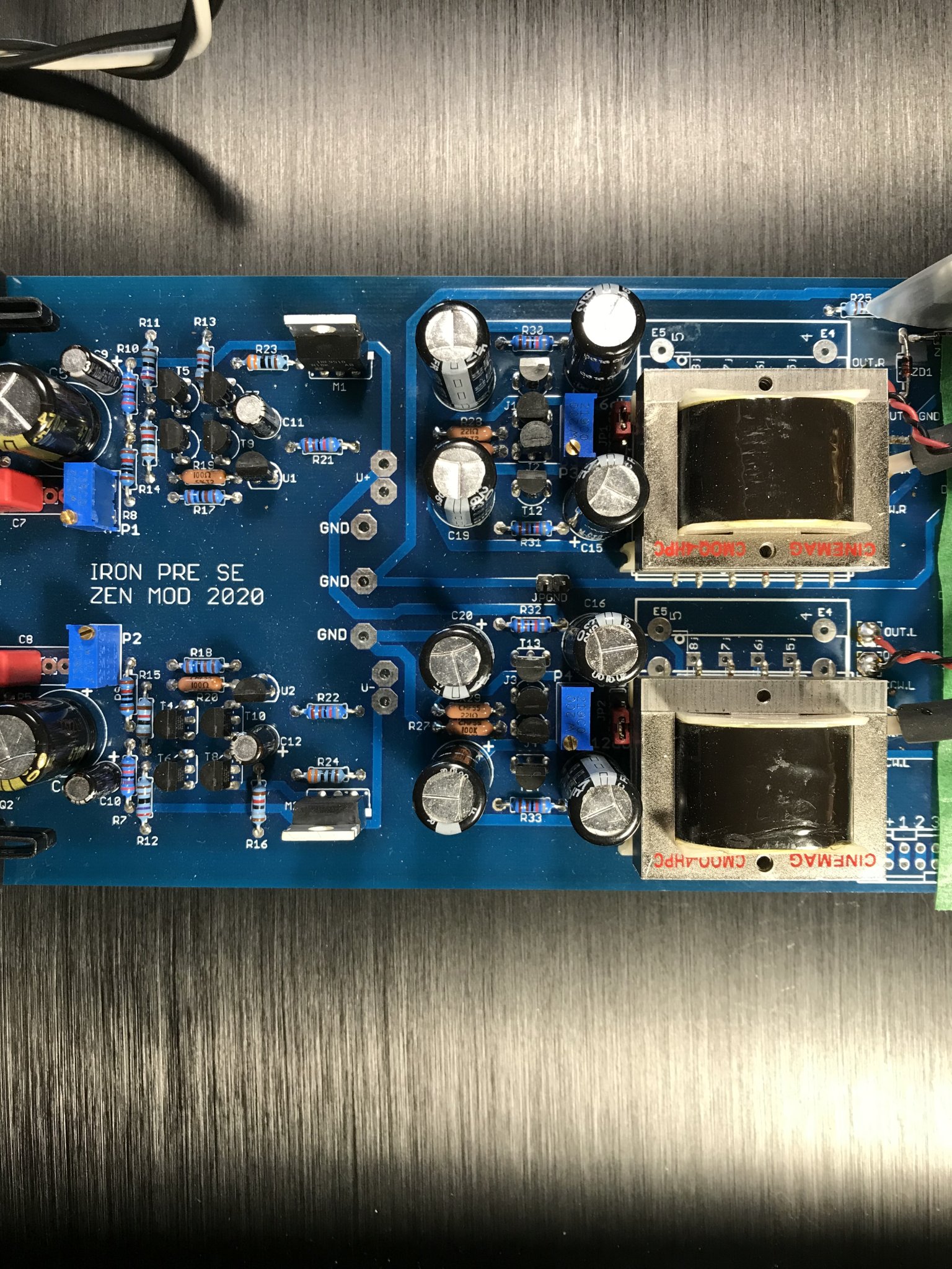

So.. first test show no gain at the 6db setting and 6db gain at the 12db setting.. Realized that I must have mounted the transformers the wrong way. Can someone double confirm this for me before I pull them out? Pin one on the cinemag should be where the red dot is.
Edit: pretty obvious that they are reversed. Output at buffer is unity so it’s good. Working on it

if you mounted them backwards ....... that's possible only if using some force
pins 1&2 are having smaller pitch than other pins, so practically pin1 being key
final iteration of pcbs ( that going to Store) is having revised pads for xformers, so no more need to cut corner pins of Cinemags
Ok everything is good it’s playing music! My pin 1 was cut for a previous project and with the board revision that I have it was an easy mistake. Totally my fault. Also found that I needed to tie pin 5 and 8 to have proper output. Rhthatcher made the exact same mistake in 2020 😅

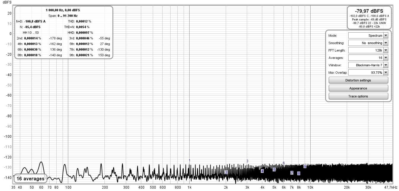

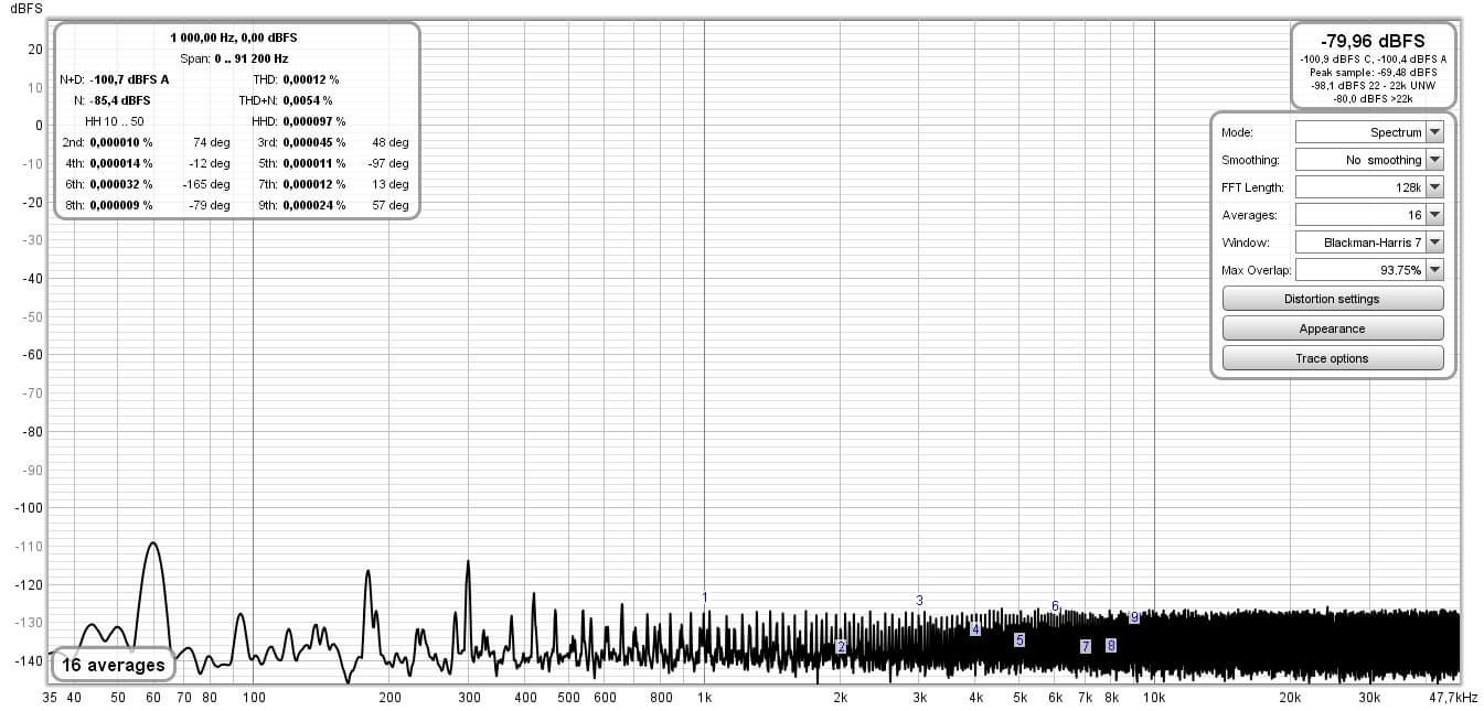

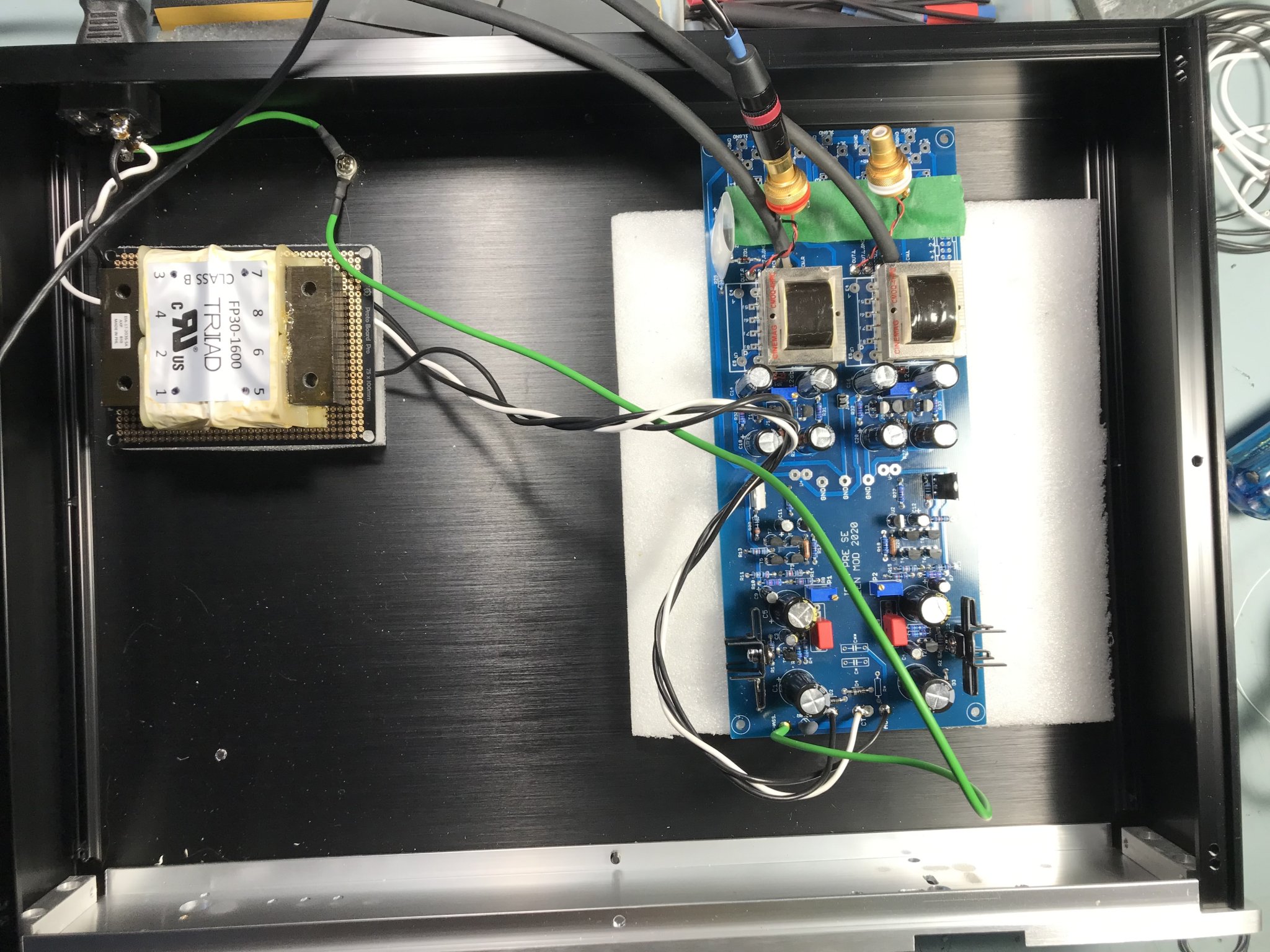

Now it’s performing up to standard. I had left the power transformer sitting on a foam to optimise radiated noise and now I have reached the limit of my soundcard 😉 Left you can see the noise picked up with the transformer mounted pointing vertically and right with the transformer pointing at the cinemag. And I must say that it sound really good so far. Thank you ZM
