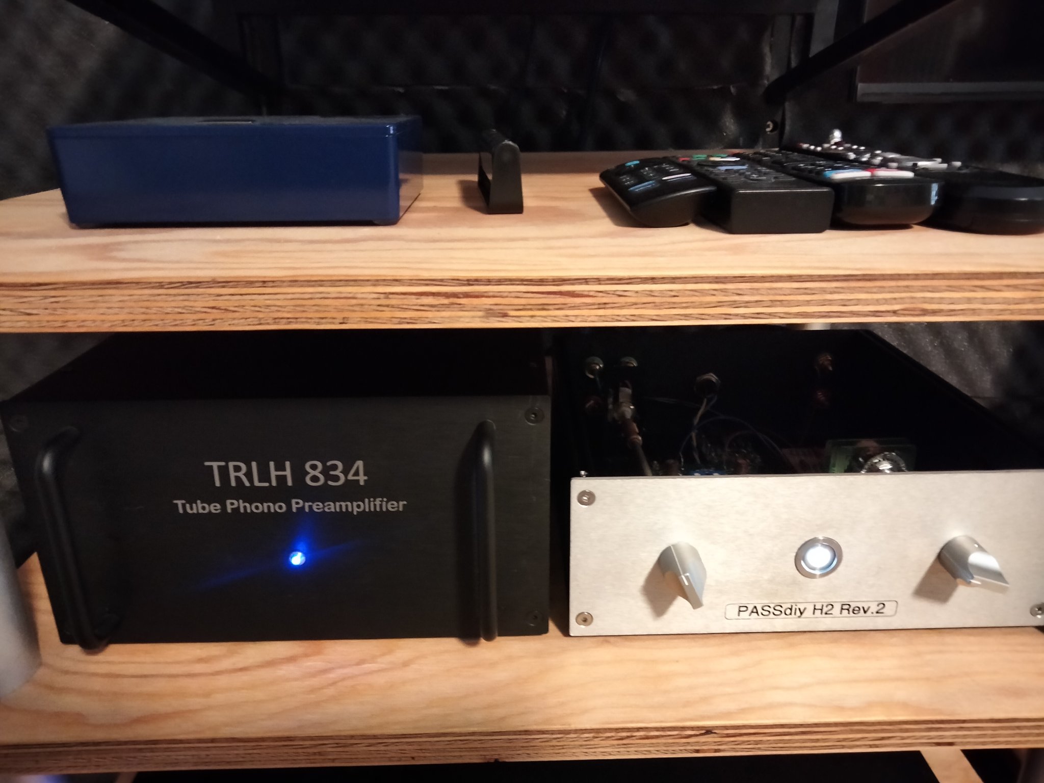

Thanks ZM. My phono preamp is a 834p with 12AX7 cathode follower at output. 25K would be enough?
ZM's Thumb of rule - eyeball ( good enough) calculus for cathode follower Rout is 1/S, where you'll find S value in datasheets [ma/V] ....... right way should be deriving actual values from exact working point, but datasheet read is good enough in most cases
for 12AX7 (blasphemy using 12AX7 for that role but, hey, that' Tim de P. - he can do anything and I'm just going to green) S is 1.5mA/V so Rout is ~ 670R
in ZM's book - better to leave 50K volume and alter Rin of your Iron Pre to 270K
take care of not too long interconnect cables and that's it
