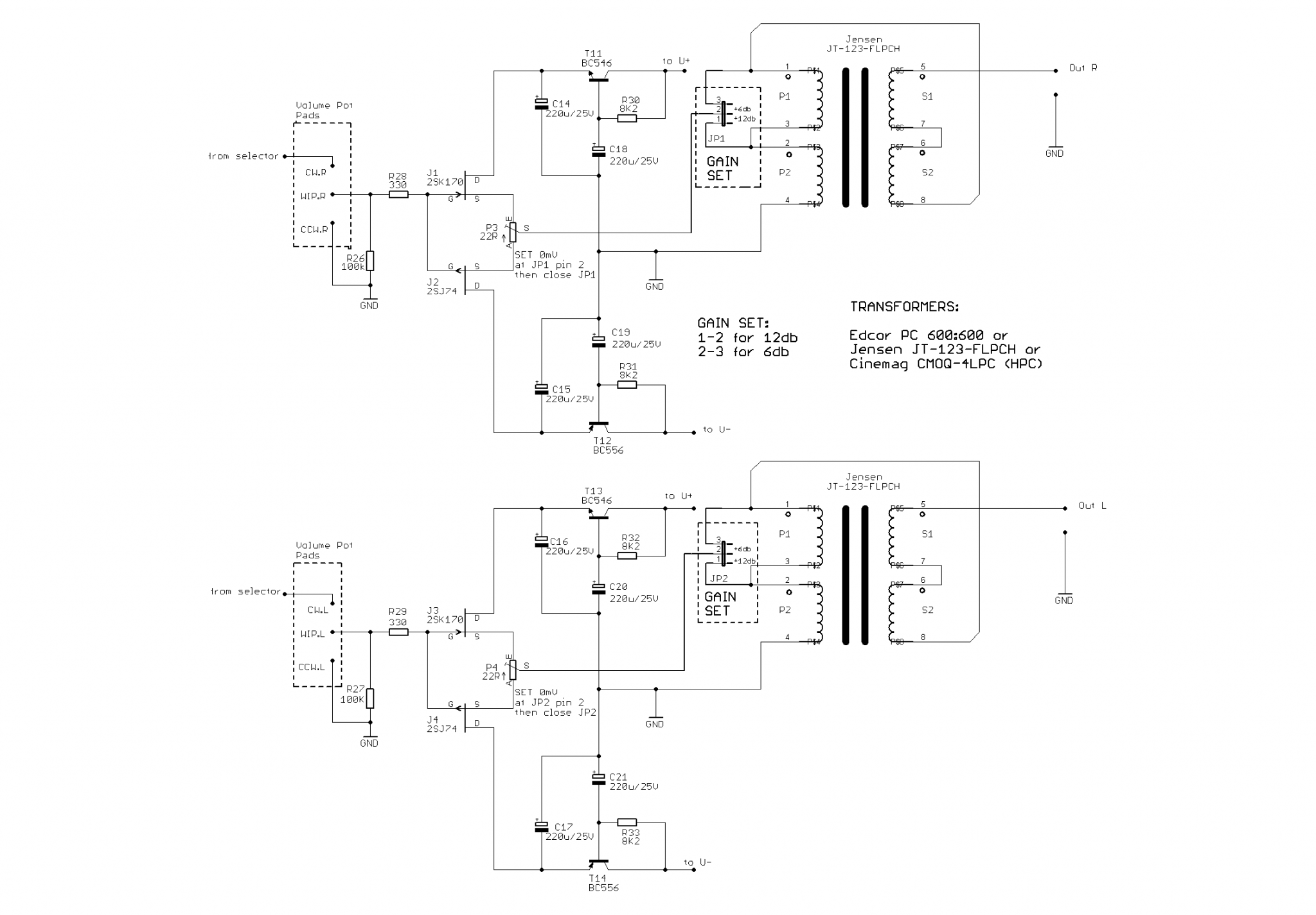

in general, with repeater coils (old name for 600:600 jobbies) it's irrelevant which one you use as secondary and which one as primary
further - if you see one side having more Rdc, that's secondary
if all windings are having same Rdc, irrelevant
Thanks again Zen Mod, my friend has measured them and it looks like all windings are the same and around 50 ohms or a bit less dc (he just has a primitive analog meter for car repairs).

Hello Damien,
6db is 2x voltage gain or 2x turns ratio, 12db is 4x voltage gain or 4x turns ratio.
The impedance ratio(your question if it works or not is related to this) is equal to its turns ratio squared this meaning that:
-for 6db your output impedance will be 2x2 x input impedance, so output impedance will be 4x input impedance
-for 12db your output impedance will be 4x4 x input impedance, so output impedance will be 16x input impedance
The dcb1 output impedance is ~120r.
With 6db trafo you will have ~480r output impedance and with a 12db trafo you will have ~1920r.
480r is ok but 2k is a bit high.
What is the input impedance of the next stage you wanna drive with the dcb1+autoformer ?
@Abx74 if you have some spare time I do suggest reading this article https://www.psaudio.com/pauls-posts/output-impedance/
Now you know the output impedance you will get with with your 6db or 12db preamp and you also know the input impedance of those amps you mentioned above.
Read the article in the link and then check if your preamp-amp combo satisfies the condition mentioned in the article.

Question for mighty ZM, for trim pots P3 and P4, better to go with 20R or 25R if I can not find any 22R?
Thank you!
Hubert
good praxis, always doubt in Mighty ZM's musings
22R isn't exactly standard value for pots, even if it is for resistors
so, just another Brainfart of MZM, nothing unusual, I did learn from The Best One :rofl:
(don't tell anyone, but I did catch Pa melting 5 channel amp, according to Iq settings in Service Manual)
yup, 20R

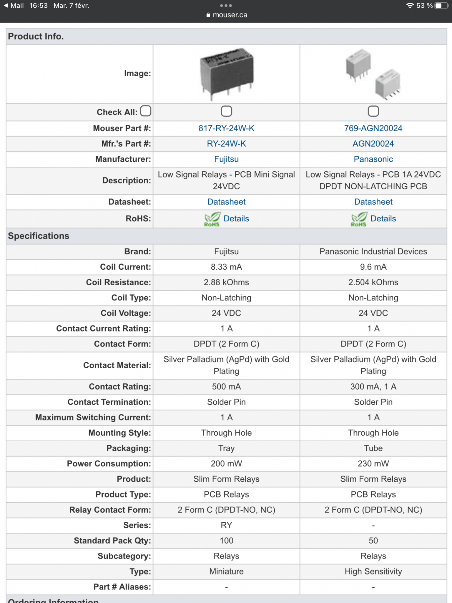

I’m having a hard time finding a relay that is equivalent. The Fujitsu RY-24W-K is out of stock.. I’ve found this Panasonic AGN20024 that seem compatible. But I’m not sure, so many parameters.
Edit: oups, didn’t saw they don’t have the same footprint. Back to research
