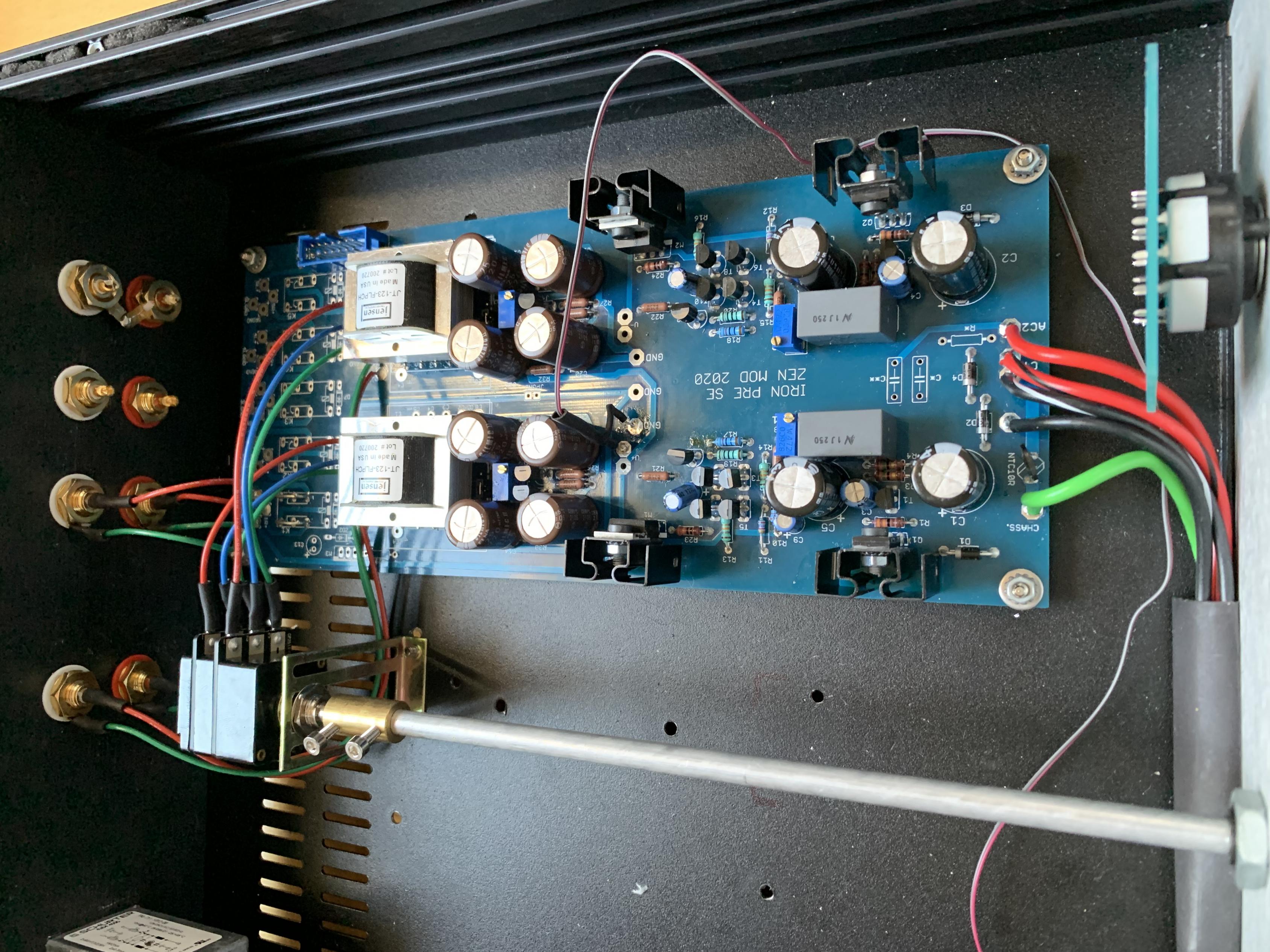

The parts arrived this morning and I replaced the dead BC556.
Checked it over again before turning it on and all values look good.
Now I am getting max 10v/-11v from each trim pot (DM at V+ GND and V- GND) cant get close to the 15v spec. The AC input voltage from transformer is about 39v when checking at AC1/CT/AC2.

decrease R8 and R9 to, say, 6K8
even if I'm surprised that you can't get 12V
anyway, decrease them
just in case , check that you have 5V across voltage references
Thanks Zen Mod,
6K8 was not enough on the positive rail. I ended up going down to 5k on both sides, Now both rails are good at +15v and -15v.
The DC offset didn't give any troubles and I was able to zero it on both channels.
Are there any other checks I should be making now?
Finished up the Iron pre yesterday with the 820R's and rest of the wiring in the temp chassis.
After passing the initial listen on the "test" system I moved it over to may main one, currently an F5.
It works, nothing exploded, and all the smoke stayed in! But there appears to be significant LF roll off when comparing to the ACP+ or B1K (apart form the LF it sounds very nice). I am guessing there is something similar to what codyt was experiencing in post #1263. I will have to look into where I could have created this issue with the transformer wiring. (please ignore the terrible temporary LED butchery)
