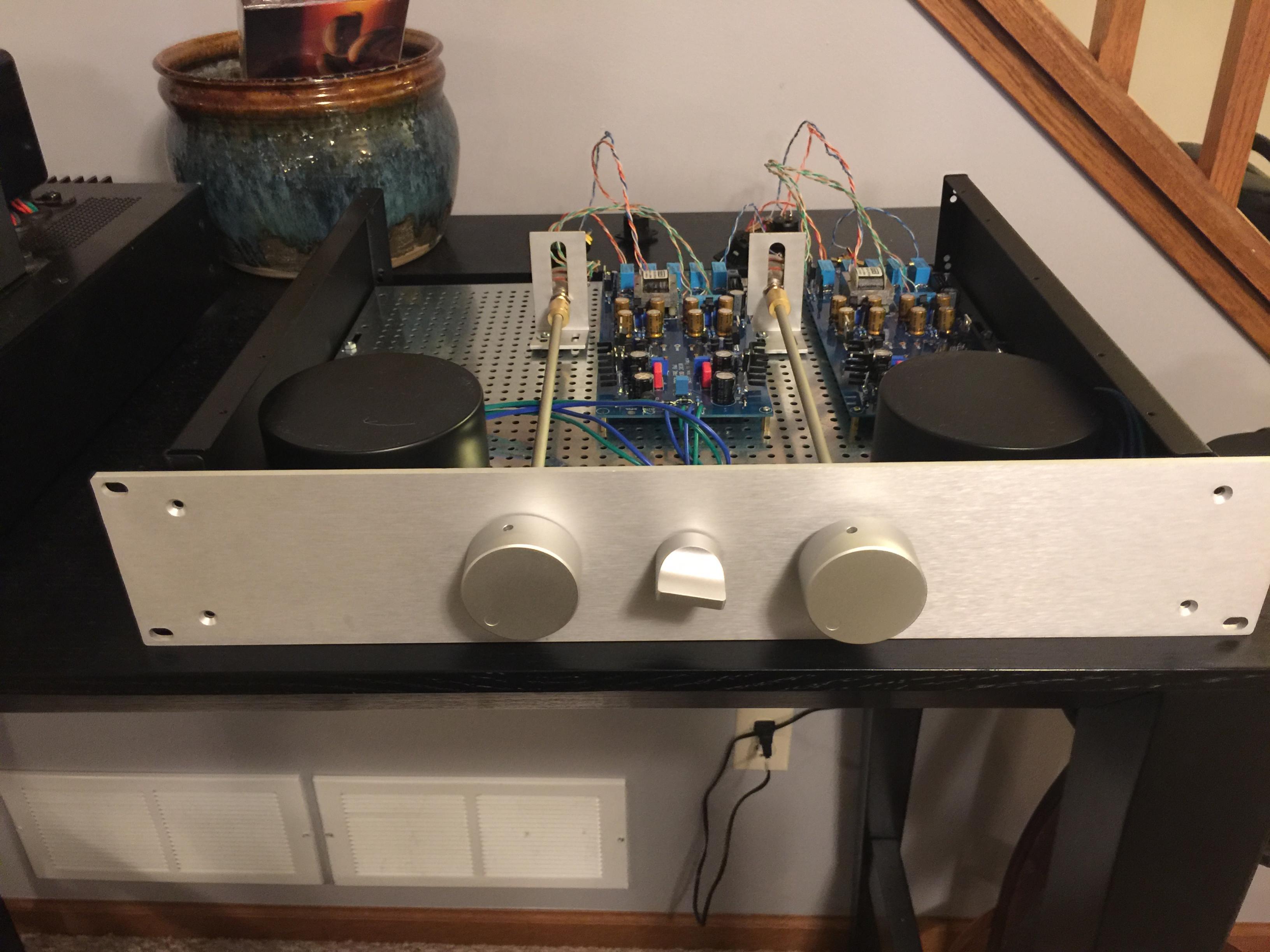

My indecision and lack of foresight is causing some delays.
- Ordered the wrong XLR jacks... I want jacks that mount on the inside of the back panel for ease of soldering / mounting and to keep I/O wires shortest. I accidentally ordered external mount.
- Didn't have a large enough stepped drill bit to drill holes for XLRs...
- Had to bore out the coupling for the pots / extensions. Pots are 1/4" shaft. I have 6mm rods, couplings and knobs...
- Had to make decision for front panel and twister... LEDs, no LEDs, Mute, no Mute... LED for Mute? Decided on LEDs and mute. Blue for Inputs and Red for Mute. I'll drill and install those last in case I change my mind (again)... :D
- Had to order tool, wire, and connectors for making ribbon cables. Ready-made ones I bought are too short. Running twisted wires and soldering point-to-point would most likely wind up causing me issues. :D
I still have to choose wire routing for mains / primaries. I should have room between riser and bottom panel. I'll shorten up the pot wiring and I/Os once have final positions. I may switch to some shielded wire for I/Os and pot wiring vs. re-purposed CAT-5. Thoughts?
Are there any tips for physically EMI shielding the mains / primary wires? Some kind of mesh? It seems many people use shielded I/O wiring to prevent noise "getting in", but I have not seen any examples of trying to shield the "source" of the noise i.e. the actual mains / primaries? Is it effective?

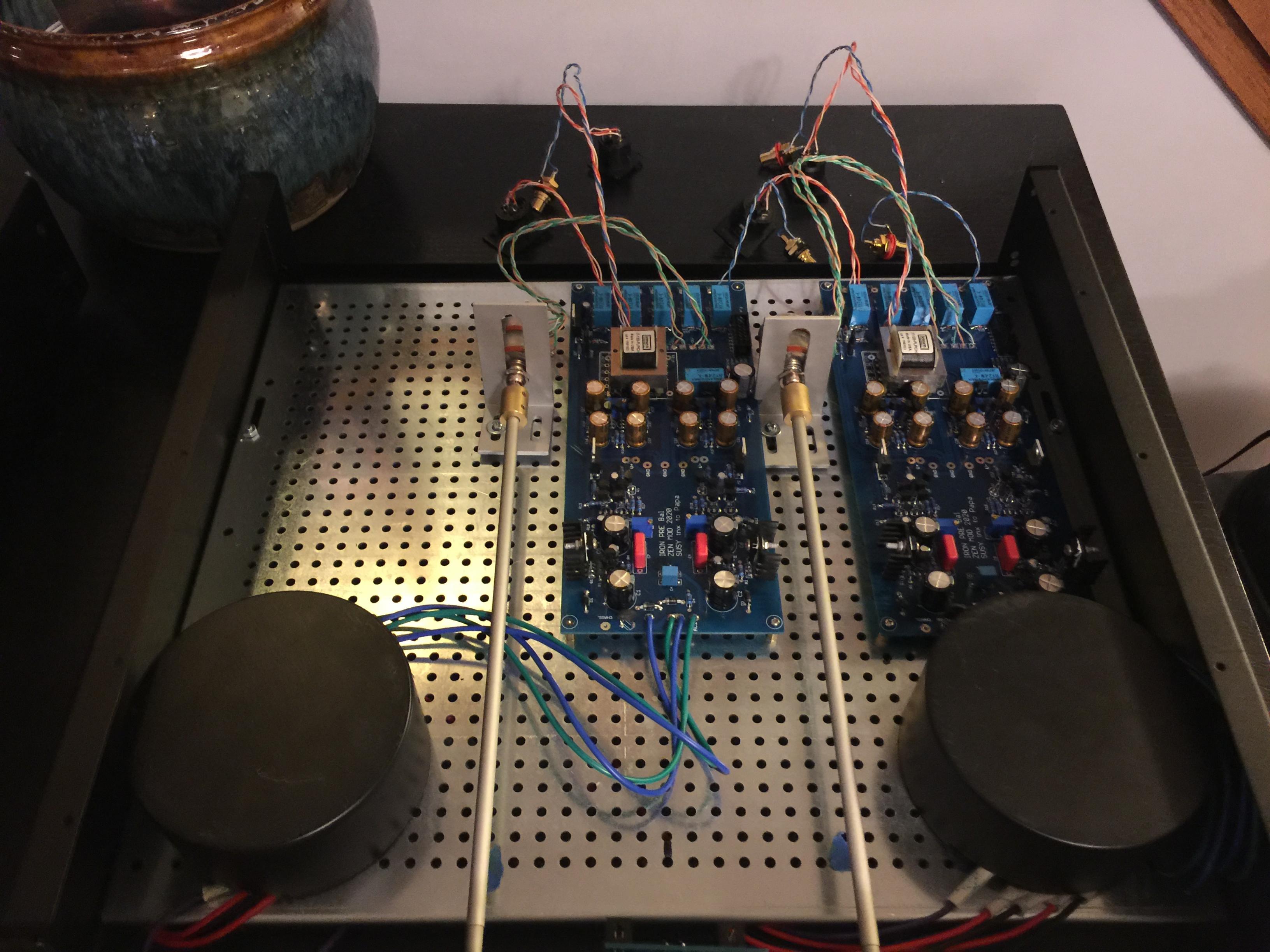

Some early porn. It's starting to look like a proper piece of gear.
Right now, having no extenders yet ( want ones from partsconnexion and are out of stock) so just twisted wire to selector and volume. I initially left the transformer and boards unmounted with extra long wires. (fixed now)
No matter how I moved things around and even with longer wires, this preamp is dead silent. Nothing. Period. Yours being balanced should be even more immune I think?

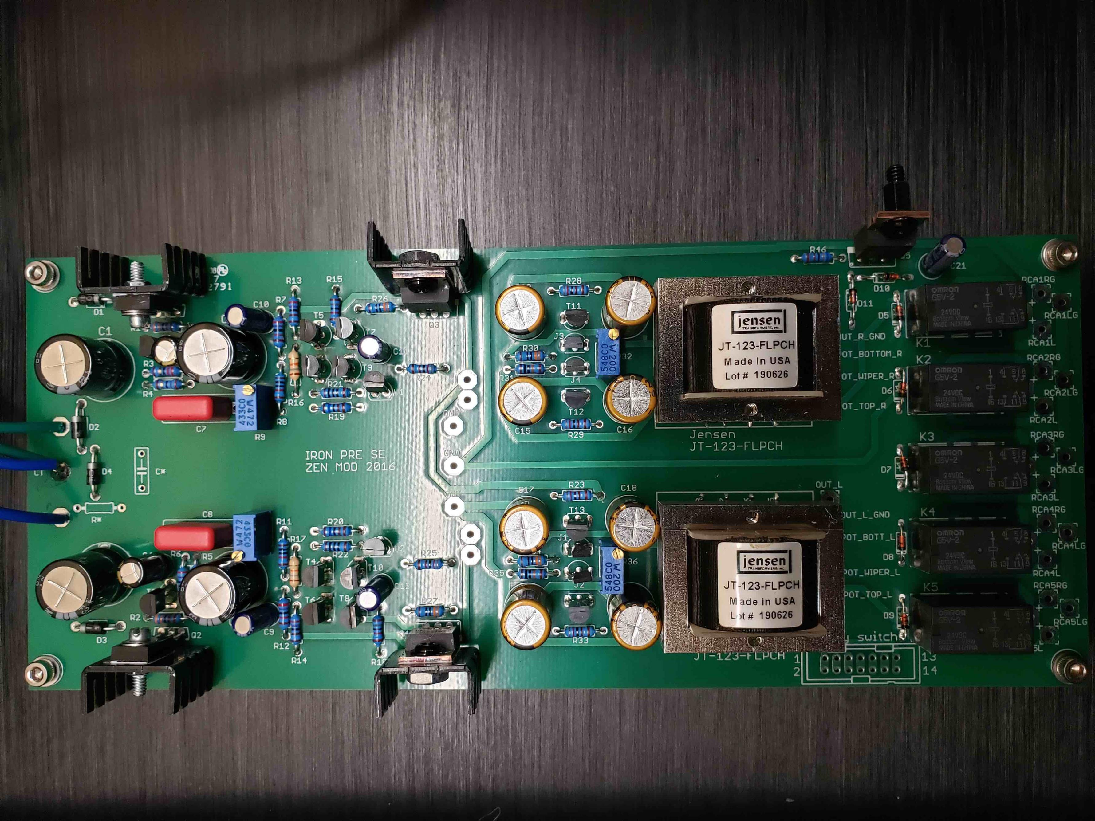

no V+, V-
Board is a 2016. Please see pic.
I am using a 2 secondary (18v each) transformer, wired in series. I read about AC 36V from AC1 - AC2 and about DC 47V after the diodes.
Not everything is wired up. I wanted to check power supply part first. The relay power is ~23.8V (Across D10, D11) . Is that correct ?
Neither V+ to ground (measures 0.7V) nor V- to ground (measures -1.7V) move when I turn pots R9/R10 (Tried limit to limit).
Am I missing a ground? What was the 24 hour wire ? I tried searching for that reply, but didn't find it. I thought better to ask first.

check parts positioning once more
voltages at BD transistor pins?
my guess is that you swapped BD transistor positions
Thank you ZM. I had the IRFs swapped. At +/- 15v now. I will list the previous measurements, since I did it already.
Do you recommend checking anything else because of this error?
The best I can tell, parts positioning is correct. I checked all transistors again (I had first checked all the BD, BC. While I was writing this, I realized I had not checked IRF. That was the issue).
Whatever error I made seems symmetric - i.e. same on both halves
Voltages wrt ground on BD pins (measured left to right on board):
BD139
1.4, 23.3, 2
BD140
-3, -23.2, -2.4
Voltage drops (V)
R1 21.1
R3 0.6
R2 20
R6 0.6

Looks like you are there, time to put tunes to it. If no chassis yet, get a pizza board, piece of wire with alligators (24 hour wire).
I also have 2016 boards, BTW. No jumpers for 12 dB, but Zenmods told how to slice and dice to get one few posts back. I'm finding 6 to be enough mostly.
