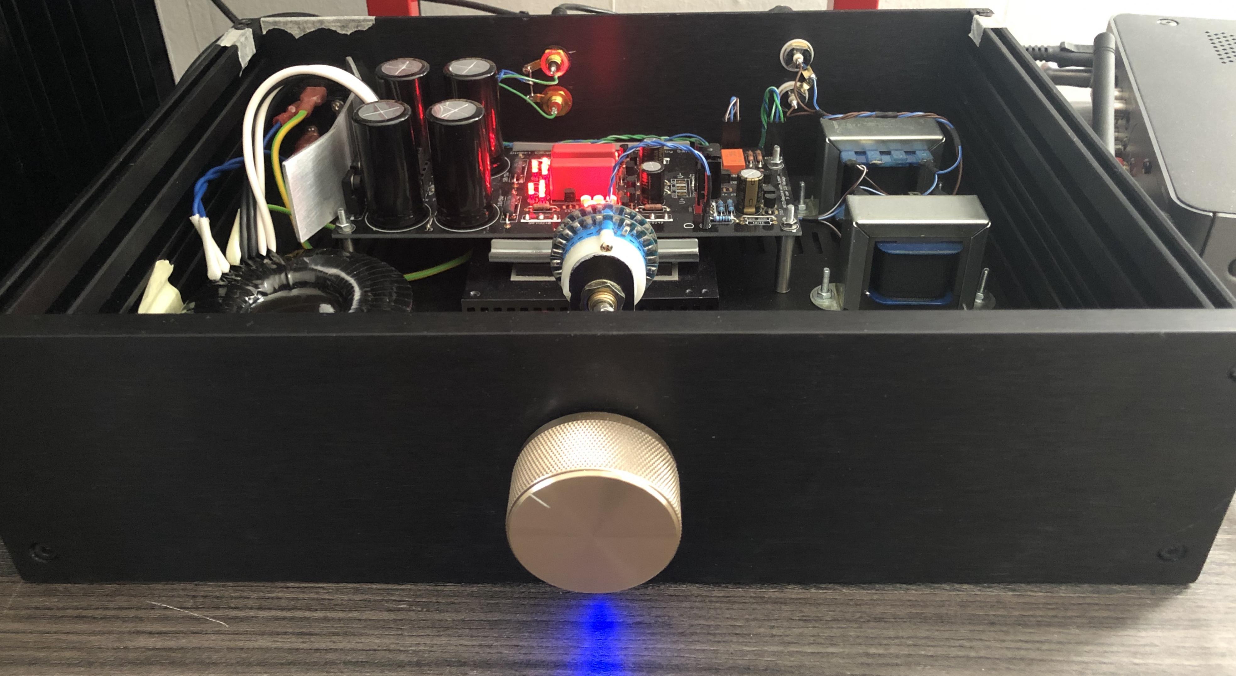

In effort to speed finish of Iron pre, I "borrowed" the tubecad on/off I had for the DC3G build. Havent tapped its heatsink yet so it can wait for tubecad to restock. It doesnt use an extender b/c of transformer position. Once fuse holder arrives I can add it and shorten/neaten the transformer wiring.
Did briefly take upstairs for whirl on vinyl rig. Very nice. One thing that is clear about this preamp, it has an ability to really separate sounds and instruments really, really well.

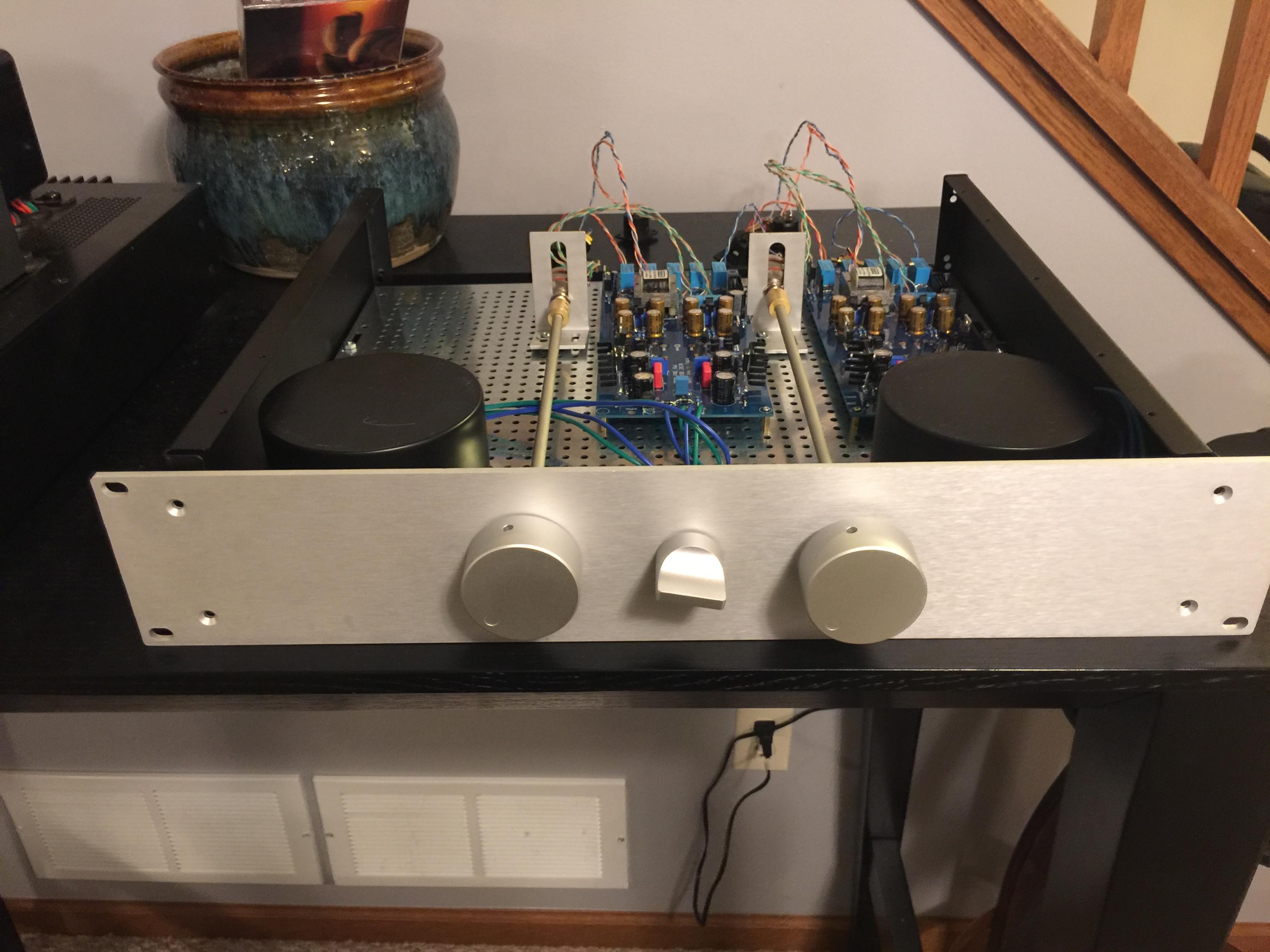

Getting ready to drill some holes and get the Iron-Pre Balanced into a chassis. I was / am a big sissy, and I could not decide on dual pots or not. I am going with dual pots.
Simple question as I finalize layout and wiring. This is my first balanced pre-amp build with two transformers. Is is wise to have a fuse on each of the neutral legs of the primaries similar to what was advised for my power amplifier / dual mono builds? Based on what I've read and picked up, I think the answer is yes, but I want to confirm. I forgot to order fuse holders... DOH!
one common fuse is good for two eenyweenies
regular calc - if they're 2x20VA=40VA............/120V=250mA will do the job

DCB1 (close enough to write here?) now playing with some iron haven’t got time for critical listening yet. Gain should be 14db. Thanks Chromenuts and Zen Mod for tips. Have to rebuild couple things if I like it enough
well, I wasn't clear regarding that, sorry ;
I'm leaving matter of fuse positioning to comply with your local rulez
in my neck of wood, single phase connection (wall/cable) is not oriented, and all gadgets are made according to that (of course that double fused and 2-pole switching is best practice)
"only" 3-phase wall/cable connectors are oriented
both for work and GodForbid!!
Is having the Neutral fused legal in your City/County/State?

Based on 2 x 50VA = 100VA / 120V => ~1A single fuse on the hot side should be just dandy.
BTW - No one should take this post as guidance re: AC wiring... or really anything for that matter.
My indecision and lack of foresight is causing some delays.
- Ordered the wrong XLR jacks... I want jacks that mount on the inside of the back panel for ease of soldering / mounting and to keep I/O wires shortest. I accidentally ordered external mount.
- Didn't have a large enough stepped drill bit to drill holes for XLRs...
- Had to bore out the coupling for the pots / extensions. Pots are 1/4" shaft. I have 6mm rods, couplings and knobs...
- Had to make decision for front panel and twister... LEDs, no LEDs, Mute, no Mute... LED for Mute? Decided on LEDs and mute. Blue for Inputs and Red for Mute. I'll drill and install those last in case I change my mind (again)...
- Had to order tool, wire, and connectors for making ribbon cables. Ready-made ones I bought are too short. Running twisted wires and soldering point-to-point would most likely wind up causing me issues.
I still have to choose wire routing for mains / primaries. I should have room between riser and bottom panel. I'll shorten up the pot wiring and I/Os once have final positions. I may switch to some shielded wire for I/Os and pot wiring vs. re-purposed CAT-5. Thoughts?
Are there any tips for physically EMI shielding the mains / primary wires? Some kind of mesh? It seems many people use shielded I/O wiring to prevent noise "getting in", but I have not seen any examples of trying to shield the "source" of the noise i.e. the actual mains / primaries? Is it effective?
More goodies to finish up should arrive through the week Can't wait.
Some early porn. It's starting to look like a proper piece of gear.
