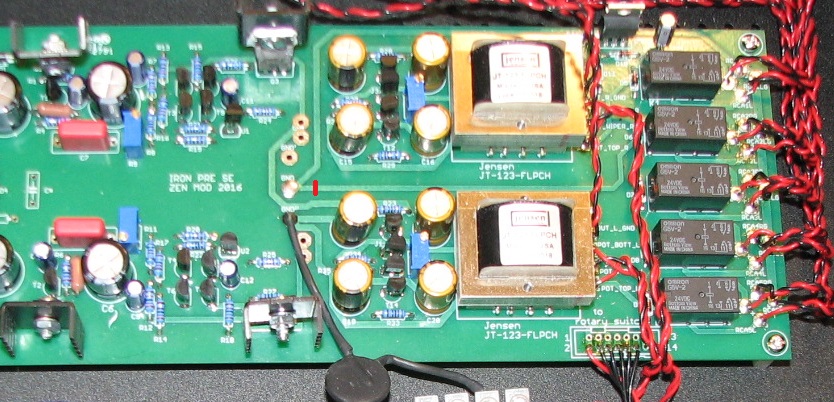

reason is that you bundled all those wires together, there must be crosstalk, especially with unused inputs routed to GND (muted)
now, you have solution - either cut GND trace which is connected to relays to mute unused inputs , or rotate pcb 90deg CCW, to be oriented as I planned it to be - to have properly short wires from RCAs to input pads, so being properly separated
I prefer rotation, though, if you insist - I can see later which trace needs cutting, but be aware that I can't be sure that it will cure crosstalk 100%

take in account that signal gnd for inputs is one trace , going to central GND point, while muting gnd trace is second, different trace going to central GND point, and these two are almost half pcb width appart
crosstalk is phenomenon easiest explained as one antenna talking to second one
you made looong input wires, all bundled together, thus enormously increasing physical dimensions of emitting and receiving antennas
practically - one antenna is starting at source RCA, including interconnects, then preamp input RCA, then wiring from them to pcb, then all signal traces on pcb, including GND traces
and , if Rout of active source is highish, that input is even more prone to crosstalk, Rout of source acting as I/V conversion impedance
you said you have Samsung and Dragonfly; first one is certainly drek, regarding Rout (I have one, so...) while second one is small enough that I can't count too much on it's Cojones
so ......... hope you get it now

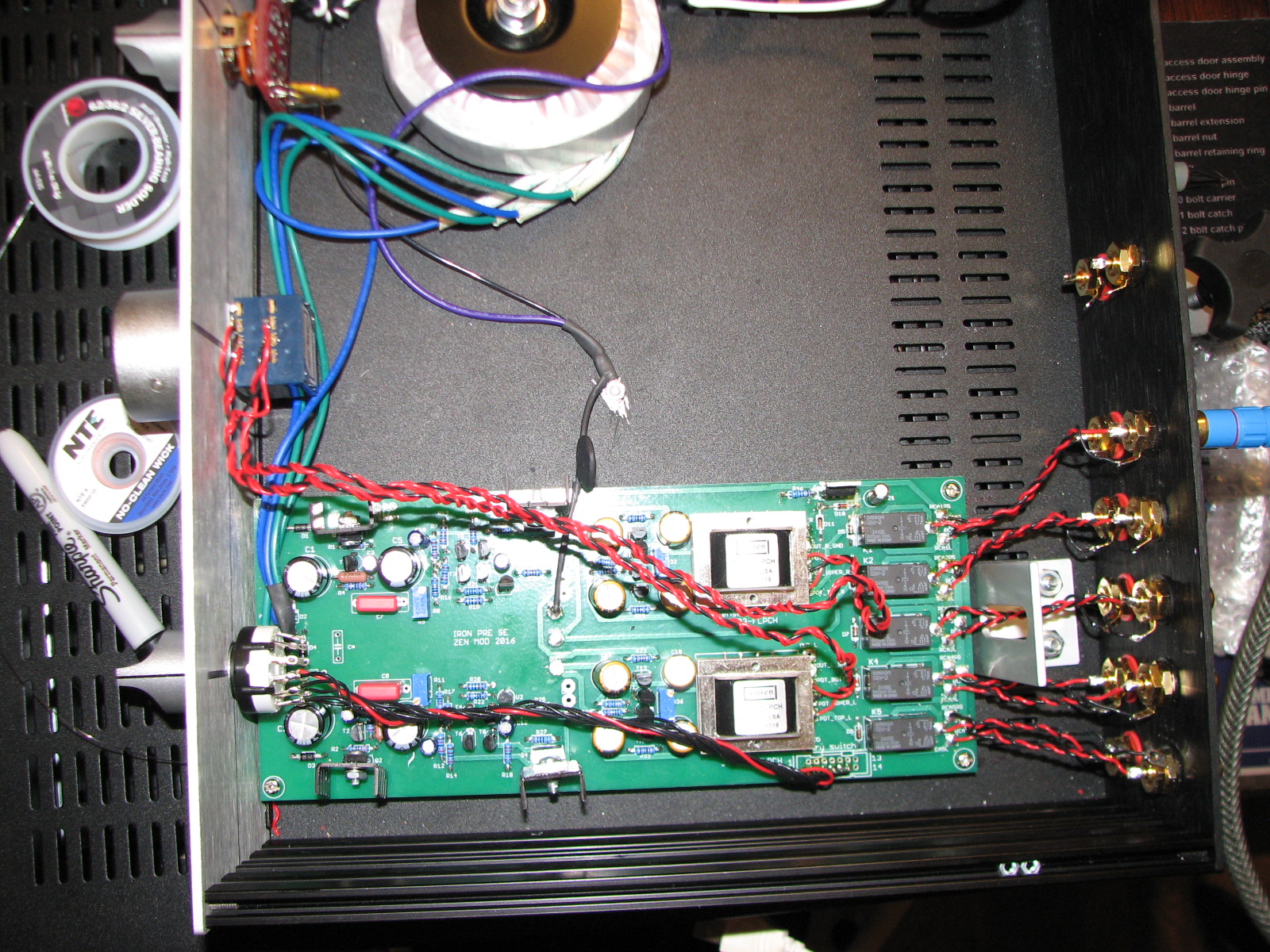

Ok, total rewire and board reorientation begins. Should be just in time for extenders to arrive. The existing wires on RCA jacks will be left in place on board end, but removed from said jacks, wires shortend and reattached to the RCA jacks as board reorient requires.
If that doesnt solve it, will try trace cut.

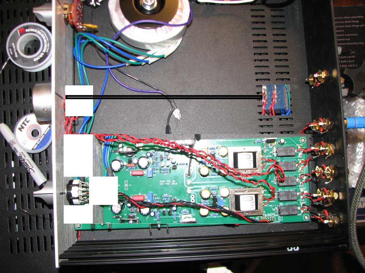

OK, a little rewiring, as far as can get without extension kits to move selector and volume pot to rear location.
I need a wider box to use the layout I want with front plate switching the way I wanted it. When Iron pre hits store, that build will use a wider one
for sure.
I dont like where selector ends up, to close to RCA jacks, but front panel already drilled.
Oh well, at least board closer to correct orientation. Getting ready to try it as is for now, more after extenders get here. The long lines to volume pot are still problem, (until extenders arrive) Then there is selector pot. Dont know if it is more problematic as they only switch relays?
That,s it for now.

regarding selector switch, as you said - it is just energizing relays, so you can situate it in next room , as far as I'm concerned
regarding that L bracket, shown in between pcb and RCAs, I'm really not getting purpose of that
