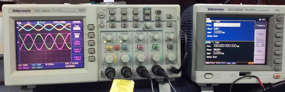

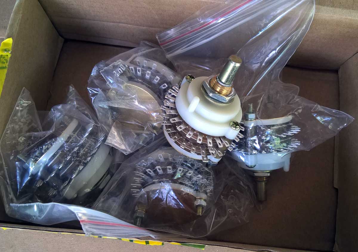

zero specimen of Balanced AVC finished
thorough technical testing day after tomorrow
(rotary switches stuck in Customs for two weeks already)
got them ...... (switches) ...... finally , after 18 days in Custom
each will get proper treatment with vaseline
just inside

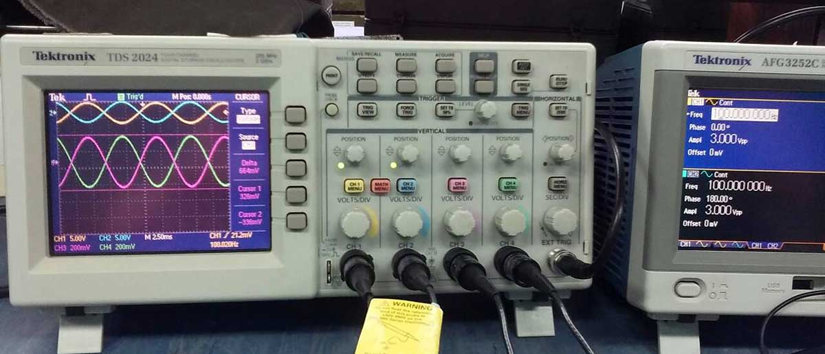

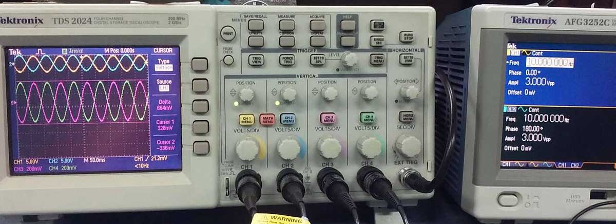

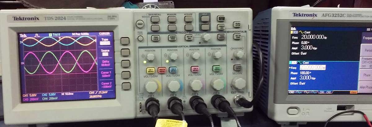

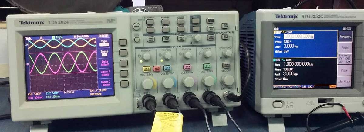

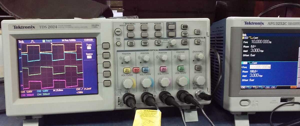

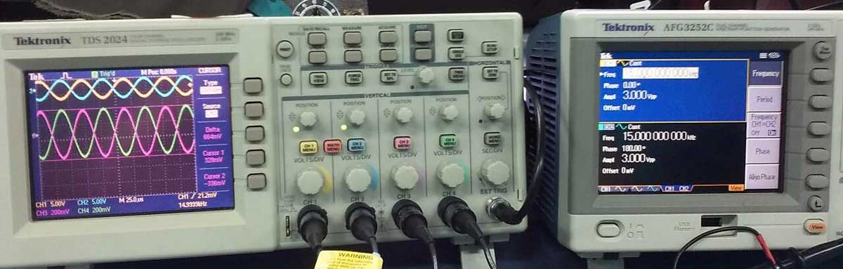

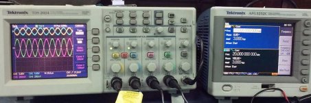

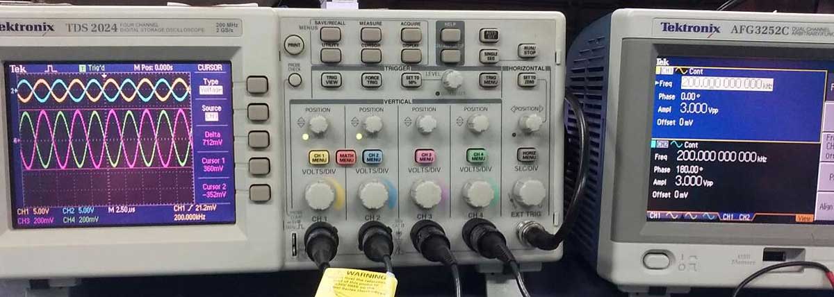

Looks fantastic ZM and constant level across all frequencies! What does a square wave look like?
good enough
I didn't posted sweeps and squares simply .....from two reasons :
- Rout of generator is somewhat wimpier than needed , so will wait** for that measurements with my own gear , where Rout of gen is confirmed and trusted ;also probes (ultragigamegaexpensive) are having some incompatibility with calibration at used levels (my friend working in service center for veeeeery high freq. gear)
-sweeps are just compressed tests already shown on pics
anyway , this pic will say enough - you can see in upper traces that gene output is showing some sweat and tears , driving 10H per coil
whatever , thingie is , as always must be the case , optimized for my Diamond Buffer ....... and "even" Toshiba complementary JFet buffer is driving it with ease
so , to reach desired plateau of performance , I didn't go to make Swiss knife AVC , rather entire package - buffer in front of AVC , as pretty special Swiss knife
(and , as always , proof is in da pudding 🙂 )
**edit - no need to wait - I already measured SE ones at my place and conducted thorough listening tests ...... as Bal AVC is "nothing more" than two SE coils on one core .... things are more than easy and logical to decipher
