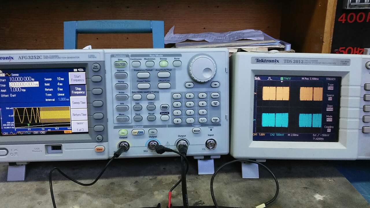

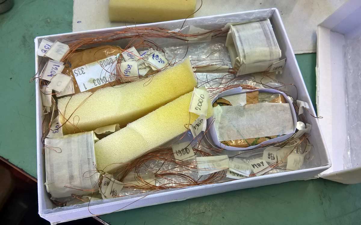

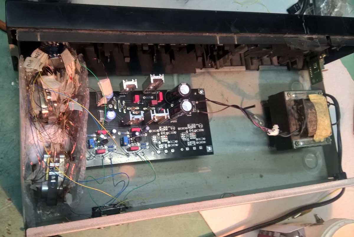

after waiting my first-choice Winder guy - 2 months ( and some) for nothing , I sent my precious Metglas cores to different Winder guy (this time having some luck in fact that actual guy is friend of mine) ..... today he sent me viber pics of measurements of first specimen of SE AVC , conducted with some modernvodoogizmo digital Tektronix gear
results are veeery promising , these days I'll conduct some listening tests (with not just my pair of venerable ears, but also with few younger ones) and , in meantime , we'll work on logistic for Bal AVC

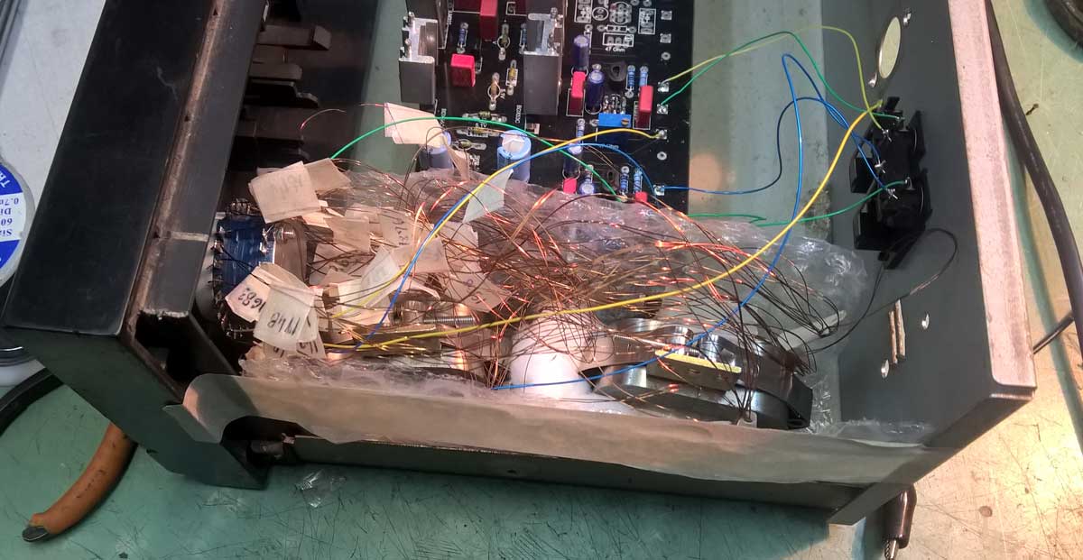

tired as Mad Hatter after two shifts ;

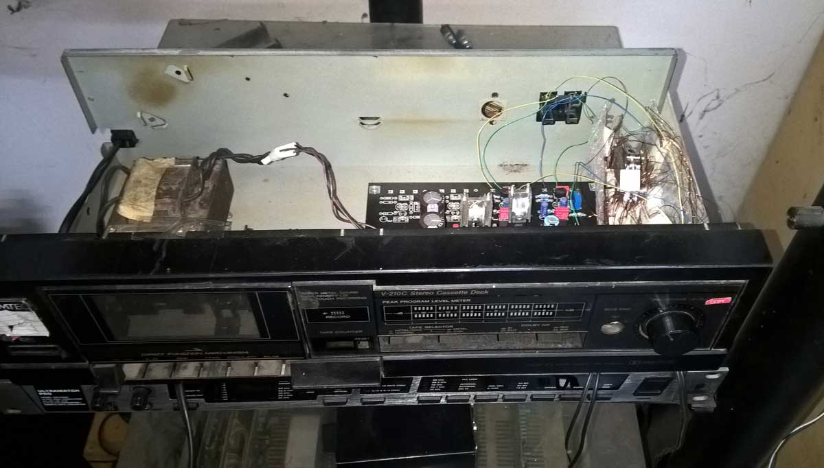

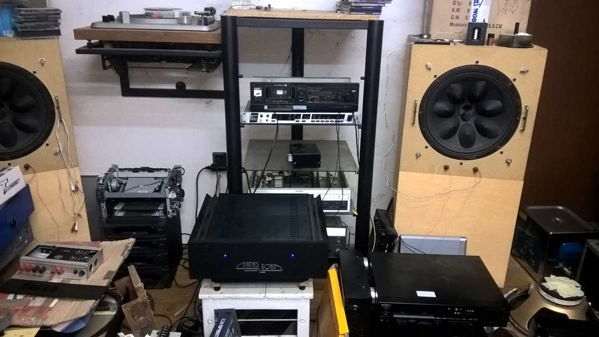

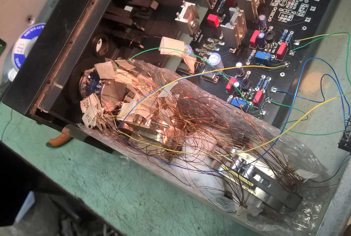

it's certainly more complicated and tiresome puttin' zero series specimens of SE AVC in test bed** , than it will be placing them on final pcb cradle , as intended
anyway , all efforts are granted , it measures and it sings spooky , even in quick line-up , with oldie Sony CD as source
tomorrow it goes to second pair of ears , less biased , and to direct comparison with Intact Audio (two-switch iteration) AVC - which is , incidentally,equipped with exactly same buffer combo.
good day it was ... and still is 🙂
** cassette deck case already known from start of the thread

just to inform ya that SE AVC passed all listening tests ...... both critical and non-critical
now working on decent bobbins (did I tell that original ones are looking as one size bigger ? ....... so that's mentioned logistic for Bal AVC , and will be implemented for both SE and Bal iterations
also thinking about making fixture for vacuum varnishing them after assembly
why not ......... :clown:

-regular size case for preamp (W438) , so mains xformer mount away of AVCs
-placement in system - put preamp normally away from big mains xformers (amplifier usually)
if you take a look at prototype cassette deck case , mains xformer is on one side , while AVCs are on the other ....... no hum, no buzz , even with case not connected to safety GND ( choice reserved only for Old farts , as I am ...... and even for them - just when prototype is in question)
with proper toroid (as we usually all use , not big chunk EI as I used in prototype) , danger of buzz is even smaller and requirements for placement are less critical

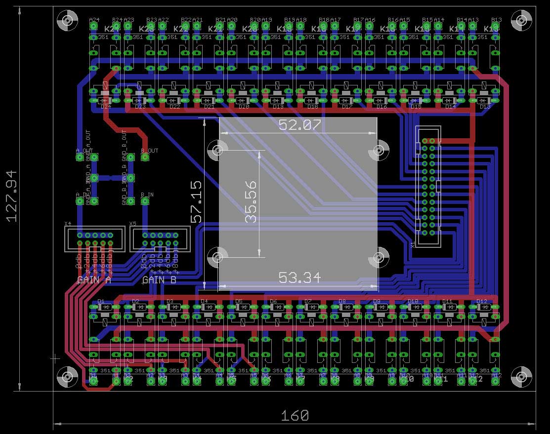

one of these for stereo SE (pcb being in sandwich between two Irons)
and two of these for stereo Bal (one Iron on top of pcb)
yup milimeters

As I might play around with a case before getting pcb´s, could you comment about the hight of the AVC sandwich? It is fixed than in position via the PCB mounting screws, right?
Maybe i still start with a ordinary pot and the Jensens, but case wants to be big enough for AVC upgrade.
tnx
thinking of 2HE cases and variations of real space in them ........ :
-80mm of height in case should be real tight
-85mm of height in case should be plenty
that speaking of SE iteration ; for Bal count on half of that
or just use 3HE case , so you can ignore that issue
