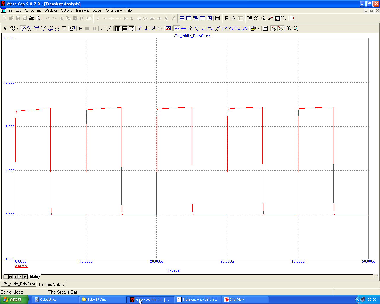

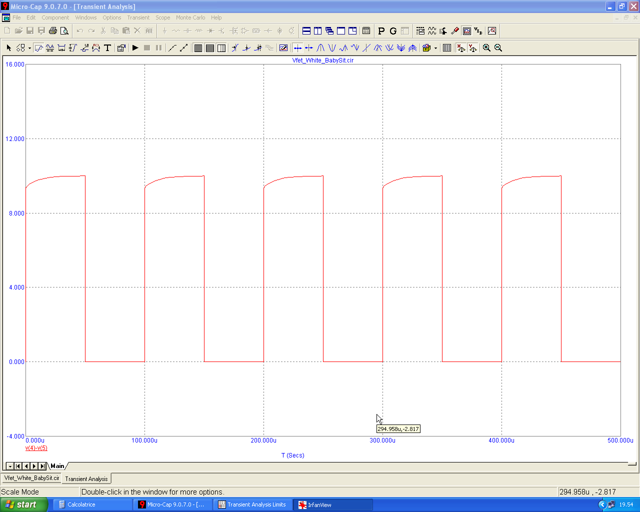

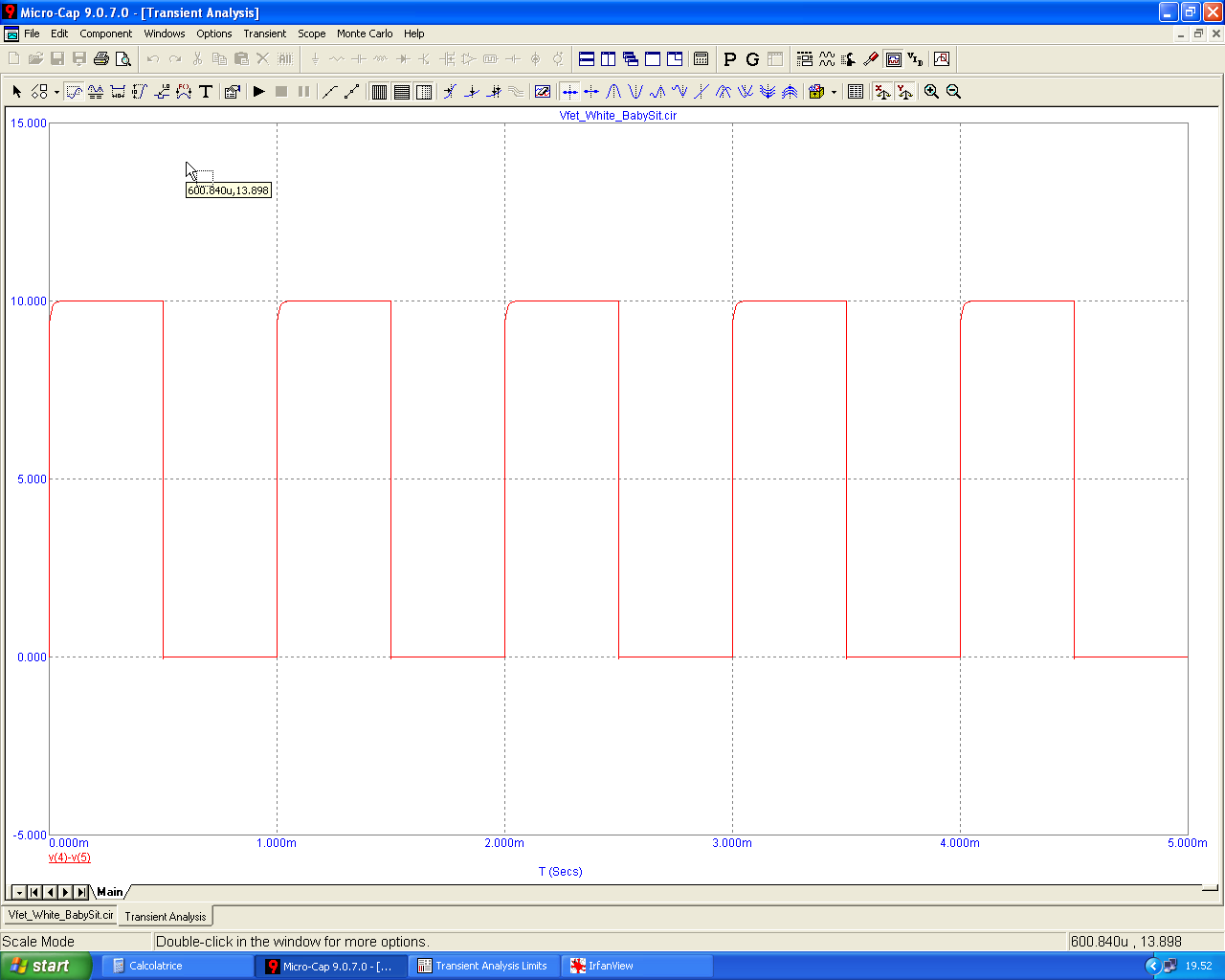

Hi, today i add other microcap simulator results.
Square wave at 10, 1k, 10k, 100kHz.

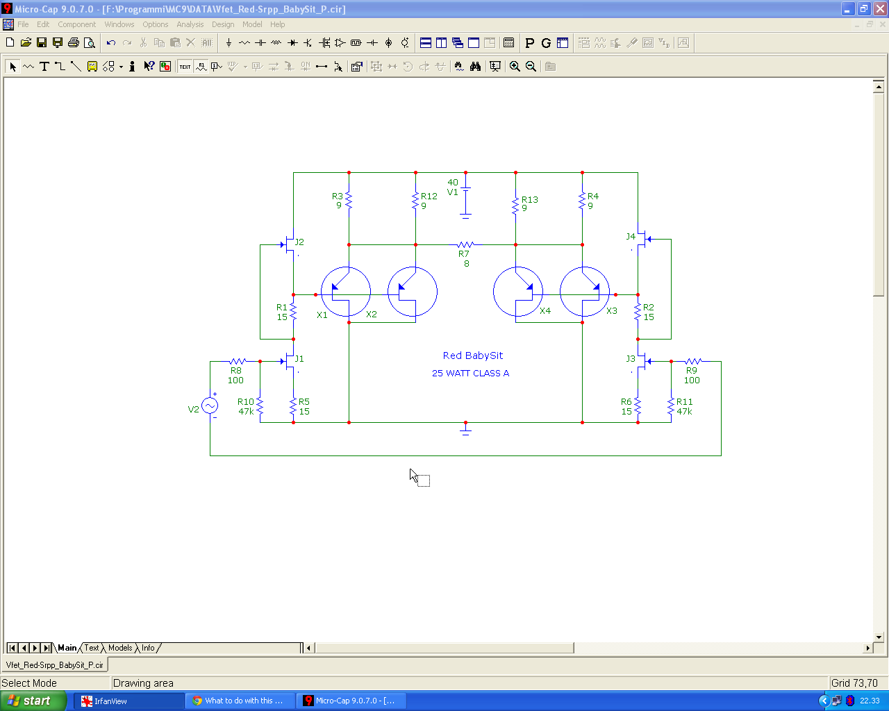

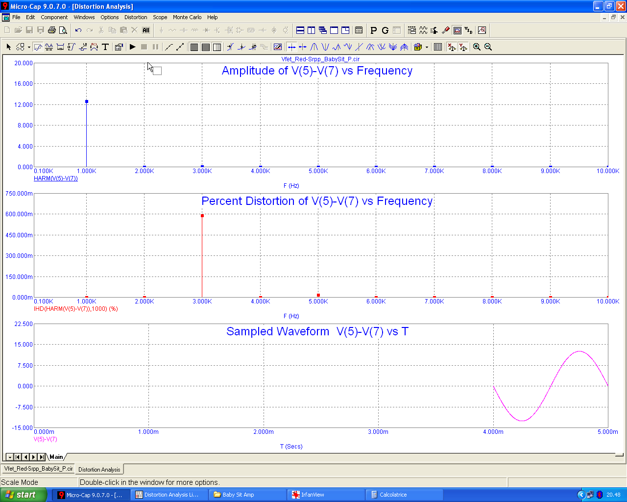

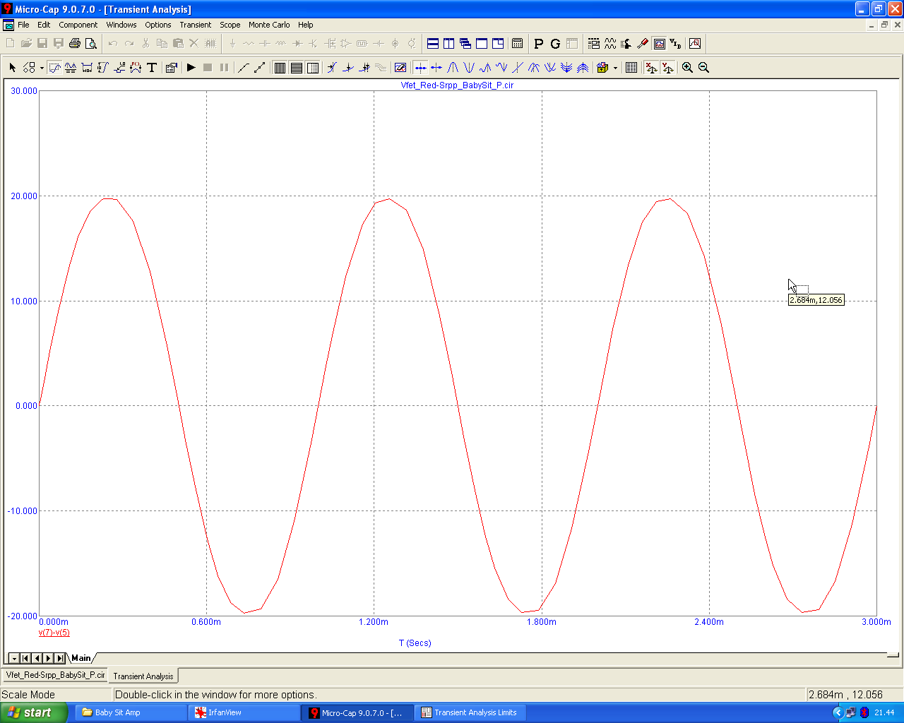

The RED Version
Now I would like to present an enhanced version of this circuit.
I have called it "RED" because of the better performance as the Ferrari that has a more powerful engine and especially a high power consumption. 😡
Maybe I overdid it, maybe it's more fair to compare it to a Fiat 500 Turbo.
This scheme as the previous one does not use GNFB and its performance are true performance. The scheme is very simple but the selection of the components must be very strict.
Please find attached some images taken with the simulator.
Others will follow after.

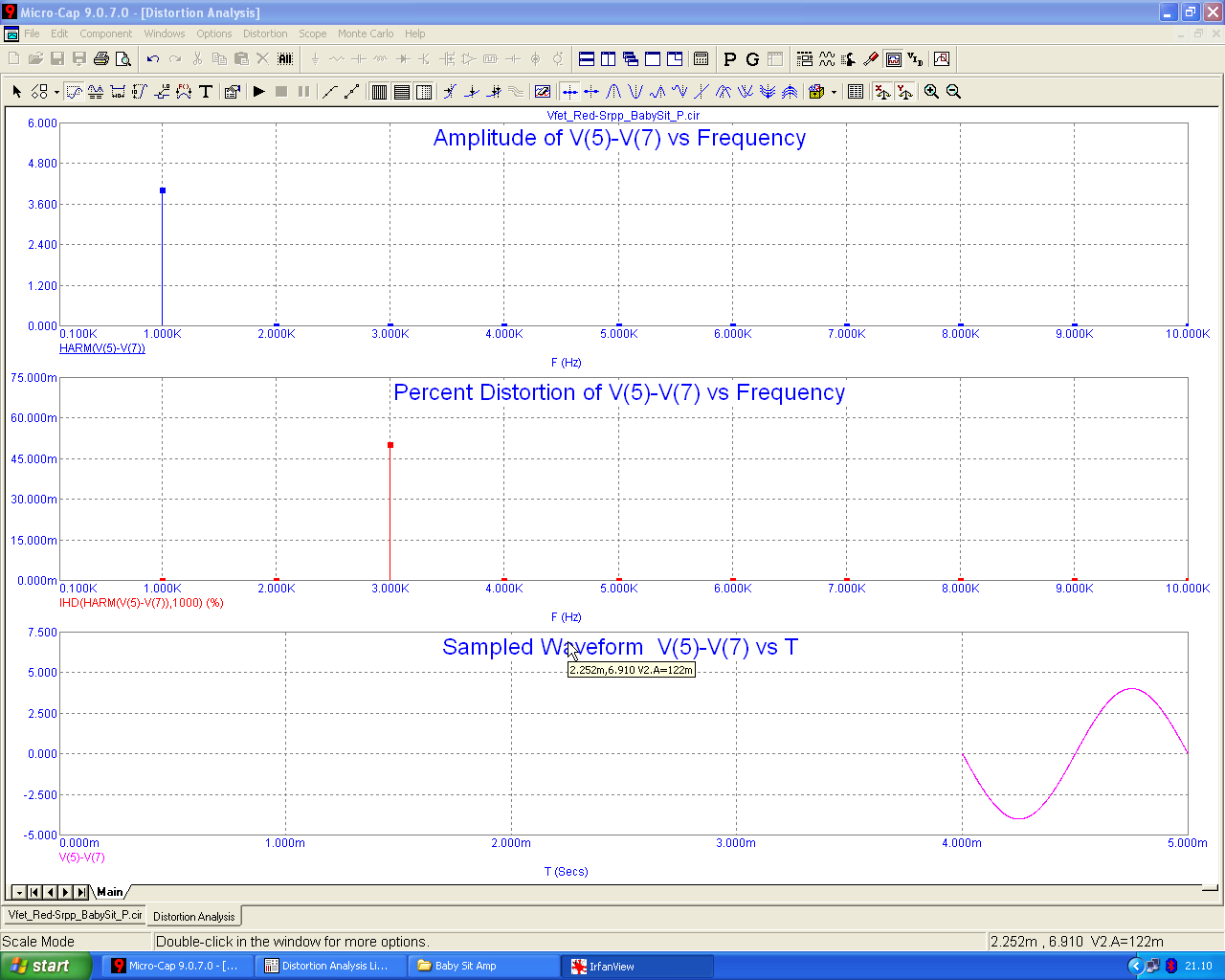

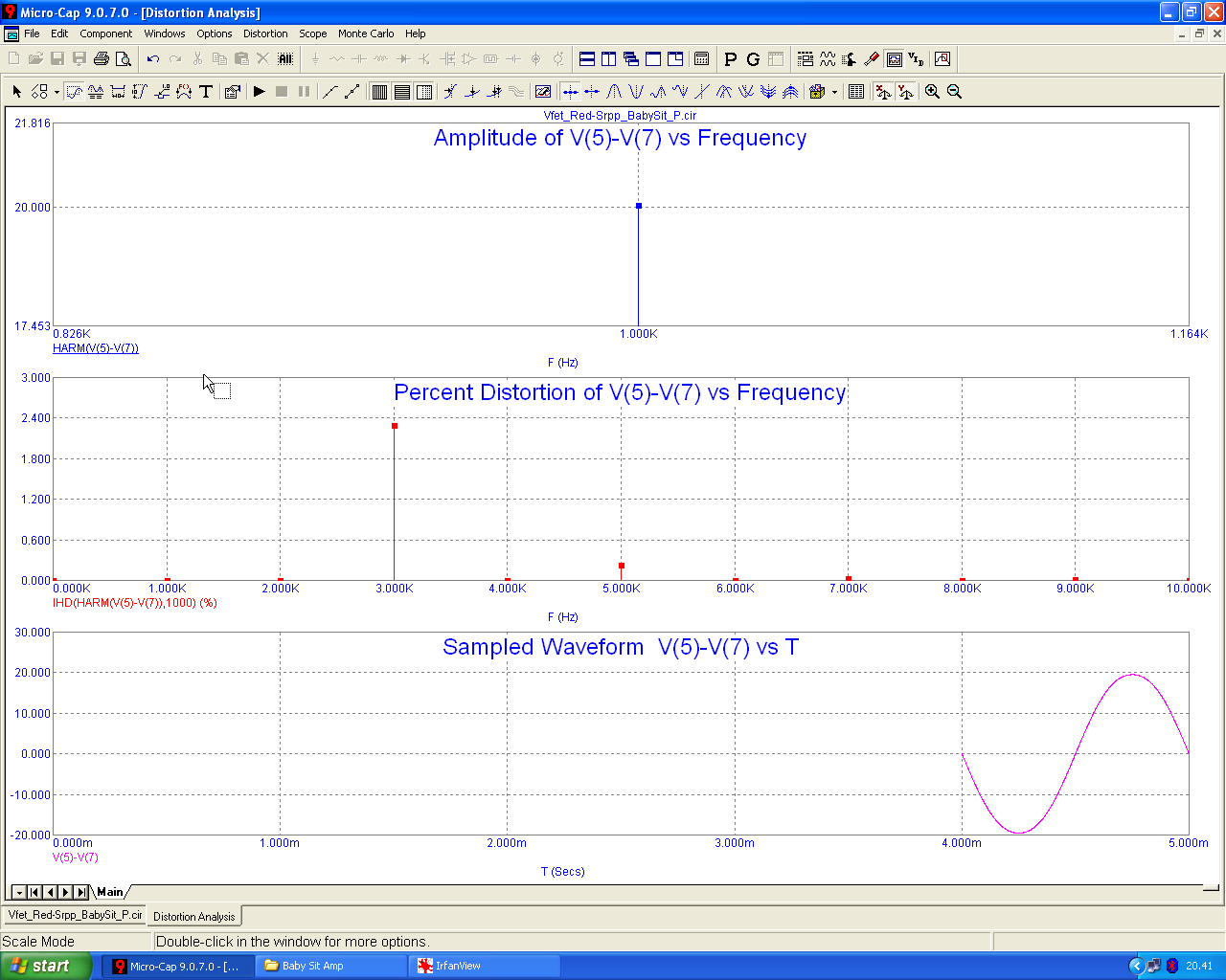

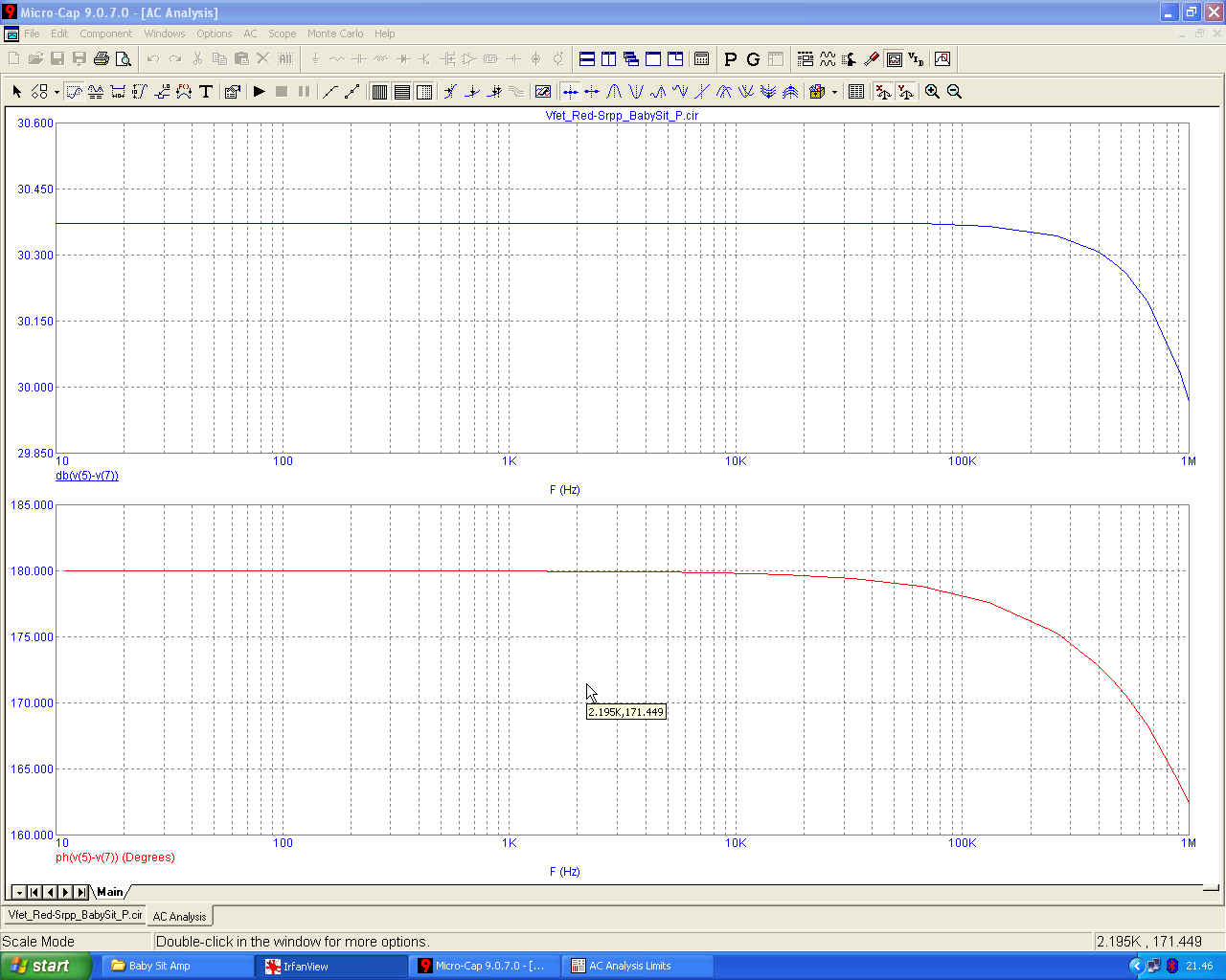

I am attaching more images relating to measures of distortion of the Red version to:
Notes: Because I realized that in the model of Vfet, the author did not consider the parasitic capacitances of the component, please You do not consider all the previous posted measures relating to AC and Square Wave analysis. I'm sorry.
For the 2SJ28 I expect compared to a 2SJ50 as an input capacitance slightly smaller than that or approximately equal and an output capacitance equal or slightly greater to that.
Have any of you has a better idea?

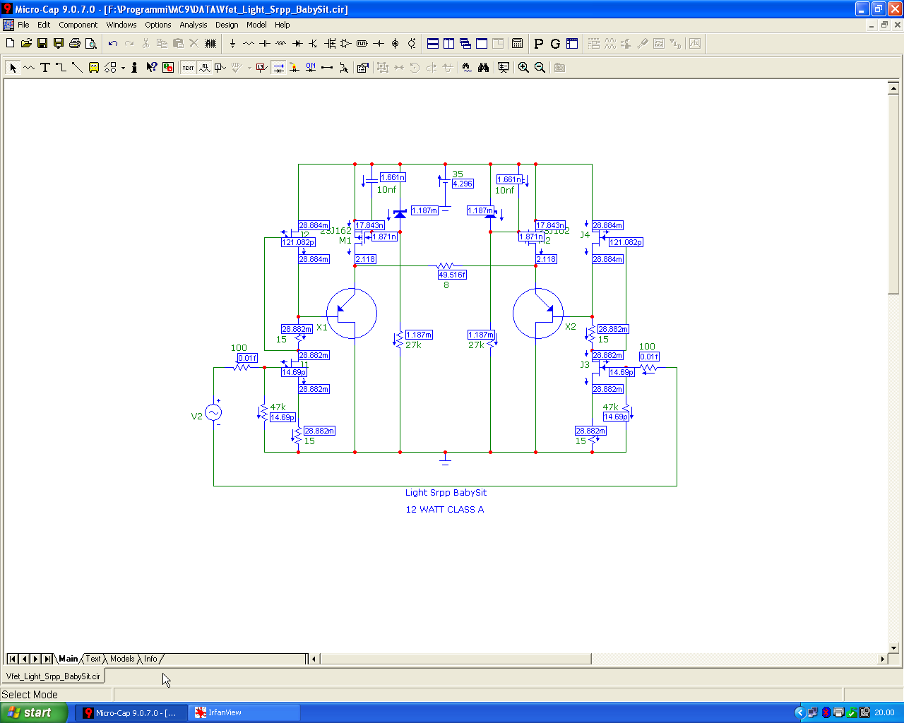

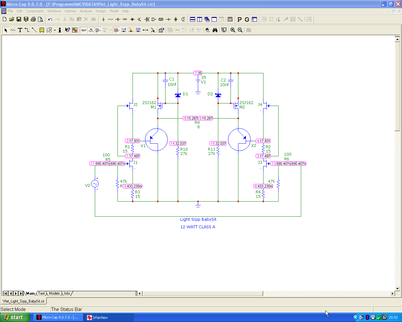

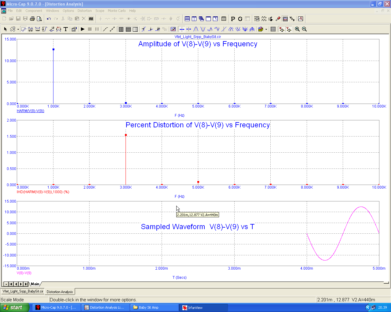

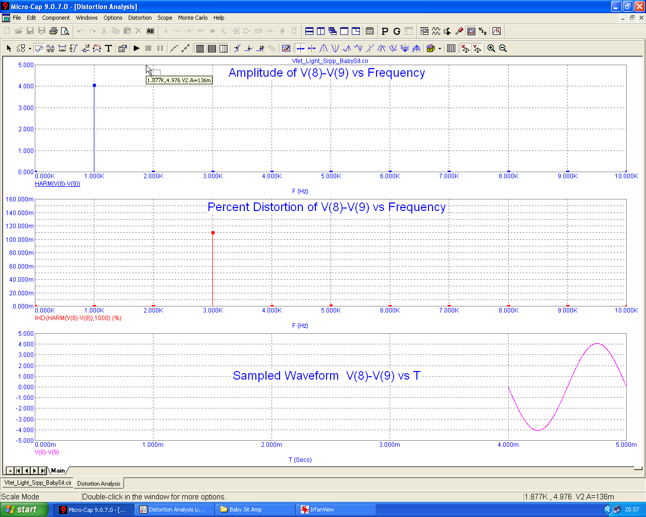

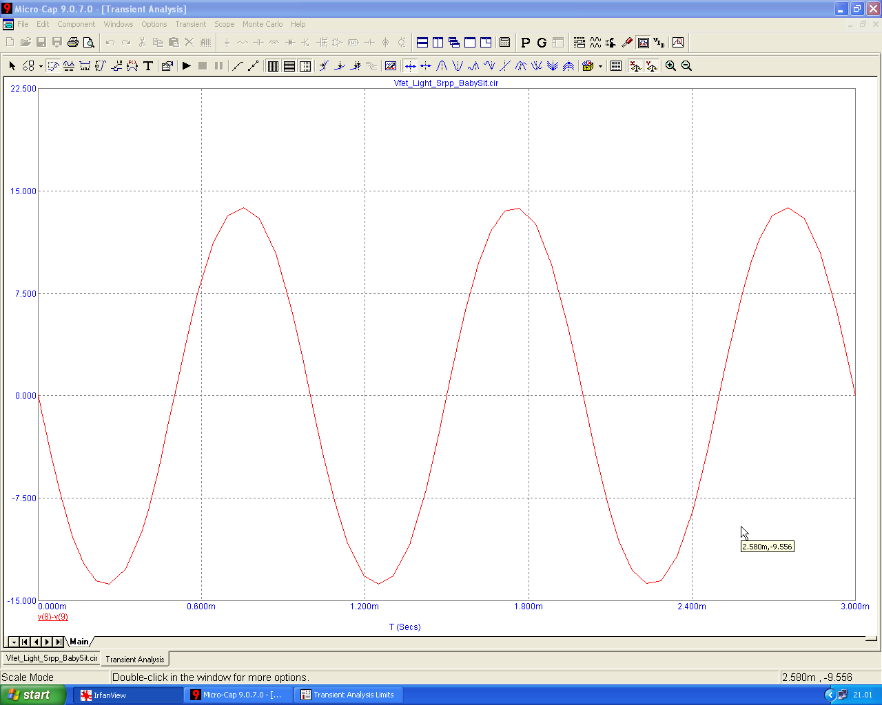

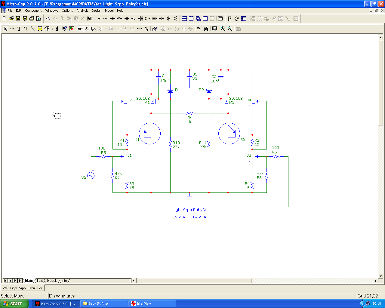

The Light Version
As promised, today I show the final circuit of a number of iterations, which, in my opinion, is the best compromise between conflicting requirements: low power dissipated by Vfet, higher power output, lower distortion.
The input circuit is an high current SRPP (approximately 28 mA) that makes use of 2N4392 type JFET. For the function of CCS I used the famous Hitachi 2SJ162.
Compared to the first version (the White) improvements have been tangible:
Final Note: not necessarily the sound of this latter circuit will be better than first.

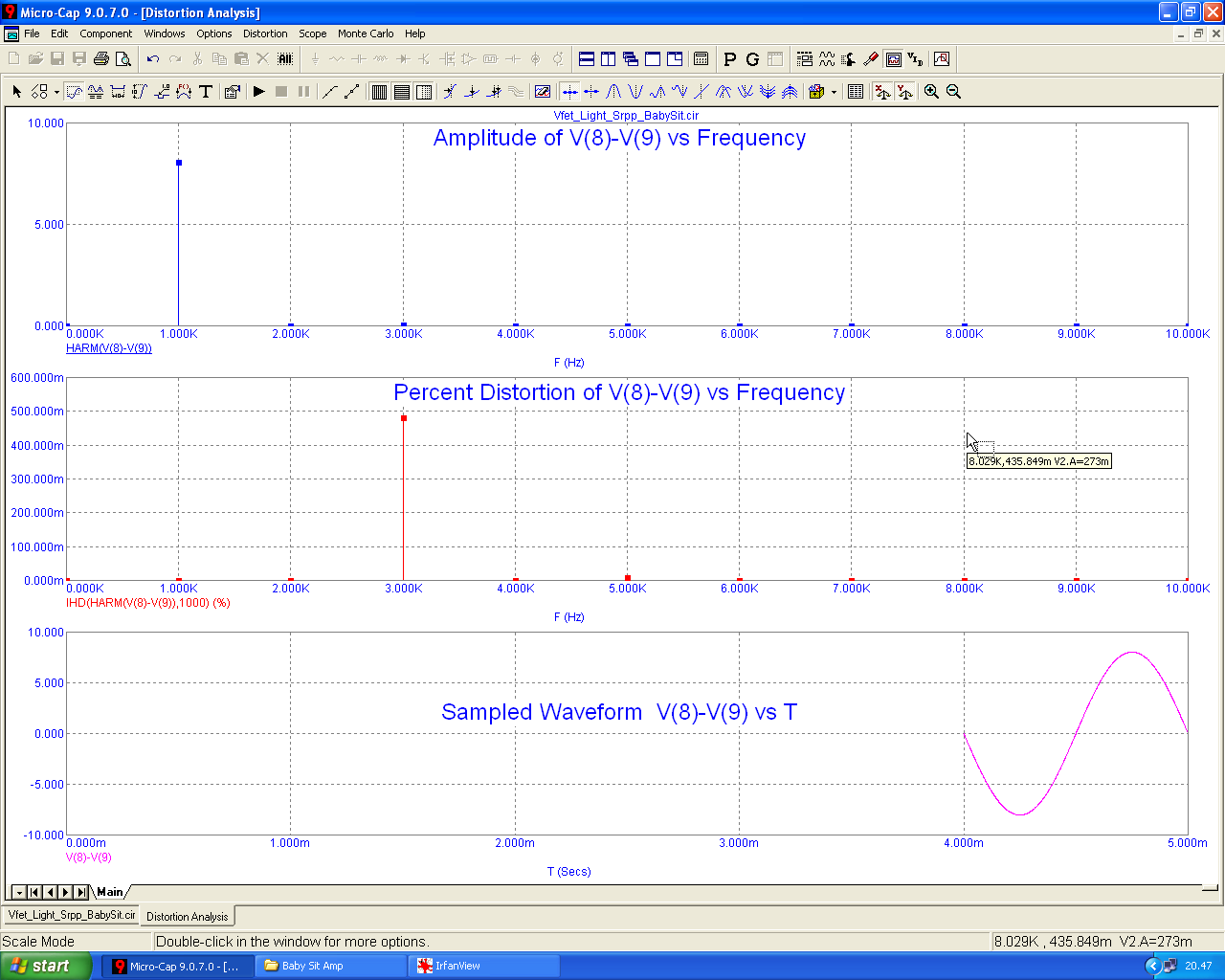

THD analisys is for 12 - 10 - 4 - 1 Watt
- 12 W vs. 10 W of output power
- 32 W vs 45 W of power dissipated for each Vfet
- Lower distortion at all measured power (you can compare the corresponding graphs).

Sorry, I had forgotten the transient analisys,
The CCS use a latfet J162 and what is the value of the Zener diode you use...Can I use vertical mosfet such as irfp9240 as CCS and what Zener value?

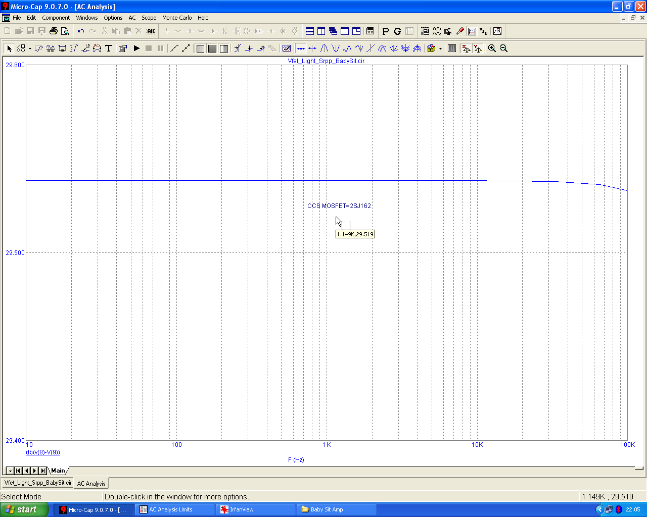

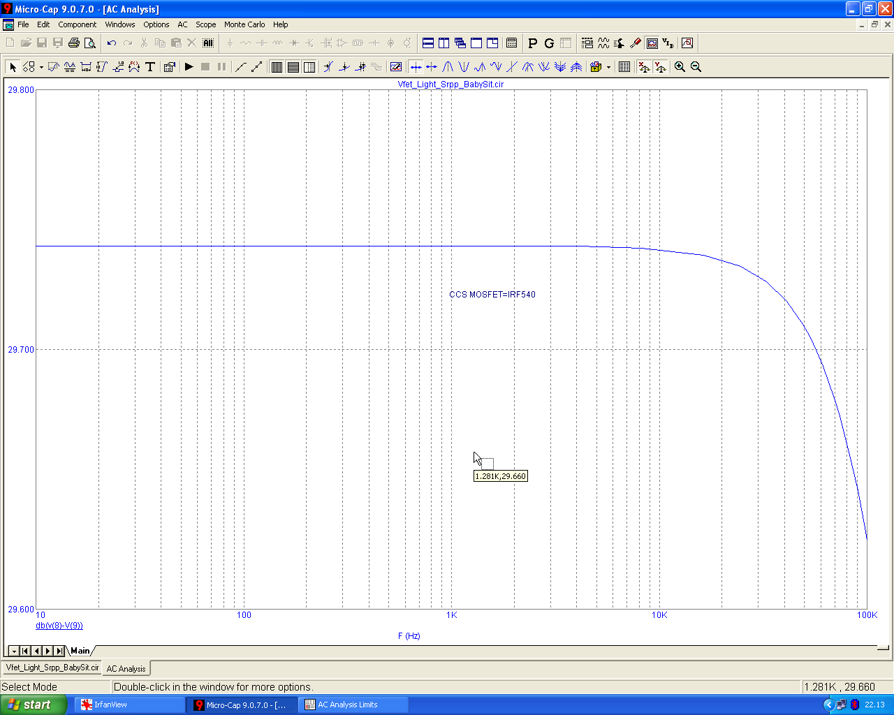

The 2SJ162 was not chosen at random. That 's what gave me the best results both in simulation against the harmonic distortion and in the extension of the bandwidth.
I enclose explanatory graphs, although as already mentioned the vfet with the current model are seen as components devoid of parasitic capacitances.
First graph referred to 2SJ162 CCS, the second to IRF9540 (no model for IRFP9240) but result must be similarly. I have tried other lateral and vertical mosfet: Hitachi is the best
I have zoomed up the scale to better highlight the differences.
The scale is the same for both graphs: 10-100KHz X-axis, Y-axis 0.2 dB ; Id current=2,11 A
Actually the zeners used for J162 are of 3,0 V type.
Best regards

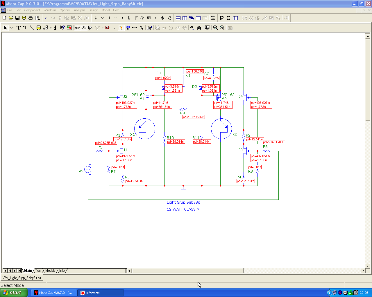

What should be the minimal VA rating of my PSU for 2Channel (stereo).
JUNM,
You are right, i not exposed these details yet because too much data on the same scheme would be confused.
Now I post the 3 designs related to voltages, currents, and power enveloped in the circuit, respectively. . (I hope you referring to the version with CCS).
So stereo version dissipate 300 Watt, therefore you need 400 or 500 VA transformer. I recommend double C (or EI if not possible) with separate windings for primary and secondary
