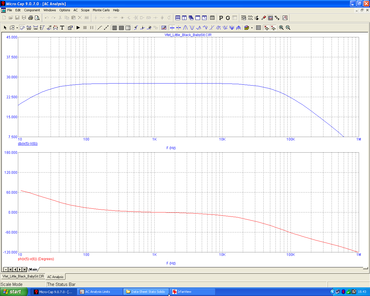

The BLACK version

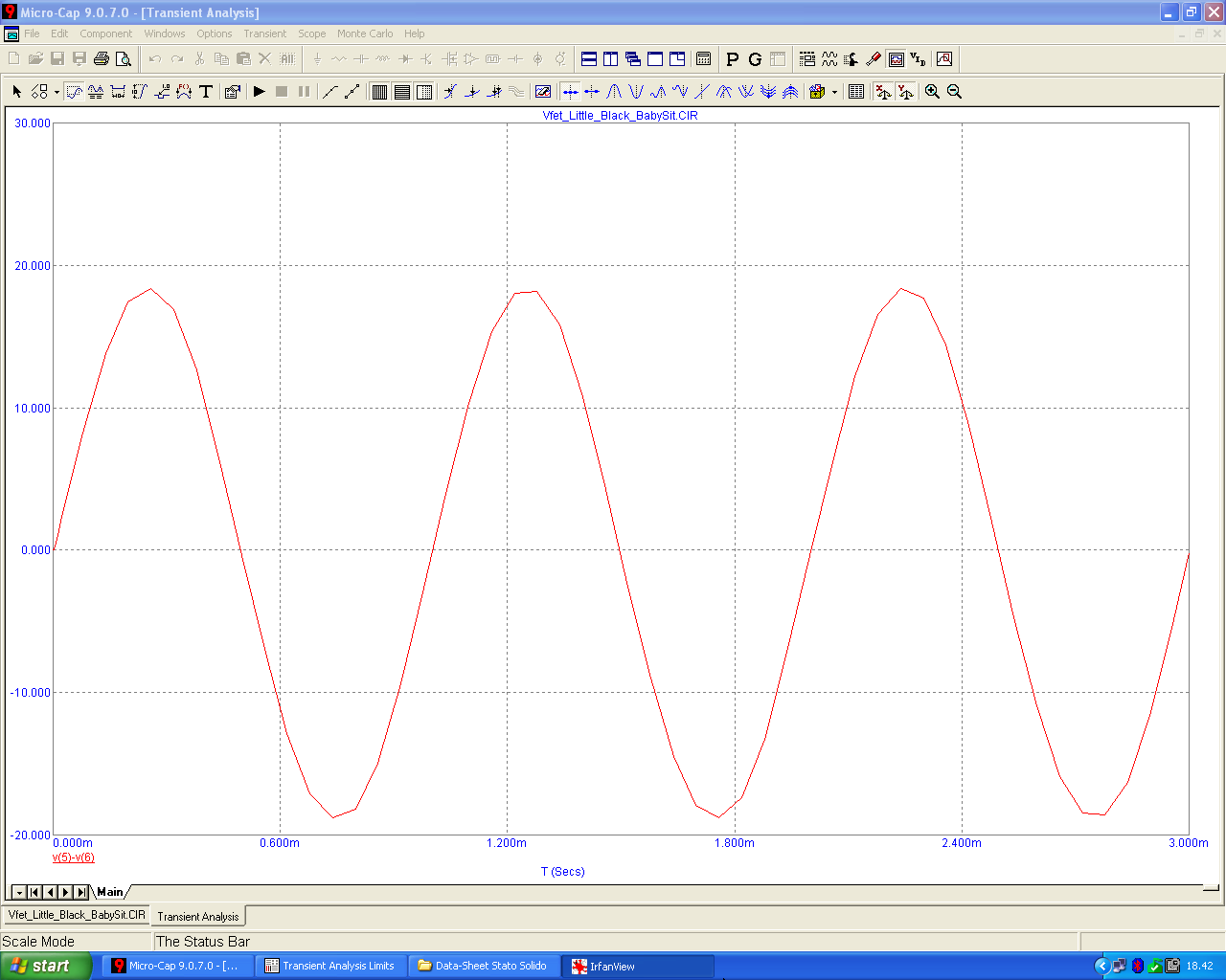

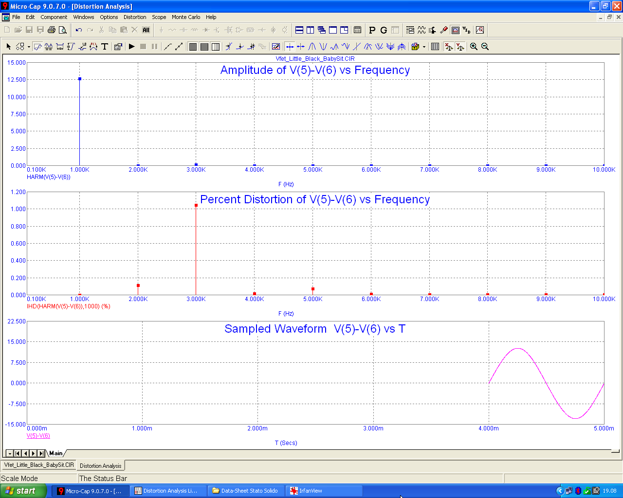

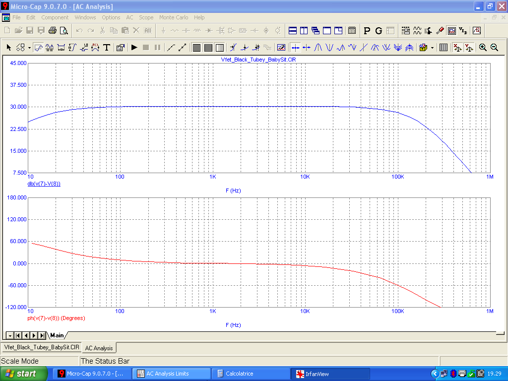

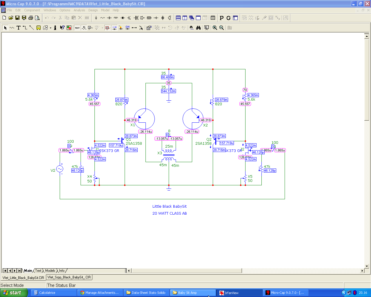

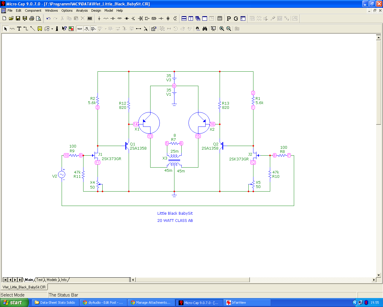

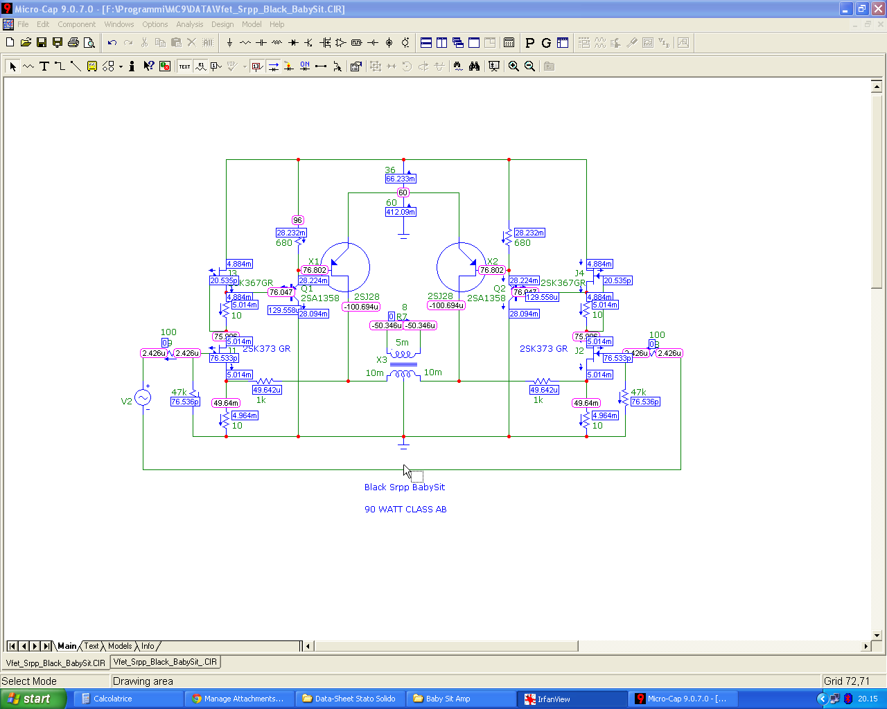

To meet the demand of people asking for a version with the output transformer, I have designed two different power amplifiers, the smallest of which is shown below, along with the graph of the frequency analysis and distortion at 1-10-20 Watt / 8 Ohms
Thanks Mos57... i think this transformer coupled one is more appropriate for me...you use K373, a 100v jfet in the input, does it necessary to have this Hv jfet or any jfet will do. The OPT is labeled 45m+45m// 25m...is this in meter, millihenry's or what?

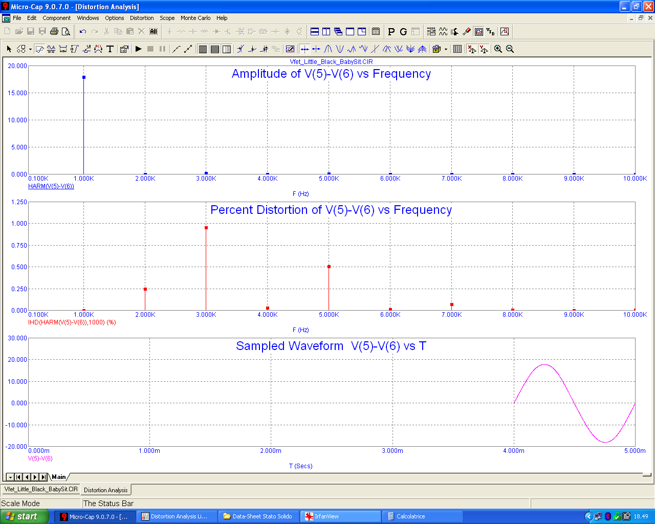

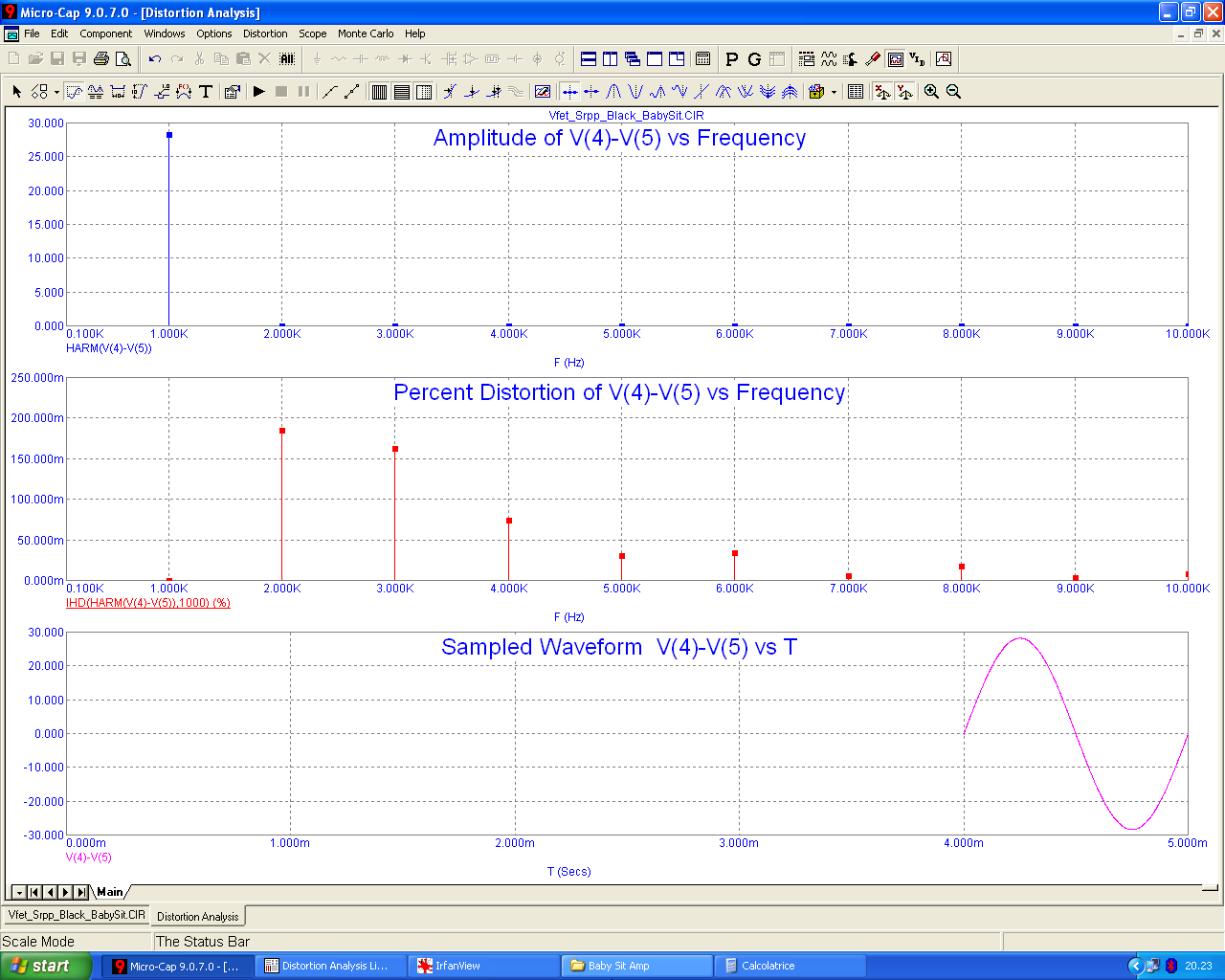

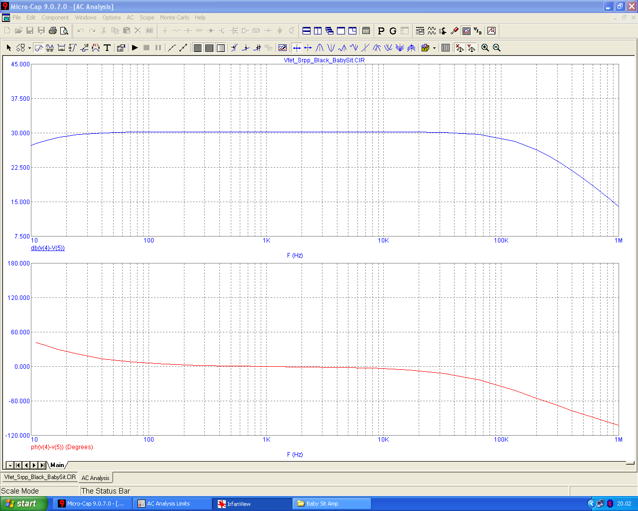

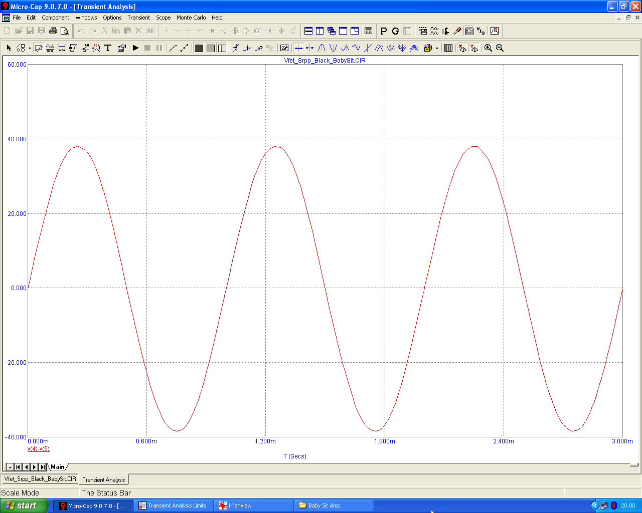

This is the high power version with output transformer. Also if I have declared as a 90 Watt amp, it can also delivers 100 Watt on 8 Ohm load without clipping.
Images attached for circuit, transient, AC and distortion analisys for 90,50,1 Watt/8 Ohm.
Best regards, Francesco.
In this circuit is necessary high voltage Jfet. You must substitute it with another high voltage jfet and about same Idss and gm. 45+45 means 45 mH+45 mH inductances on 2 primaries and 25 mH on secondary.
I didn't notice that you use two supplies, now i really know we have to use hv Jfets. I have K223 but only 80V and almost same rating as K373. At 96v, I presume that voltages across each jfet will be half(48v) or lesser since its srpp, am I right?
Can you give us the OPT details...core size, wire size etc.and the schematics with current and voltages on each node. What should be the driver tranny?

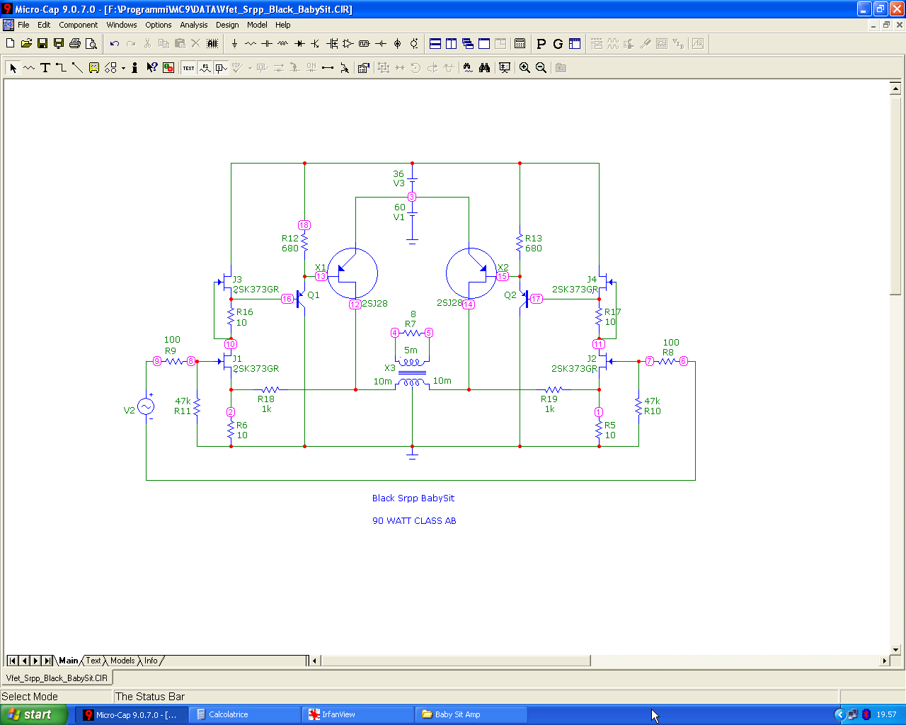

I enclose schematics of the small and bigger amplifiers with out transformers with specified voltage values of the nodes and circulating currents.
You are right for JFETs in SRPP circuit, not for other scheme.
Driver transistors are 2SA1358, or 2SB649A or 2SA1011.
For construction details of the output transformers please contact your supplier. It is sufficient that you tell the value of the inductance and the effective power.
Because the transformer has it's centerpoint grounded, the trafo could (and probably should) be made as an autoformer, which would make it signifficantly easyer to make.
An autoformer with seconday as the output terminal?
Most autoformers i know does not have secondary only single winding for step up or step down types.
How about using a autoformer as Choke and connect directly the speaker between the drains, one setback of this is when one of the Vfet dead the speaker will get affected or burned.

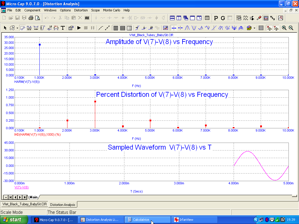

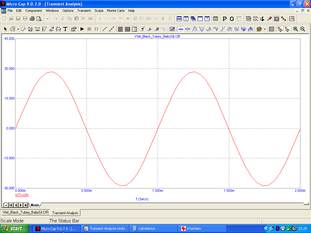

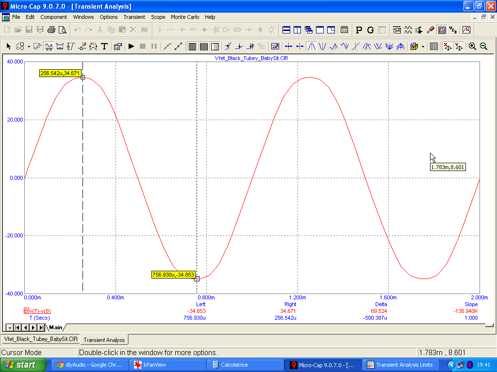

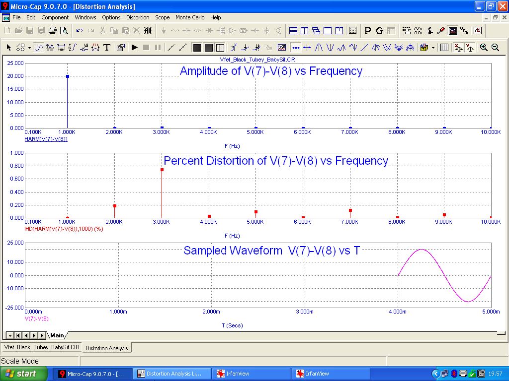

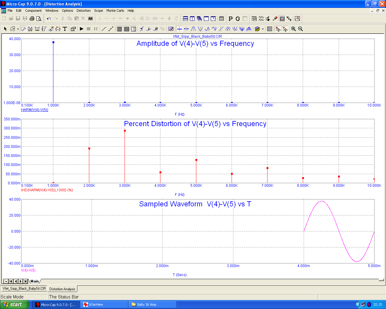

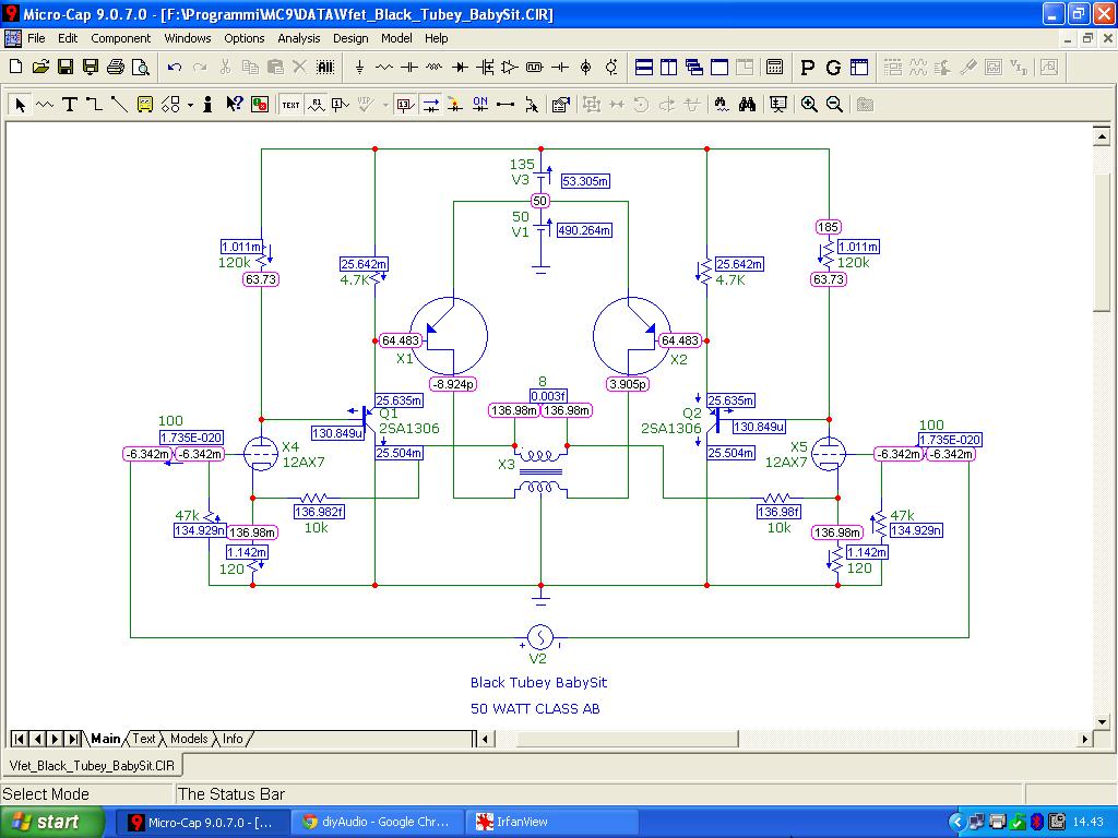

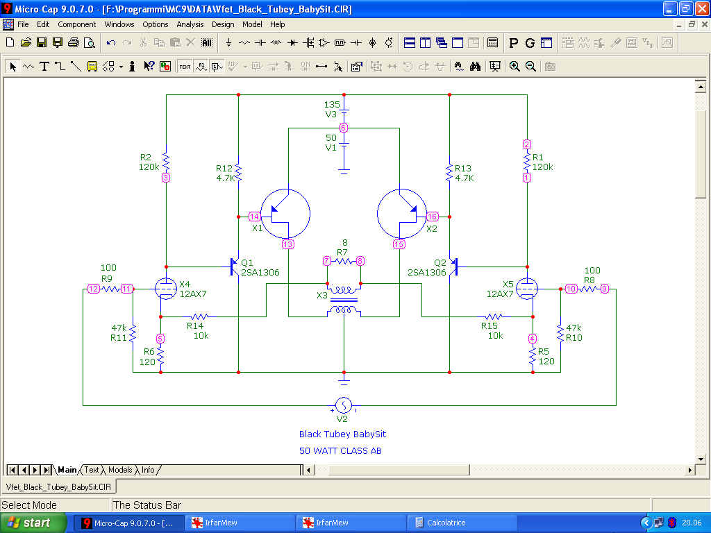

The Hybrid version
Given the relative difficulty in finding high-voltage jfet I made a virtue from necessity, and so, also for the lovers of the tubes, I propose a hybrid version that uses high mu triodes in the input section.
It would be desirable also to use high-gain nuvistor as type 6DS4 or 8058 but I do not have the models.
Please note that this circuit uses the better devices (IMHO) in their respective categories:
I enclose circuit and related measures. Distortion analisys are for 50, 25, 1 Watt / 8 Ohm
Francesco
- Tubes for voltage amplification
- Transistors for current amplification
- Vfet for power amplification.
Francesco

wow a hybrid...well i think this my other alternative since i do have hi mu tubes like 12ax7. I think this will be the one i can start off since i have the tubes...I just want to try a PA Output trafo for the output....I have an 50w opt from a PA system with 4-8-16-70-100v secondary....i will just use the 8 ohm taps.
Thanks mos57 ..i also want to give it a Tube concertina or cathodyne phase splitter to address the balanced input...
BTW, what is the idle current on each Vfets. Can you show the node voltages?

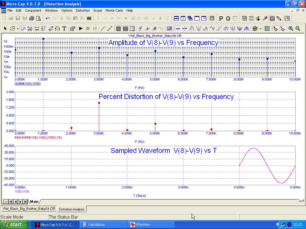

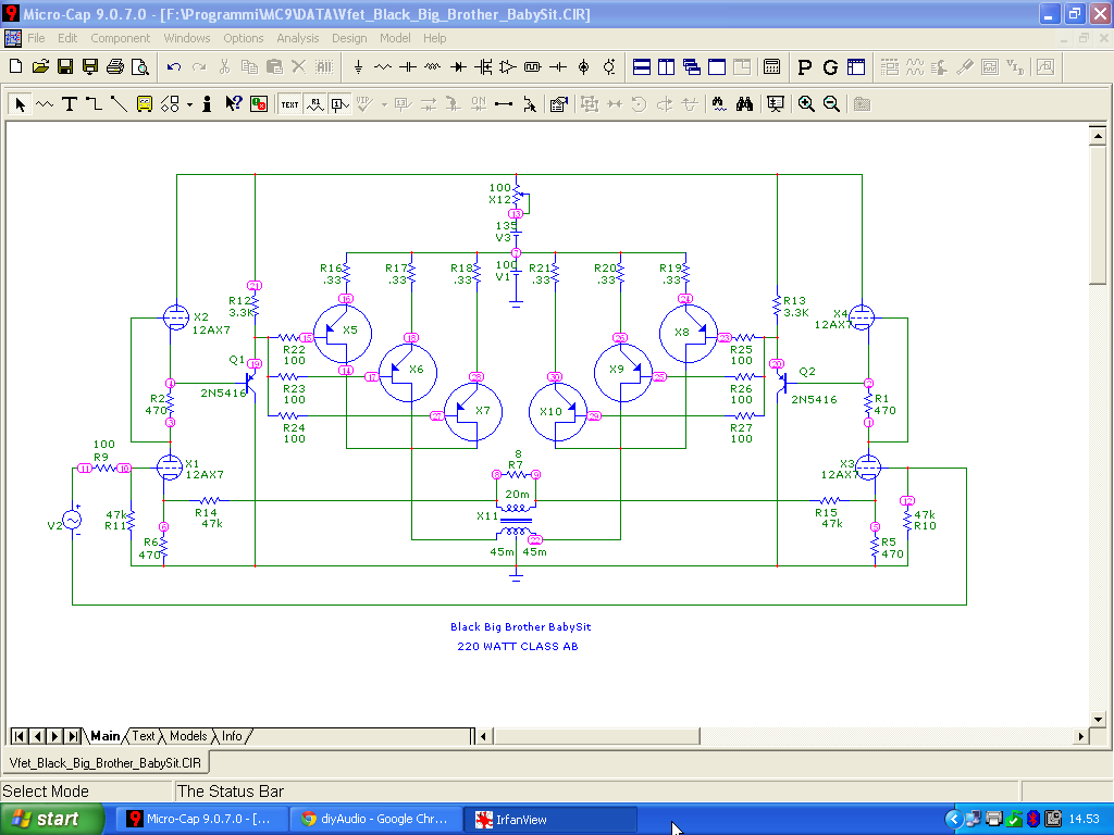

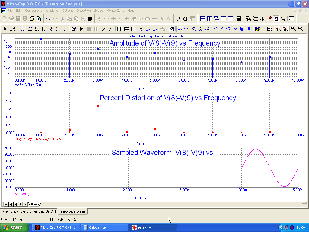

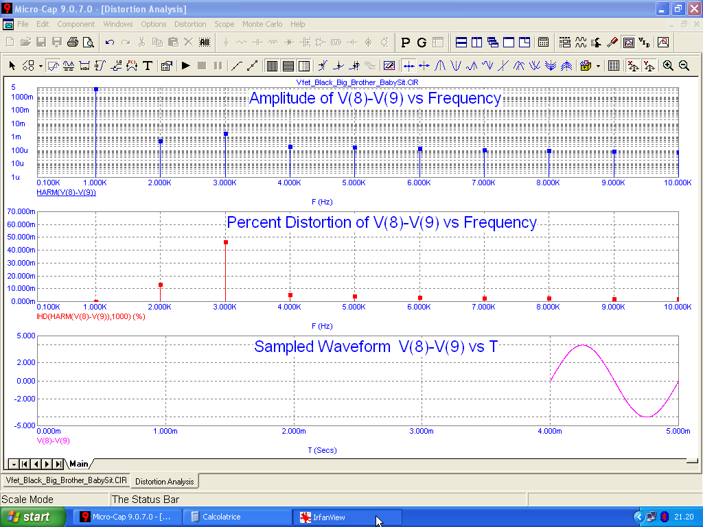

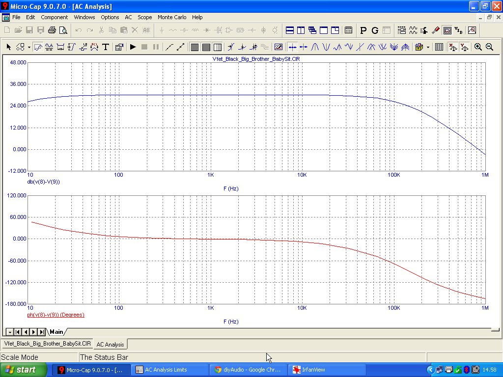

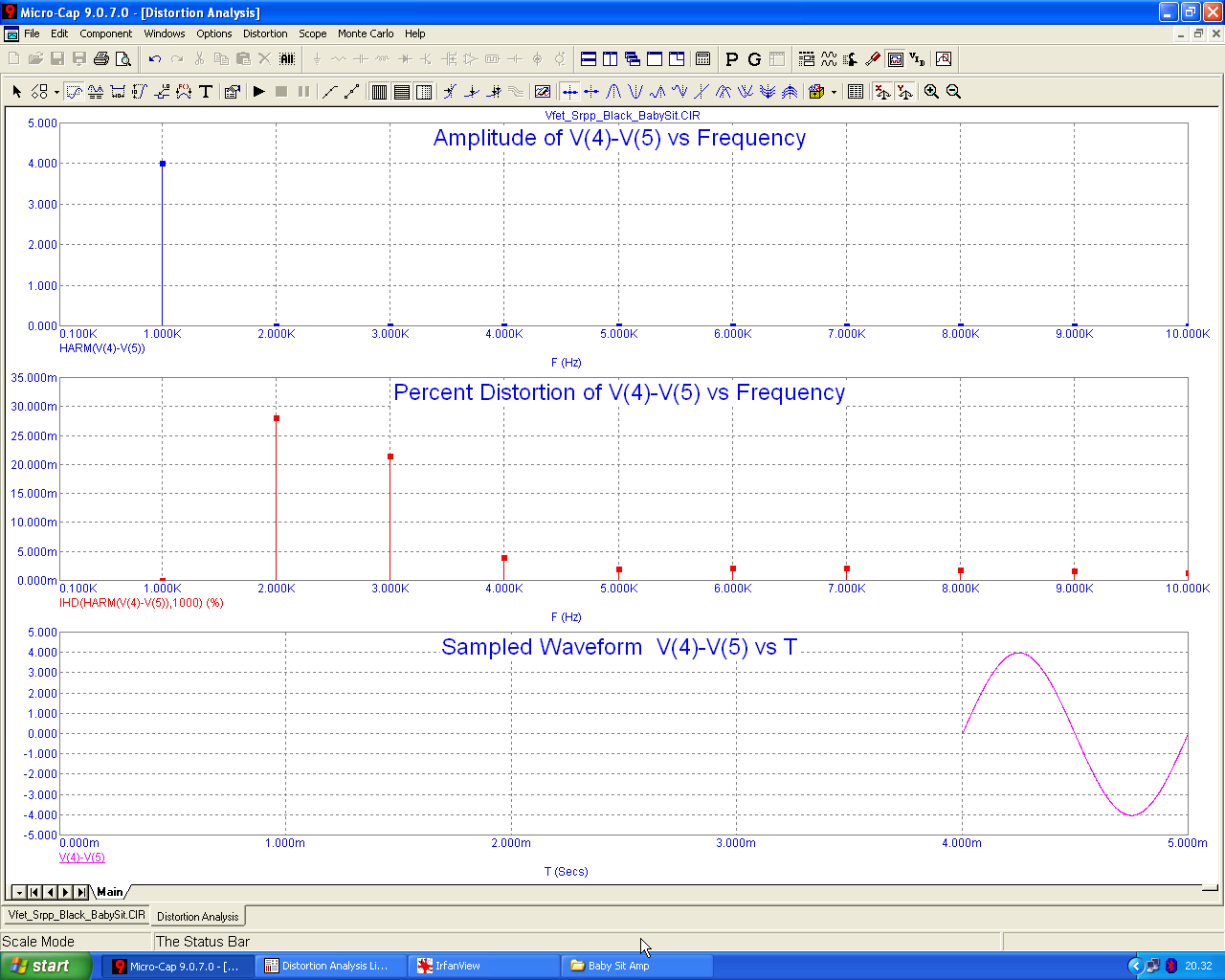

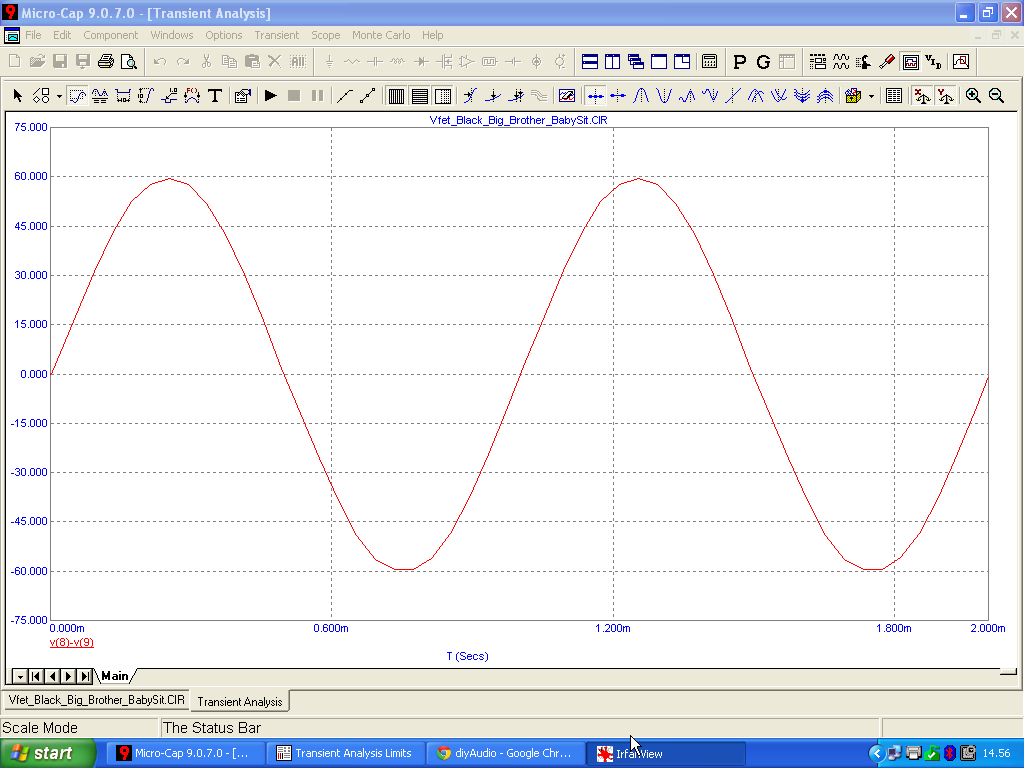

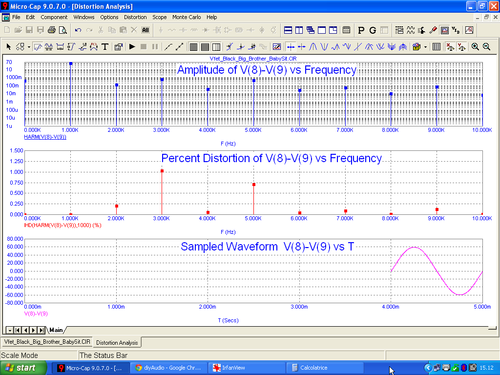

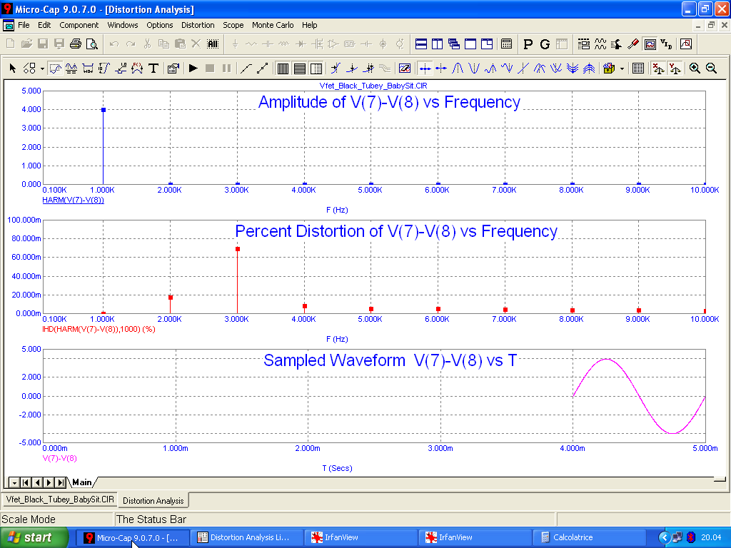

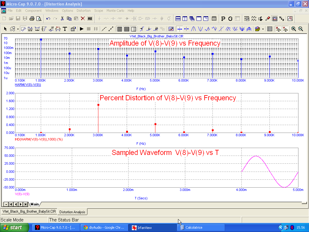

The B4 - Black Big Brother BabySit
Today i show a booster version of tube BabySit.
It can deliver up to 220 W on 8 Ohm speaker.
Much more power should be delivered with 4 Ohm speaker, but i not show here because i not like very high power amplifiers for home.
Notes: For which is interested in 4 Ohm version please add another 2 pair of Vfets (for a total of 5 pairs)
In following the images for circuit Schematic, Transient analisys, AC analisys, and Distortion analisys for 220, 150, 100, 50, 1 Watt on 8 Ohm load.
woow...lot of power...and J28...
I think i will just settle for the parallel J18 a total of 4 per channel...50w ab is enough and I think heatsinks will be smaller than of those in CCS and Class A schema's.

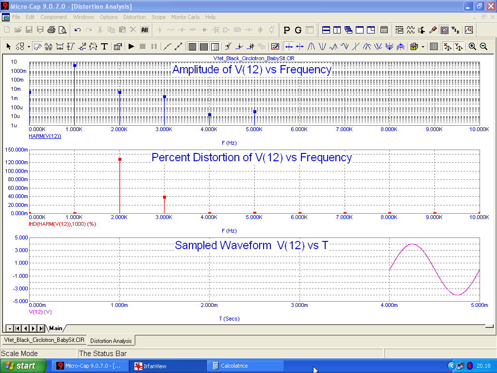

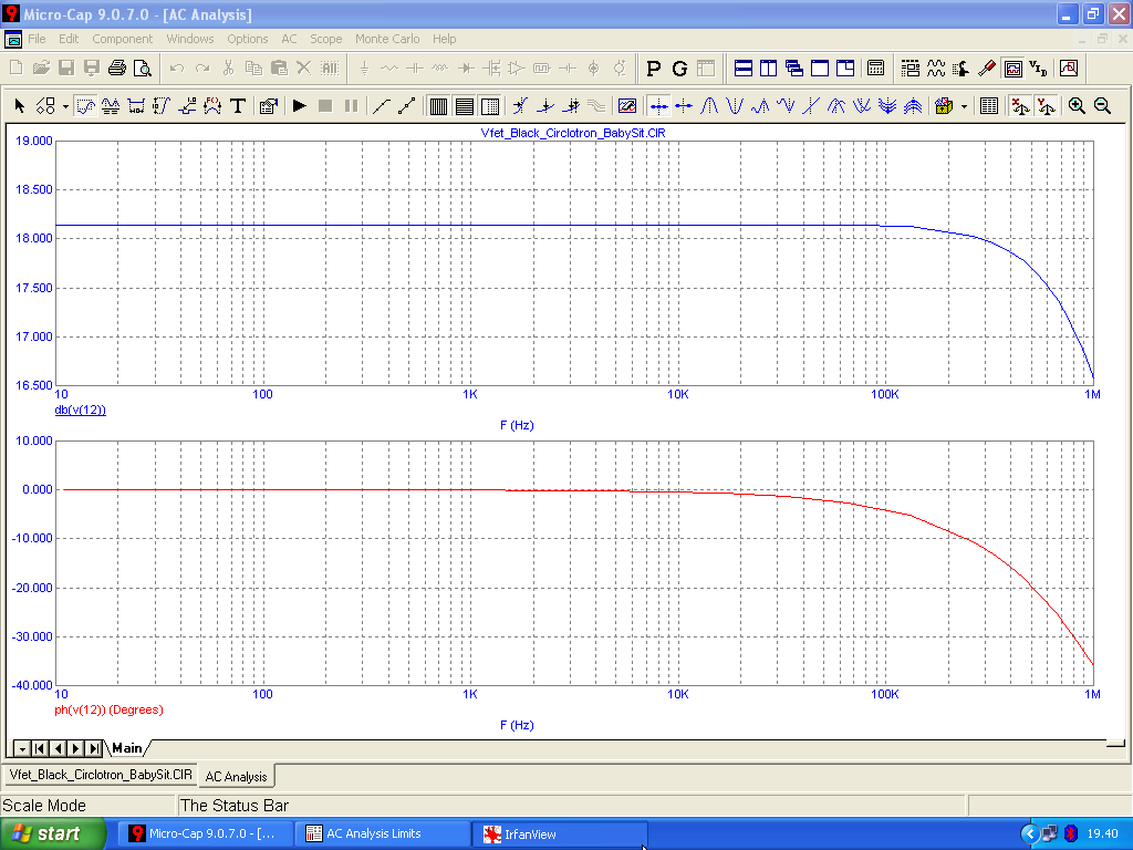

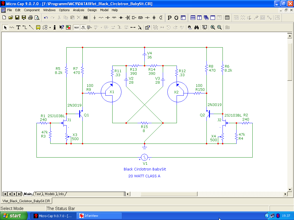

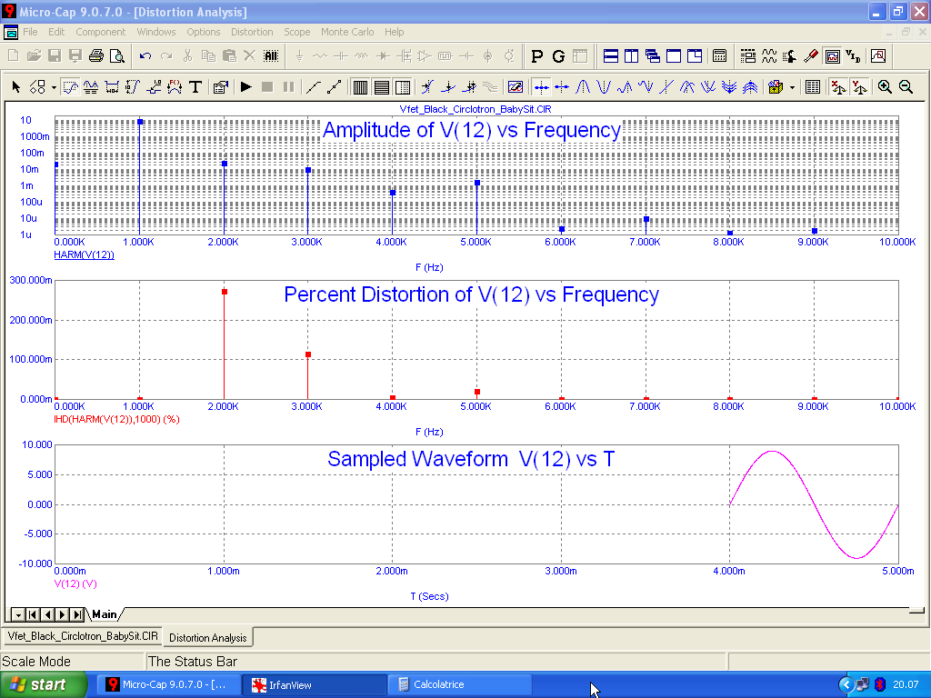

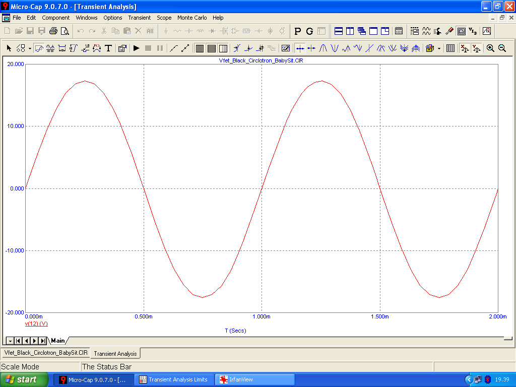

The Circlotron variation
One other alternative to use Vfet of the same polarity is the circlotron known to you all. I designed a circuit like this but this has some variations.
Firstly this circlotron is not used in the classic follower topology but it has voltage gain.
In addition, the output signal is at ground level for the continuous components.
Note also the reduced quantity of power supplies respect to similar circuits
This is' the first time I show this configuration in practice, although the schematic was studied at the time of my patent: see also this link: http://www.diyaudio.com/forums/pass-labs/153912-circlotron-meditations.html
I enclose scheme, transient analisys, AC analisys, and Distortion analisys for 20,10,5, 1 Watt / 8 Ohm.
