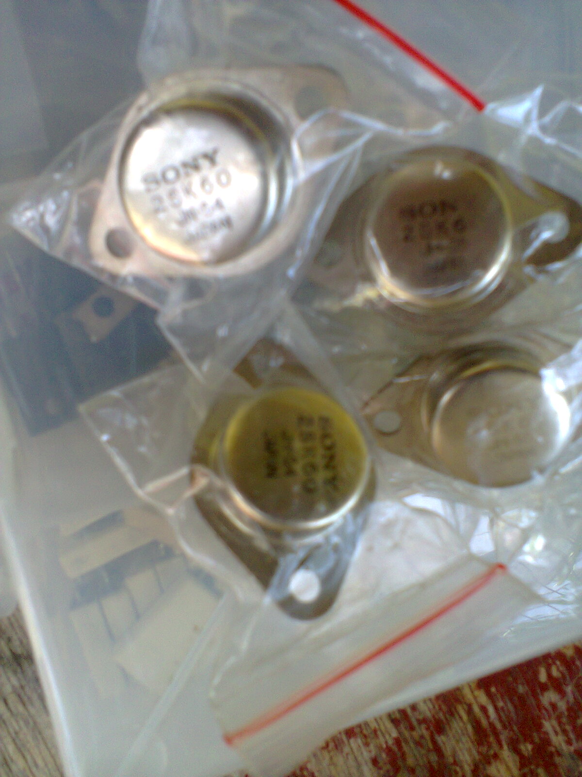

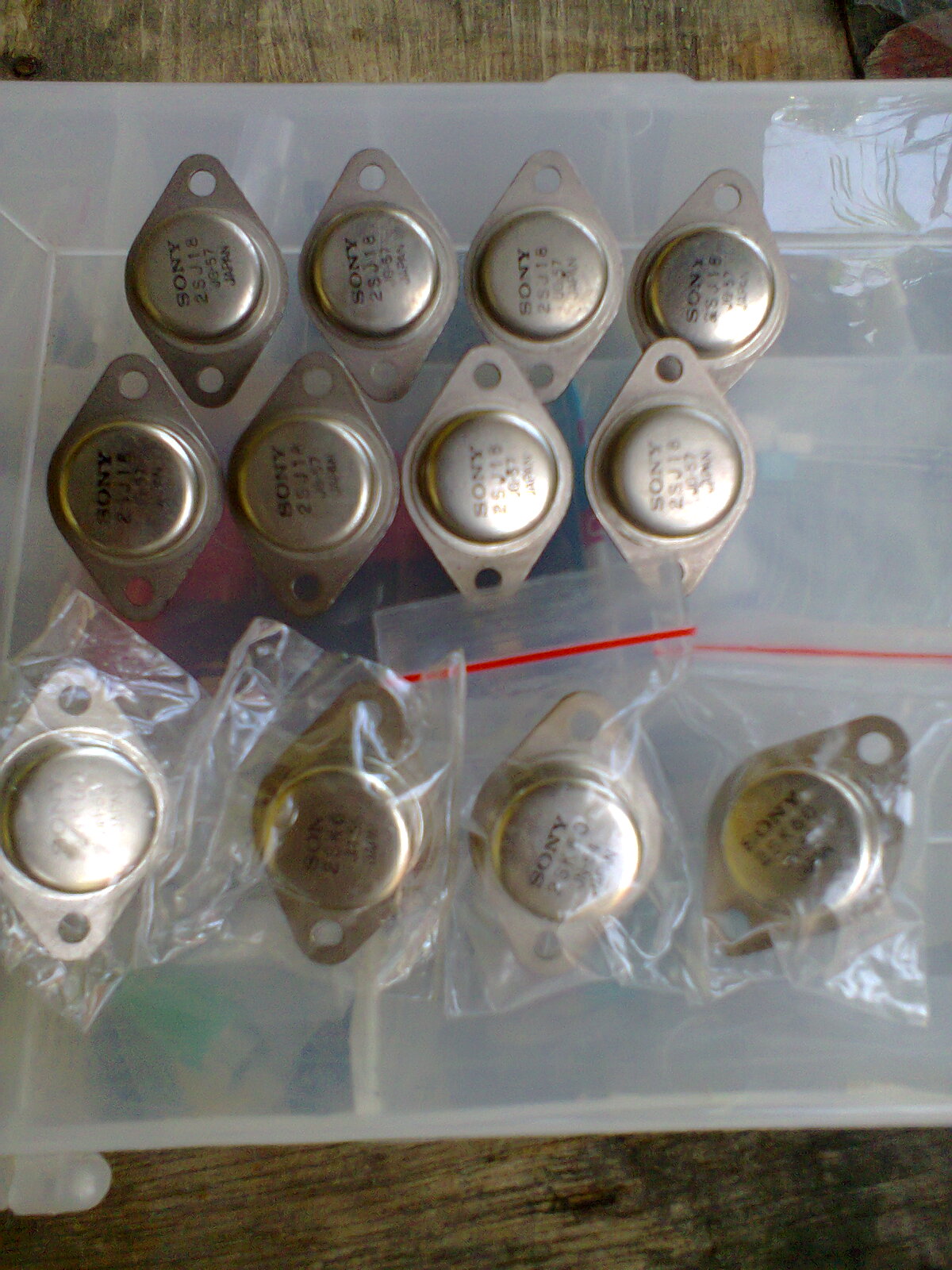

What to do with my 4 pieces Sony 2SJ18 JG-57?
Assuming they are genuine, best sell them or trade them with someone who needs pairs for rank 7 2SK60...

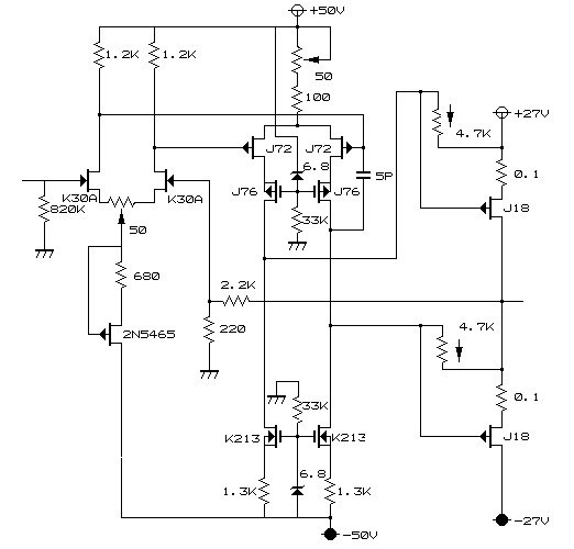

Assuming you can give the high input capacitance a good drive, look at the Yamaha B1 for inspiration on using these...
Maybe a high current drive will address this issue...
