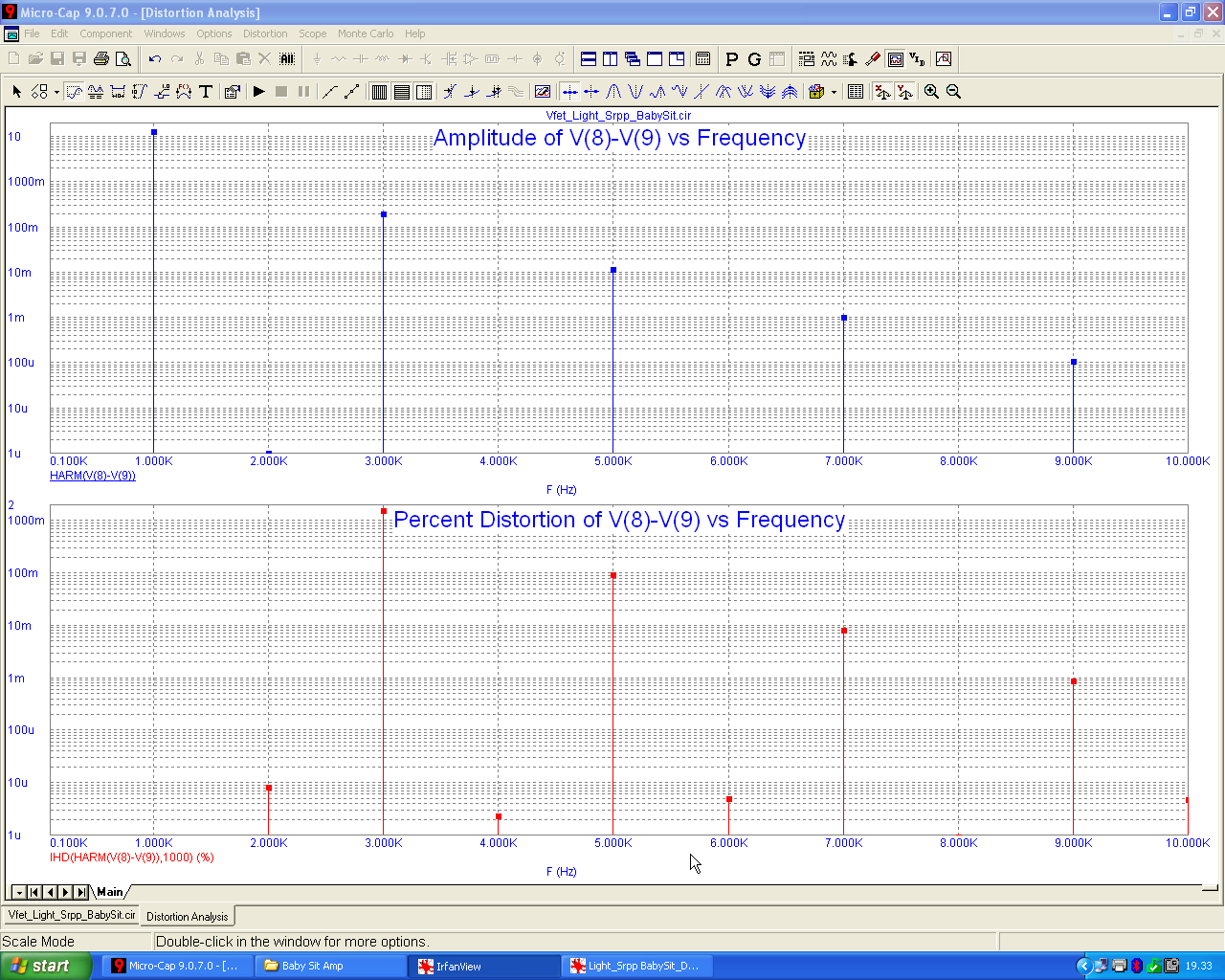

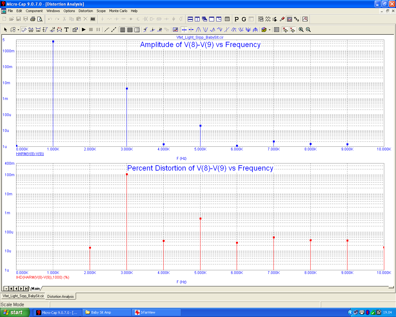

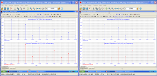

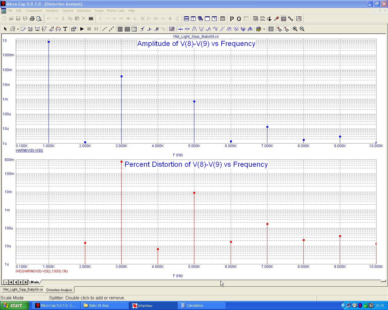

Were raised a bit of questions. I will try to answer one at a time in the following posts.

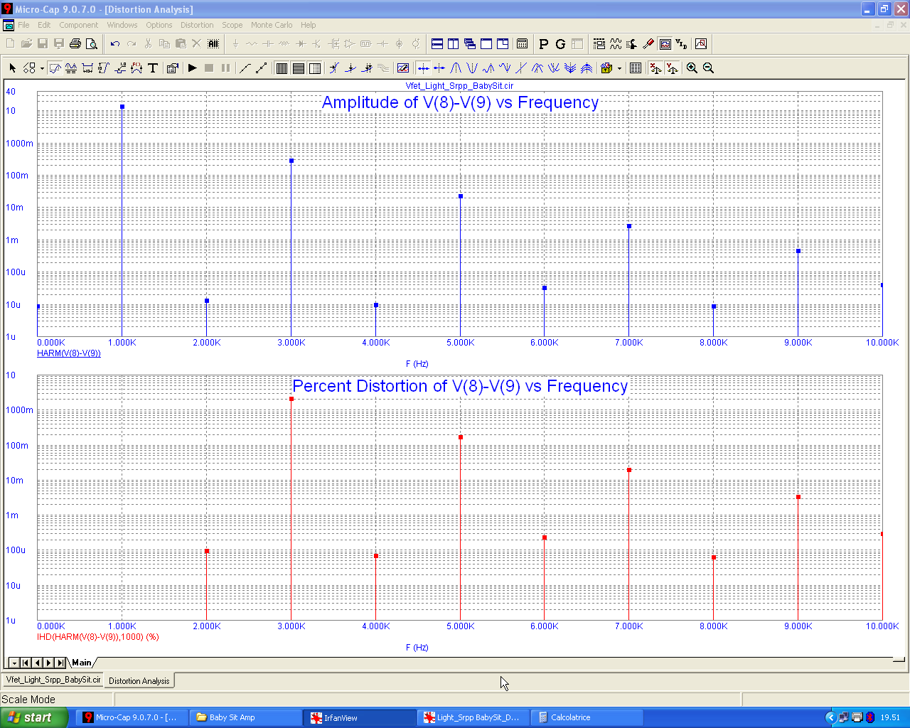

We start from the charts of the distortion. Linear level of harmonics show at first glance (more intuitively) the relationship between the various grade of harmonics. In fact, the charts posted before immediately detects that the only noticeable distortions are those of the third harmonic.
The other with respect to the latter are practically negligible.
However,for those who want a more detailed analysis, I repeated here the graphs for the version with the CCS that seems the most interesting.
The attached pictures are referred to respectively 12 -10 - 4 - 1 Watts - @ 8 Ohm load

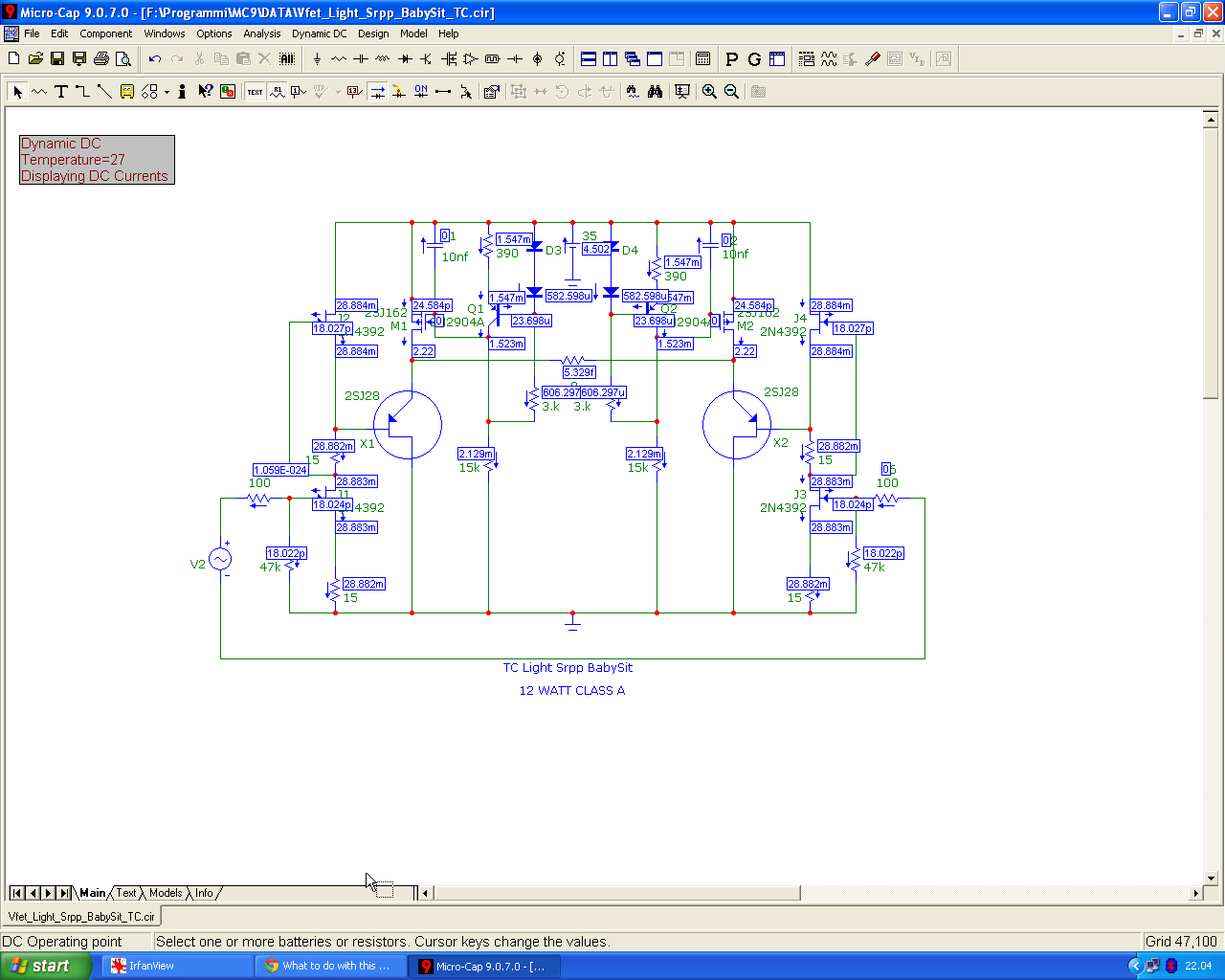

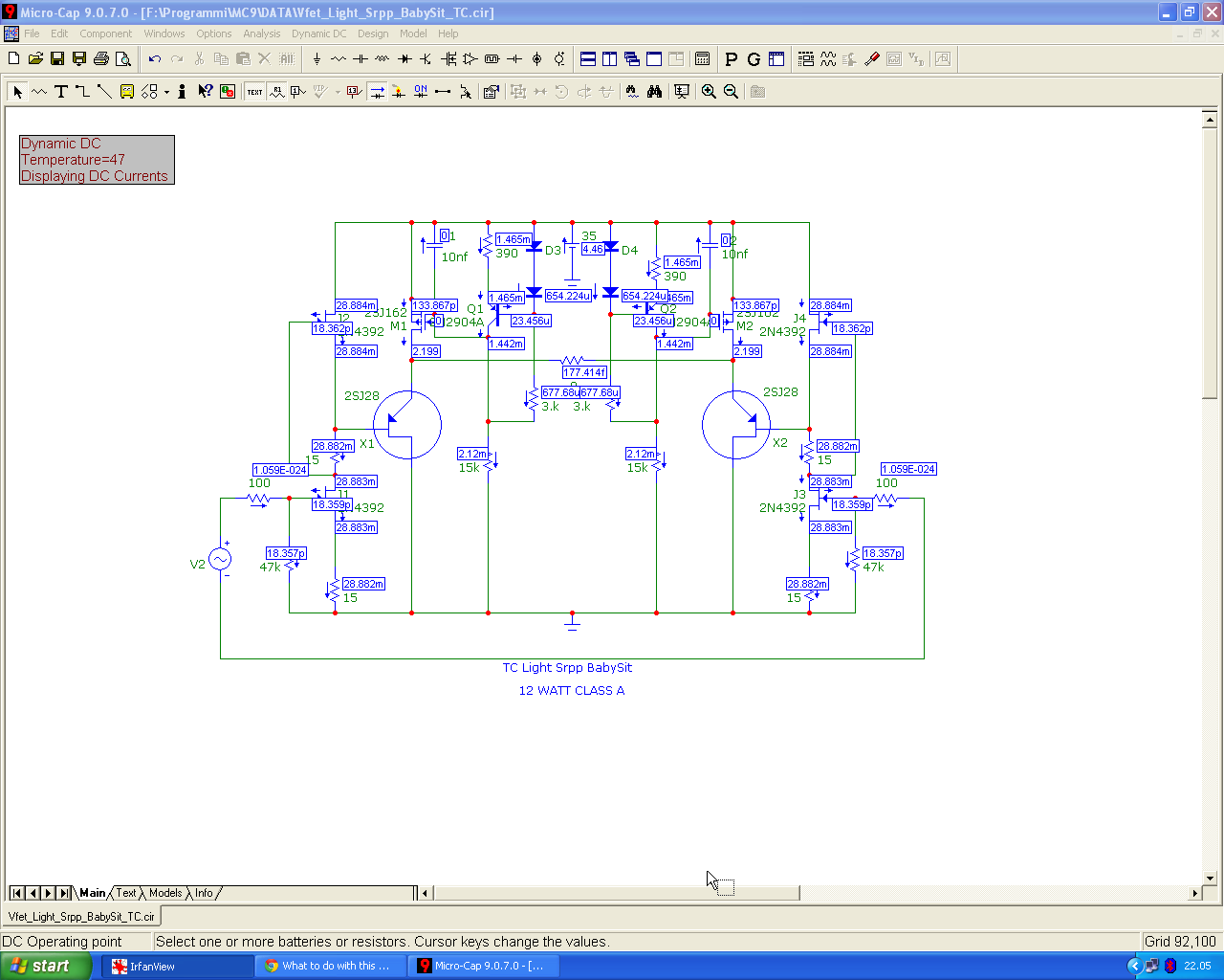

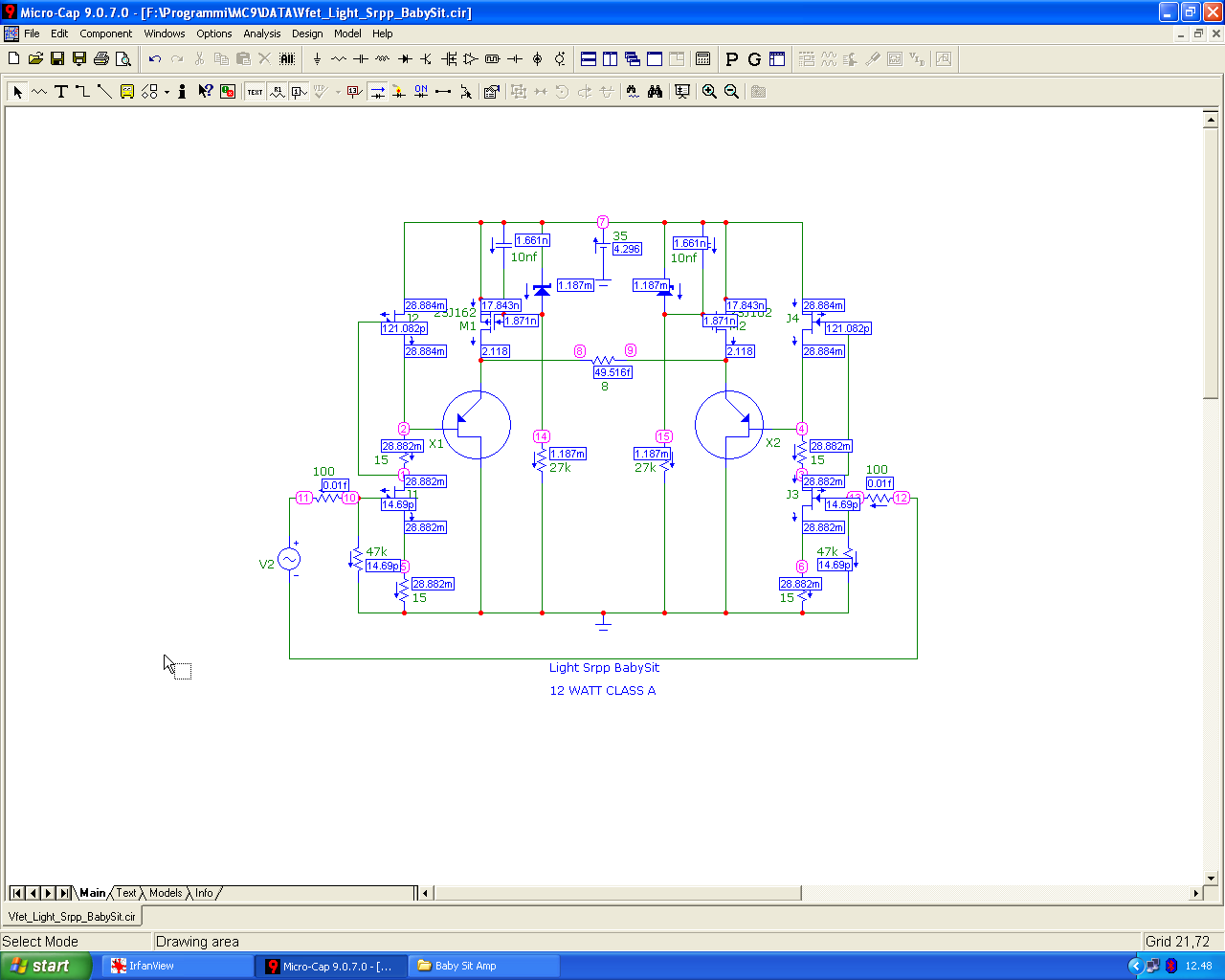

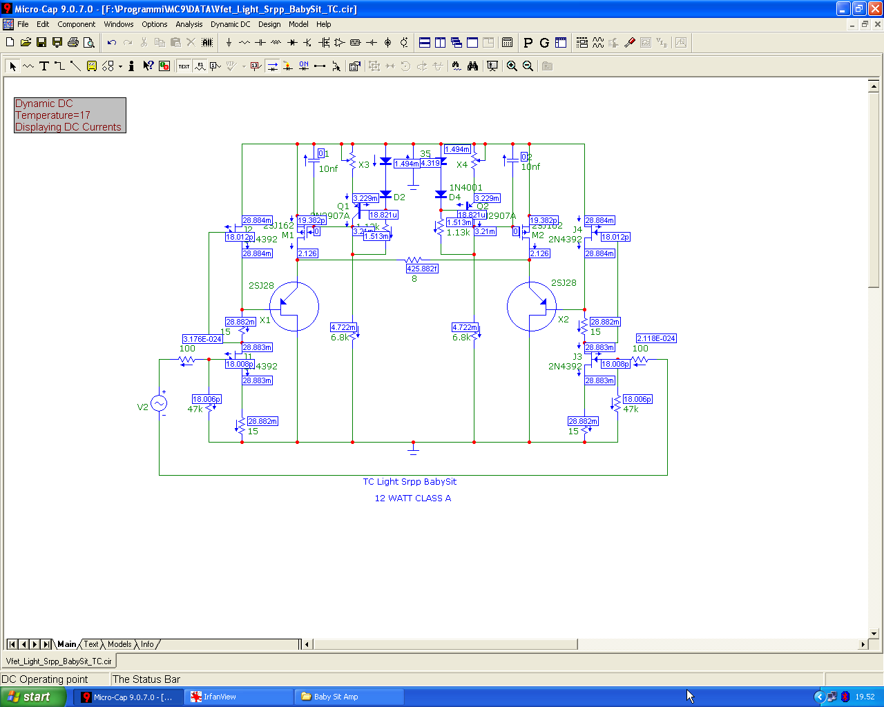

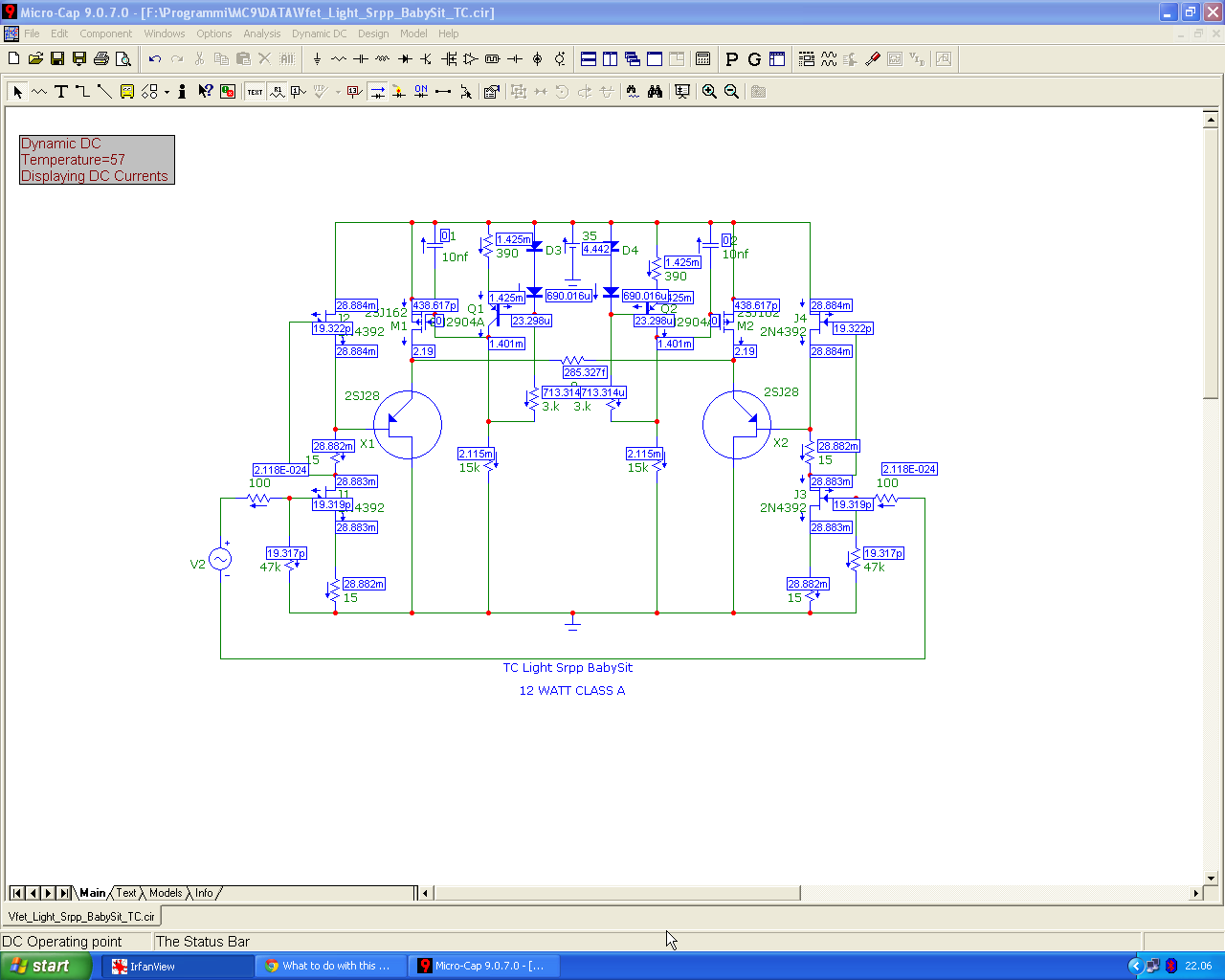

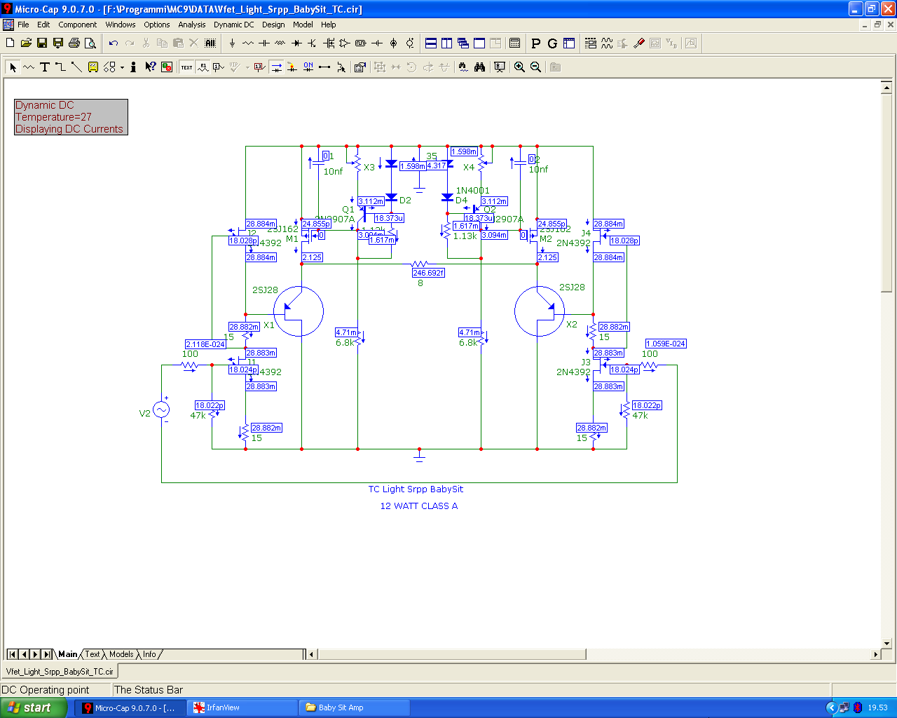

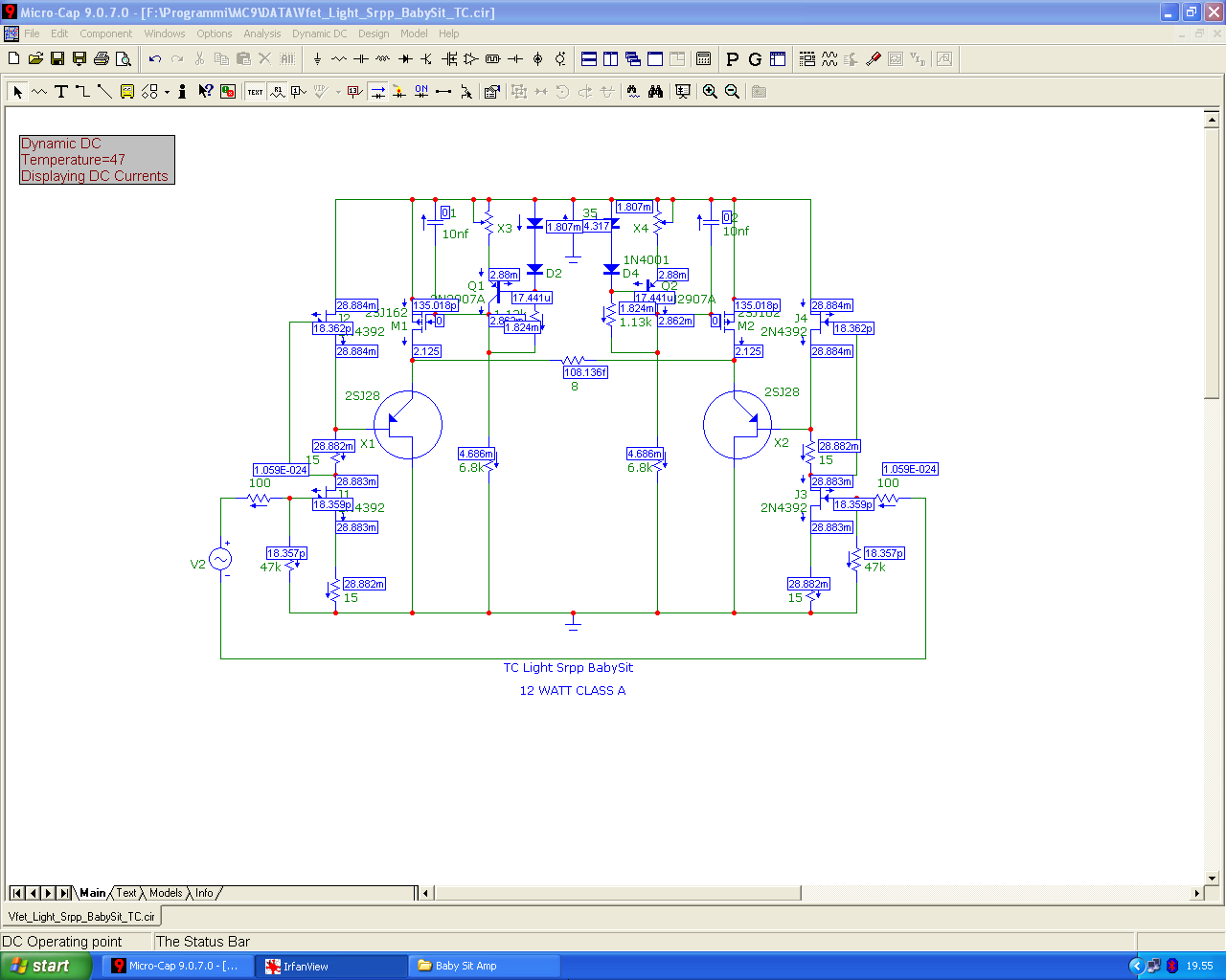

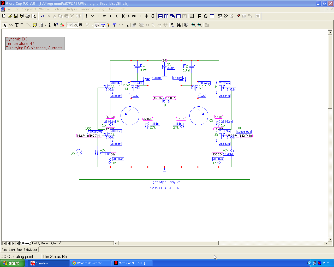

Another issue raised is the variation of the current of the output stage with the variation of temperature. This variation is supposed to be very high and therefore very dangerous condition of operation.
As you can see from the attached graphs the output current varies (decreases) of about 10 mA for an increase of 10 degrees (27 to 37), while from 37 to 47 degrees the current drops another 94 mA. I do not think so disastrous behavior and the behavior in every way that I would describe as "conservative."
In each case the observations to improve the performance must be taken into account and in the following I will post a first variant that improves this behavior by making the current more stable.
Pictures are referred to a default temp of 27° then 37° then 47° for comparison

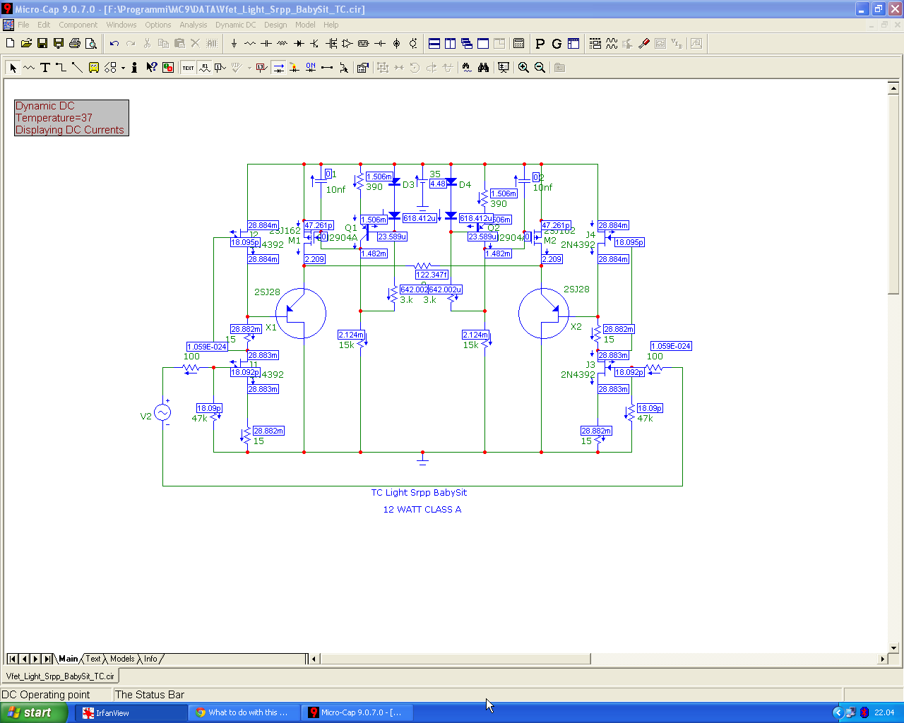

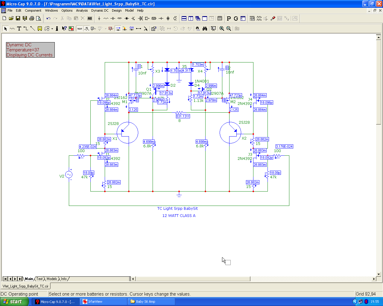

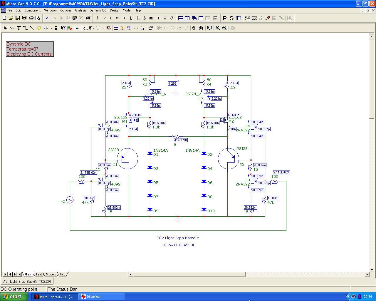

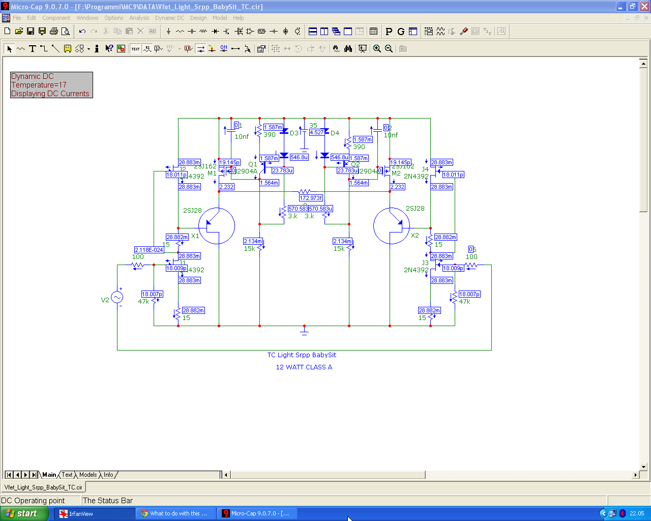

Here I show the variant to stabilize the current vs. temperature. The zener were replaced with simple PNP CCS polarized with 2 diodes. The resistors 390 Ohm on emitters can be replaced with potentiometers from 500-1000 Ohm allowing to adjust the right value of the current generated also not disposing of selected pairs of MOSFET. Another option would be the use of the TL431 as suggested.
In the same conditions of temperature variations of the previous case (from 27° to 47°). here the change is 21 mA. You could do better but I prefer not to go beyond this value because in the practical application is a guarantee for better security.
I also added graphs for more 10° down (17°) and 10° high (57°)

All these designs are very stable. They have low efficiency but are solid as a rock. We have to agree to get what you mean by stable.
If we mean that the operation is "safe" from an electrical standpoint , namely that reliable and not subject to breakdowns for anomalies that may be generated during operation, in this sense, then all the circuits presented in this thread are at the highest levels for the following main reasons:
- absence of feedback
- absence of reactive elements
- a single power supply
- power devices that have a zero or positive temperature coefficient (in them the current decreases with increasing temperature).
Moreover, the presence of CCS in some of them is an additional degree of protection.
An amplifier more stable? An amplifier that is power off 😀
If instead for stable we includes an amplifier that maintains in the time and at different temperature the same operating conditions (which the value of the output current) then is a different matter.
In the case of circuits presented here the one that best fulfills this condition is the schematic with mosfet powered by BJT ccs (last one of the previous schemes).
However, paradoxically, those in which the current varies, being that it decreases as the temperature increases are to be considered safer especially those with load resistors.

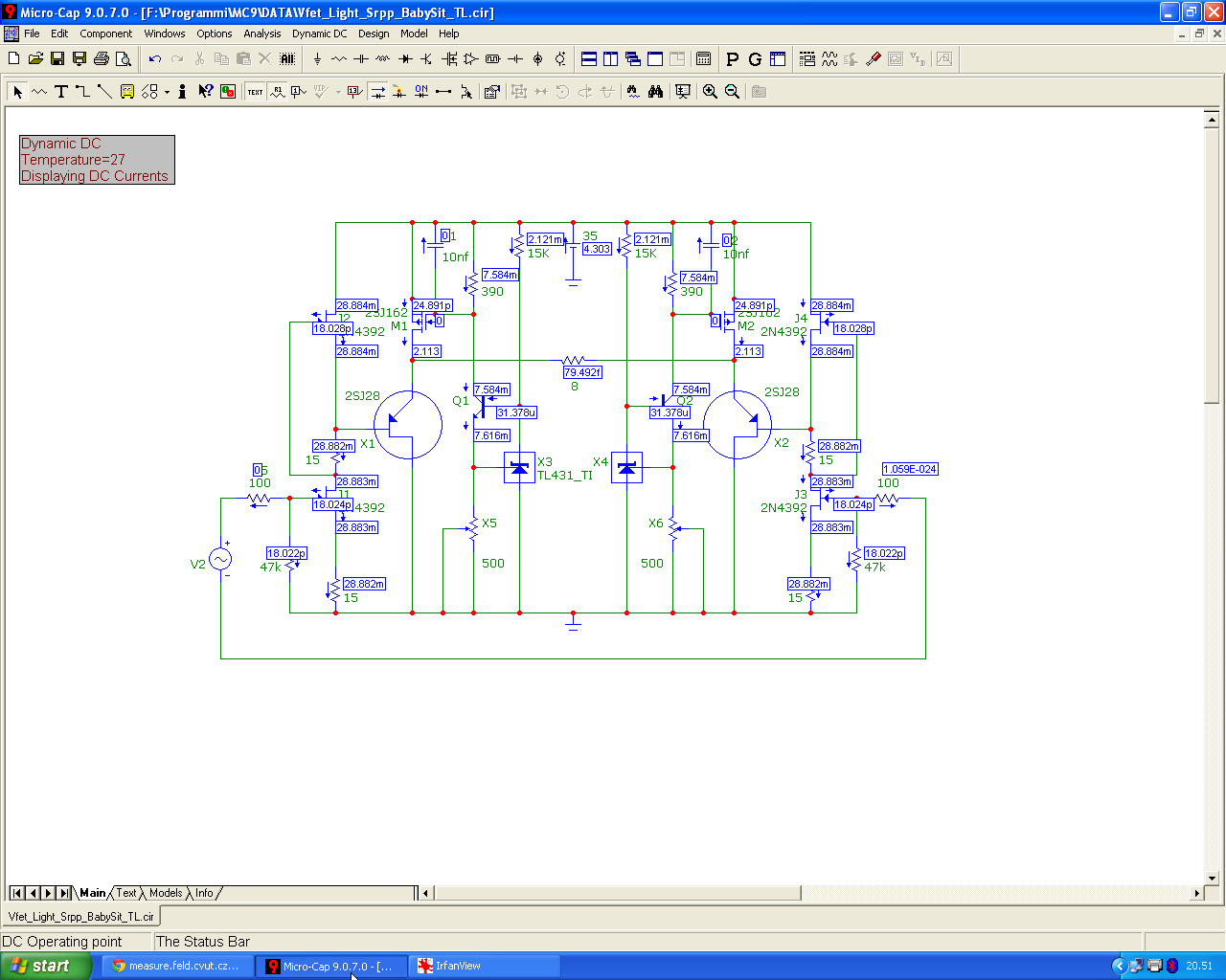

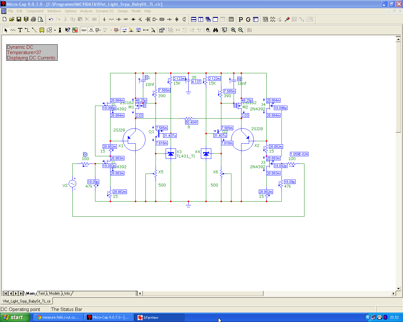

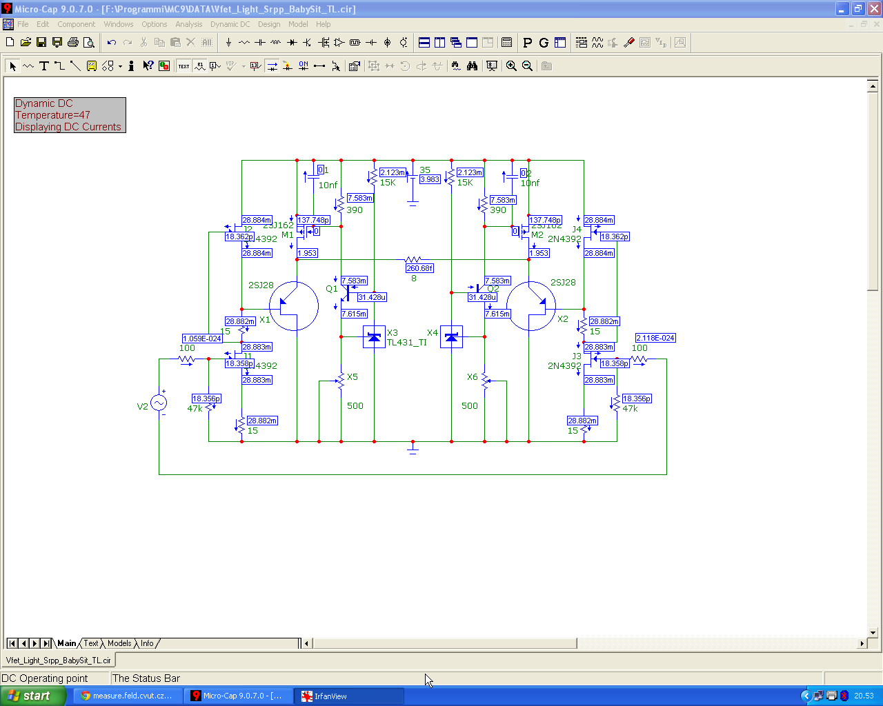

We come to the second point: why had not yet submitted a circuit with TL431.
These devices were invoked to allow a continuous adjustment of the bias voltage, such as to adapt to mosfet with different Vgs. This is the only advantage that their presence provides.
In fact, from a point of view of stability of the current Vs temperature the situation is even worse than in the case of the circuit with the zener, as you can see from the simulations attached. The lat Mos as mentioned have a drain current which decreases at rising temperature. What serves us to counter this effect is a gate voltage that must increase with increasing temperature. All contrary for vertical mosfet
Being instead the TL431 a ccs quite accurate even varying the temperature parameter, it follows that the gate voltage of the MOSFET remains stable kilter the compensatory function.
Schematic attached with TL431 are referred to 27° 37° 47° for direct comparison.

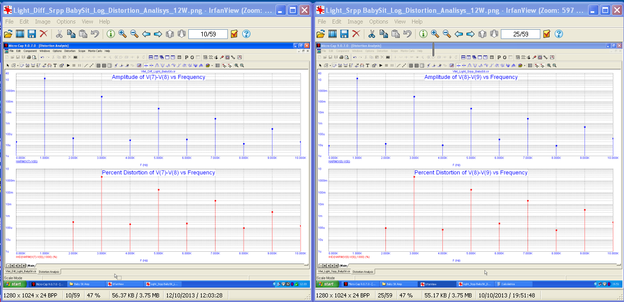

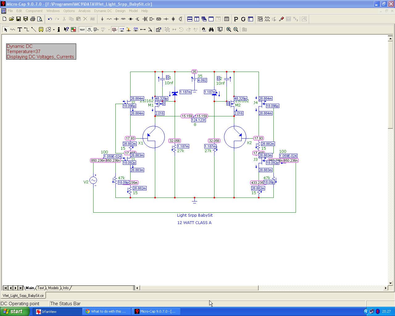

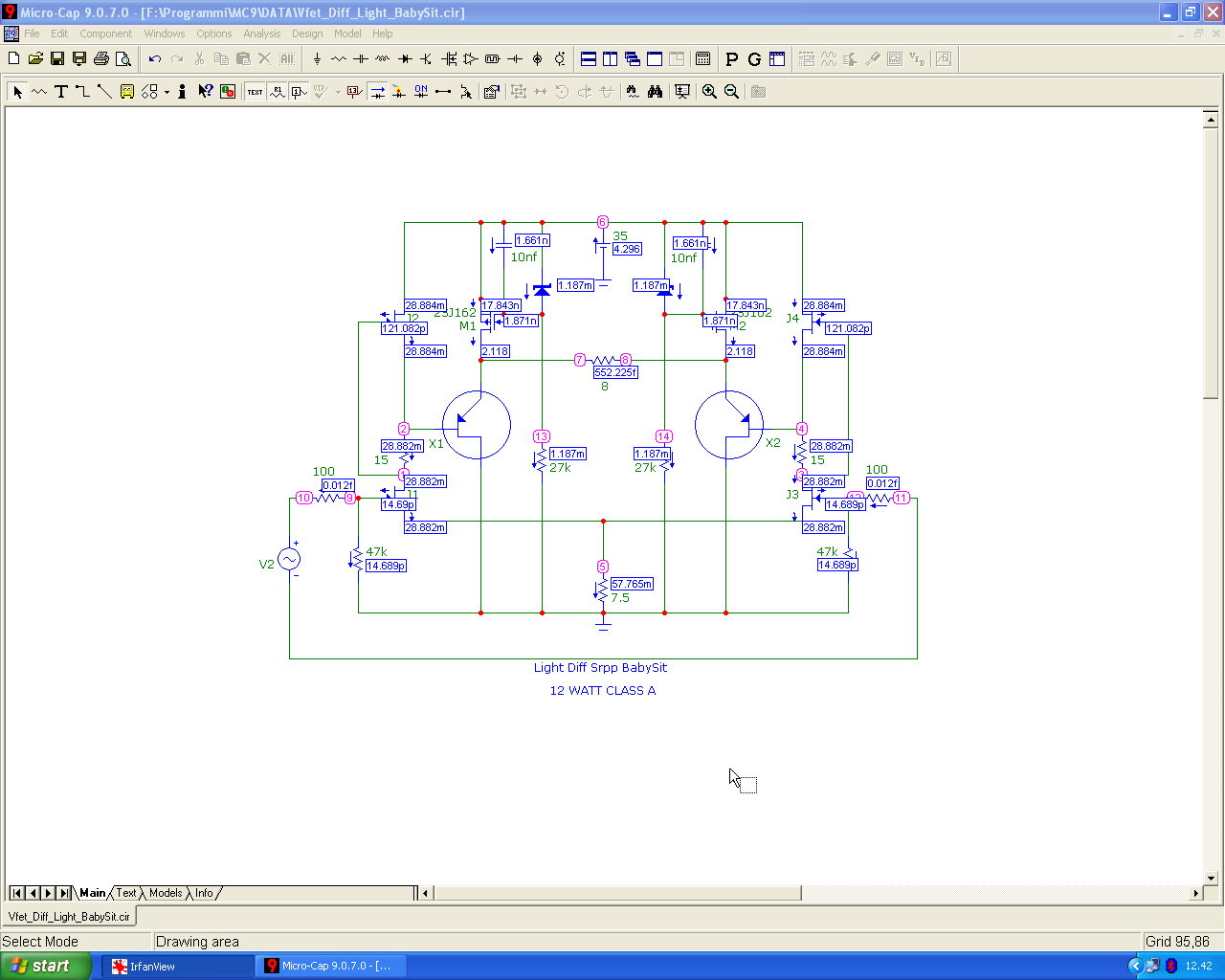

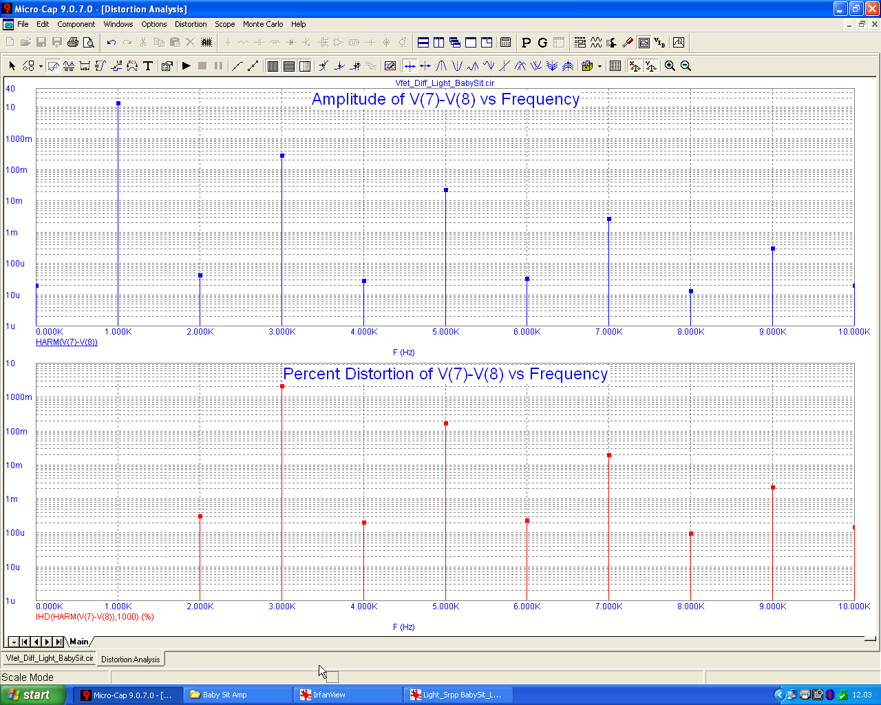

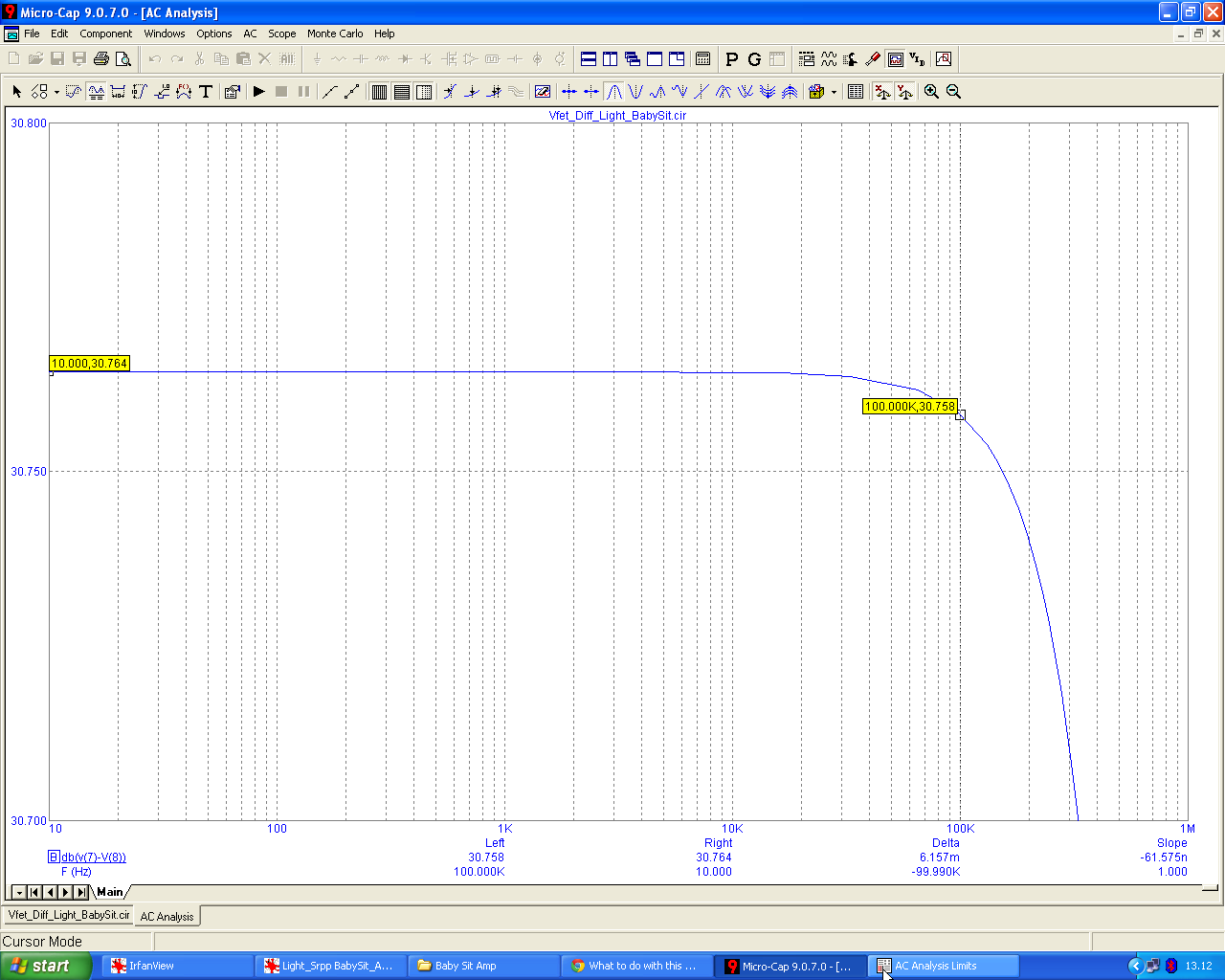

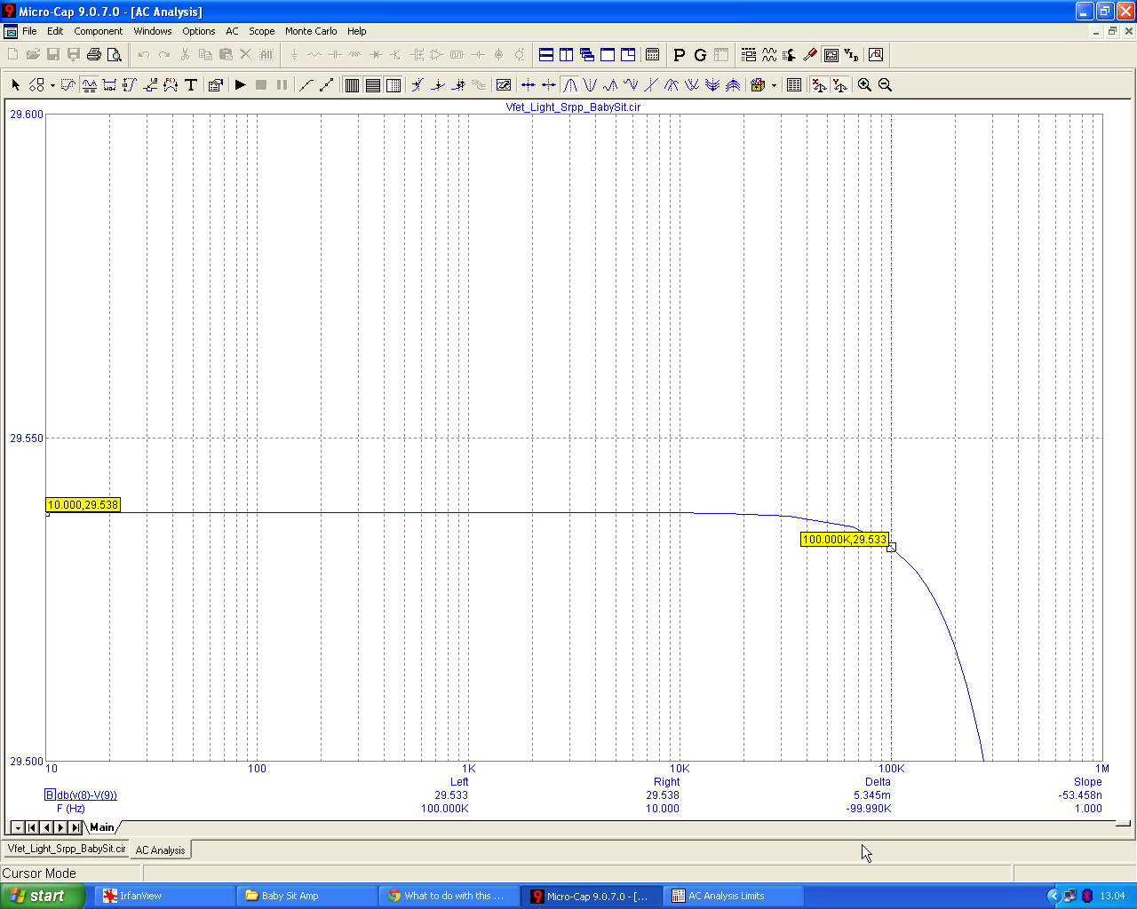

Question on the topology: why not have J1 and J3 share a common source resistor and be a real differential amplifier?
Well, I had not yet shown the circuit with differential input stages (LTP) for two reasons.
- For those who wanted an unbalanced input, I was thinking to use my phase shifter that is better balanced compared to 'LTP although the latter is easier to implement.
- I suspected, as then it is confirmed by the analysis attached, a small performance degradation in both distortion and frequency response.
In the analysis of the distortion of the individual harmonics it is clearly seen that those of odd order remain exactly the same, while those of even order are higher compared to the basic circuit.
For convenience I attach the wiring diagrams, analysis distortion (@12W) and frequency response of the two circuits.
As you can see the comparison was made at par, ie under the same operating conditions.
Light_Diff_Srpp BabySit_Comp_Log_Distortion_Analisys_12W.png148.3 KB · Views: 323

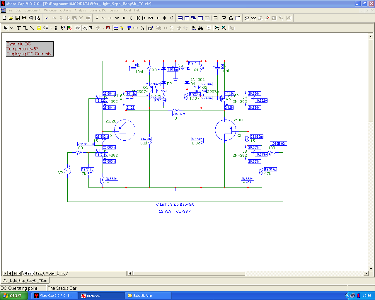

Temperature variations come down to zener tempco and anyway should not be a bog problem unless you were driving your VFETs at the maximum possible dissipation, but then you would still have the problem of different ambient temperature 🙂
At the suggested current the MOSFETs have a negative tempco (I wonder if the models accurately model this!). Still, as I said, putting a zener in G-S and sticking in a J162 you just bought will give you nice lottery numbers for the CCS current. You will either need to select MOSFETs or get a 'variable zener' (TL431, or use a different style CCS (with source resistor for the MOSFET).
a little bit confused, will it be better by using a fixed zener and a resistor on J162 source.
@Mos57 have you tried this option?
I think your confusion stems from the fact that ILMZN took the words of the post No. 107 and then comment the schematics of the post 106.
In the figures of the post 106 are not present trimmer to adjust the value of bias of 2 mosfet with different Vgsth , trimmer whose use has been suggested, though not shown in the diagrams of the post 107.

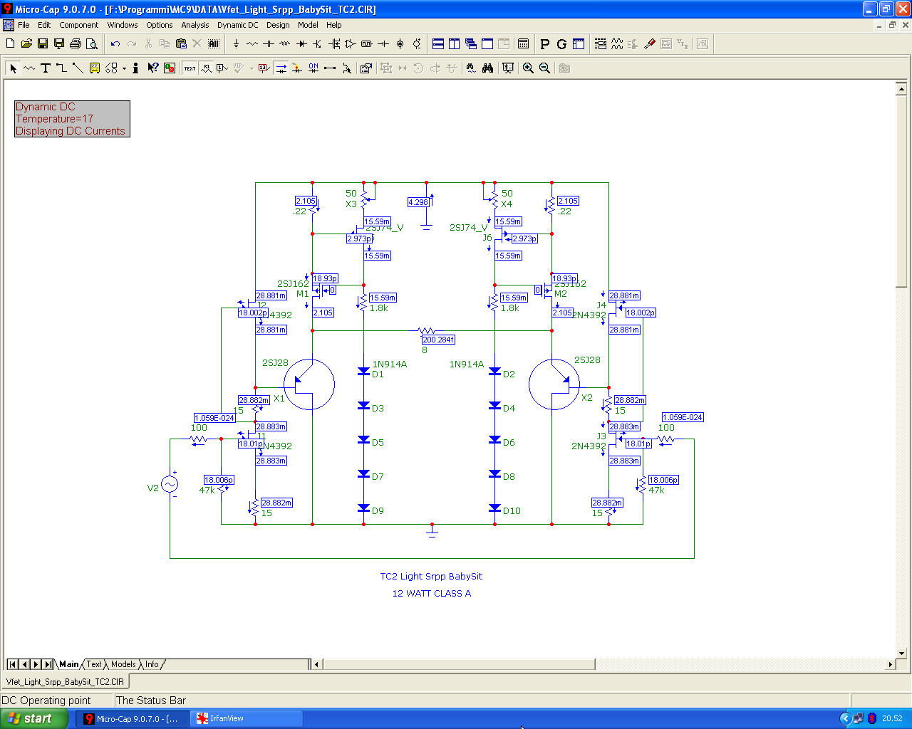

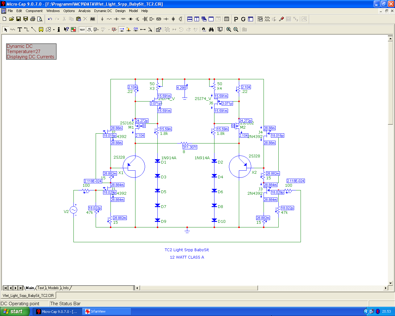

Today, however, I introduce a scheme with compensation for the effects of temperature in which as seen from the attached analysis of the output currents it varies of 1 mA in a range between 17 and 57 degrees in temperature.
The bias current is set by the trimmer X3 and X4, while the rate of temperature compensation is set by resistors 1.13 K (they also replaceable by other trimmers).
Notes: A resistor value lower than that shown produces undercompensation, while a higher value produces overcompensation.
Of course, in the real case will end a calibration procedure to locate the right setting value.

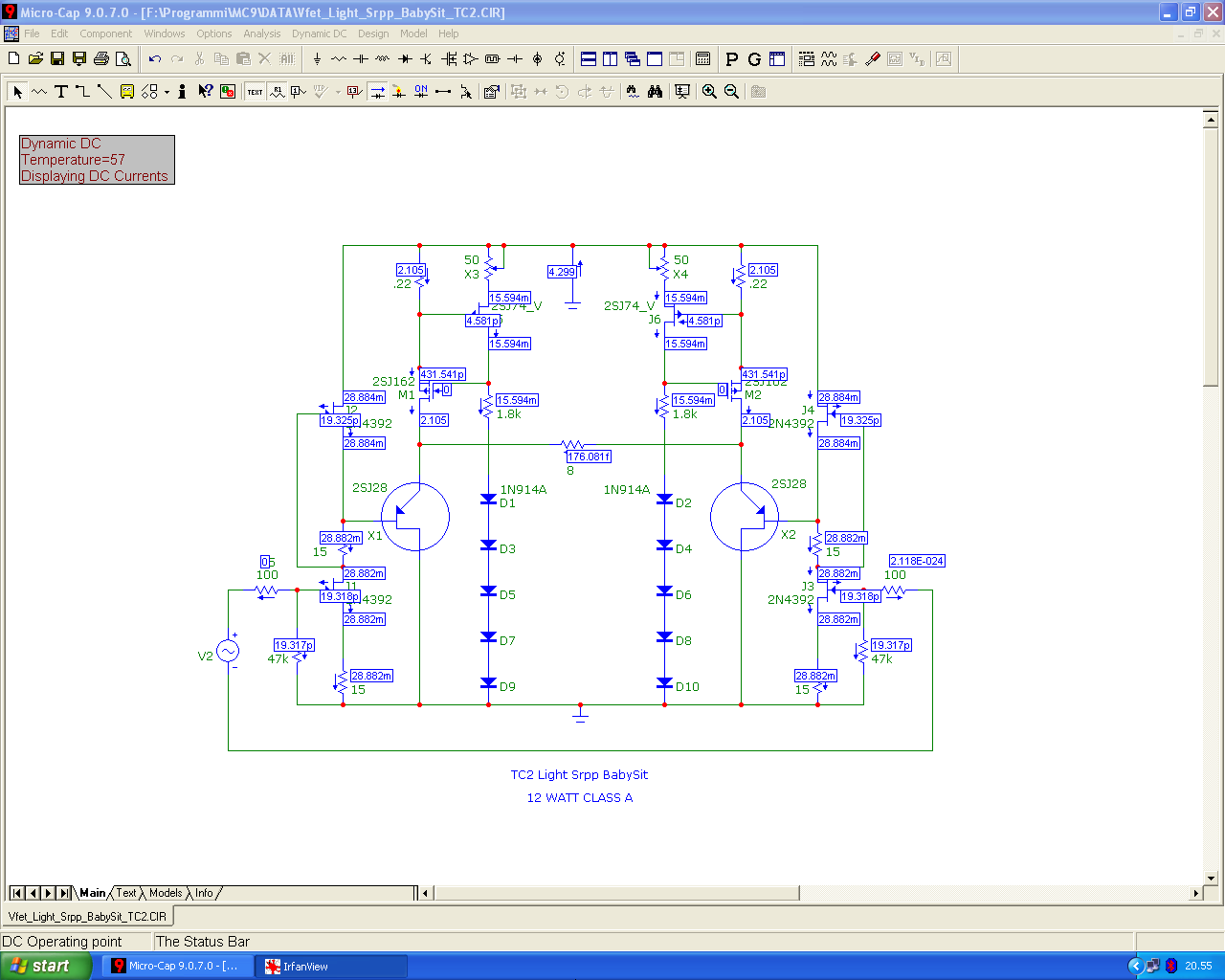

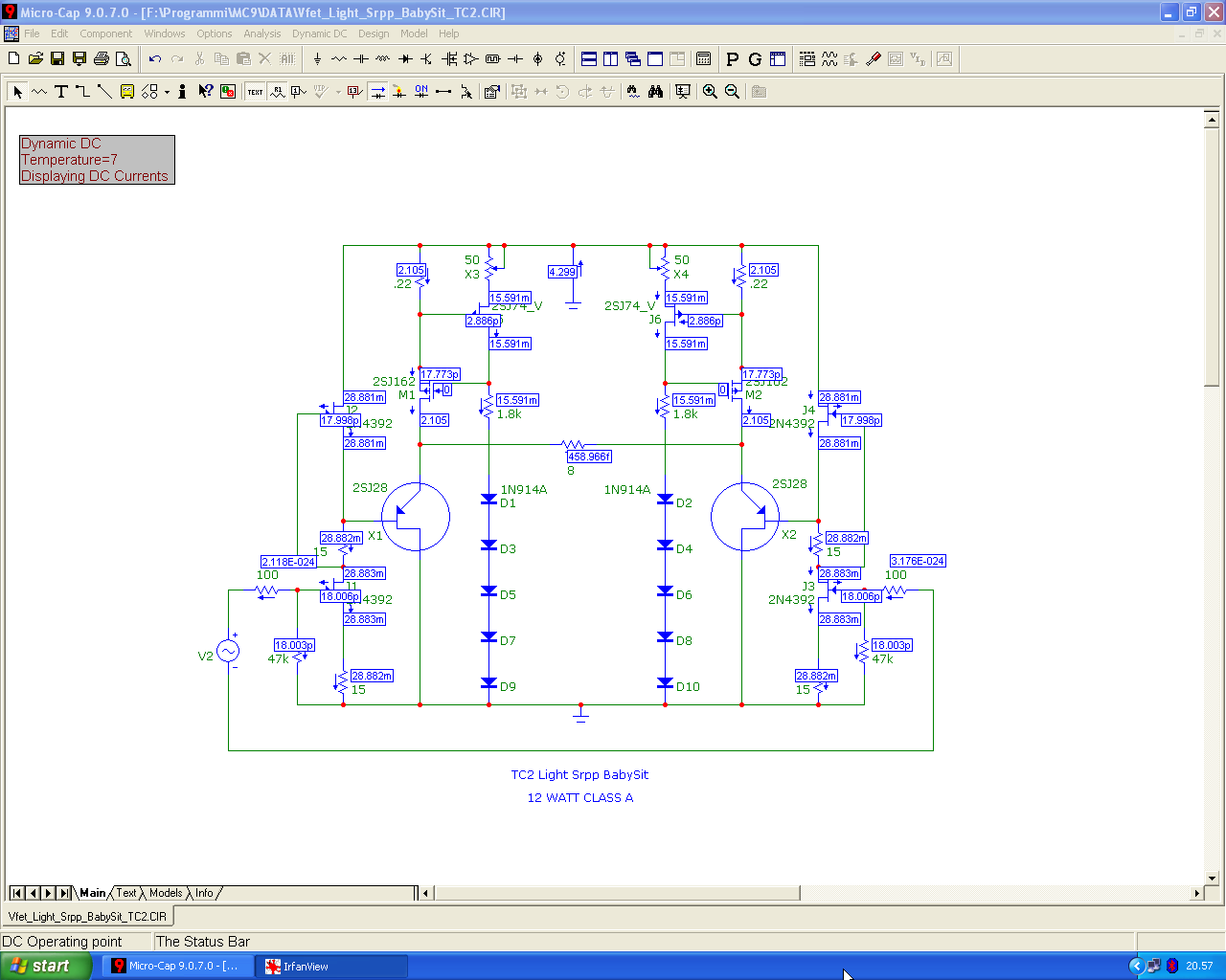

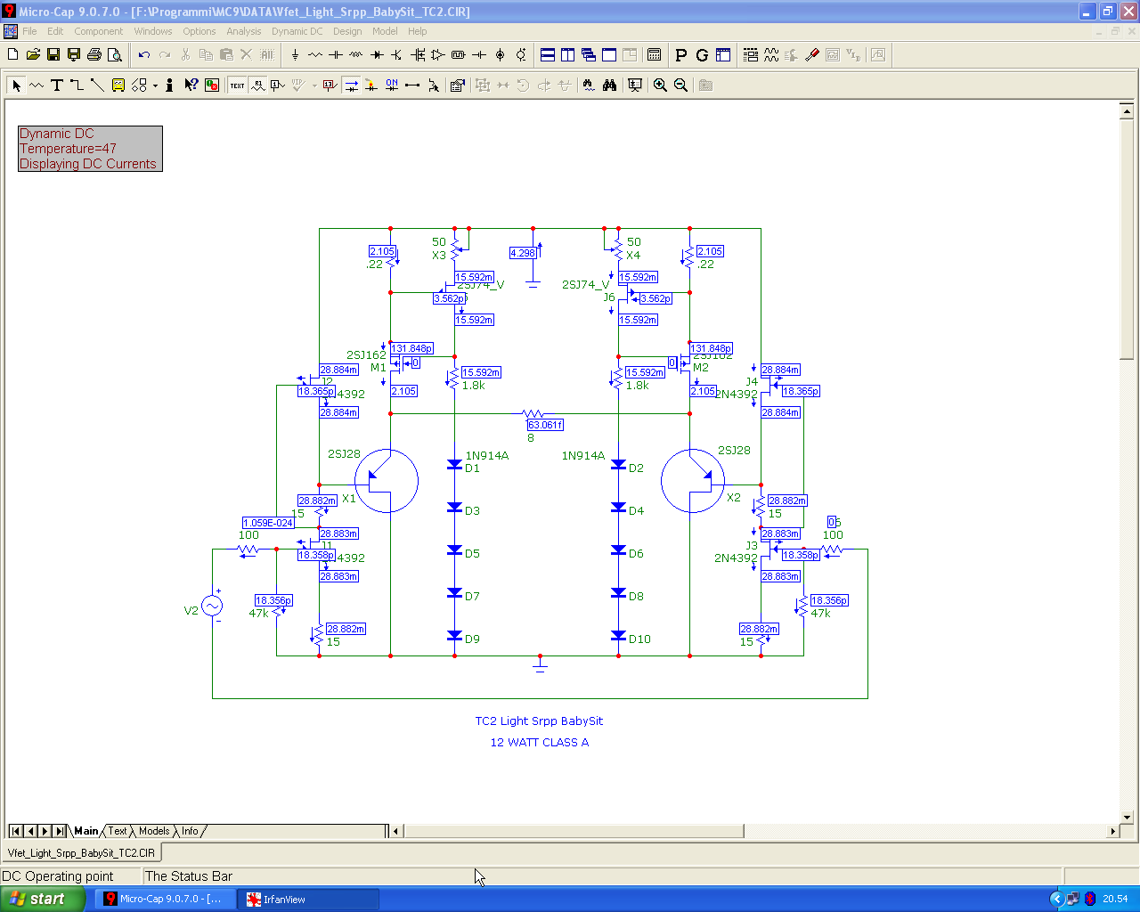

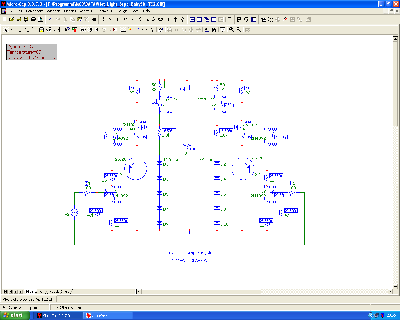

In these days I have developed a new approach to control the output current and stabilize it against temperature variations.
I want to show the circuit because personally I prefer it.
Here, unlike the previous scheme, there is the monitoring of the current through the two 0.22 Ohm resistors.
X3 and X4 set the output bias current
Thermal compensation is carried out mainly by the germanium diodes D1-D10.
A lower number of diodes overcompensate while a greater number overcompensate .
It can also be used the diodes 1N34A type of easy availability on Ebay.
From attached pictures you can see that the current of the output stage varies only 1 mA (0.0475%) within an extended range of temperatures between 7 and 67 celsius degrees.
Errata corrige:
A lower number of diodes UNDERcompensate while a greater number overcompensate, of course. 😎
