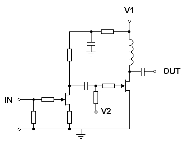

This 2sk79 is no ordinary buffer and is not a cascading thing, its source and drain are actually tied to the input and output of the chipamp, steering the amp's performance which manifested in the unique distortion spectra unlike the chipamp's own : )
This schematic was designed by the great Shinichi Kamijo. He call this configuration STC (Super Triode Connection)

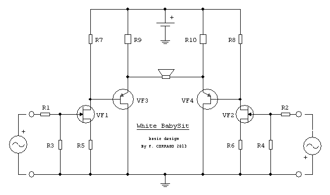

For some time I have in mind a scheme designed just for the Vfet.
In my mind it should have the following requirements.
- very very simple scheme
- one single power supply
- push-pull type with small or medium output power
- tracking of variations of the mains voltage (Illzman)
- balanced input
- no auxiliary circuit required To safeguard the Vfet from destruction at startup and shutdown.
- no input capacitor
- no output capacitor.
- upgradable for unbalanced input (using the new Fully Differential Phase Inverter) and also with dual power supply.
The project is currently in its infancy and did not want to present it yet but given the Vs. curiosity I might be tempted to anticipate here.
What do you think?
The conceptual scheme you see it below.
the basic idea from which I started was to explore the possibility of using the resistors as load resistors and as source resistors for providing the bias (automatic bias) to the gate.
Someone may then replace them with a pair of CCS, or a pair of inductors, for to increase the power or the efficiency of circuit, but obviously I would start with the simple resistors.
We can also decide to operate the Vfet in class A or AB.
The circuit is designed with the input Jfet of N polarity with an eye to those who want to use the 2SK79 to achieve a completely Vfet amp.
Obviously you can achieve all complementary devices: just invert the polarity of the battery.
There are no component values because we can choose them together: there are many people prepared around here.
I did a spartan simulation and the circuit seems to work, but I do not have any Vfet model for Microcap. Is there anyone who can help in this regard?
Otherwise I'll have to (or you will have to) find the time to realize the real circuit.
Comments and suggestions are always welcome.
Francesco.

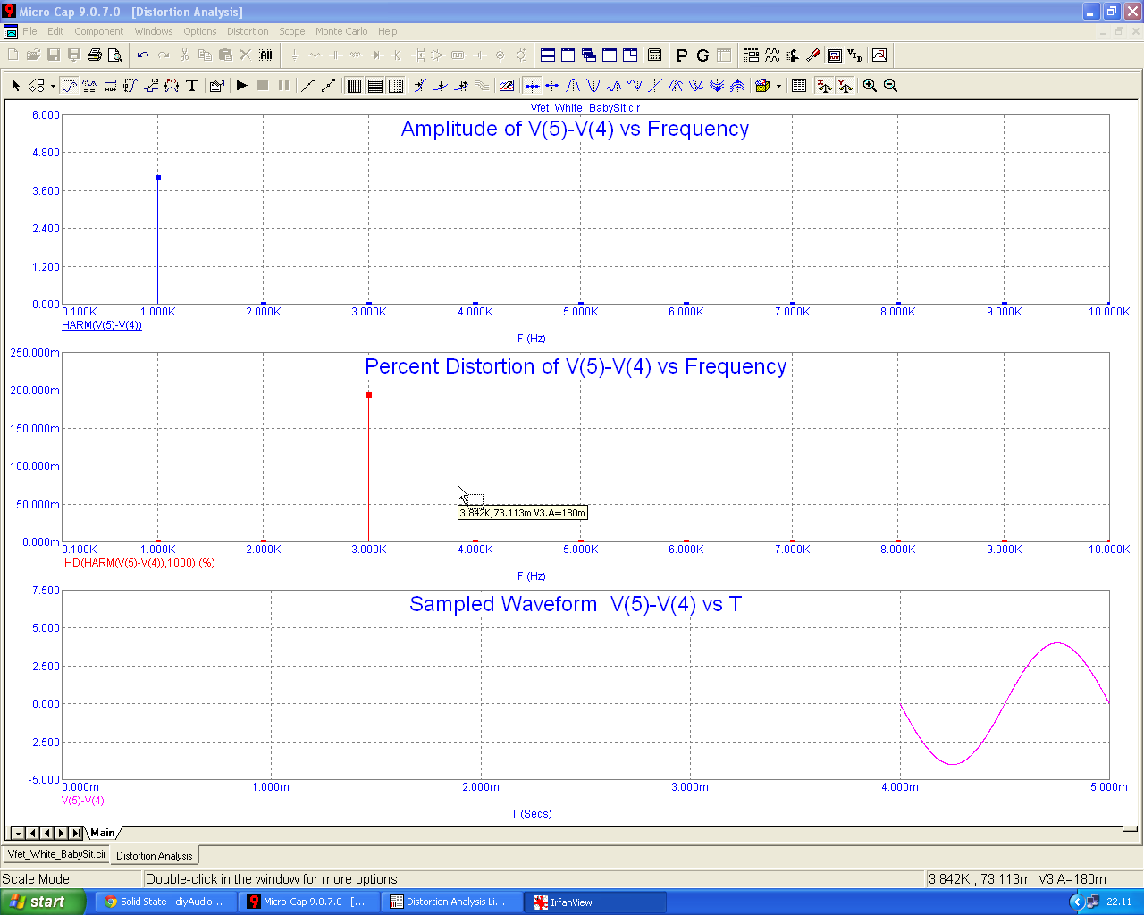

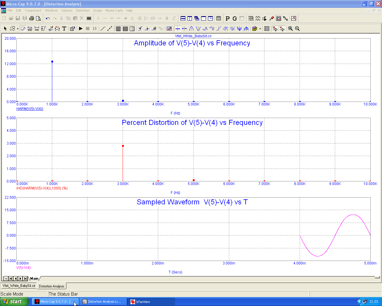

The baby is born
PSZ, thanks for the suggestion and thanks to Michael.
Yamahear, You're welcome.

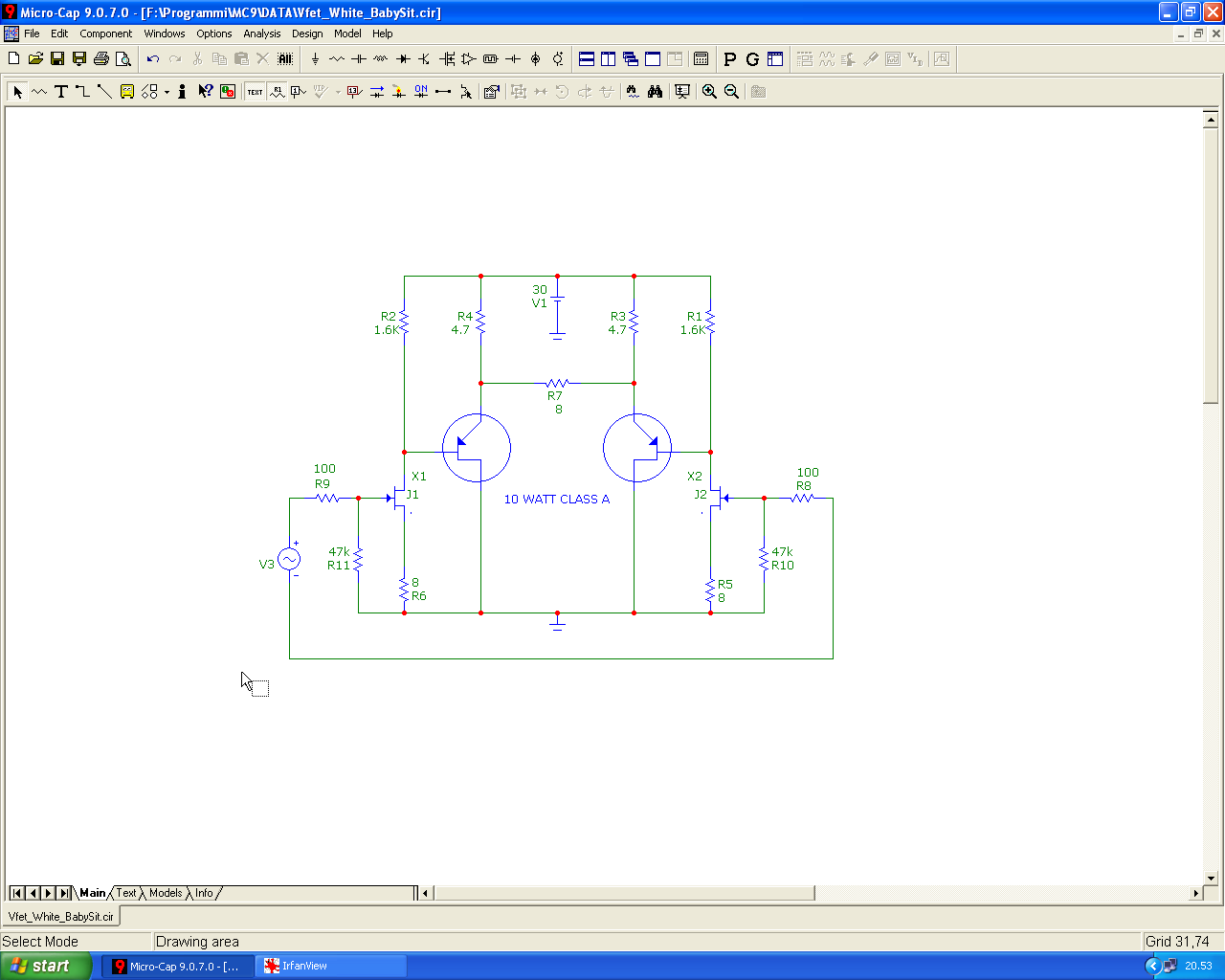

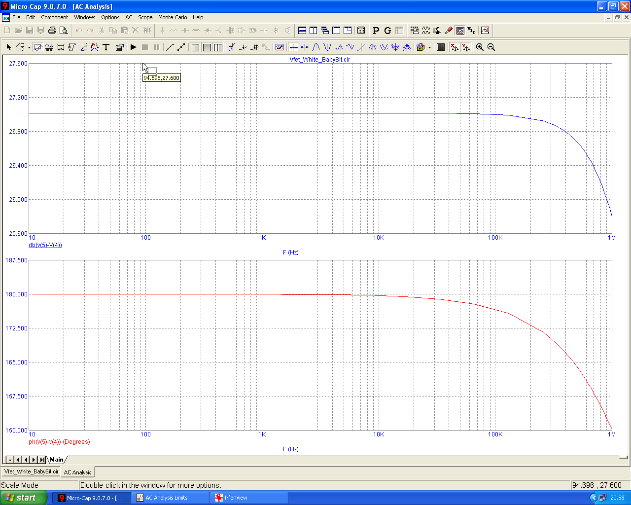

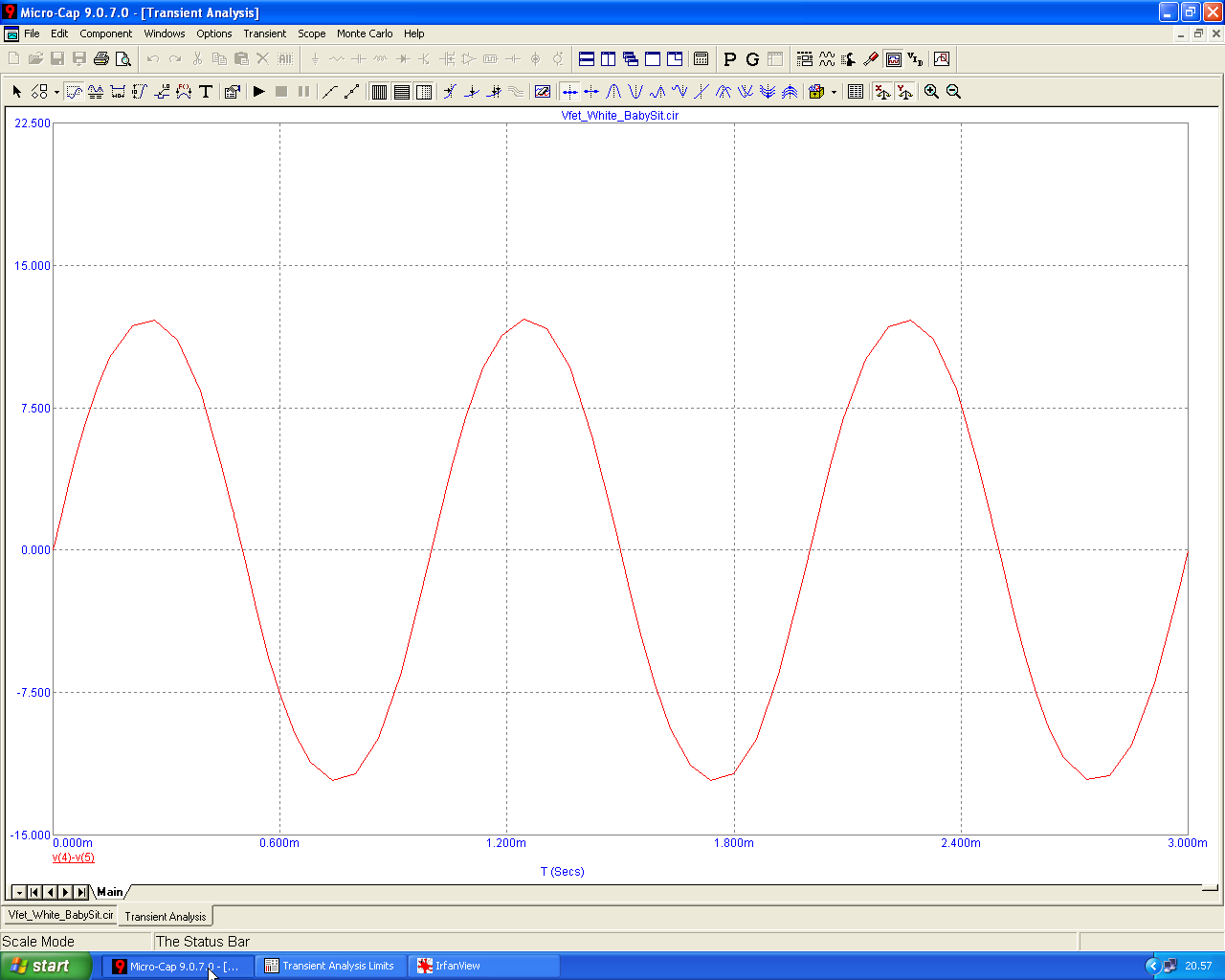

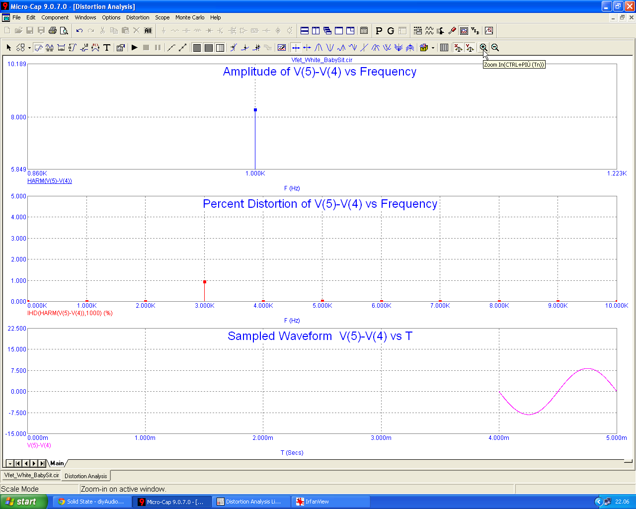

In these two days I uploaded the model of Vfet and did some simulations.
Attached are some pictures of the circuit design and the results of microcap.
Francesco

Looks interesting Mos57, its a balance input..is the Vfet J18 and what is the Jfet you use in the sim?
Hi, sorry I have the 2SJ28 Model only, but it is possible to use 2SJ18 in this circuit, i think.
The input Jfet is 2SK170V but 2SK369V is also very good.
