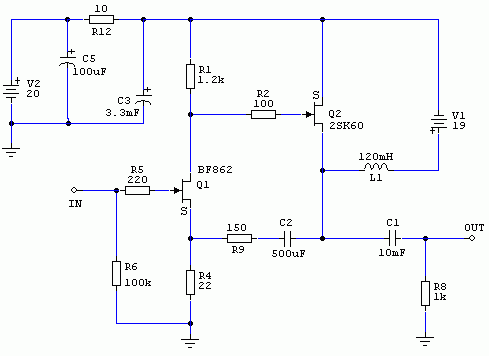

Some time ago I got some VFETs and have made a SE 5 Watt-er just to test the VFET in an amp.
Q1 is a standard JFET working at about 8mA (2SK170V can be used too). Its drain resistor (R1) provides a Vgs needed to bias a VFET (about -10V, for Id of about 1A). Working load for k60 is a 120mH choke (made by my friend, and I still wait for another one to make another channel).
V1 powers the Q1 and the V2 is a 60 Watt PS for laptop PC. The gain is set by R9/R4 ratio. The schematic can be further improved, but this simple one is quite enough to get a feel of VFETs. I made just one channel and it sounded very nice, so here it is...

Very interesting design, but has two points which can be improved.
1) Why not simply connect the load in parallel with the inductor? If it's sufficiently low DCR it will only have a very small DC component on it and you can get away without the 10mF cap. But that's only one problem - the way it's drawn (load to ground), the output cap and the 3.3mF cap from source to ground are actually connected in series - so the effective series capacitance is 2.48mF. Using the 'in paralel with inductor' trick, there would not be this effect, even if you still have to block the small DC with an output cap, and the 3.3mF cap could be far lower (it's actually only used to establish a ground reference so you can use feedback).
2) There is a slight problem with connecting the feedback like this but as the schematic is drawn, it's unfortunately the only way. The side effect is that there will be an increase in LF response (potentially quite high, in the subsonic range) if the time constant of the output caps and load is higher than the feedback cap and resitor, which happens if the load is of higher impedance than expected. As the schematic is drawn, the actual feedback point could be simply connected to the output after the output cap, with a slight correction in resistors to keep proper biassing as a small DC bias current will run through the load.
I think you may get a truly elegant design using the 'in parallel with inductor' trick and balancing the time constants of the NFB with the ground reference cap from the source of the VFET. In any case I like what you did, just keep your VFET properly cool 🙂 it's only intended for about 60W of dissipation but only if you keep the case temperature at 25 degrees C. Realistically, due to the thermal resistance of the case itself and the interface to the heatsink, 30W is about the maximum you can get with a VERY big heatsink.

1) Why not simply connect the load in parallel with the inductor?...
Easier said than done - choke's Rdc is 1.5 Ohms and Q2 has Id=1A which will set the DC offset across the speaker at 1.5V and that would be way too much (200 mA or more of DC current through 8 Ohms speaker's coil). 120mH choke is made with 1.2mm enameled copper wire and it is big - using a thicker wire is an option, but it demands a bigger core which will make the choke even bigger....
The rest of your proposals are OK and can be easily tested so that every builder can find out what suits his system (speakers) the best.

In your simple design, V2 is 20v and V1 is 19v...is V1 a separate supply, or just the result of the dropping resistor 10 ohms R12 subtracted from V2?
I'm planning to use 48v,7A, supply which i have now and use higher voltage Jfets...what must be the IDSS rating of the Jfets required and resistor values adjustment?

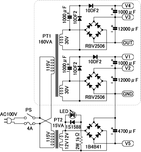

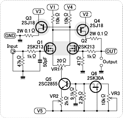

You said about circlotron....Is this circlotron from this 2SJ18 CSPP Power Amplifier

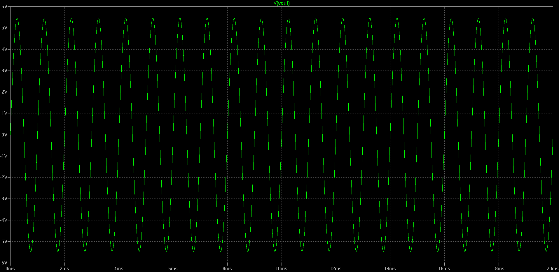

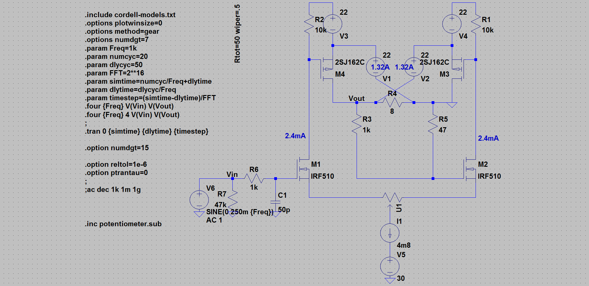

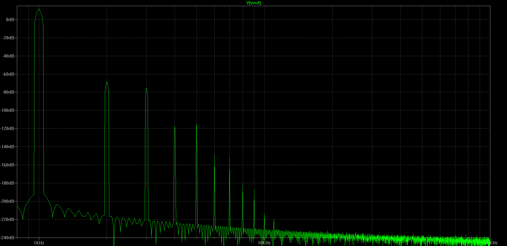

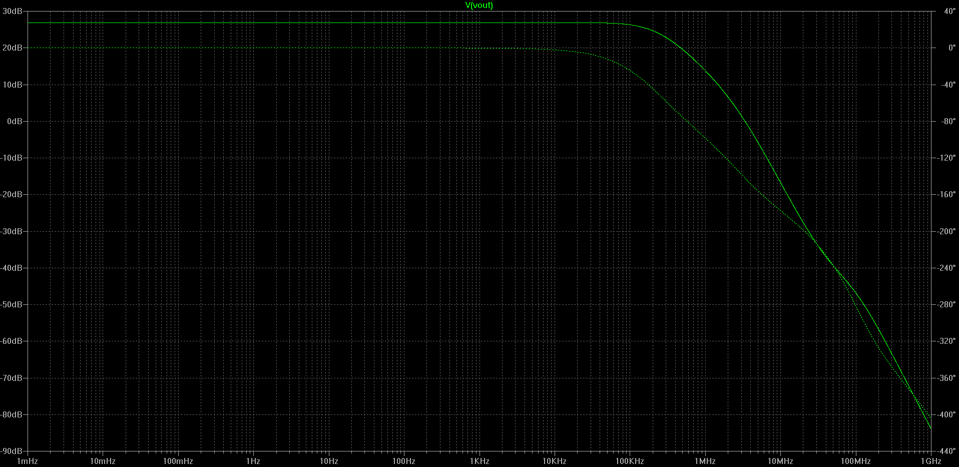

What can you comment on this?

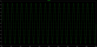

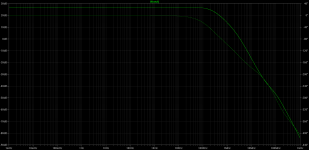

Hi
please look what great potential has this topology:
Harmonic Frequency Fourier Normalized Phase Normalized
Number [Hz] Component Component [degree] Phase [deg]
1 1.000e+03 5.464e+00 1.000e+00 -0.21° 0.00°
2 2.000e+03 5.437e-04 9.951e-05 -82.57° -82.36°
3 3.000e+03 2.502e-04 4.579e-05 26.27° 26.48°
4 4.000e+03 1.901e-06 3.480e-07 -158.70° -158.49°
5 5.000e+03 2.493e-06 4.563e-07 -134.52° -134.31°
6 6.000e+03 5.199e-08 9.515e-09 35.90° 36.11°
7 7.000e+03 3.657e-08 6.692e-09 59.92° 60.13°
8 8.000e+03 1.078e-09 1.973e-10 -135.99° -135.78°
9 9.000e+03 5.980e-10 1.095e-10 -87.74° -87.53°
Total Harmonic Distortion: 0.010954%
  • circlo pmos 162.asc
    circlo pmos 162.asc
...In your simple design, V2 is 20v and V1 is 19v...is V1 a separate supply, ...?
Yes, it's separate PSU. I chose 20V to supply the JFET (I wanted JFET's drain at half of the V2 voltage and 10V to bias the VFET, in order to get 1A bias through it). V1 is 19V because it was convenient - it's standard value for laptop PSUs which are cheap and abundant and it suits my power and heatsink requirements. V2 needs to supply only about 10mA per channel. Each channel should have its own V1 which can be of higher voltage and/or current (depending on your speakers and power demands) but, as ilimzn said, don't go over 30W of thermal dissipation per VFET.
Shinichi Kamijo designed some SIT/VFET amplifiers and some of them are reprinted to the internet including this site.
He died last year but his website is managed his brother today.
Oh, I'm very sad to hear that. He always had very interesting topology amps.
J27/K77 SEPP design
Report
(J27! the myth do exists in the world! )
I know, I have several 🙂
Also, there is a J25, notionally complementary to the 2SK75m used as a driver and cascode amp in the Yamaha B1.
Yes, if thicker wire increases choke size, then it has to be longer. At some point you get to negligible drop in DCR while the choke cost increases rapidly.
My idea was mostly to connect the load in parallel to the choke for AC (and DC if possible because it removes the cap - however, not possible in this case). So, in your schematic, the default load (1k resitor) and the load itself - the side connected to GND is moved to the 19V power supply end of the choke. This automatically removes the load current from the 3300uF cap, while all the rest stays the same. It may also be possible to transpose the load and the 10000u cap so that the connection of load and sap is at a lower DC voltage, it may be possible to establish correct DC parameters for a JFET even without the series cap in the NFB network. If not, connecting the NFB network 'after' the 10000uF cap will include it in the NFB and reduce the cap's influence on sound. However, carefull attention is needed to the value of the NFB cap and also perhaps an input cap to prevent a gain peak at LF, because the NFB will also attempt to compensate the 10000uF cap roll-off at LF, which results in a gain peak at LF and increase in distortion,
In any case it's a very interesting design. A possible variation could use an auto-former and run the VFET off a higher voltage, at lower current, so pushing the operating point into more linear regions, but as it is it's a very nice minimalistic design.
If you want a push-pull design my choice would be a circlotron topology which, by its nature, deploys the same sex devices. If all your VFETS of the same polarity belong to the same Vgs/Id rating groups that eliminates the problem of using complementary VFETs that belong to different groups.
I wholeheartedly agree! The CSPP amp schematic is a good start, with a bit of jiggling around the ground references it can have complete symmetry and still be quite simple (except for a number of power supplies - but CSPP always have that 'problem'). Again, it's also possible to use a center-tapped autoformer in such a design to get the VFETs into the more voltage, less current more linear areas, and in this case the added bonus is that the DC currents in the autoformer cancel out. Since the required inductance and ratio is low, assuming one takes care of DC balance, this could be even wound on a toroid core and offer quite high performance. Ah, so many ideas, so little time 😛
Hi Mr. Mos57, i have some of your schematics...what do you think is the best schematic suited for my Vfets? they are not at the same rank so, can I use your complementary schematics? are those running in class A?
Thanks...
Sorry for the delay.
Not suited for complementary schematics. Mine was optimized to work in class AB but they can work also in class A, mainly bigger capacitors in PSU and heatsink only.
