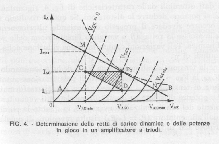

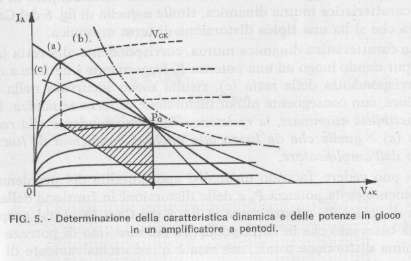

The performance of a Vfet amplifier is, similarly to that of the triodes, very low.
The poor performance is due to the shape of the output characteristics that do not allow large voltage excursions.
In particular, the minimum voltage reached is significantly higher than that of a comparable pentode or transistor stage. (See the two attached images)
In that the useful power is represented by the triangle.

The graphs posted are related to generic triode (similar to V-FET) and generic pentode (similar to MOSFETs and bipolar transistors).
On my website you can still find the curves of 2sj18 and other v-fet that I have measured.
Unfortunately my curve tracer is for small signal devices and not very suitable for precise measurements of power devices. It seems that ILLZMAN is equipped with a professional curve tracer . Having the 2SJ18 he could measure and post the pictures.
But to understand the concept expressed in the previous post, also referring to the image downloaded from the site, and removing the first three curves to the left (area just not linear), then drawing on it the load line , we can see that the minimum voltage will not be less than 8 - 10 Volt about.
Therefore the maximum excursion of the signal will be less than it with respect to the power supply voltage. It follows that to obtain the right excursion we must move the operating point 10 volts to dx (more) and therefore the power supply must generate 10 volts more than necessary.
So the stage employing a Vfet must be powered at a higher voltage than equivalent transistor or mosfet stage and this more voltage is wasted.
It makes vfet stage less efficient than other devices.

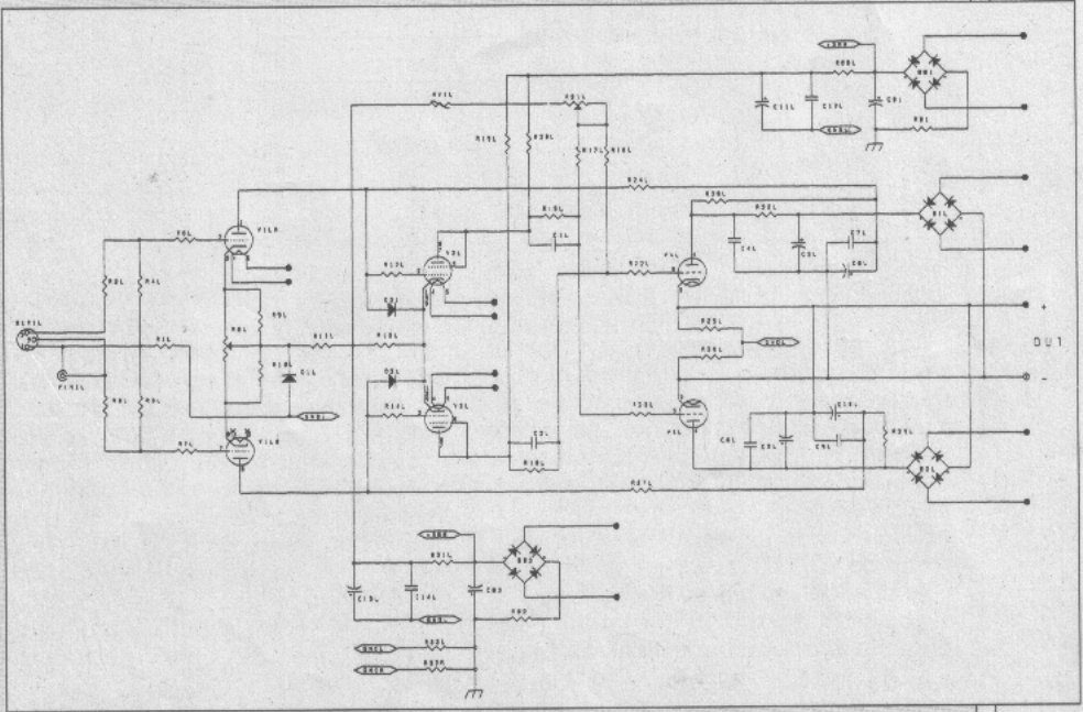

It is possible the direct coupling without interstage transformers
The driver circuit must be powered with a dual voltage PSU, so that output from the driver have the bias voltage for Vfets.
Take example of the schemes ATMA-SPHERE but especially by the attached Graaf scheme, (unfortunately in low resolution), but it is enough to know how to play with the voltages of the circuit.
In fact, the GM-20 is, whatever you do, a full DC coupled circlotron.

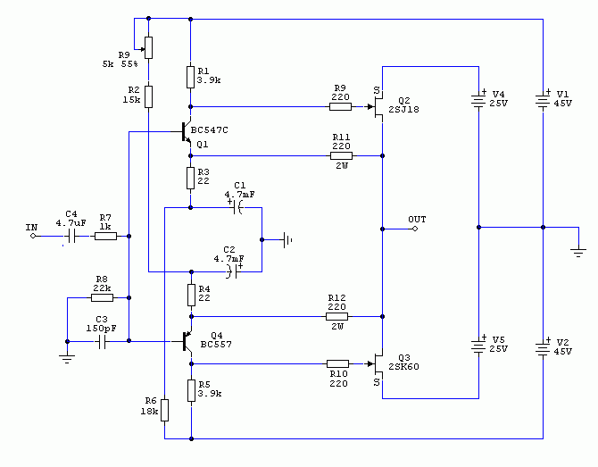

Junm,
If you look for complementary design that will use both P-ch. and N-ch. VFETs, why not make it using a proven F5 topology:
In order to properly bias the VFETs we need additional rails (V1 & V2) but we can easily make them from main rails (V4, V5) by using a voltage doubler. V1, V2 need to supply only about 10ma per channel each.
R9 pot will set the DC offset at the output. R6 and R2+R9 determine the current through input BJTs (as drawn it's about 2.5mA - you can use CCS here).
I think that 1A is a nice bias for K60/J18 VFETs (at 25V Vds) so I set the values of R1 and R5 towards that goal. If you want less current (VFETs closer to AB class) just raise the value of R1, R5.
The gain is set by R11/R3 and R12/R4 ratio (20dB as drawn). C1, C2 (4700uF/6.3V) provide AC ground for input BJTs' emitters.
You can avoid additional V1, V2 rails if you use VFETs as Source Followers which would be pity, considering their unique triode properties which really come into play when they are used as voltage gain devices.

Now I see that I drew C1, C2 polarities incorrectly in the post #54 schematic - they should be the other way round...

Yes, but first you measure your VFETs (Id vs. Vgs at Vds=25V) so you can match their working conditions (the value of R1, R5 and R2+R9, R6). The point is to make VFETs to pass the same Id so you'll have the zero DC offset at the output....BTW,will this thing work even my Vfets are not of the same rank?
It can be done in the circuit by making a R1, R5 5k trim-pots (as in original F5 circuit), but here you'll start adjustment process with a maximum value of pots and turn them slowly until you get the wanted bias and zero DC offset at the output. In this case you don't need R9 so R2, R6 can have the same value.
I guess i will consider both option as to adjust operating points.
So R1 and R5 adjusts the offset voltage and R2+R9 and R6 will do the bias current, am i right?
