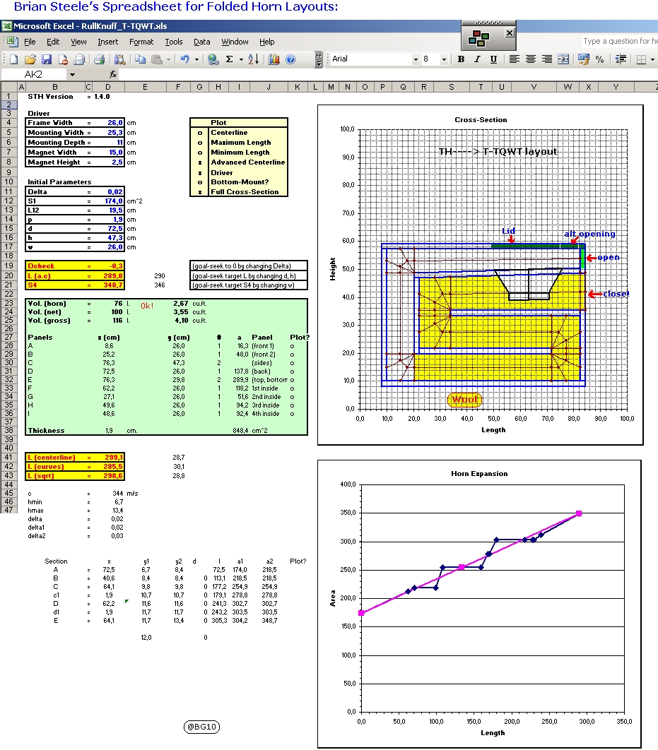

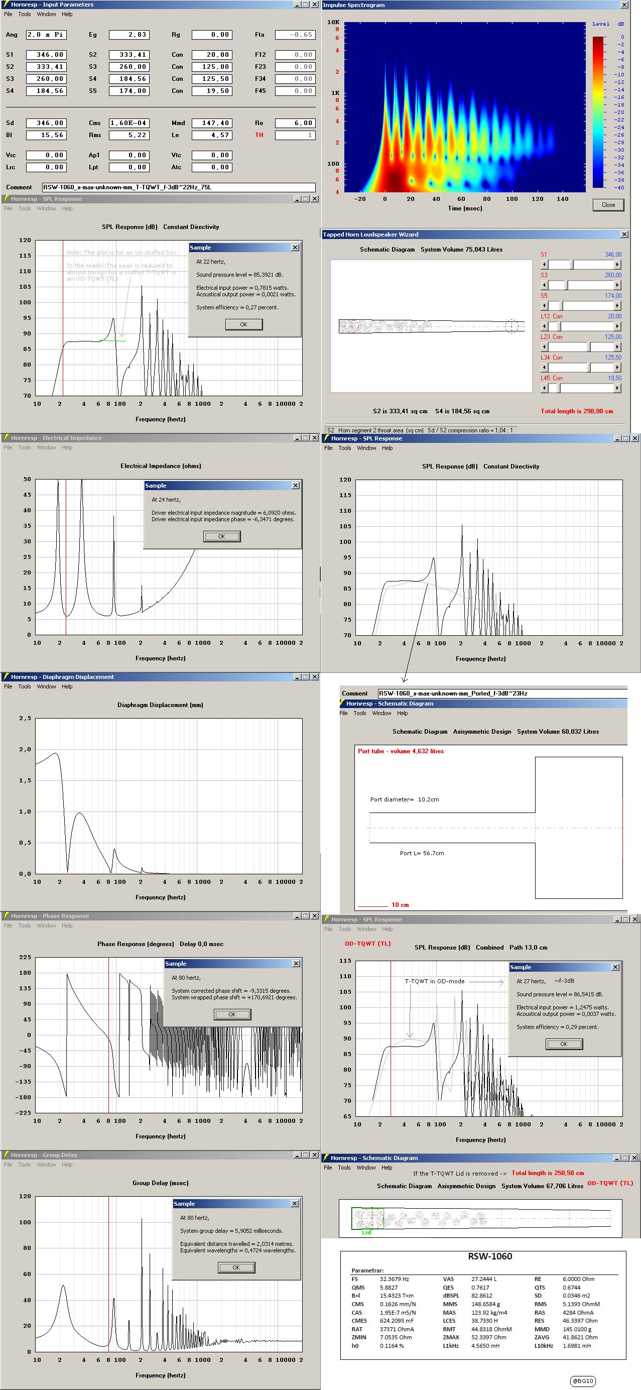

I wont spoon-feed you with more simulations as you seems to lack very basic knowledge how to interpret my sim.-plots…but here is a
Brian Steele’s Spreadsheet for Folded Horn Layouts:
http://www.diyaudio.com/forums/subwoofers/171747-spreadsheet-folded-horn-layouts-6.html
b

I´ve built ugly testboxes from 40L up to 80L ported and even tried them in my SLS10s 42L closed box. Played with parametric filter and different Q-settings. What´s funny, they sound good in all of them.🙂
My decision was from the beginning to build (cheep and fun) real small boxes, as small as possible, and make room for plenty of them.
The big problem is the portlength, it tend to be far to long. So 54,4L was my not so bad compromise.
Have not tried isobaric yet. I´ll put them outside my boxes front/front.

Now i see something that looks like a box. Tack Bjorno 😀
