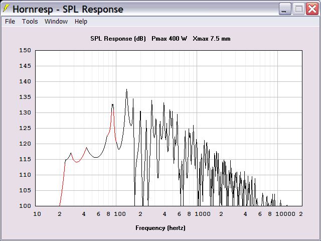

..Or put the 'A' version into use in a TH if the BW can be accepted..
Right, when I saw your specs I immediately thought of a DTS concept. Looks pretty good down to ~23 Hz in 1pi space/400 W/7.5 mm Xmax in ~62.8 L net, though of course being tuned this far below Fs it will probably need a steep high pass to protect it if told to play any pipe organ or similar:

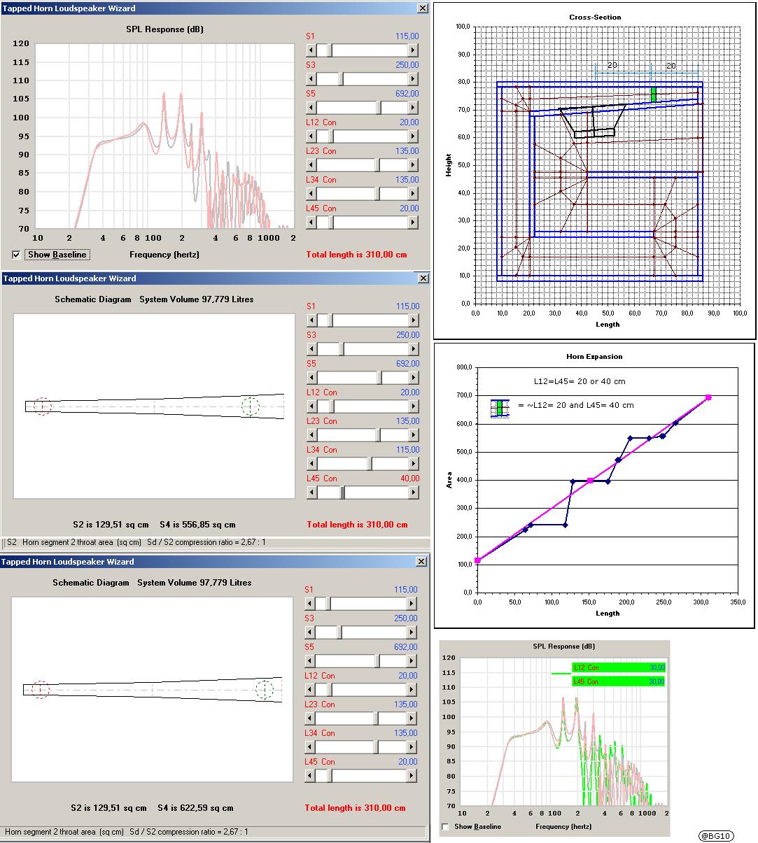

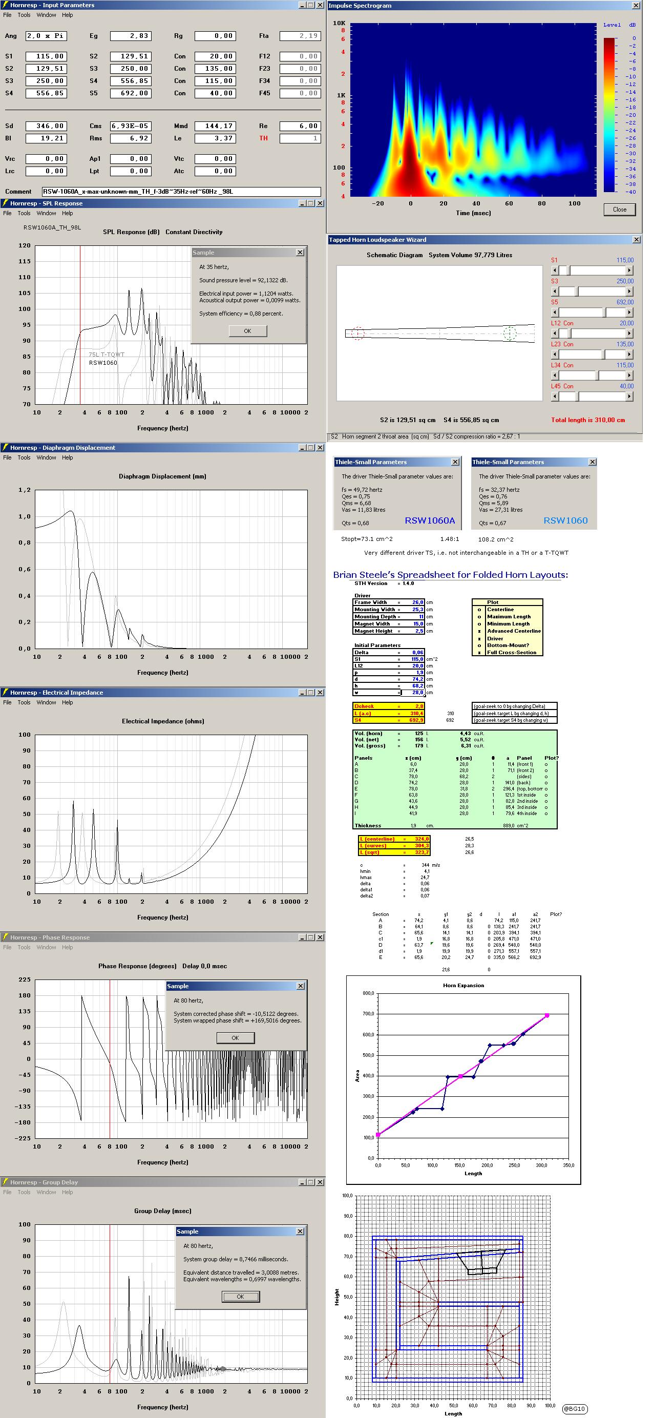

Would it be a problem to design a box with enough bracing for me? And would it be difficult to build?
bjorno's or my sim? I mean you basically just put in dividers like I showed or even just a number of short scraps to mimic a long divider. My sim would best be laid out like the DTS-10 since it has an expanding portion at the closed end like it, so you would have to design your own layout or get someone with more time/willingness than me to do it unless Brian's new Excel folding designer can handle it.
WRT 'difficult', that depends on your woodworking skills, available tools. This guy made a router jig of a similar design's internal baffling and claims to have quickly, easily routed out the two side panels, making assembly quick/easy: http://www.diyaudio.com/forums/subwoofers/172025-th-spud.html
GM

OK, bjorno's can be done as a two-fold, but then it will be a tall column. Mine have a very long path-length, so can't be done this way unless you have > 9 ft high ceilings.
