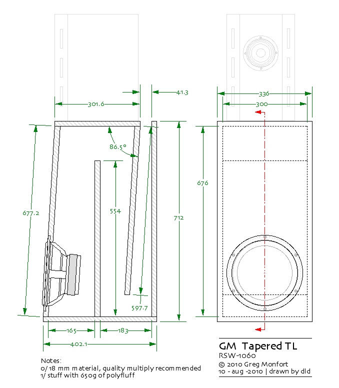

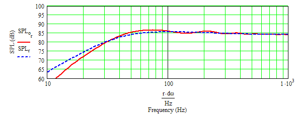

Very tall? Well, i don't mind if i could place my Mar-Kel70's on them at a reasonable height.
It's 80" long, so folding it in half will make it a bit tall for a stand and in fourths maybe a bit too low, but thirds puts either the driver or terminus up off the floor too much for max boundary loading.

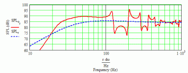

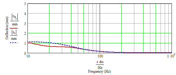

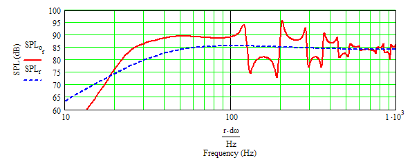

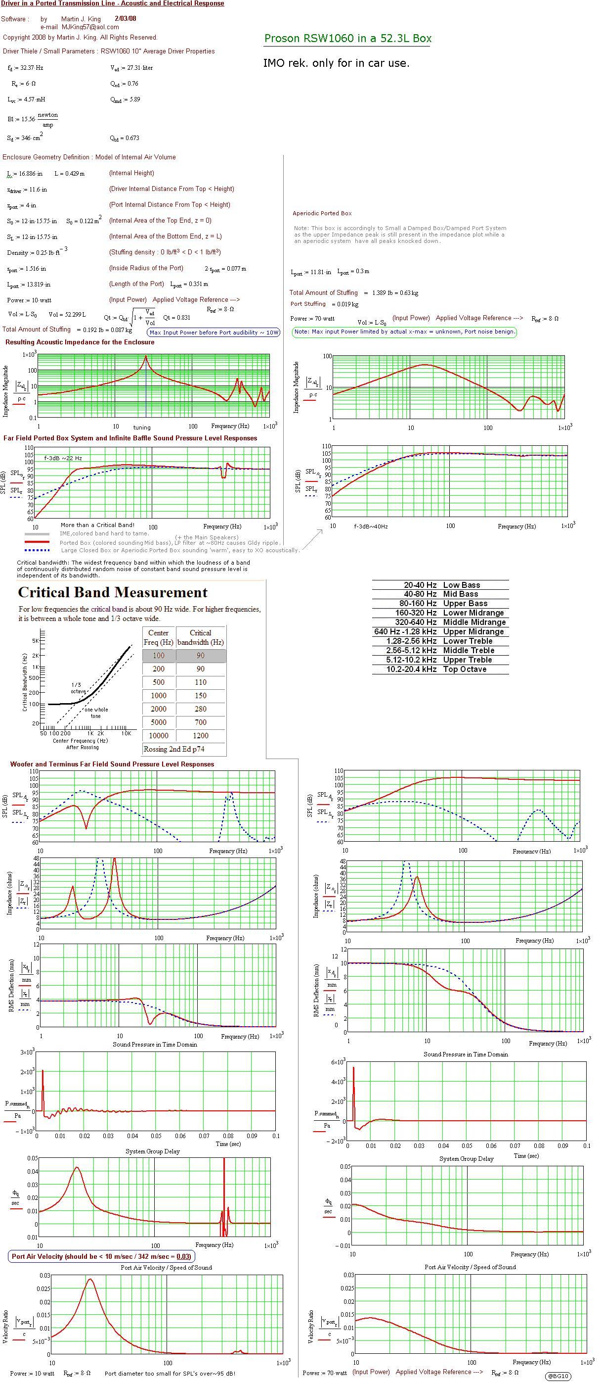

Anyway, it's a reverse tapered TQWT with a 75"^2 closed end and 15"^2 at the terminus with a 15"^2 baffle thickness vent. The sim uses a 0.75 lb./ft^3 polyfil stuffing density. Dashed trace is an infinite baffle response (>3900 L), so not too shabby for only ~54 L plus its excursion is better damped.

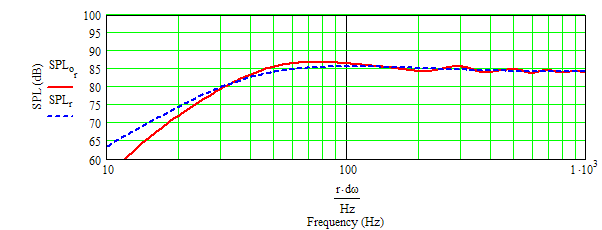

Hi GM,
A quick question if you not mind .....
What would be the effect of moving the driver from the bottom of
the baffle to the top, that would be near say 1/4 length positioning.
(Related to P10's 3 fold cabinet drawing)
The reason I ask is avoiding max boundary loading is the fundamental
principle of smoothing the excitation of the main room modes, though
you need to cross the subs over low enough to avoid the floor dip.
Rgds, Sreten.

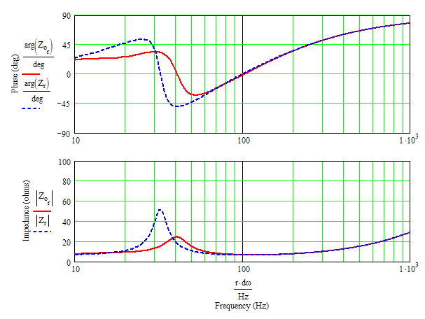

How does this look?
Do you have an impedance plot?
At a glance it looks fine, though as I implied I'm all about getting as much acoustic gain as practical to increase tuning flexibility, so the terminus ideally needs to be at floor level also. WRT any discontinuity in the bending, within reason, its stuffing density is adequate to smooth it out.
To make it ~aperiodic, i.e. ~completely damp its impedance peak/flatten its phase response will require shortening its path-length while ~maintaining its net Vb.
GM

Hi GM,
Greets!
Moving the driver down the length of any taper (straight, positive or negative expanding) TL reduces its fundamental + harmonics loading and introduces a second set that comb filters with them, shifting its F3 up/down based on the taper and stuffing density and shifting its harmonic structure higher up where it takes less damping to quell them. In short then, when the right offset is found you'll get the best trade-off between damping, widest ~flat BW. Refer to MJK's excellent Classic TL alignment doc for what the math told him.
My way is a bit different since it's more intuitive/experience than math derived, but don't look all that much different in a sim, so would have to A-B several different pairs to see if they are audibly different and/or which sounds more life-like.
My SWAG though is that floor bounce and the eigenmode between the driver and any near boundaries is more important than hitting a theoretically ideal point along a TL's path-length, so at minimum I'd want the speaker setting on a very absorptive pad and angled > ~9.46° (1" in 6" slope) to diffuse any reflections (AKA 'slap echo') somewhat. Angling all the speakers sides back > ~9.46° then also negates the need for the pad.
Regardless, for this particular alignment the offset doesn't appear to be audibly different since it doesn't have a particularly high taper.
If the OP's budget wasn't a major issue I would have recommended using this TQWT with only just enough wall lining to keep it from sounding hollow since it's for 'sub' duty, but then he would need a high order digital XO to roll it off enough to make its HF 'hash' 'disappear'.
GM
