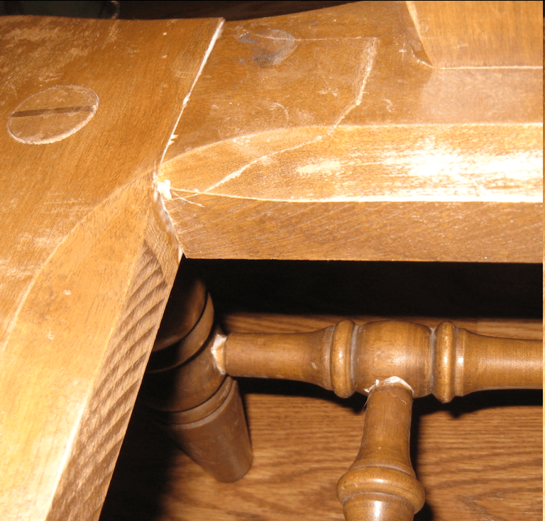

Fixed a wood chair. Teen sat down on it hard; sheared the front wood piece holding the two front legs clean off. Mom screamed -
Elmer's yellow hopefully holds it together for rest of its, if not our life. The outline is the chip that ripped off the top of the wood; two glue steps to fix. There's another, albeit smaller feature on the other side that got glued and clamped as well, as a first step.. Of course they didnt go back in quite the same way, so I had to trim the ends to match the flat; one side with the table saw, the other with my Makita mini rotary, whose max depth missed by 1/8", which finally yielded to a file.
Coulda wiped the glue a bit better I suppose, but it's well beneath the cushion and I'm not Steve Jobs.
