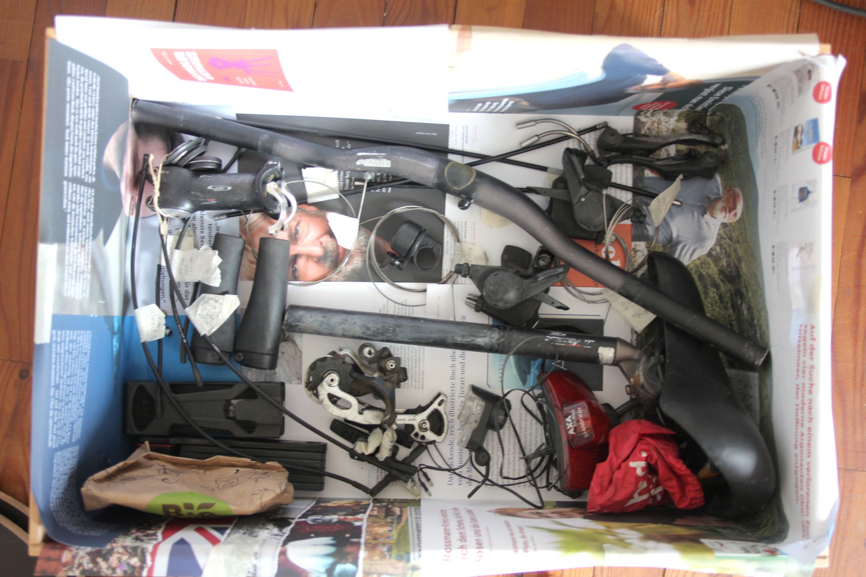

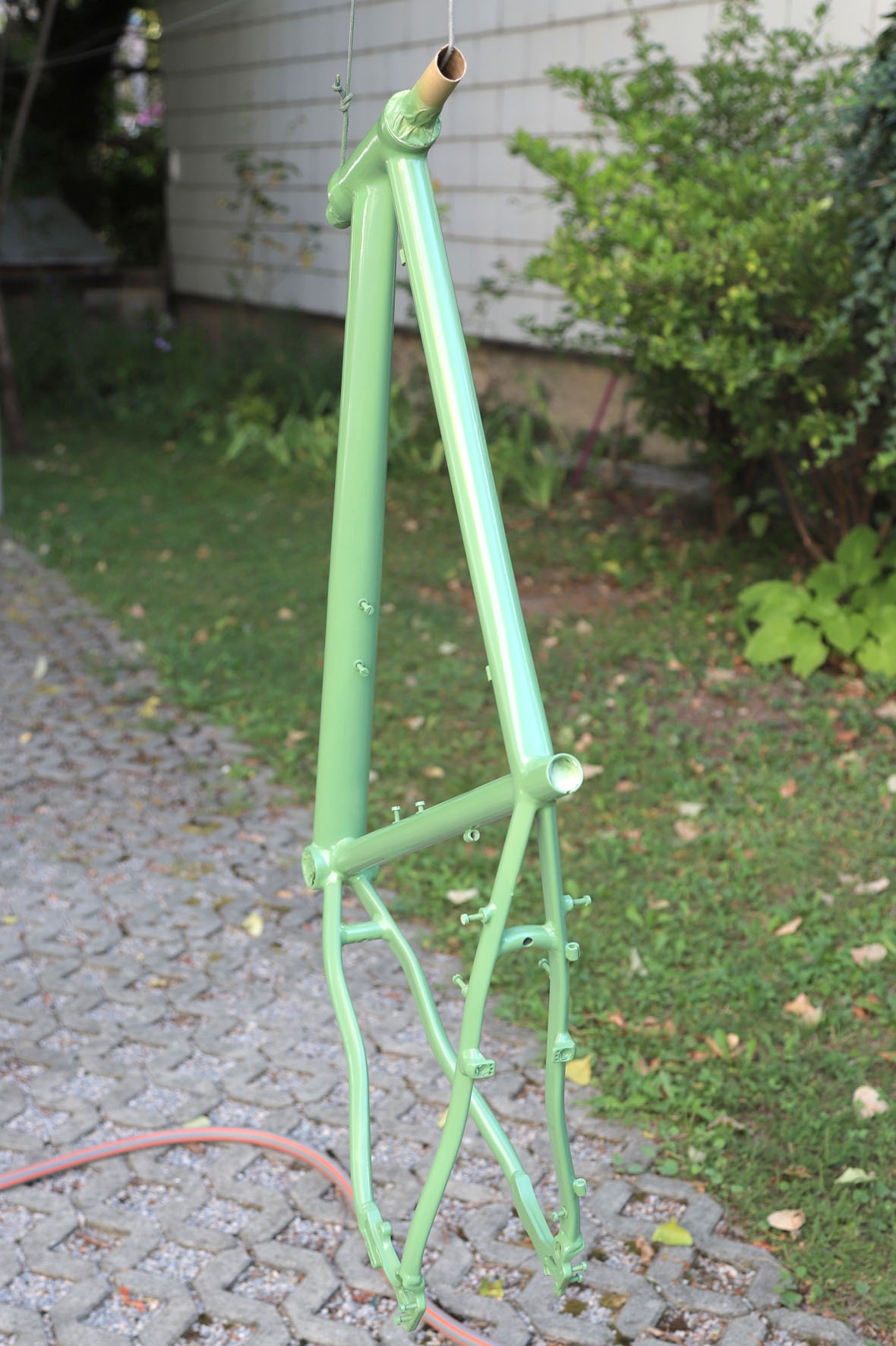

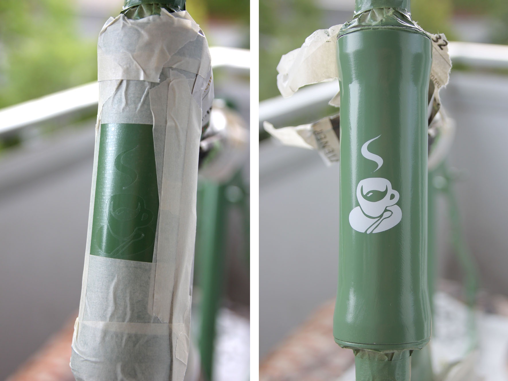

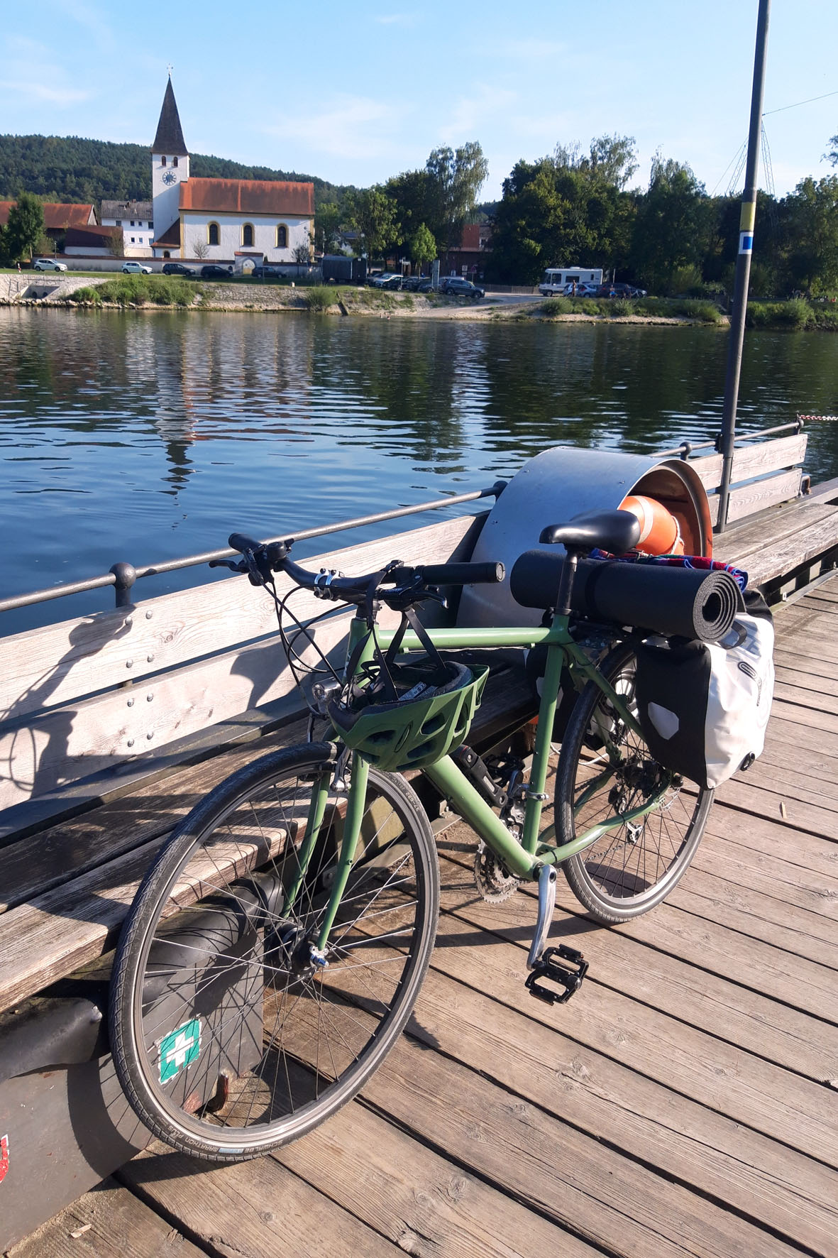

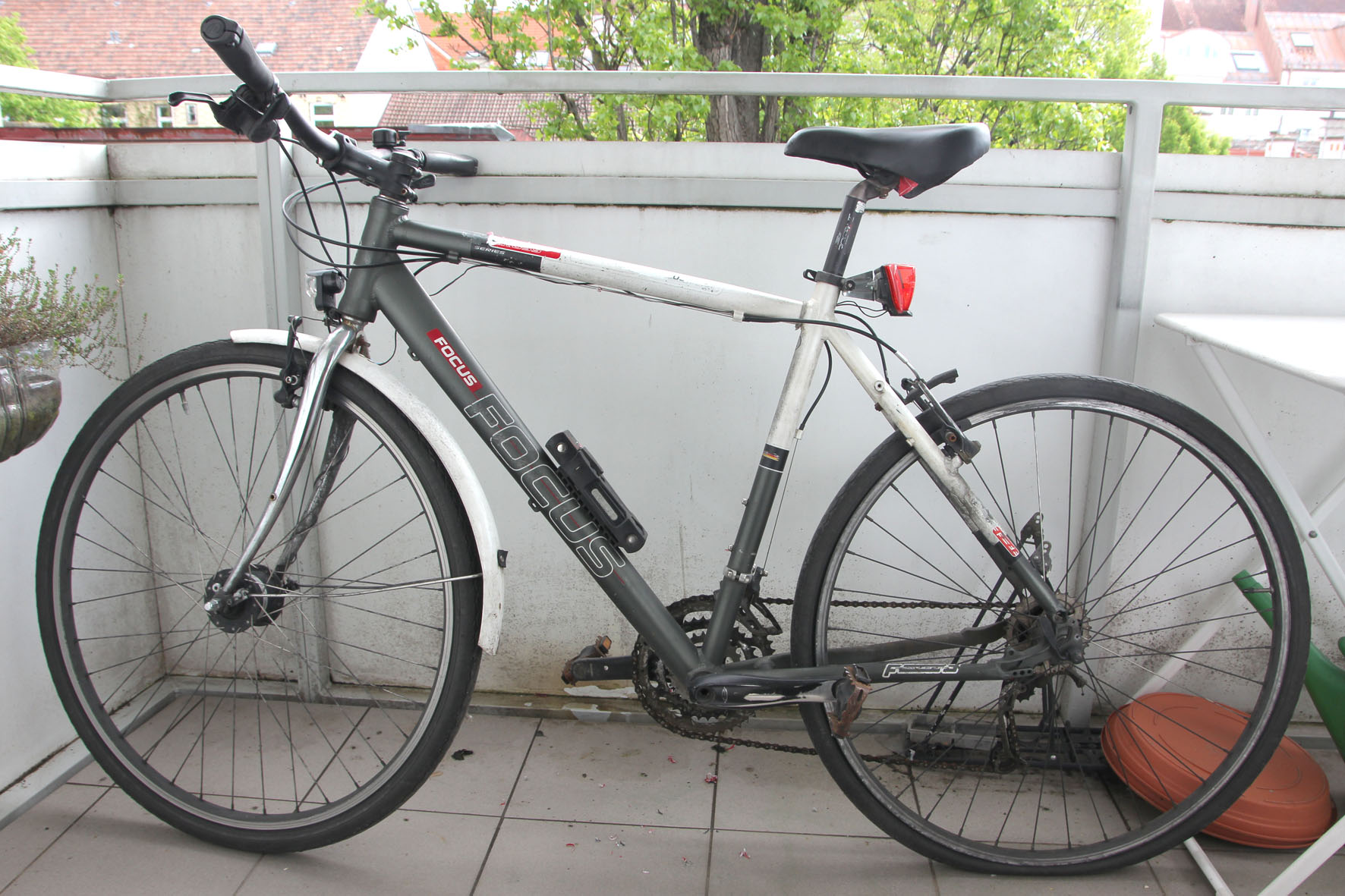

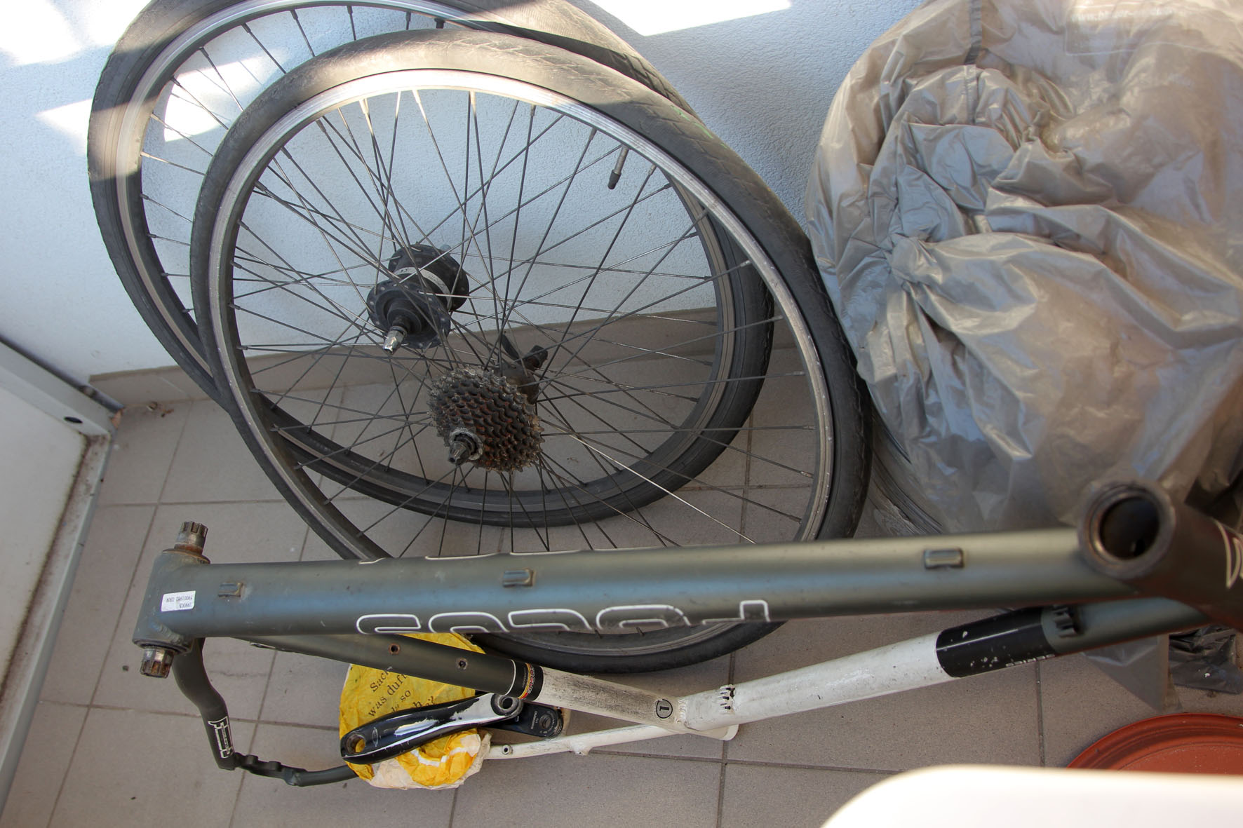

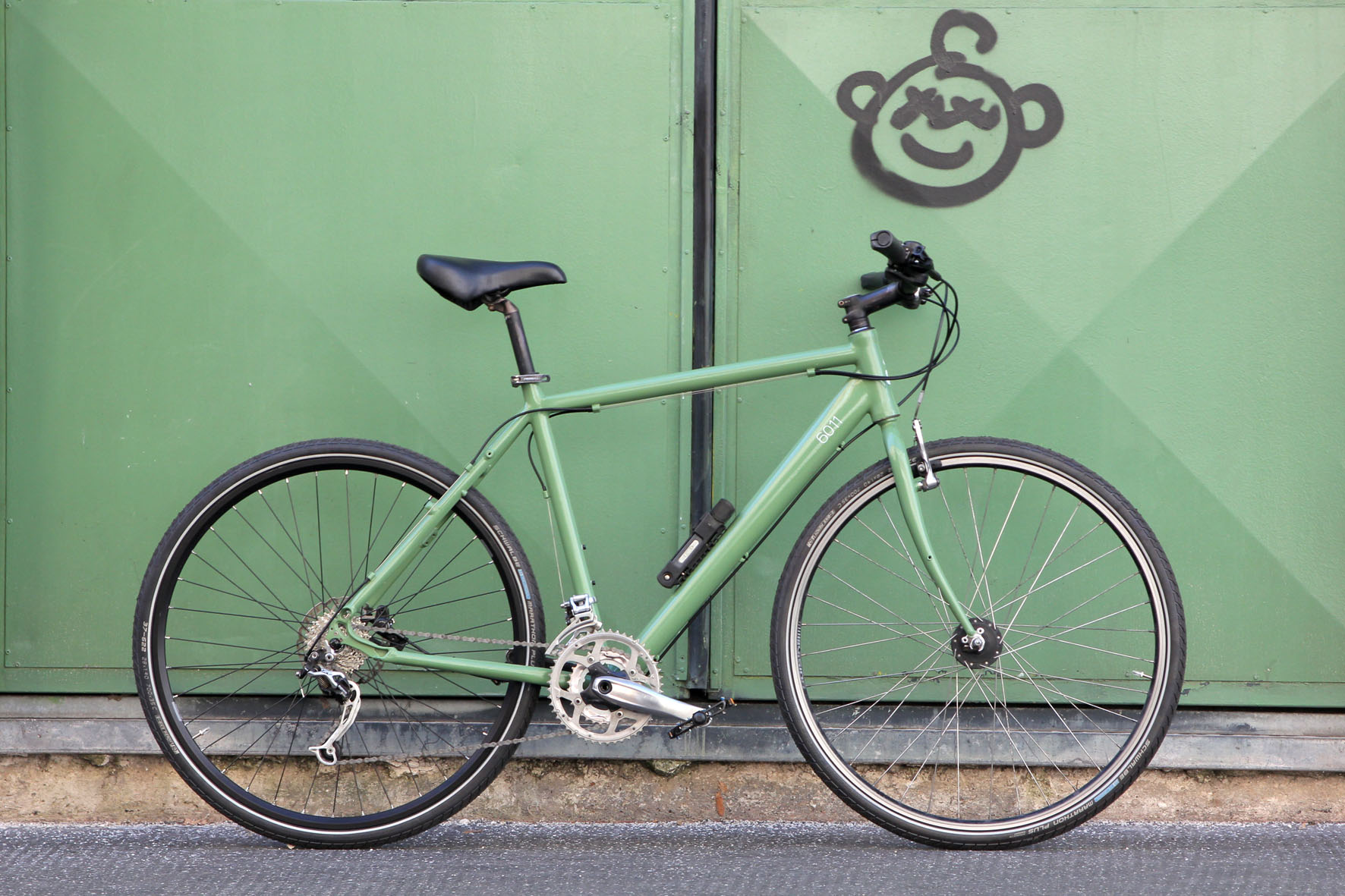

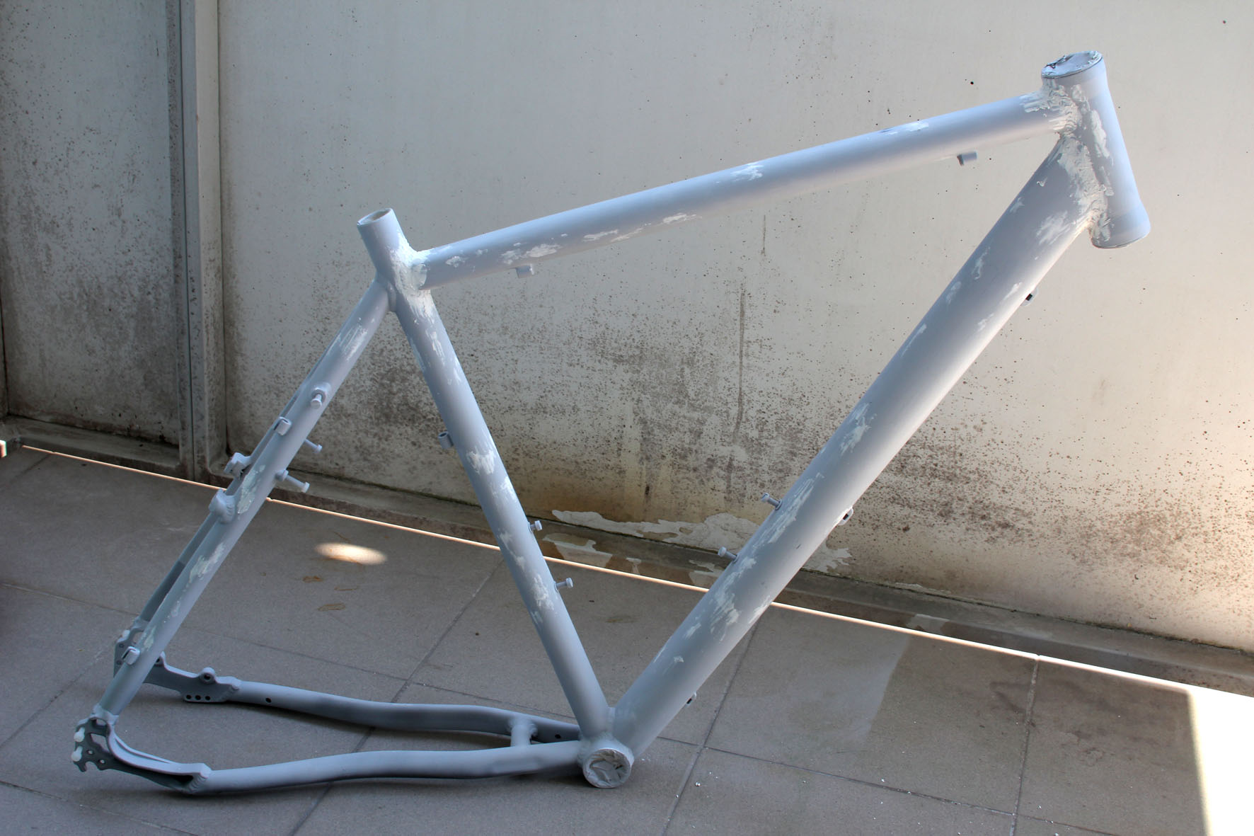

My every day bike.
It was completely broken:
cracked rear rim (worn off from breaking)
worn out chain and gears, only one or two gears usable at all with dangerously jumping chain
flat tire (because of cracked rim)
rusty bowden housings and cables
completely worn off tire profiles
ugly scratched and dirty frame stickers and colours
so I did a complete dismantling and renovation including frame painting and change to a rear disc brake (front will follow, but I wanted to reuse the hub dynamo).
the final test was a successful 796 km journey along the danube river!

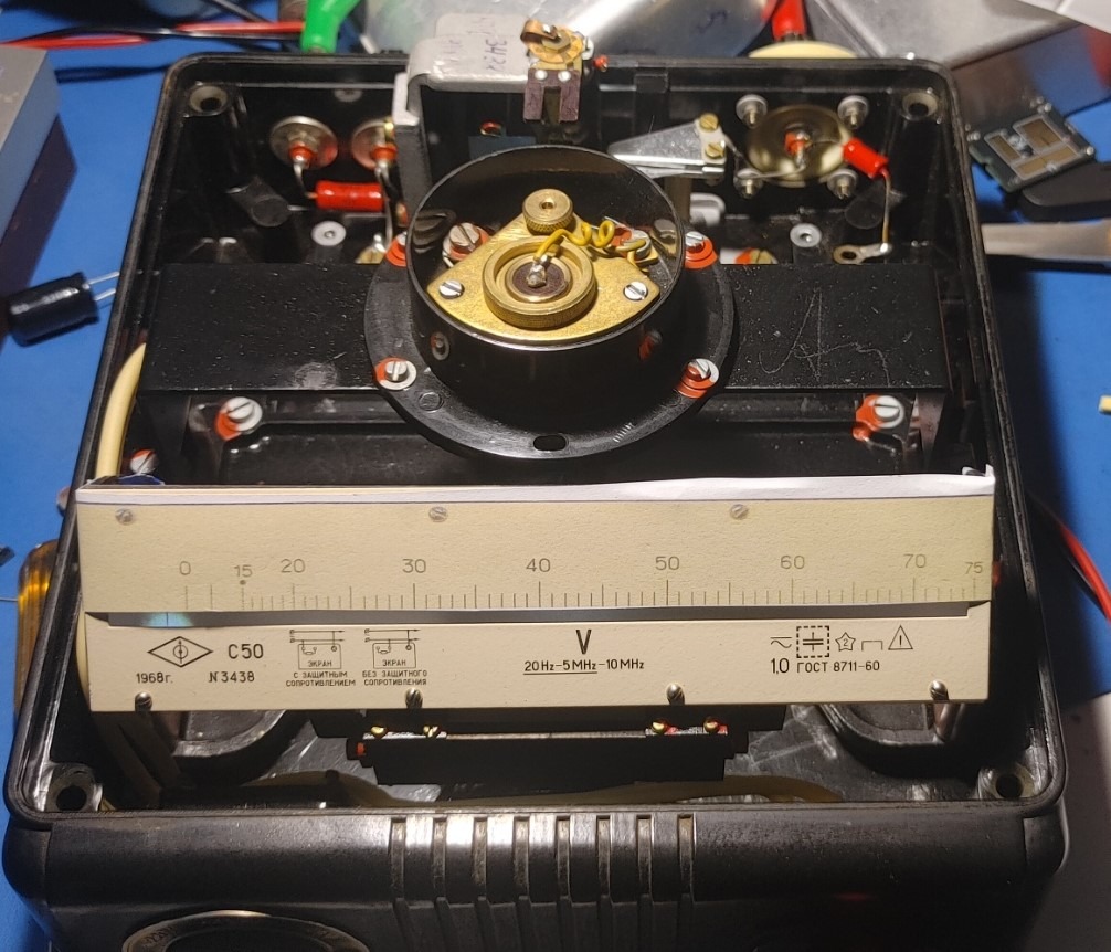

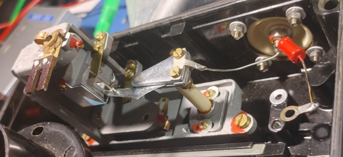

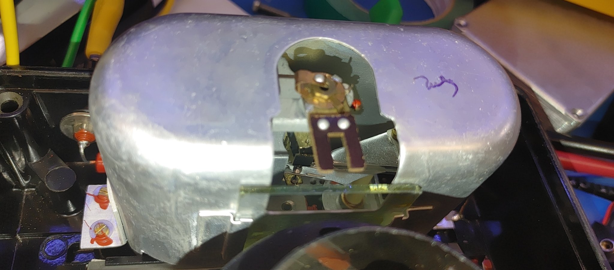

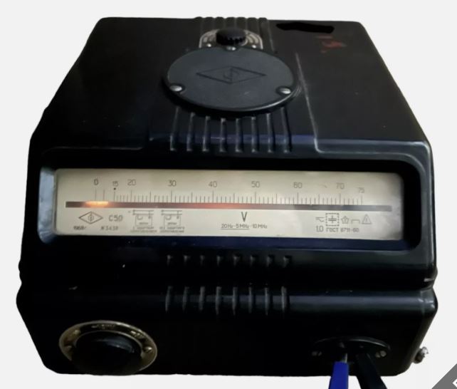

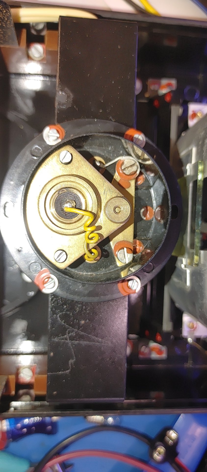

My latest is this odd Soviet era electrostatic voltmeter. What makes in interesting is as follows-
1) Electrostatic- no current on DC loading on AC is less than 50 pF.
2) AC RMS and DC
3) 70V full scale and measures as little as 10V
4) 10 MHz bandwidth- works to almost 30 MHz.
5) Uses optical to magnify the movement of the miror to a scale that has essentially no parallax. Similar to https://en.wikipedia.org/wiki/Mirror_galvanometer
This was made in 1968 it seems. It used a 6V flashlight bulb as the light source and even has a trasformer to power from line voltage.
I found an LED spotlight bilb that fit and with a little fiddling I got the optics working
Then It turns out the sensitivity has changed in the intervening 55 years. So sine the mechanism is so delicate I chose to recreate the scale. I took a photo and printed it rescaled to approx accuracy.
Finally getting it to zero correctly was the most challenging. I had to dismantle it enough to get to the lower zero adjust.
The light beam starts at the top, bounced off a mirror on the bottom, is reflected by more optics to the mirror on the movement, then goes to a mirror just below the meter scale, back to a mirror below the movement and then to the meter scale. In the light source is a wire that become the reference line on the display. I figure the whole light path is around 24 inches. Thats part of how it gets its sensitivity.
The company made a 30V version of this. There are a number of these being sold out of Ukraine (Where I got this).
I took a bunch of pictures whaile it was open.

There is a way to lube camera galvanometers, the pivot screw is loosened, and the pivot cleaned, then a tiny quantity of clock oil is applied with the tip of a sewing needle.
After that, the screw is adjusted for proper height with respect to the mechanism, no play, neither loose nor tight.
We have some people here who think Soviet technology was behind the curve in comparison to the West, this is yet another example that they were really on a more advanced level in comparison.
Only loosen pivot, if it comes out, kaput.
There may be videos about it on net.
Use a cleaning fluid to flush out old lube, dry, lube, set again.
About 1 to 2 mm is enough...more will cause the pivot to come out of its matching part.
Its a taught band movement with a very thin wire maybe 40 or 50 awg. I did manage to get the zero adjusted. I confirmed the leakage is very low when the 10 Meg resistor is disconnected. 20v can take a minute or two to dissipate.
Its a great demo of finding a solution when you have different resources to work with.
Its case is pretty rough with a hole punched in it.

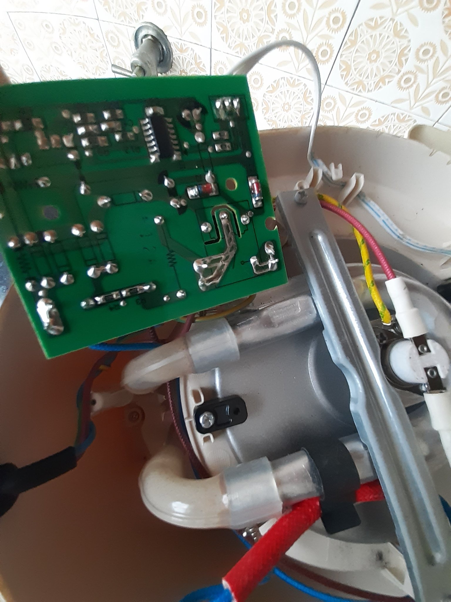

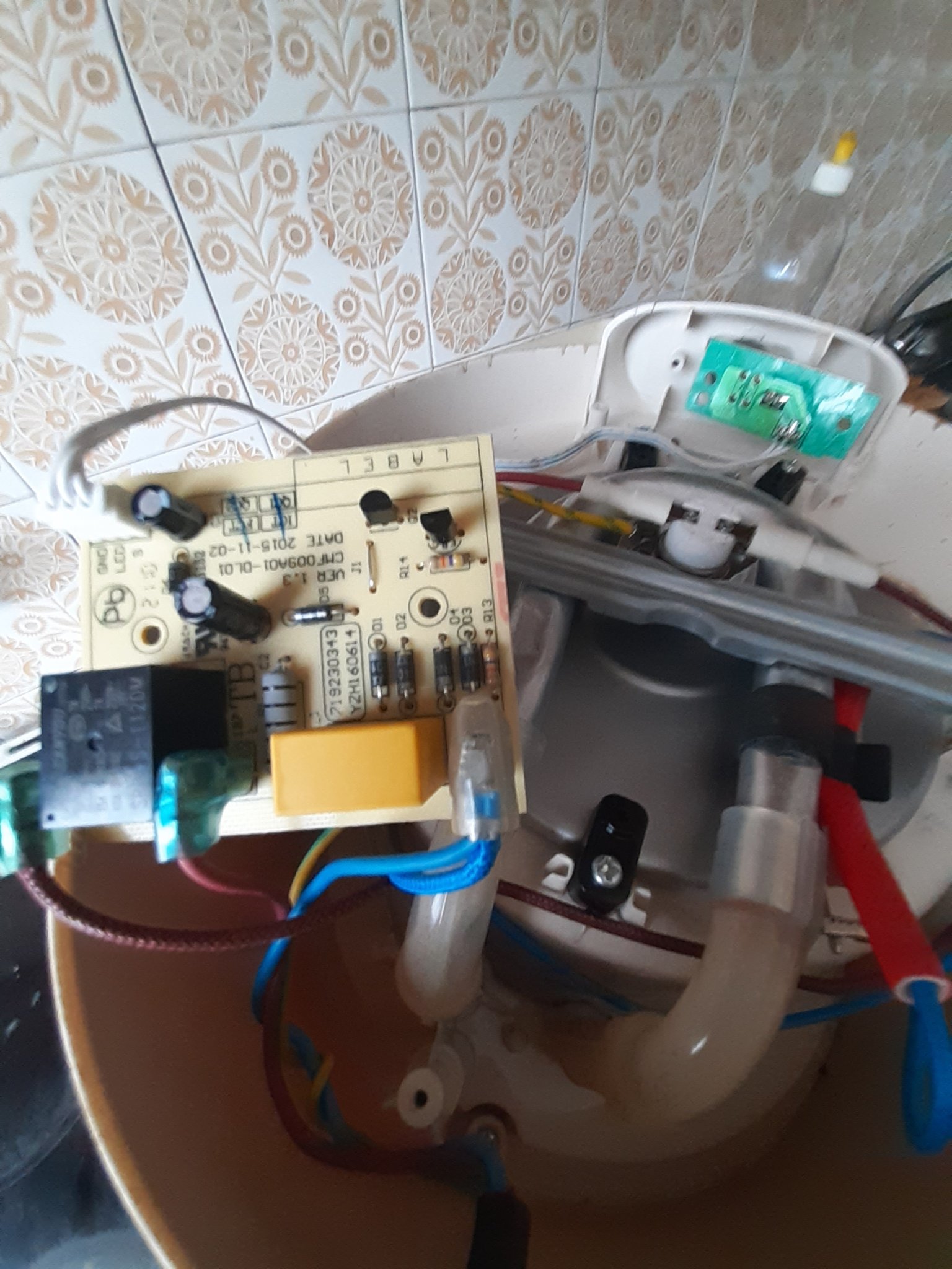

Do you think my Moulinex can be fixed.
Ligth at switch on but no heating anymore.
The diode in rhe middle measure 370 R in the two direction while the other seems ok with 750R in one direction.
The relay seems only to switch off the heater résistance after à while.
Any idea where to beginn please ?

More often than not the supply capacitor (yellow block) has lost capacity over time thus the aux supply does not work properly.Hi,

Replace with a a self-healing safety X2-capacitor
^+1 to that. Similar thing happened to me a year or more back with a cooker:
https://www.diyaudio.com/community/threads/what-did-you-last-repair.313739/post-7409378
You must use a cap of the type @bucks bunny mentioned for safety. Don't even think of using any old cap here.

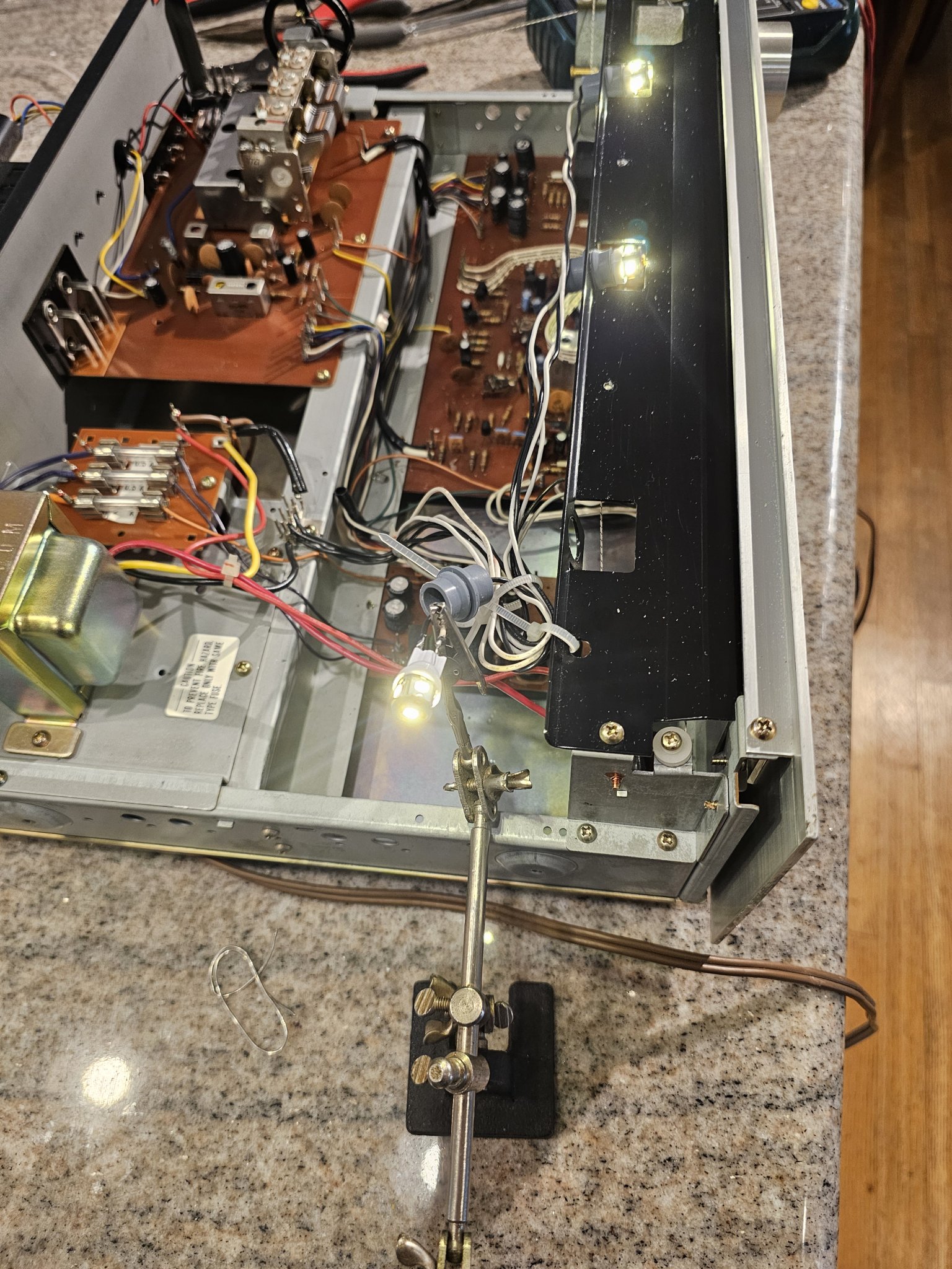

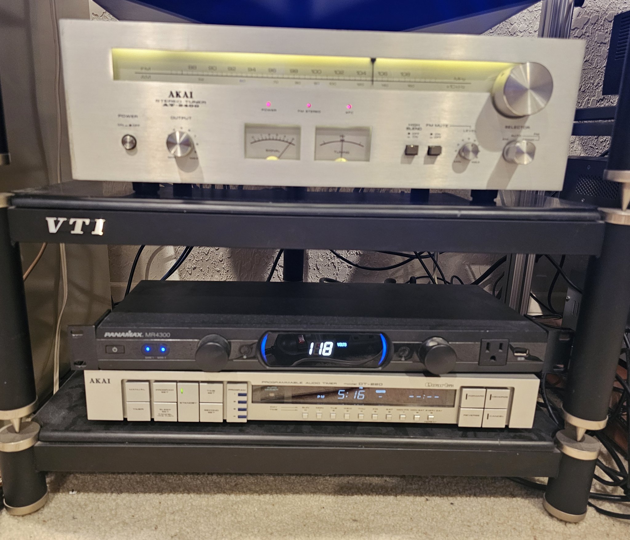

Well its not on the level of everyone else here but hey, I acquired an old 70's Akai tuner with blown lamps.
These are sealed in a wood box, not vented
No dust inside. Amazingly perfect inside and out; looks like it came off the assembly line yesterday.
Working perfectly. Cost me $70 and $12 for the 12v AC/DC LEDs.
Repair: replaced the blown lamps with LEDs.
Not quite matching my 80's Akai fancy programmable audio timer.

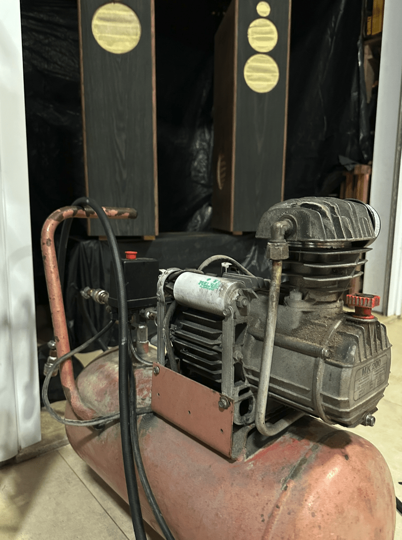

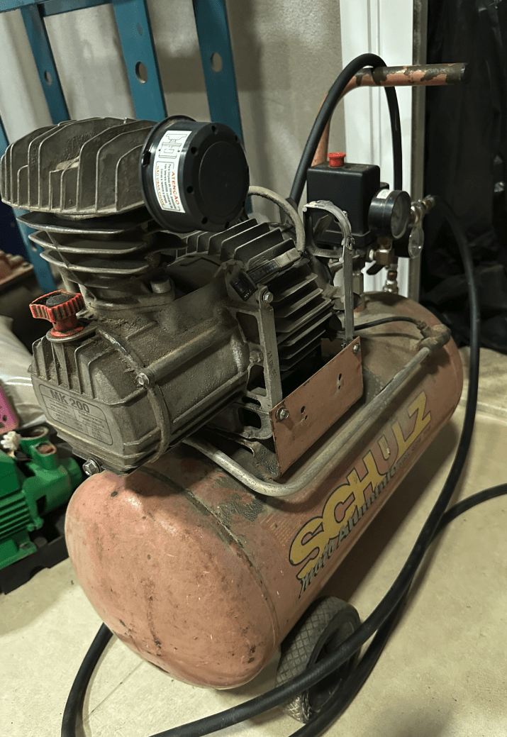

My compressor.
This damn thing broke while I was applying the first coat of varnish on my new 4-way speakers. I was spraying the baffle when it dropped a valve – okay, not literally, since it doesn’t have valves, but whatever functions like a valve was obliterated, and the compressor lost all pressure.
Luckily, I had a spare kit with gaskets, the spacer and the valve-like parts to put everything back together and finish the first coat in time.
It has been in service for about 25 years already. I guess it’s time to retire it.
