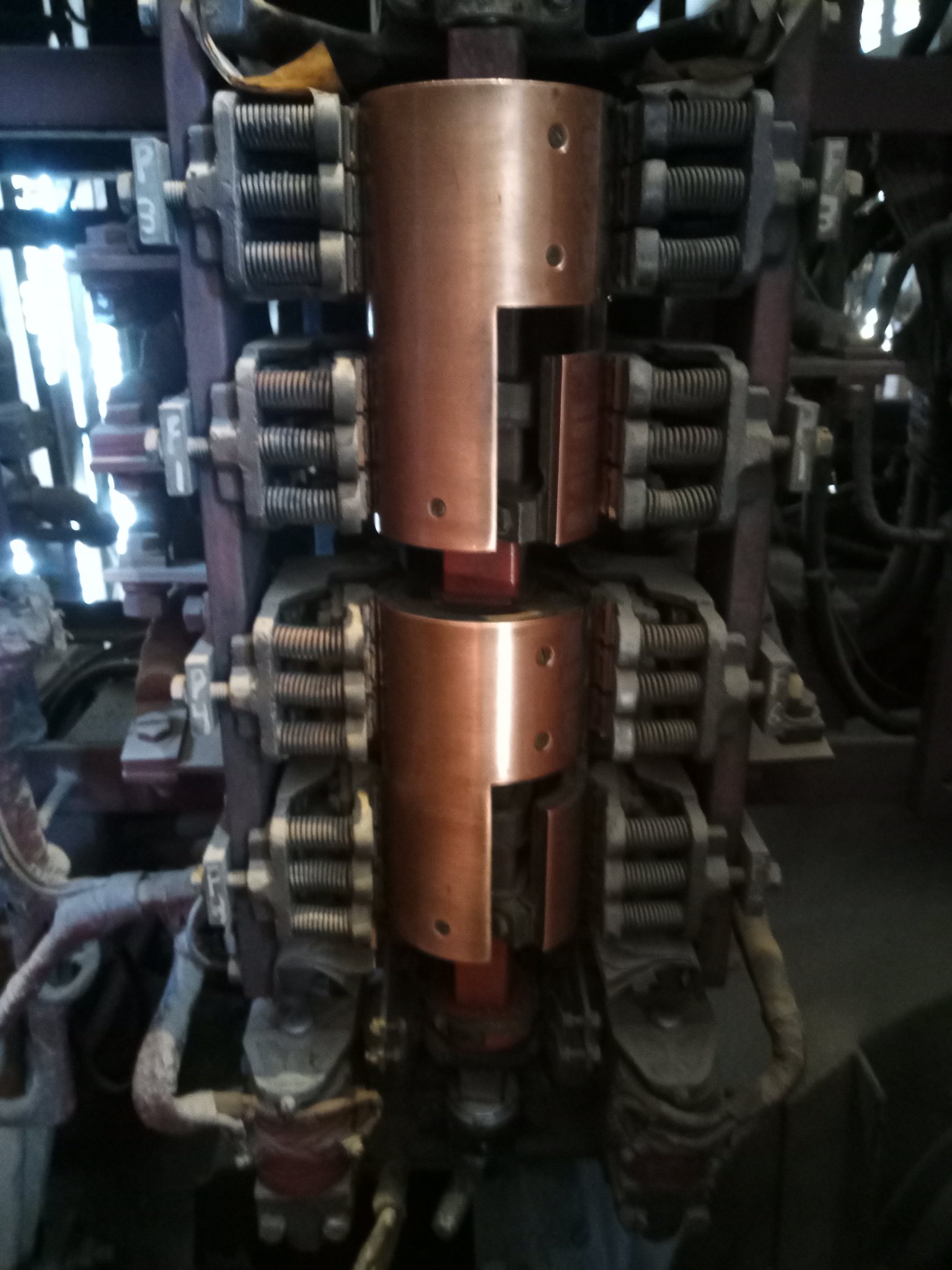

I refurbished the Westinghouse reversing device in a 1950-built Baldwin DRS-6-6-1500 diesel locomotive at the Arizona Railway Museum. The reverser has a large, segmented copper drum that rotates partially to reverse the polarity of the DC current applied to the traction motors, and hence the direction of the locomotive’s travel. This device does not switch under load, so the contact surfaces are worn but not pitted. I wish I could say the same about the power contactor that engages power once the reverser has moved.
The rotational force is applied by two air pistons, which in-turn are controlled by solenoid valves. In this case, the old leather piston cups were shot, so the reverser would not turn reliably. Hence, the locomotive sometimes moved in the wrong direction, clearly not a good thing!
Replacing the piston cups required a significant disassembly of the unit, including the drum. The drum was cleaned and polished, piston cylinders cleaned, and new neoprene piston cups installed.
This past weekend we fired up the 15,000 cu-in, 8-cylinder diesel prime mover and was gratified that the reverser now moves smoothly and reliably, and the locomotive moves in the correct direction every time! This has been an on-going problem for years, and required a big wrench in the cab to manually rotate the drum when it would not move correctly. Unit is about twenty-four inches overall height.
Sorry for the murky photo. The unit is inside the electrical cabinet, very close to floor level, making it very inconvenient to work on. The repair took about 4 weeks’ worth of Saturday mornings. Frequent breaks were needed for my sixty-five-year-old back and knees. And only one banged knuckle!

Traction motors operate at 600 VDC, current can be up to 2000A short-term. In operation at the museum, we rarely see more than 500A on the ammeter, and then only briefly. I never did like sticking my metal wrench in there to turn it manually.

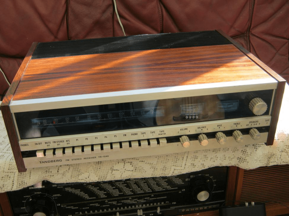

Have one of these. Changed electrolytic caps (many bad ones), cleaned, given a new volume pot and a good cleaning.
What a sound!
Can understand why some people like these machines!

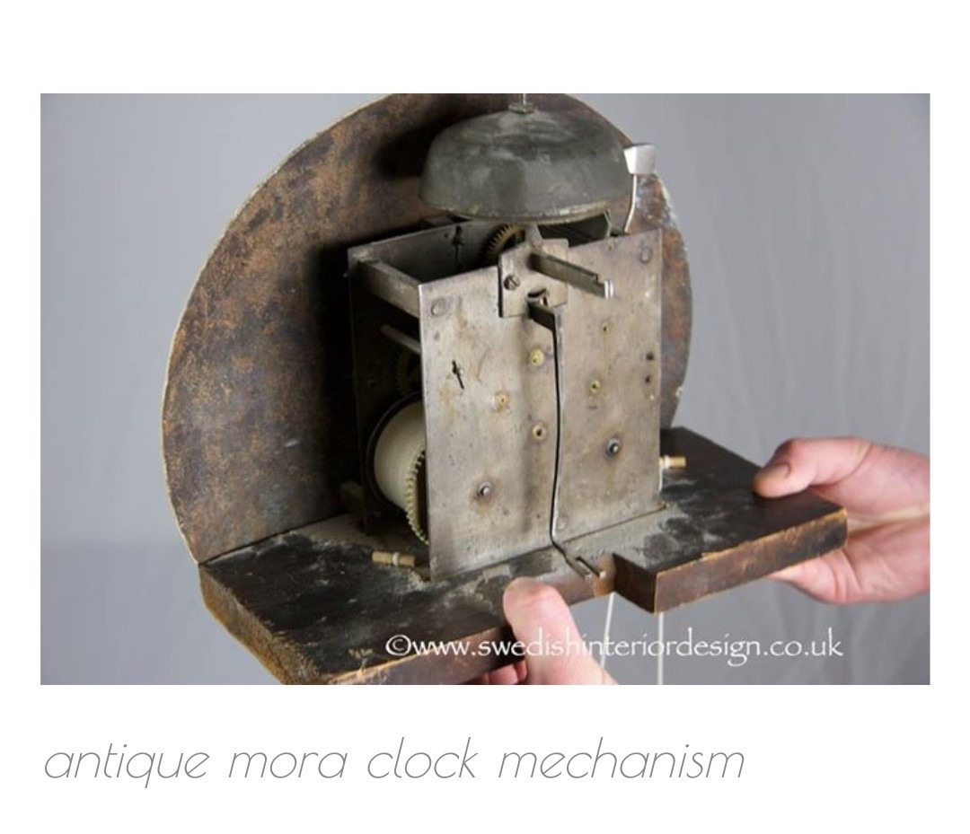

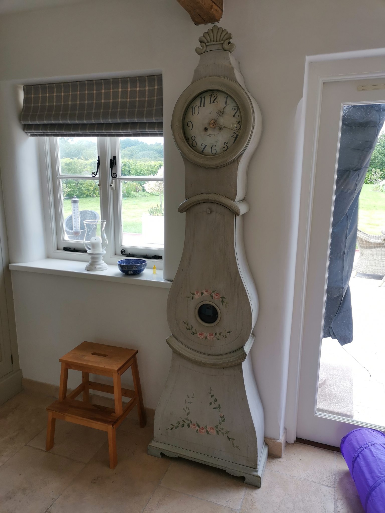

I've been tinkering with the Mora clock (long case) I recently gave to my wife.
Having cleaned the next (using electrical switch cleaner on cotton bud on all the gear bearings and re-oiled using the proper oil), I got it running.
Getting the mechanism level and adjusting the beat was the key.
Simplest method is to mark the centre of the pendulum at rest on a bit of tape placed behind it.
Then push the pendulum to the right until a tick is heard, mark that spot.
Then push all the way to the left and mark the tock.
They should be equidistant.
Some fancier mechs have a clutch on the crutch so you can adjust. These oldies just have a bendable steel rod🙂
It's been bent a few times over it's long life!
It keeps remarkably good time for such a crude mechanism.
I don't have to reset the time very often at all!

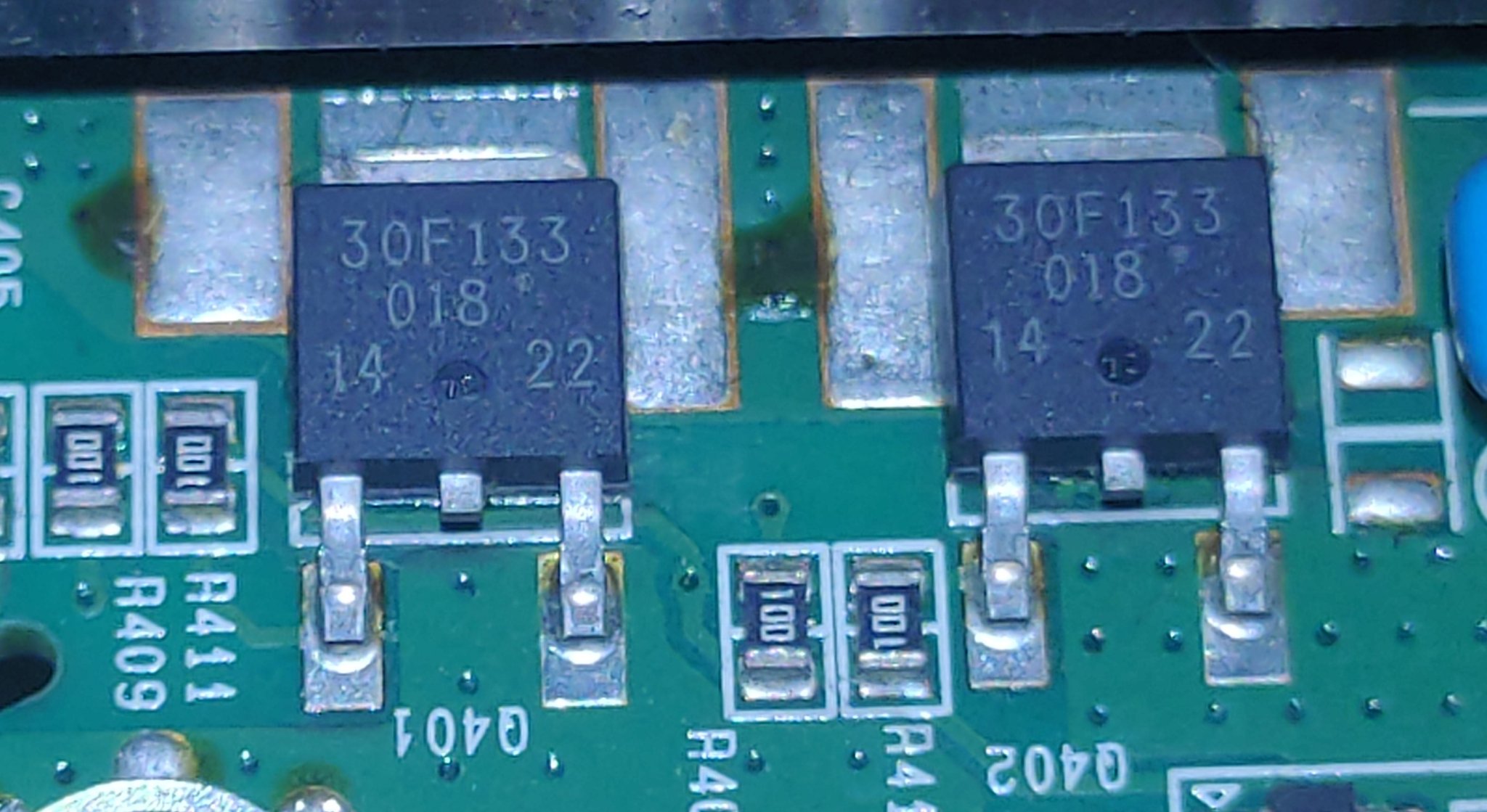

Haa, Forgot to update the fault. The issue were two faulty mosfets in parallel that was replaced.Looks like need to fix this lg tv asap. There was a some mini explosion noise and now status blink indicates power supply issue. WKP.
