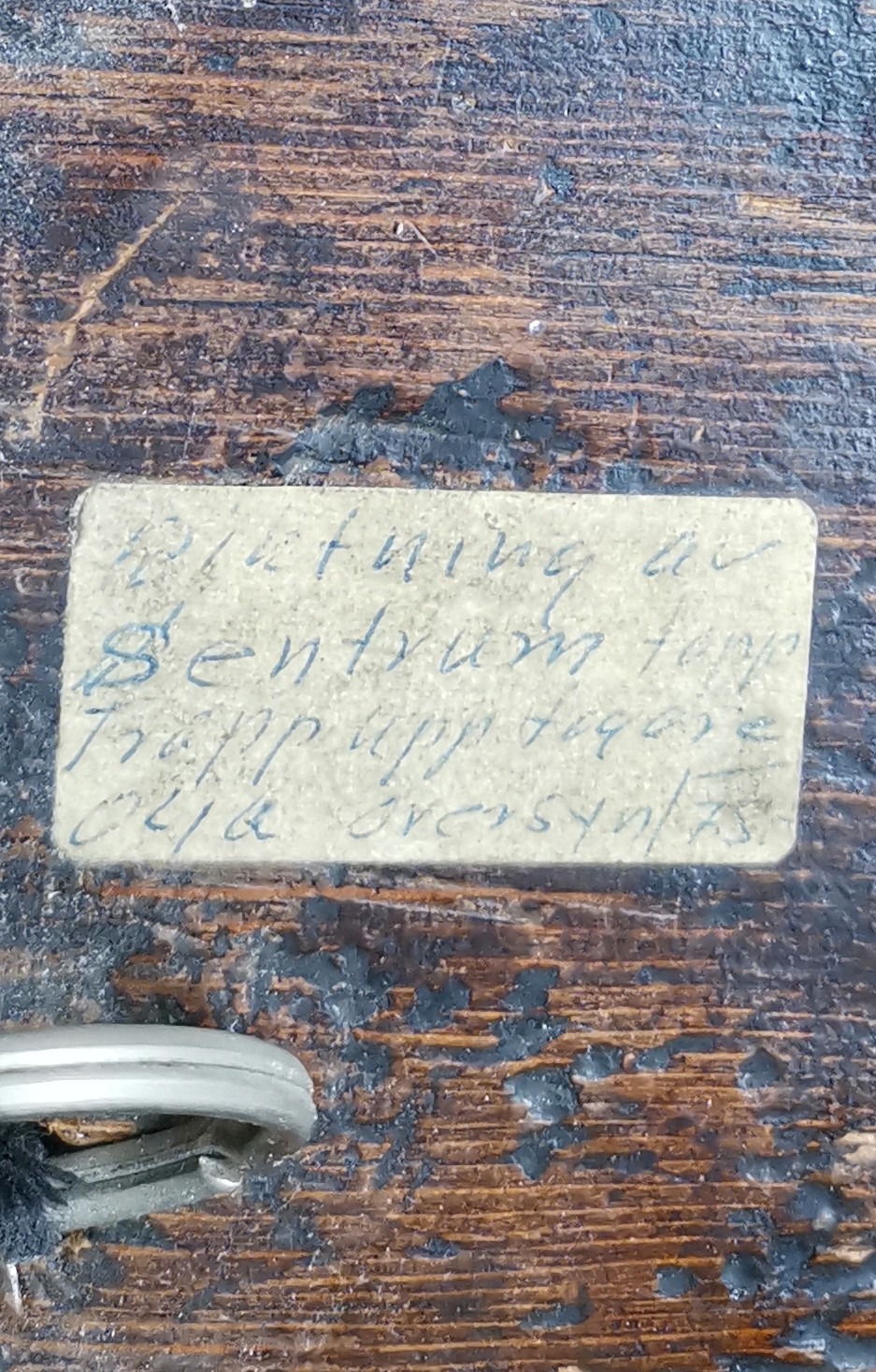

In working away on the Mora Clock.
I came across this handwritten label near the mechanism.
Norwegian or dalmål?
Any Scandi clock experts know what it means?

Norwegian.In working away on the Mora Clock.

"Adjustment of center tap, step<something> lubricated.General service / 75"
Thx. That makes a lot of sense.Norwegian.
The something I'm thinking "upp fogare"
-"step up joint"?
Or something like that.
Not clock language though.
Really hard to see..
Pendulum clocks have top hooks, leaders, suspension springs, rockers.
Interesting: it was in Noway 1975 service.
Then somehow got across to the UK where it currently is.

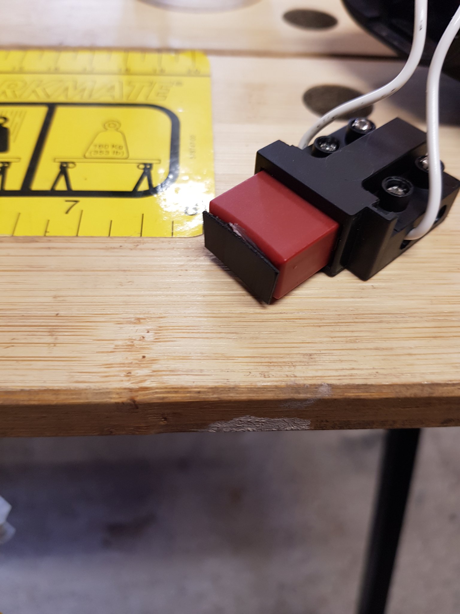

Electric lawn mower.
Usual failure point on these things in my experience. Switch interlock not working. Everything looked fine when I took it to bits, but the power switch was not operating. But the switch itself buzzed out fine.
Added a shim (aka hot-glued in a trimmed guitar plectrum) and reassembled....
...sorted!

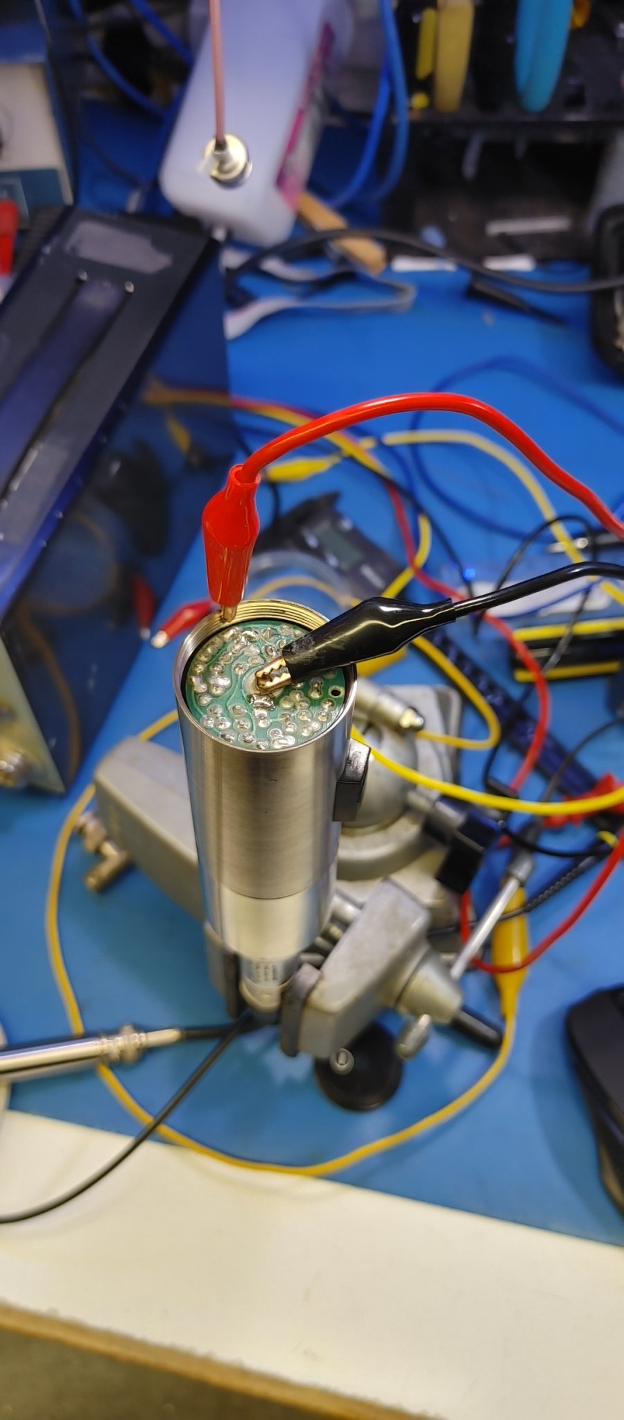

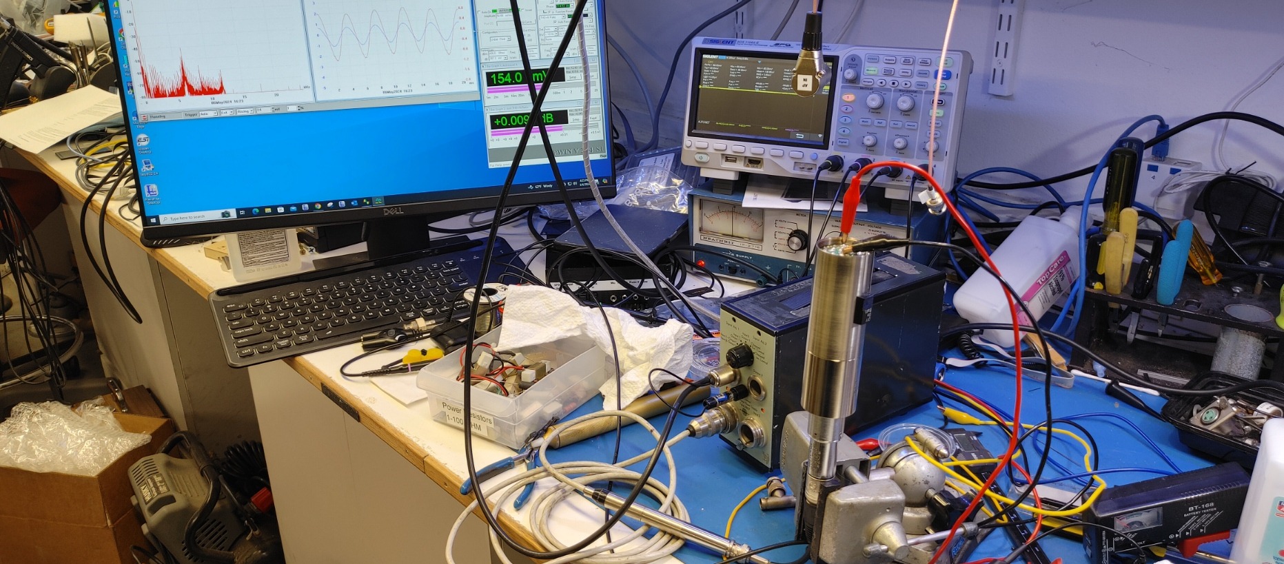

My most recent is a B&K Pistonphone 4220. Its speed had gone wonky. Fortunately these are serviceable (although B&K would rather you buy anew one for $$$$). I opened it up, figured out what controls the speed (it has a tach generator) and a simple circuit to control the speed. Futzing with the resistors got it back to speed but I'm not convinced its fixed. At least I can open it pretty quickly now. Its amazing how much stuff gets into play. I needed a mike in the unit to read back the frequency. The PCB in the picture is a precise fit in a plastic housing that also holds the motor assembly. FWIW the tach seems to have 10 pulses per turn and the cam that drives the pistons has 4 lobes. The output is 650Hz when the motor is at the right speed for 250 Hz output. I have some new parts on order just in case.
Next up is the HV amp I built. The 800V bias is getting modulated with the signal (wrong!) and I need to figure out why.
