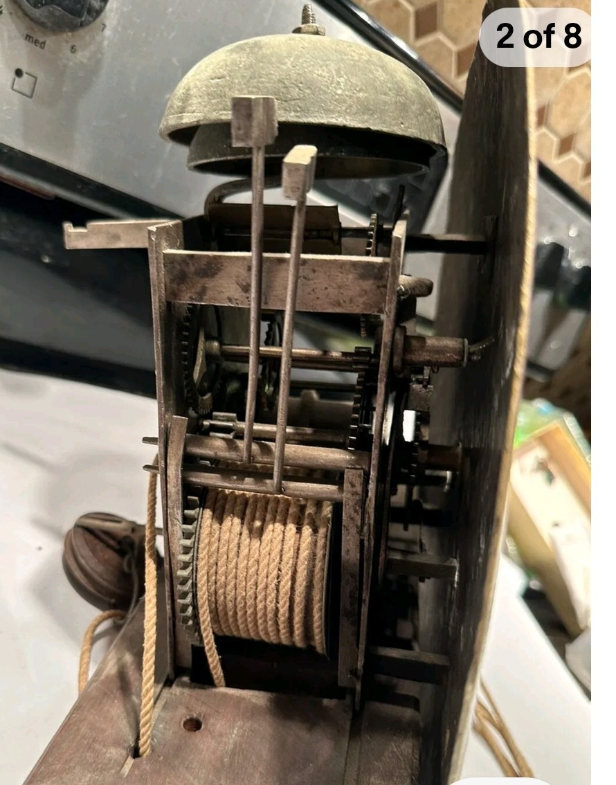

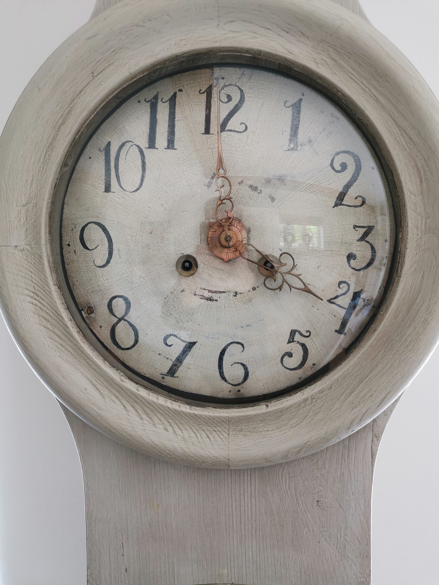

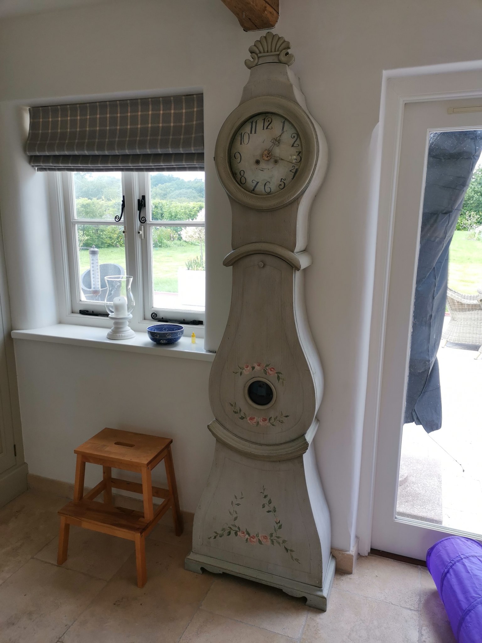

Long update to the Mora clock project
Having cleaned up the exterior of the Swedish Mora Clock I bought my wife and given it to her (she loves it by the way).
I could then do a full clean of movement and re-oil with the right stuff.
Cleaning was done with switch/contact cleaning fluid on cotton buds to remove old gunk in the bearings.
Then filling the bearing pots with the right grade oil, that just sits there, even when the movement is vertical.
I had to raise and fix down the mechanism and set the face to the right height.
The movement is the same (pretty crude, but effective) one I've seen on many Mora clocks of this age.
Right down to the wooden weight pulleys and crude mounting board.
The face however looks suitably rustic but the holes would never quite line up with the movement's winders.
Probably come from somewhere/thing else?
I made some brass ferrules to sort that out. Aged the brass with a blow torch.
The clock runs fine.
The two chime bells were sitting ontop of each other so the strikers only made one dull sound.
Should be a distinct 2 pling chime, not a bim-bam.

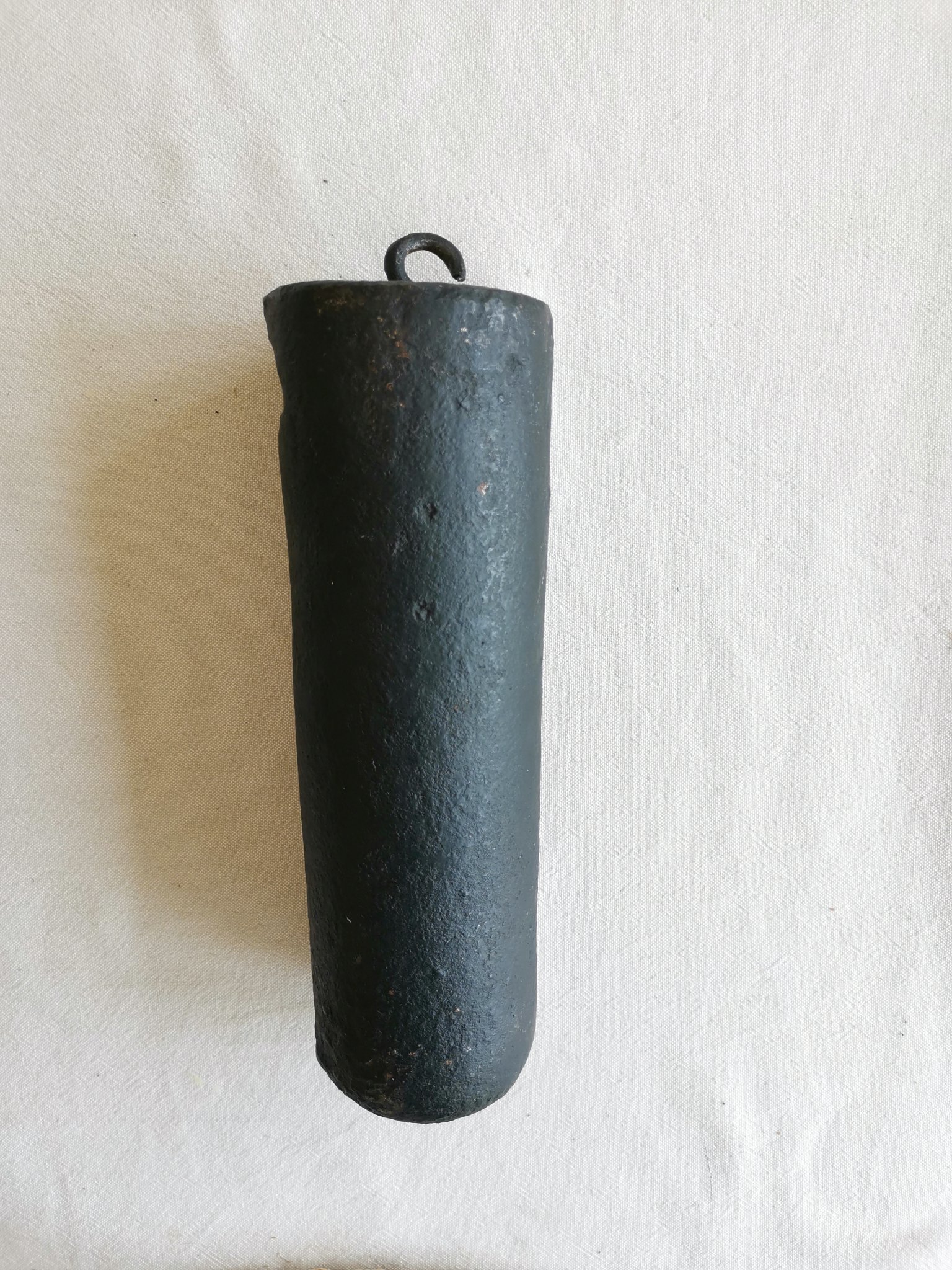

I'm currently playing with different weights as the over that came with it (cast iron) seem excessively heavy!
6kgs for the chimes and 6.8 for the time movement.
Heavy heavy fuel
The chimes run too fast on 6 kgs.
I'm testing at 4kgs.
2kgs was too light to always activate the mech and when it did, too slow🙂
4 seems about right and runs reliably.
The time movement seems fine on the 6kgs weight.
It would stop on 3, 3.5, 4 and 5kgs!
Not sure they are supposed to be this heavy?
Plenty of different weights at all manner of kgs on the internet.

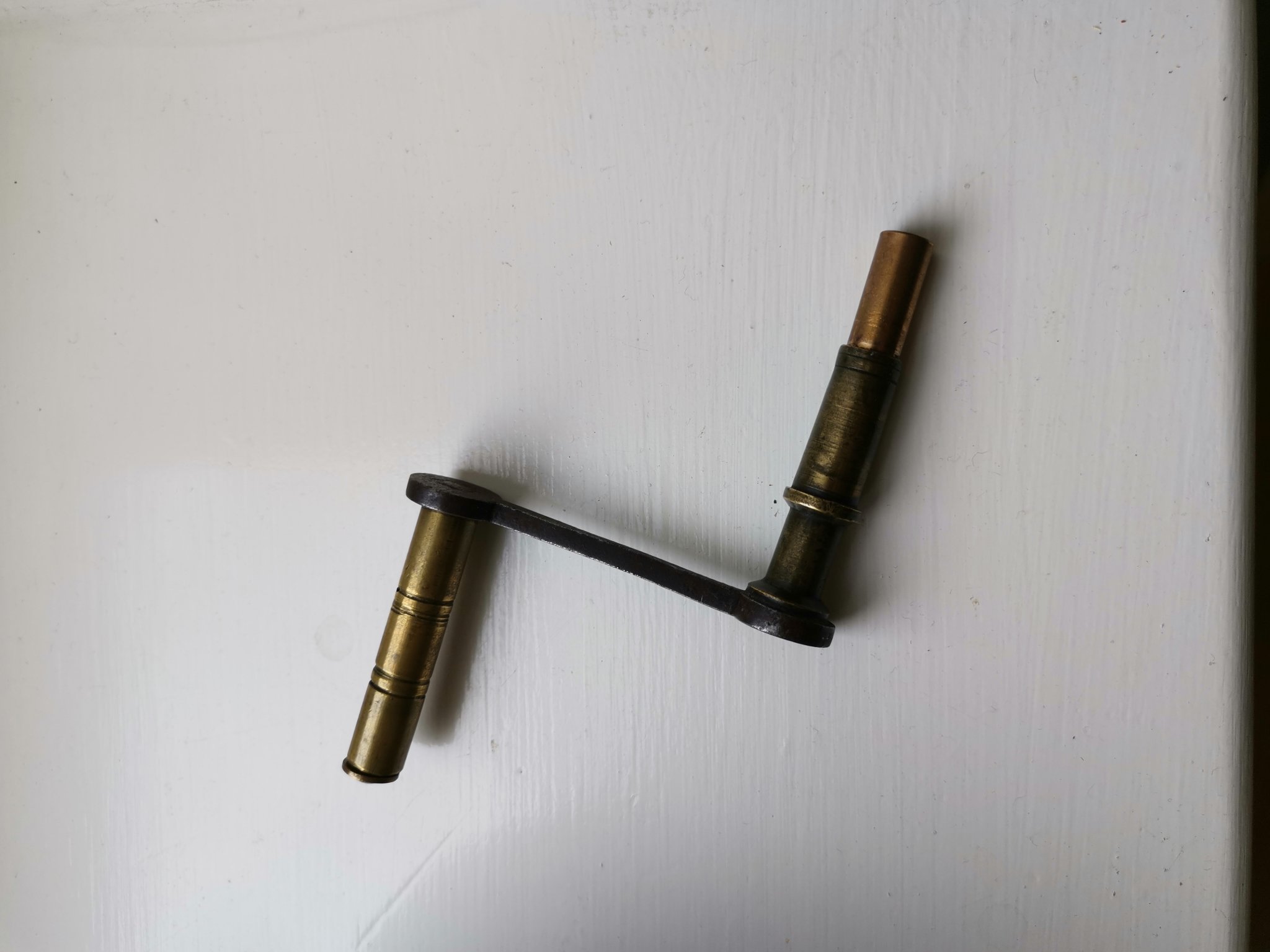

I also made a winder from one my dad had kept but with the right size square, machined in
Quite a fun hobby clock tinkering.

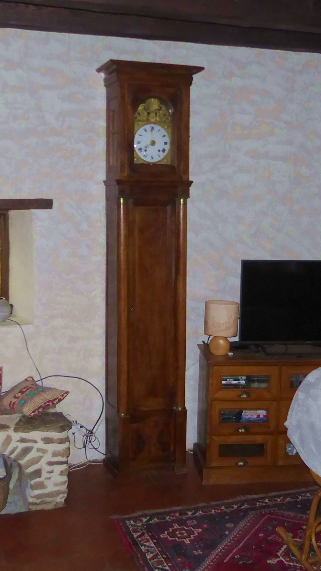

Yes, like you @Speedysteve7 : I ventured in the clock field too, and a gift for my wife also 😎... Oh, that's 27 years ago now ! She still doing fine... Since 1880 🤔 - the clock, I mean. And my wife too, of course ! 🤣

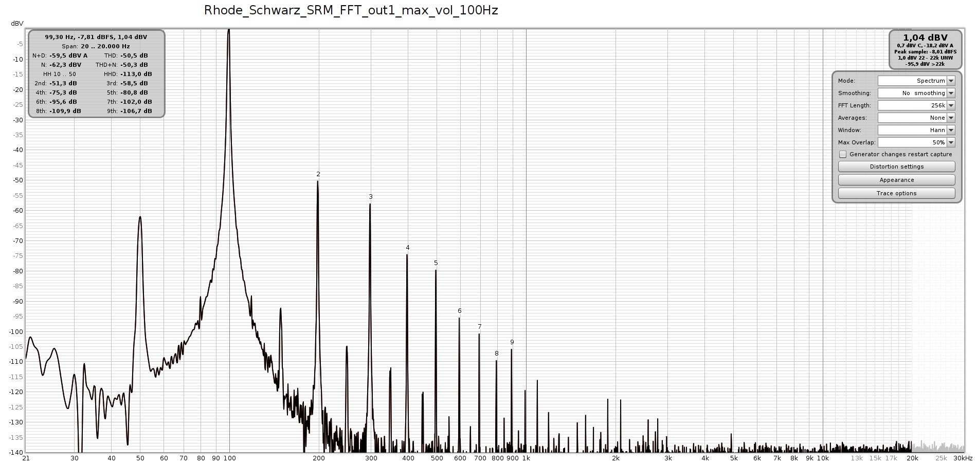

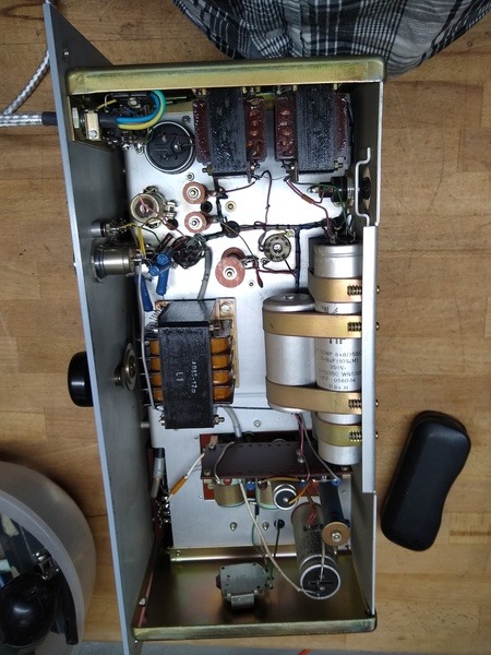

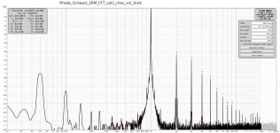

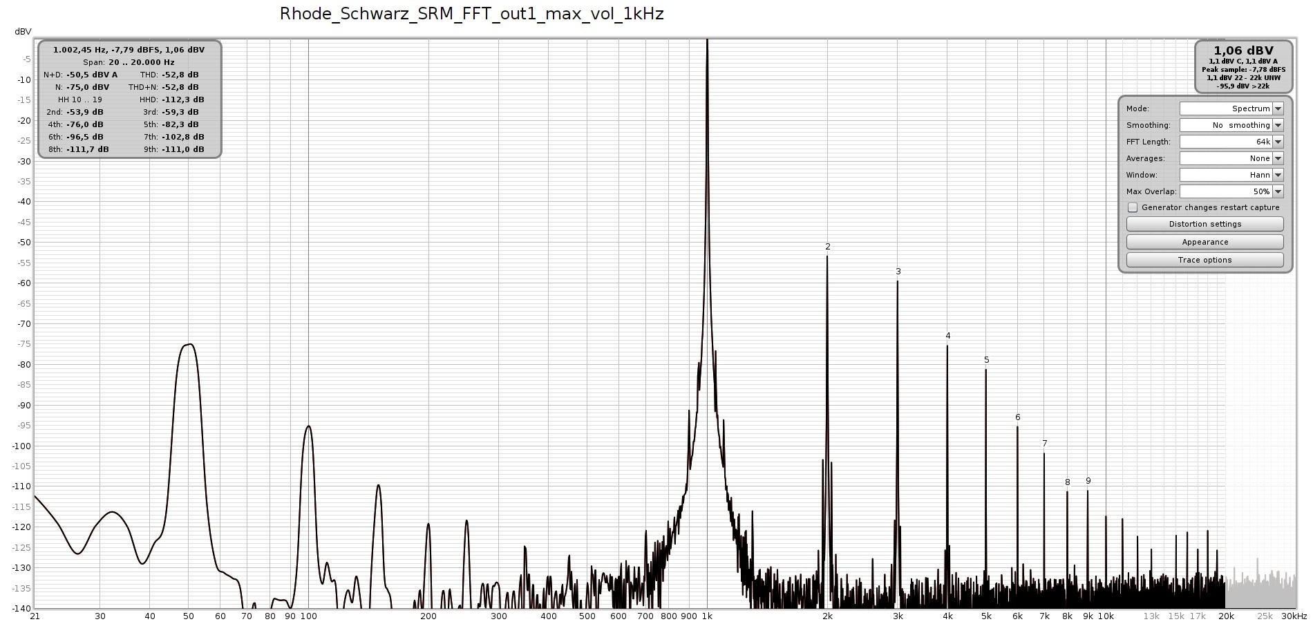

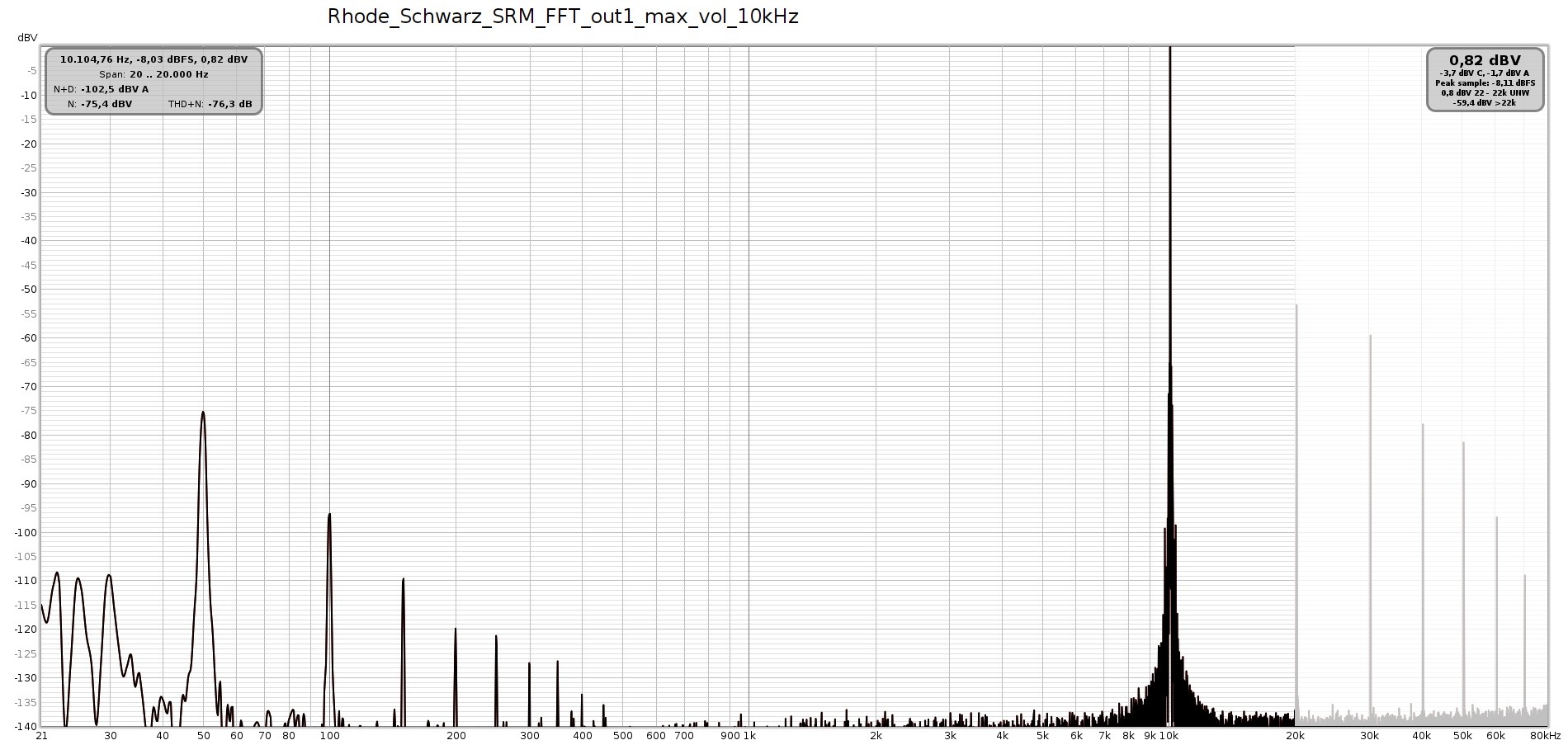

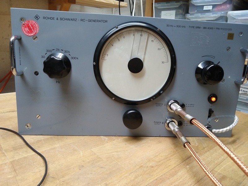

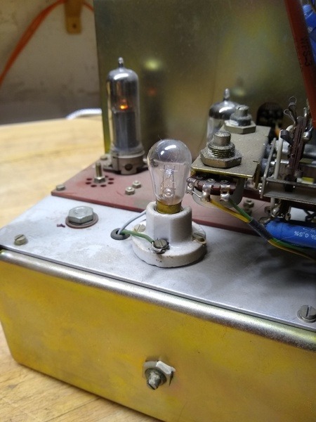

A customer brought in a Rhode&Schwarz signal generator with a cut mains cable.
So I replaced that cable, made adapters for the old fashioned PL- outputs, and voilà -
it works. I should mention that
-this is a bulb regulated wein bridge
-frequency range from 30Hz ~ 300kHz
-no electrolytics, even the main bulk caps arel film capacitors
-surprisingly precise frequency
-introduced 1951
All in all a fine old instrument in a mint condtion,
I suppose this apparatus has been decommisioned routinely because of age.

Wien bridges are of an amazing precision and stability when properly set up ! They are not counter, but resonators.
My (French Army) FERISOL C901 15Hz-150kHz tube Audio Generator from 1953 stays at 1000.0Hz over continous operation during 24Hours...
