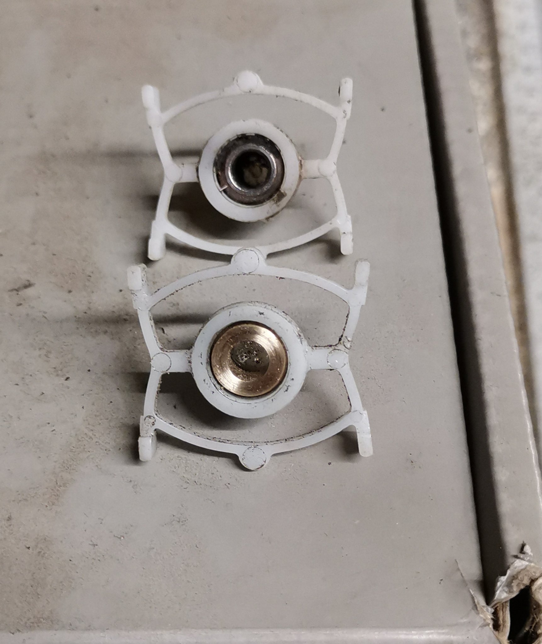

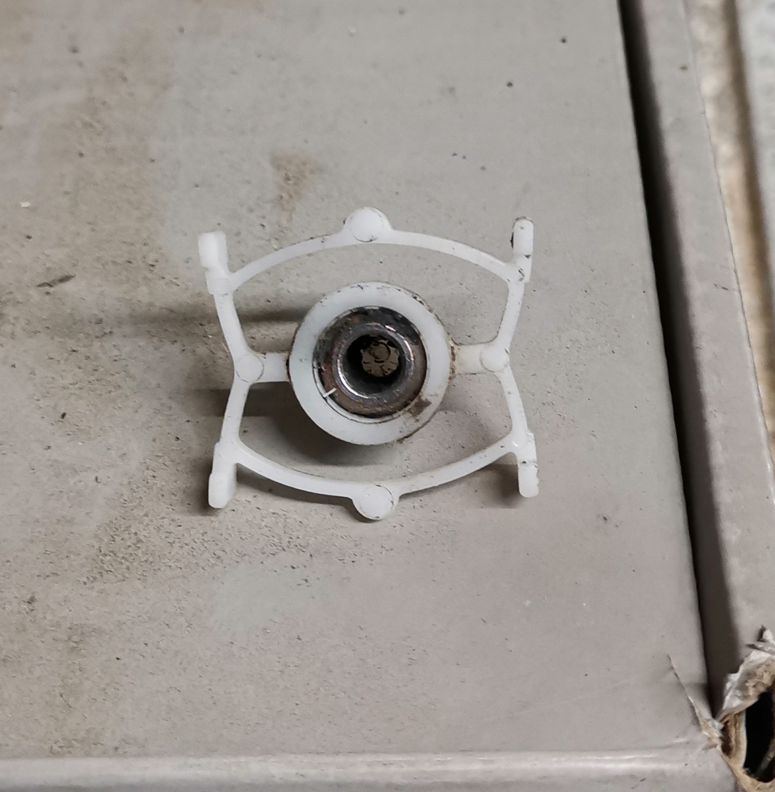

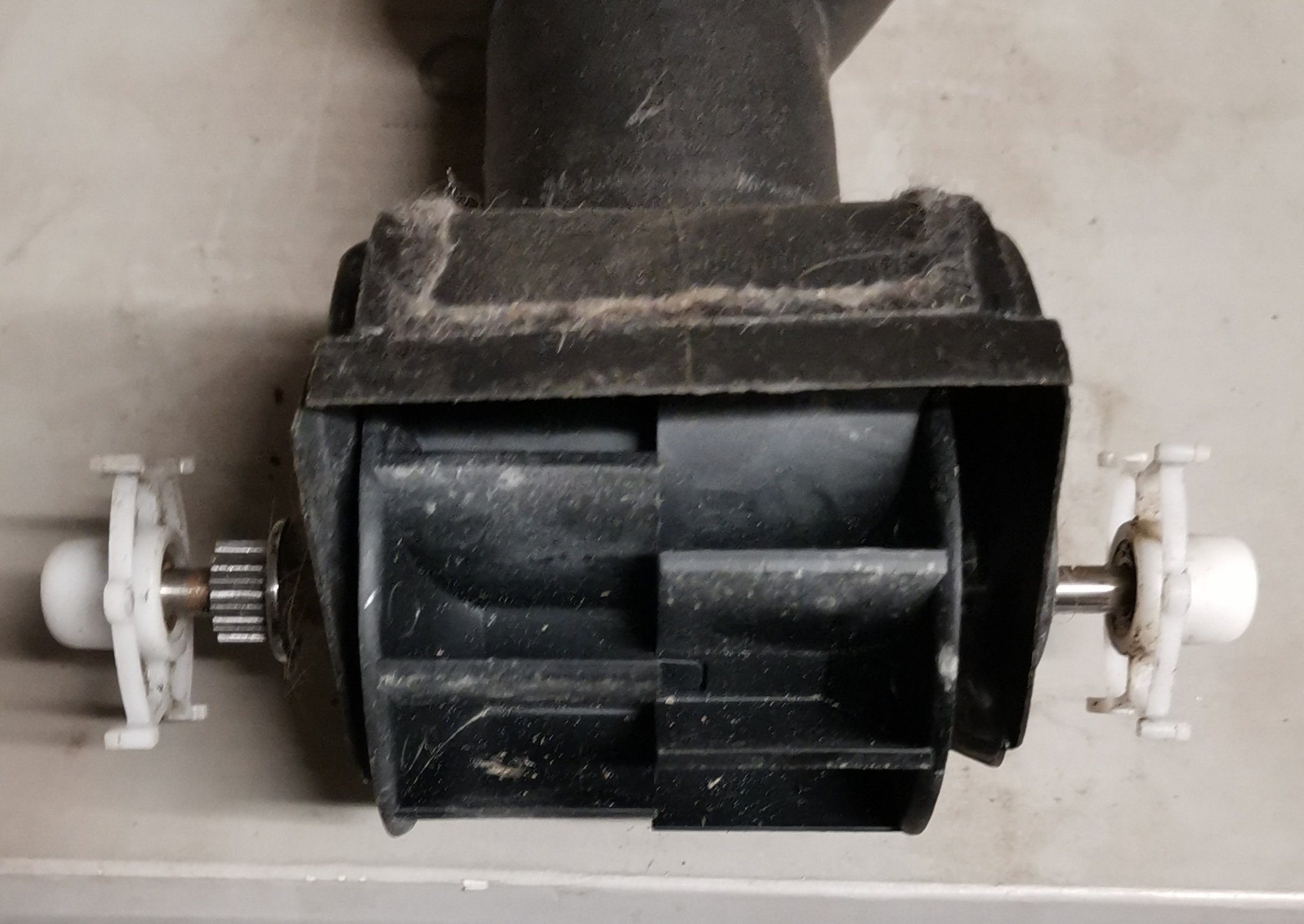

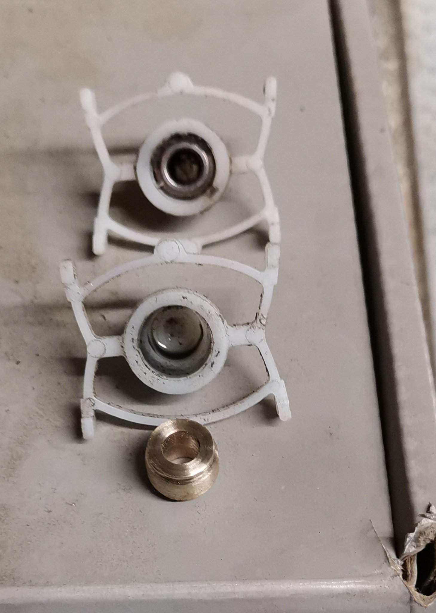

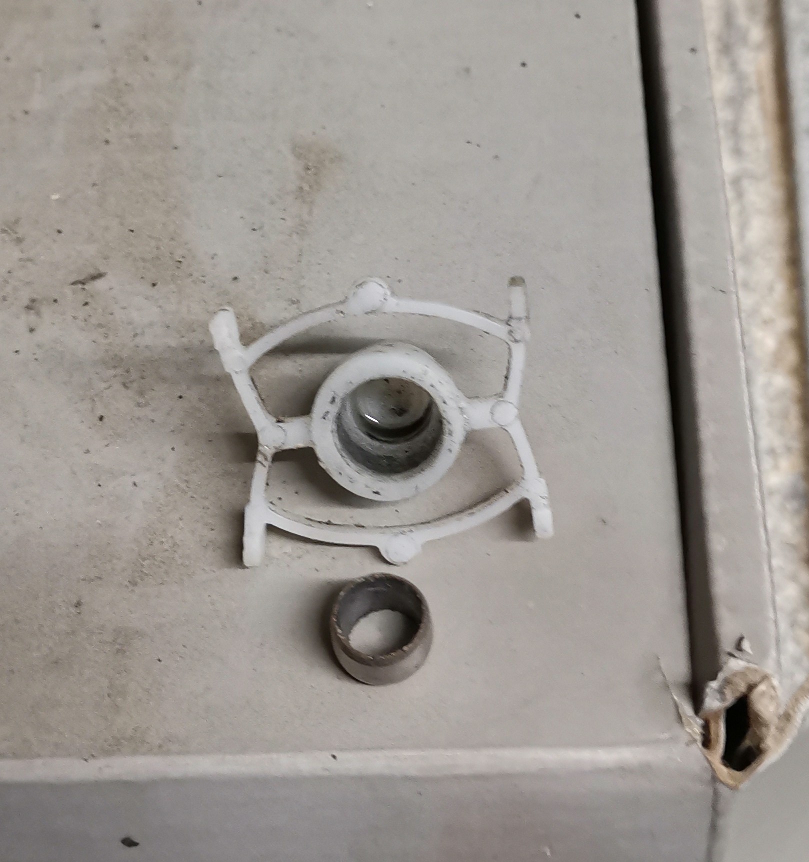

Bosch vacuum cleaner floor attachment brush wasn't rotating properly.
Took it apart.
For some reason one of the turbine bearings was missing.
Must have fallen out during previous cleaning?
Made a new bearing on my little lathe push fit as per original.
How it should look (good side)
What was left, missing the bearing core (duff side)
New part turned
Push fitted
On the turbine spindle
All back together.
Sounds up and drives the rotating brush like new.

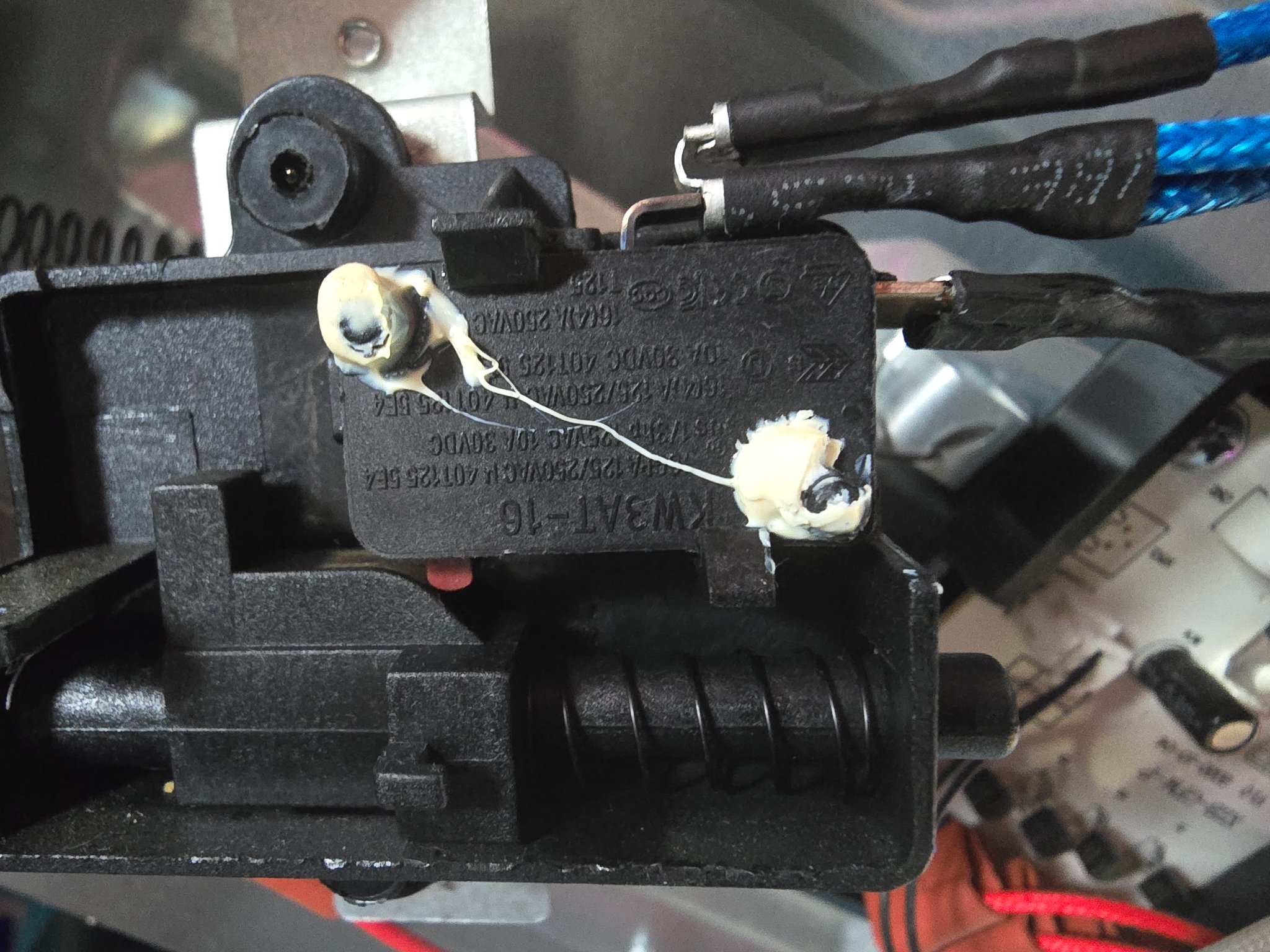

Alesis Quadraverb Plus.
Broken / worn out power switch. Eyeballed the faulty one, looked at similar ones on eBay, took a punt on one that looked close enough.
Turned out it was a perfect fit. Ok, not the most involved of fixes, but I'll take it!

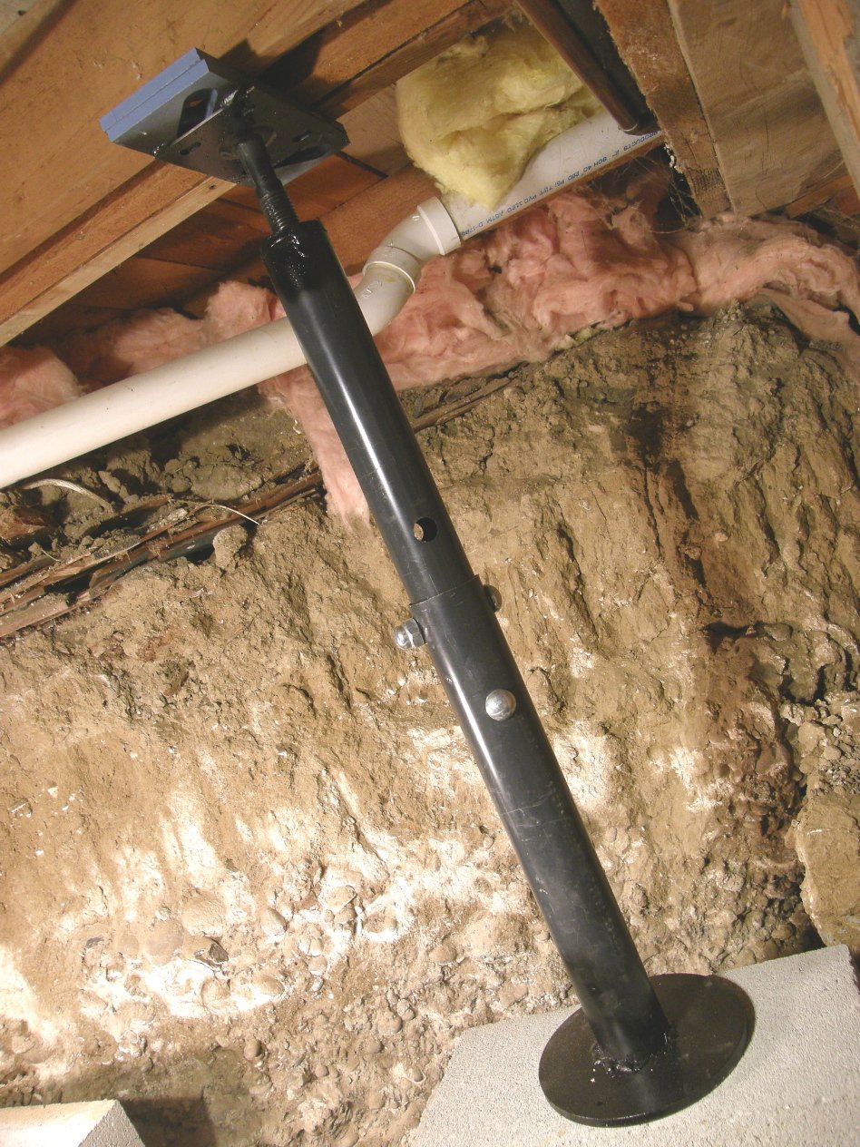

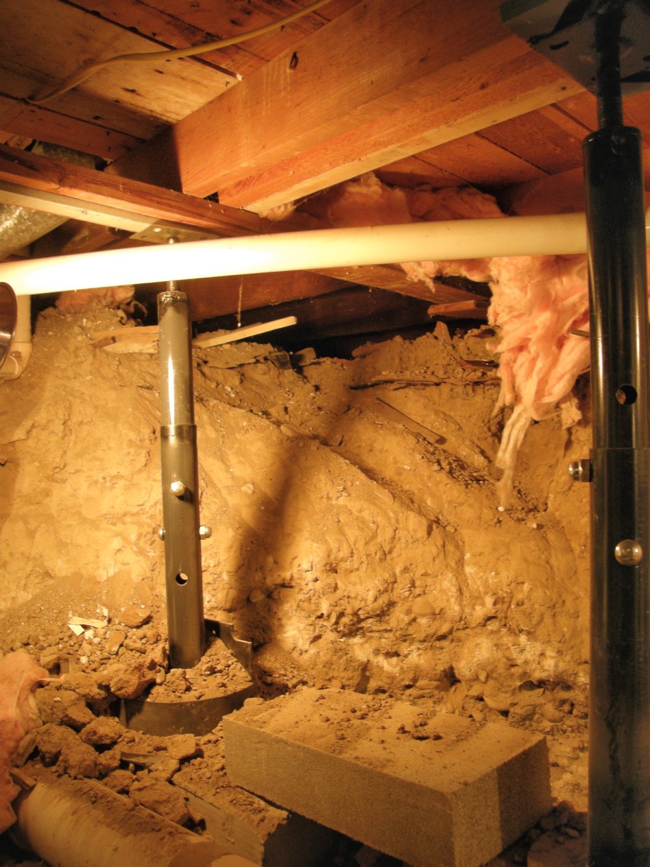

It seems that everything that I buy either needs modification or return to sender. Unfortunately, this includes the 1930's house that I bought 17 years ago. Started looking around and yes, I expected to spend money, but it doesn't stop me from more looking. I spied this next 'fix' when I bought the house and let it go for all of those years. Now it has become time to redo some really crappy work. I am now an underhouse miner. The more I look, the more I dig and replace unbelievable 'supports' (stacks of crap and wood under the floor joists). Pur some concrete, use some heavy duty pipe supports and keep on digging.

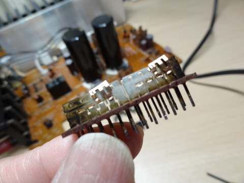

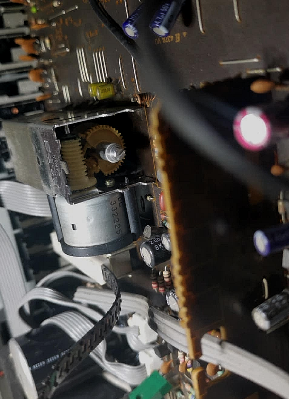

I have an idea of what you are talking about because I tried to repair a board mounted rotary selector switch in a Carver unit. In my case, I finally had to replace it with a much sturdier rotary switch. The old one was mounted to the board much like you described and was next to impossible not to damage. It was all open air as well. Not very impressive.
Reactions: shadowplay62
Actually i do not use the selector that much as this is my computer audio system, but lately it was not possible use the amp anymore. In case I had damaged the board I would have replaced the selector with a rotary one and used external cables.
This is my selector, it was much dirtier than that and the copper parts are so tiny and fragile that was very difficult to restore the contact with the fix part.

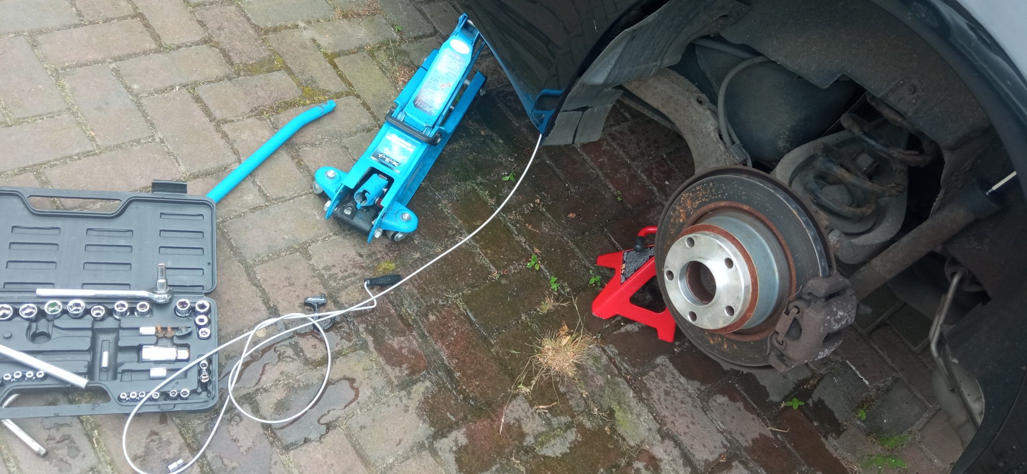

The blocked roof-drain of my old Z4 clunker.
Been on the to-do list for way too long so decided to tackle it. Jack up, wheel off, loosen arch liner, insert unblocker wire. Nothing too complicated but a chore nonetheless.
Everytime it rains the drain channel overflows into the interior and pools in the seat-wells. It's already zapped the passenger-occupancy detector module which causes the seat-belt light to remian on in the dash, so that will be the next residual job to tackle.
'It never rains but it pours.'
The putrid deluge that came when the blockage was removed was a spectacle to behold,and smell. yuk
Pictures from https://bubblecomposuki.blog.jp/archives/17598589.html
Try Kontakt PRF 7-78.
It's specially formulated for slider switches, faders etc.
