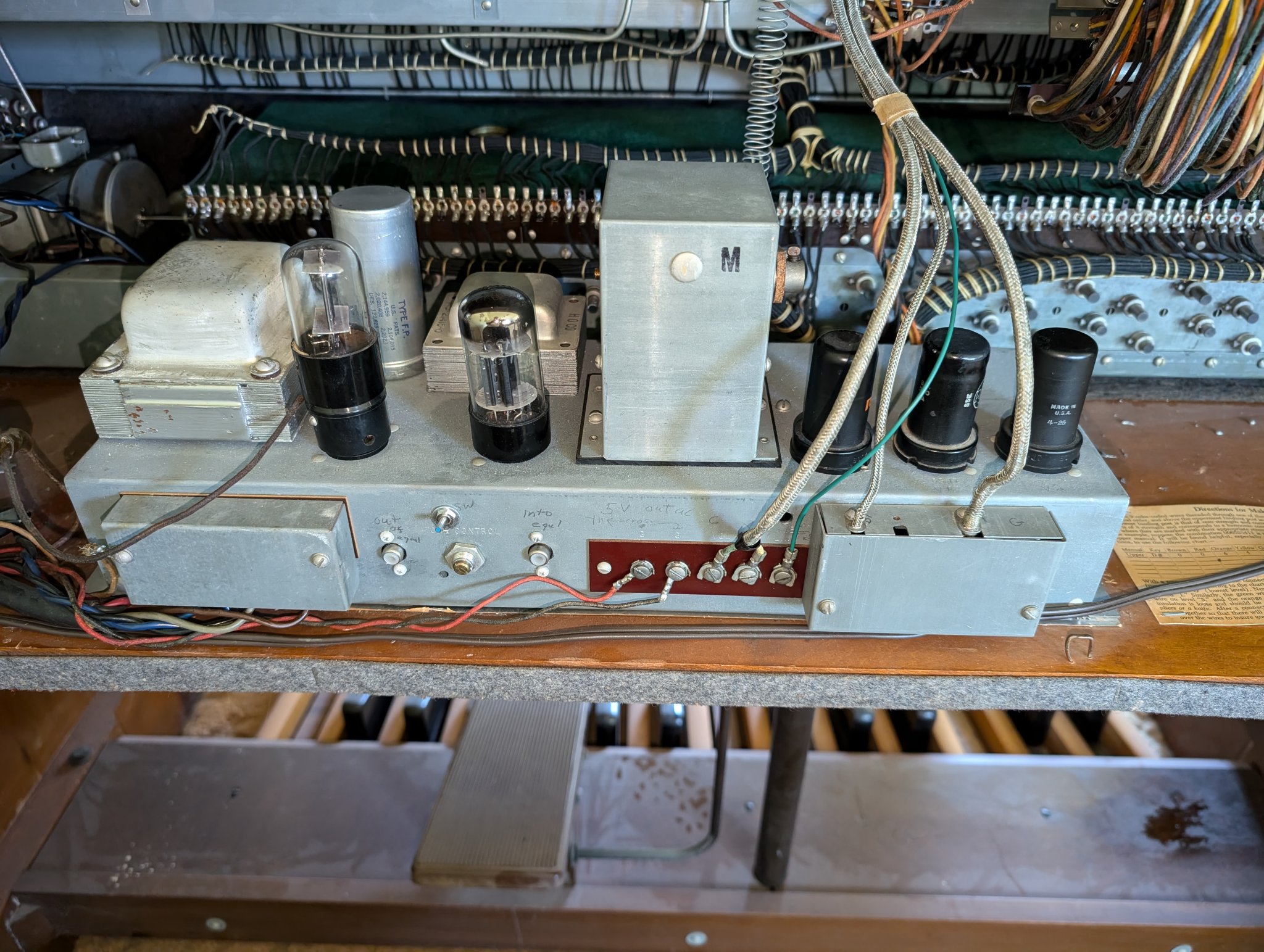

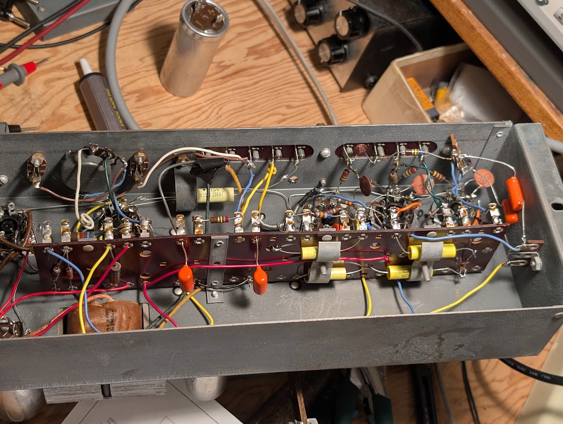

The audio output level was very weak. Tracing through the preamp found there was no gain and lots of DC offset from the old capacitors leaking. So a new set of caps were installed this week.

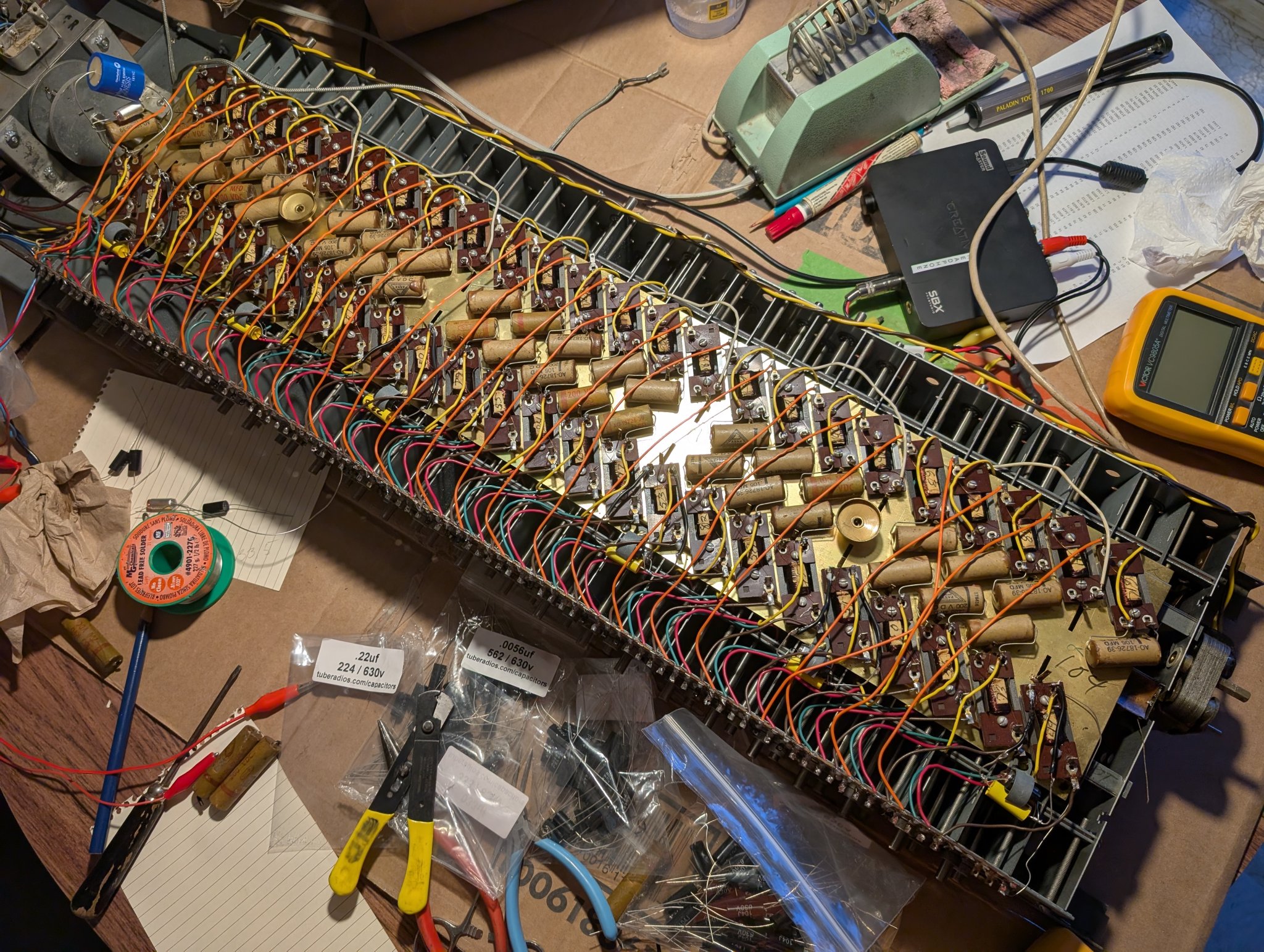

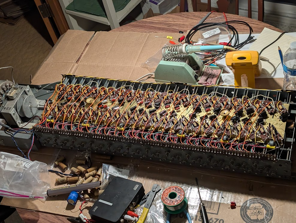

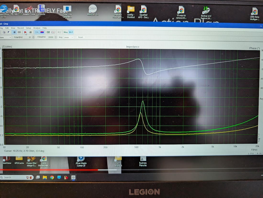

Now I'm working through the capacitors in the LC tank resonators on the tone wheel generators. Rows of capacitors to be replaced. Values are selected to match each LC tank circuit to each tone wheel frequency.
Preamp in the organ.
New capacitors installed in the preamp. Now working properly. 50 mV input gives 3 V output.

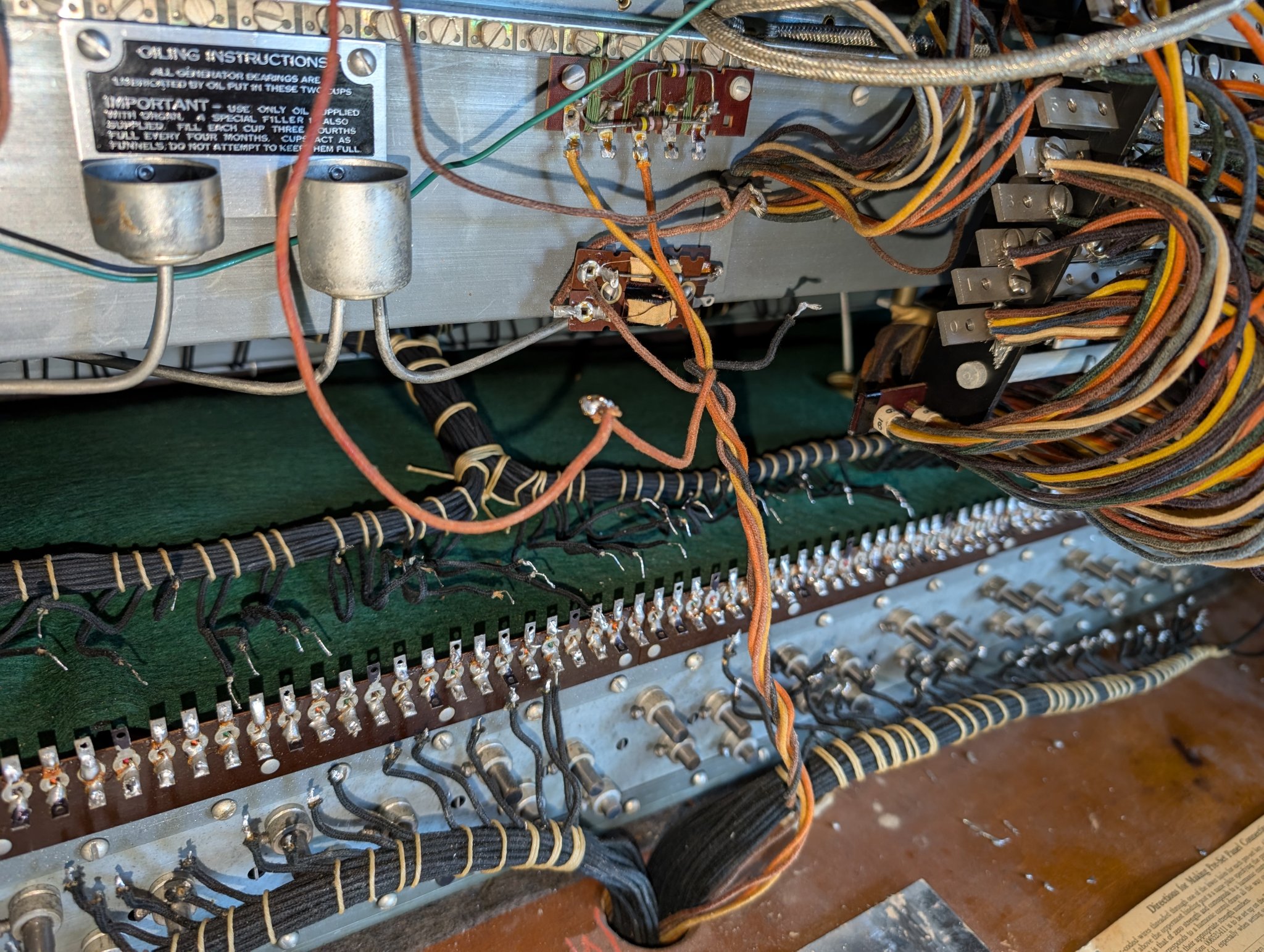

Disconnecting the wires from the tone generator.
Tone wheel generator with 91 individual permanent magnet generators. Six capacitors replaced and a whole bunch more to do.
Measuring the resonant frequency of one LC filter.

RE tuning the tank circuits- a decade cap might speed the process up a lot. And this is quite a good deal: https://www.ebay.com/itm/2669357523...R3ob3F1MD/KWfJR85PDQojqQ==|tkp:Bk9SR_yU_vzxZA resonate the coil at the right frequency and read off the display what you need for a cap. The temperature coeffients will be a possible issue but would mostly affect the amplitude as the tuning shifts.
A decade box would have been good. After about 12 hours of working on it I installed the final capacitor this afternoon. I got pretty good at guessing the value I needed to add or subtract after measuring the resonant frequency using the nominal capacitor value.
Next I need to fire up the motor and check the relative levels of all the generators. If needed I can adjust the pickup coil gaps to the tone wheels to get a good waveform and balance the levels. I wish I had some sort of micro positioner.

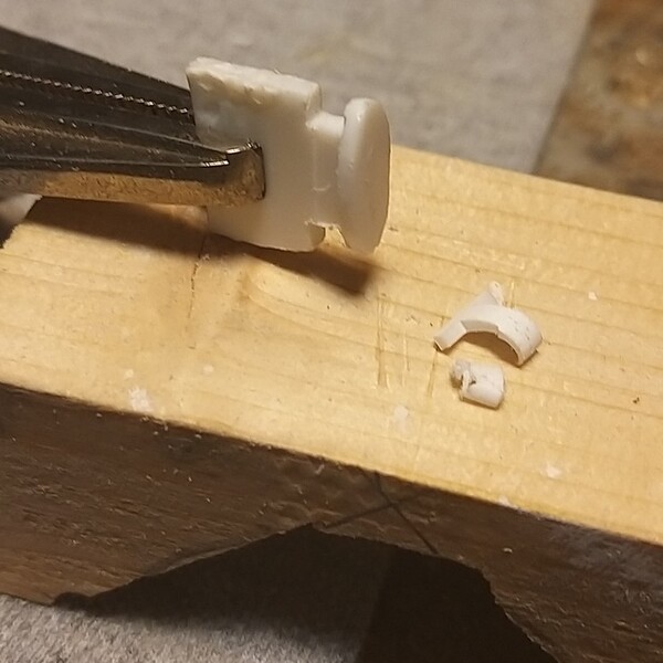

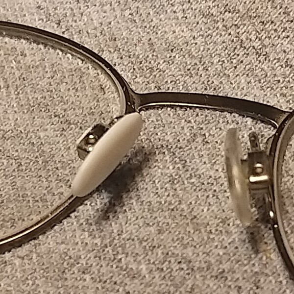

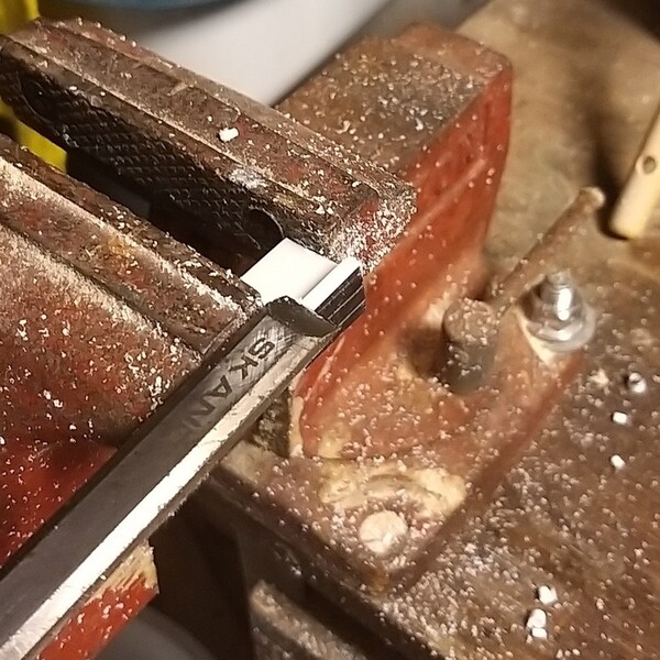

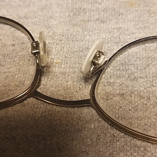

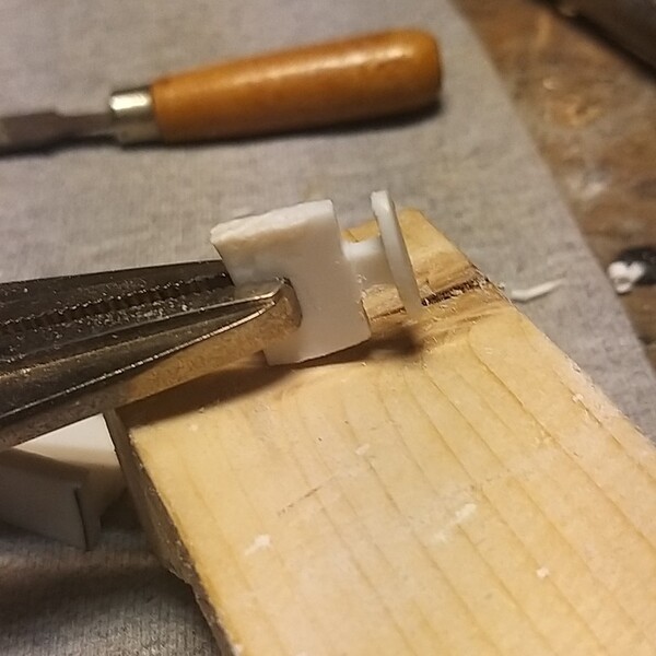

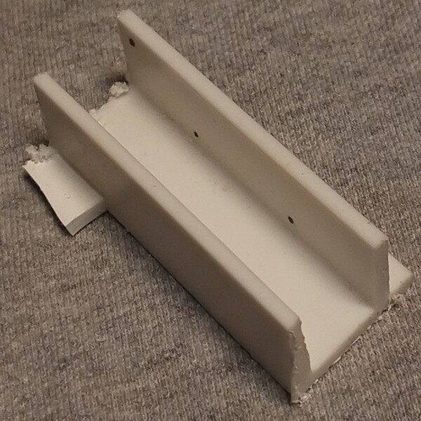

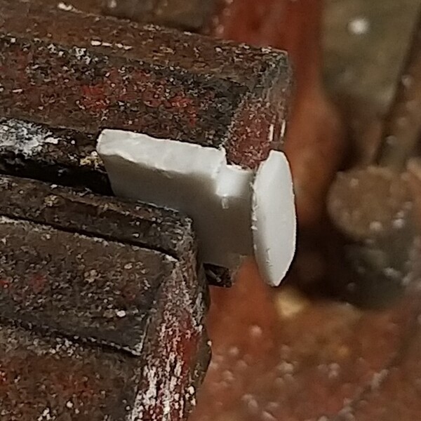

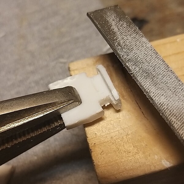

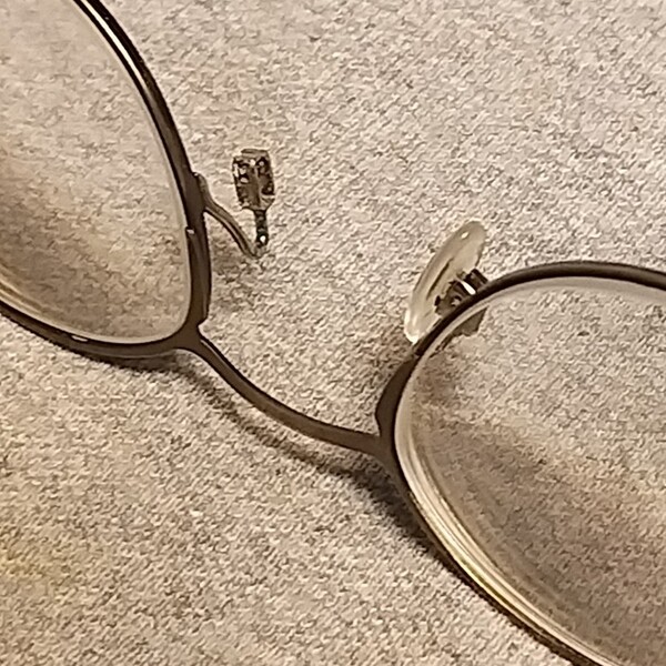

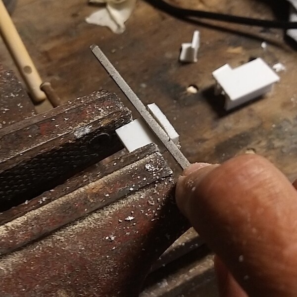

I repaired my glasses. The nosepad had broken off its support. The material is a fixture for a toilet flush mechanism which I eventually did not use but it came with the kit. Although that is a waste I did save it. As I save everything. Yes I am planning to buy a second 20 ft sea container for storage.
We get them at the spectacle shop...about 4 for 10 cents...and I have at least four shops in my city repairing spectacles.
No charge for regular customers..it is a two minute job.
They will even change the spring loaded hinges if needed and possible.
But then my city is a famous center in India for spectacles, (lenses etc. also), corrugated boxes and distribution transformers.
In any case, a commendable effort, making it from solid in a soft material.
