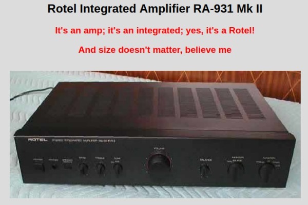

Further fixes follow. My Rotel RA-931 MK.2 audio amp blew up for some reason:

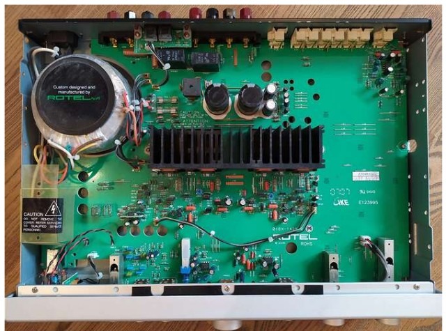

Looked like this inside, with a toroidal transformer and NE5532 op amps and a discrete output stage:
My new replacement in the second-hand market:

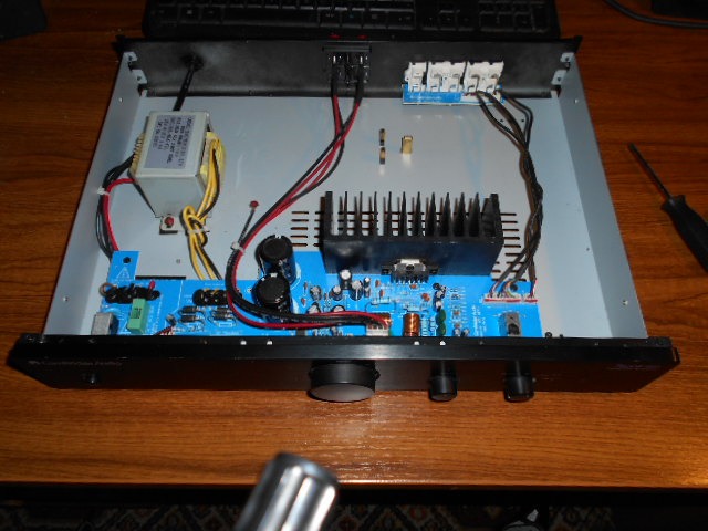

An internal inspection of the Cambridge Audio Topaz AM1 reveals a poor buzzy square-frame transformer and indifferent old JRC 4558D op amps and an integrated one chip output stage.
But sounds OK for a 20Wpc amp at £30.

Excuse my 'new to the forum' stupidity, but has your Rotel faceplate changed colour from picture 1 to picture 2?One of the World's worst ripoffs is fitting a new battery to your wristwatch, IMO! I like wristwatches since they allow me to be aware of time even without my mobile phone.

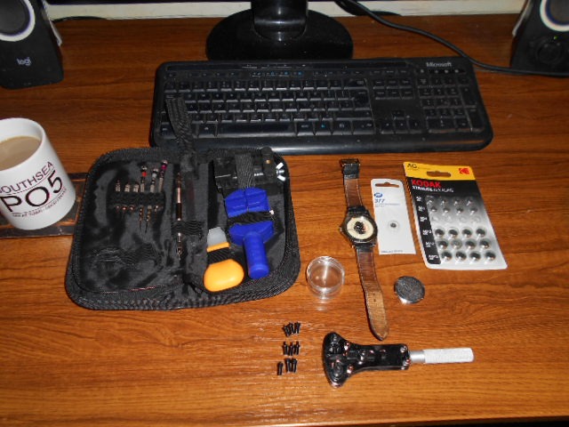

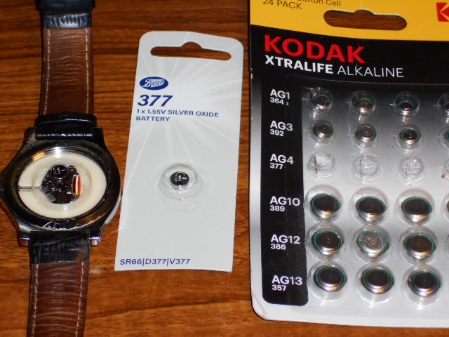

Just to build up my confidence with minor success, I have fixed my wristwatch battery. Noting that a new battery is £12 from the High Street every 6 months, I wondered if I could DIY it with a £10 wristwatch repair kit from eBay:
The trick is to have the tool to get the back off the watch as I understand this dark art, thing is some of them need a special triangular unscrew tool:
I found I had used up all my 1.45V AG4/377 Alkalines ( A mere £1 at Poundland for the lot, but currently out of stock) on easier watches that just needed a penknife to flip the back off, but found some Silver Oxide 377 cells at Boots the Chemist for 0.99p.
I call that a success! Cost me £10.99 for the fix. As opposed to £12 at the shop. And I have the superior Silver battery which should last for ages!
(Caution, wristwatch batteries are terribly non-standard. There are all sorts of diameters and thicknesses and voltages and tendencies to leak and explode. But I'll worry about that when I get to it.)
