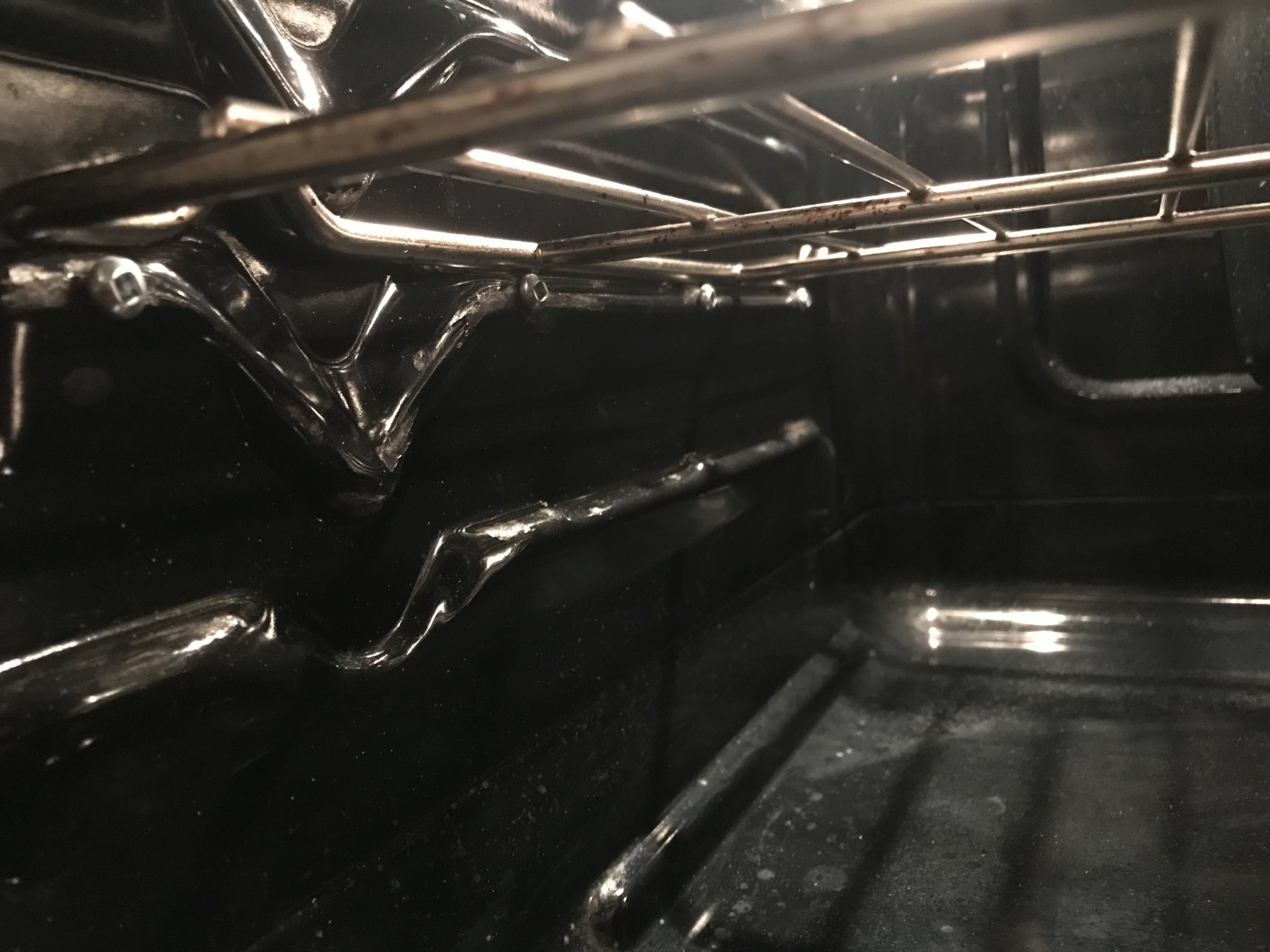

Added some pan head stainless steel screws to the rack support ridges on the inside of our oven. The walls have bowed out after 4years of use (bullish!t) and the oven racks would fall down if you tried to cook something heavy like a roast turkey or large roast beef
The repair hasn’t failed yet 🤞.
Is this a wall oven, or a range? Make & model please.
