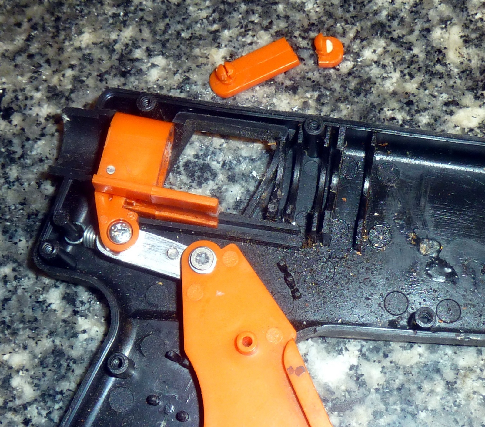

Yes, those are cheap, but they'll always break at the same point. If you need much glue fast, you pull the trigger to hard an the thing is done. So I opened one up and looked what broke. It's a simple piece of plastic, connecting the trigger with the "glue-forwarder". Made it of a little piece aluminum. Won't break again.
Reactions: 1 users
So this is a hot melt glue gun?
Yes it is. Sure, it's not really a thing for glueing, there are better ways, but i.e. it's good for isolating/ making electric save against unauthorized touch.
I would likely find a way to break it a second time.
Those are made really cheap. Not much more parts to break ;) .

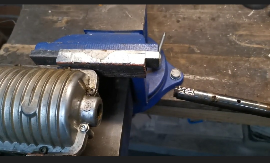

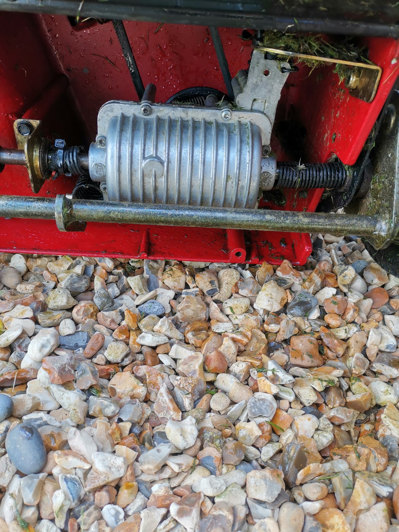

Repaired the transmission in our Toro Timemaster.
After 7 years of 'normal' domestic use, it gave up and would not drive the mower.
This is a common failure.
There's no support or parts.
You are supposed to just replace the whole thing for around £200.
This is a 30" cut, twin rotor walk behind, with Briggs Stratton engine.
After following Taryldactiles's vid on Youtube to remove the transmission.

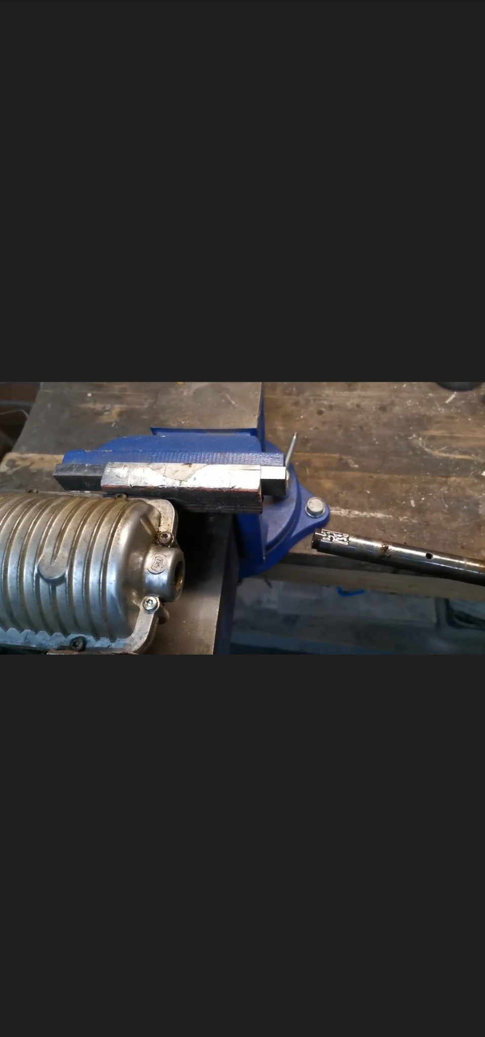

I went beyond the usual swap it for a new one and took it apart.

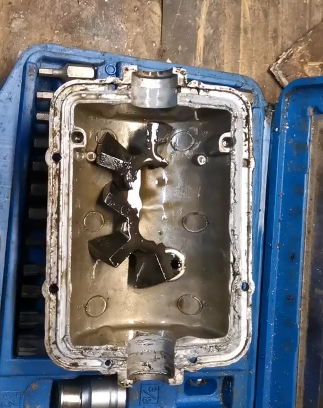

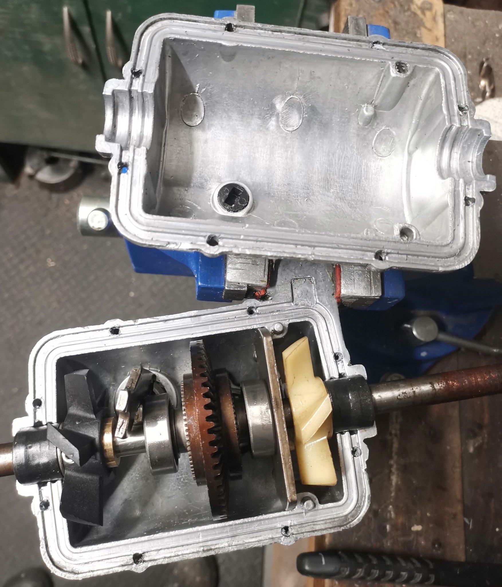

Took the cover off, drained the oil (these things are tiny compared to car diffs).
The half shaft is not supposed to just pull out!🙂
Getting into it, I was confronted by the offending part.
Another 2 bit part.

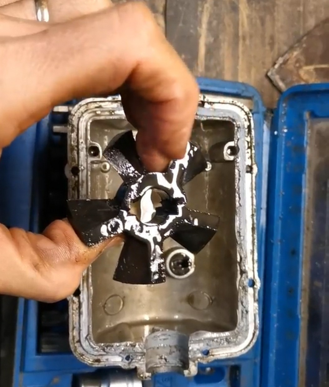

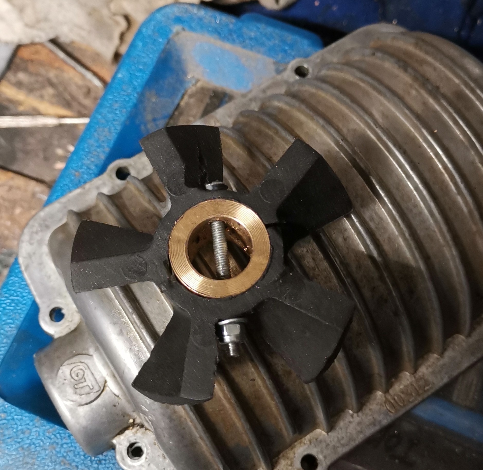

Turns out the oil pickup blade, One on each half shaft had sheared in half.
This also doubled as half shaft retaining bush!
A little pin was located to retain the half shaft.
Designed to maximize ease of assembly, once in the shaft it could just be pushed into the nylon bush! = Weakness right there!
The half shaft is the longer of the two. Gets more load in use.
Bumping around on the grass, up and down border edges etc
Once that was gone to the bottom the shaft could just float away and cease transmitting power.

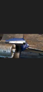

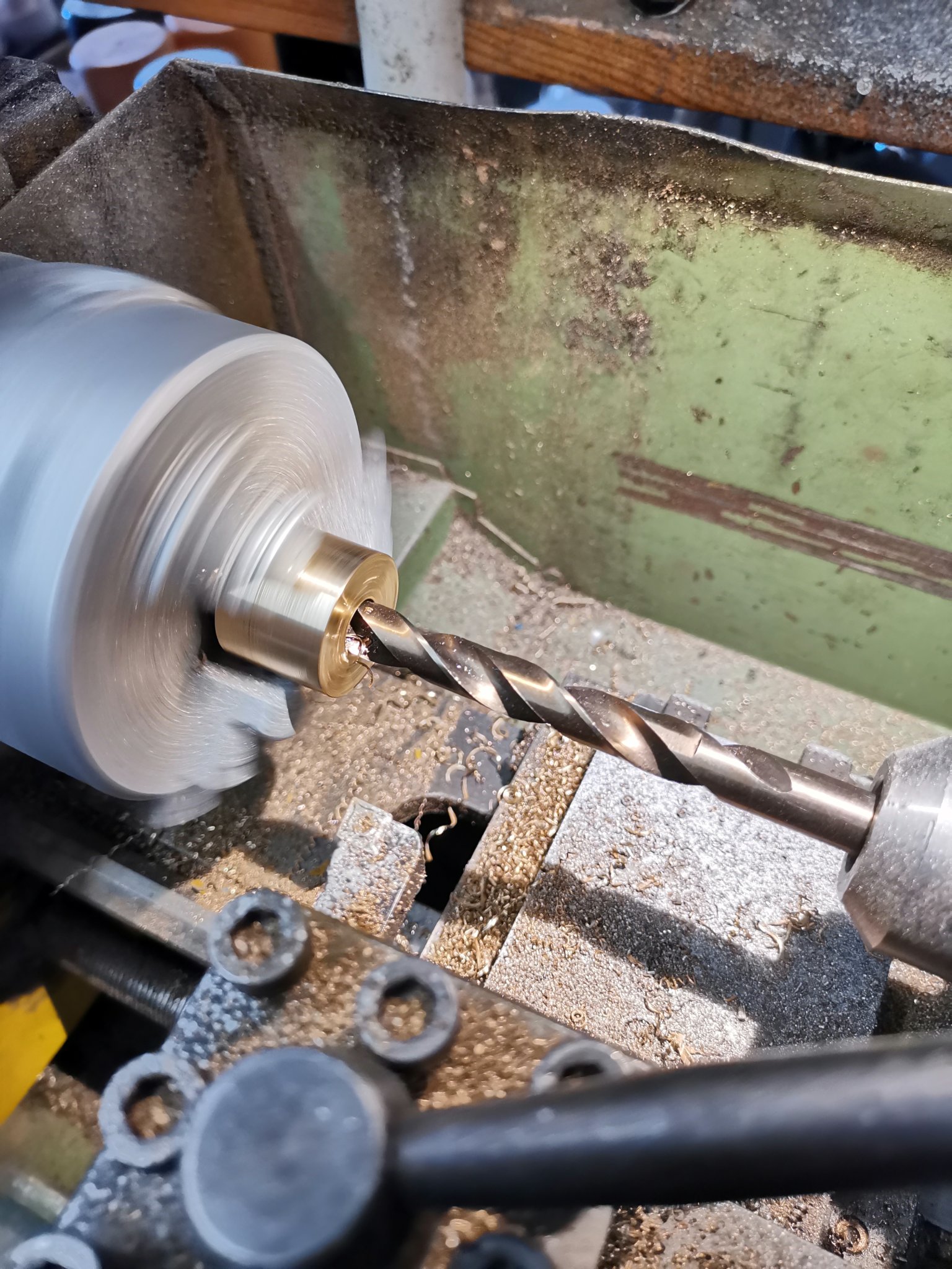

I made a new bush in brass, on my little lathe.
Wanted to keep the oil distributing vanes, so machined out the centre and put a bolt through.
The plastic blades are no longer load bearing. Just flick oil about.
The stainless bolt doubles up, keeping the blades together and securing the half shaft to the retaining bush.
Fix in place..
The other nylon bush looked fine. So, I left it alone.

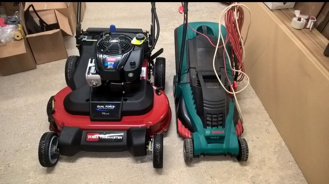

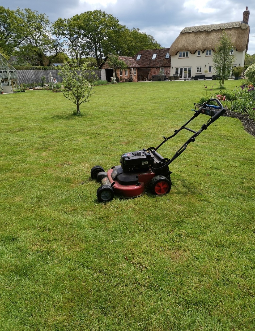

The Timemaster vs smaller plug in mower
Natural habitat
