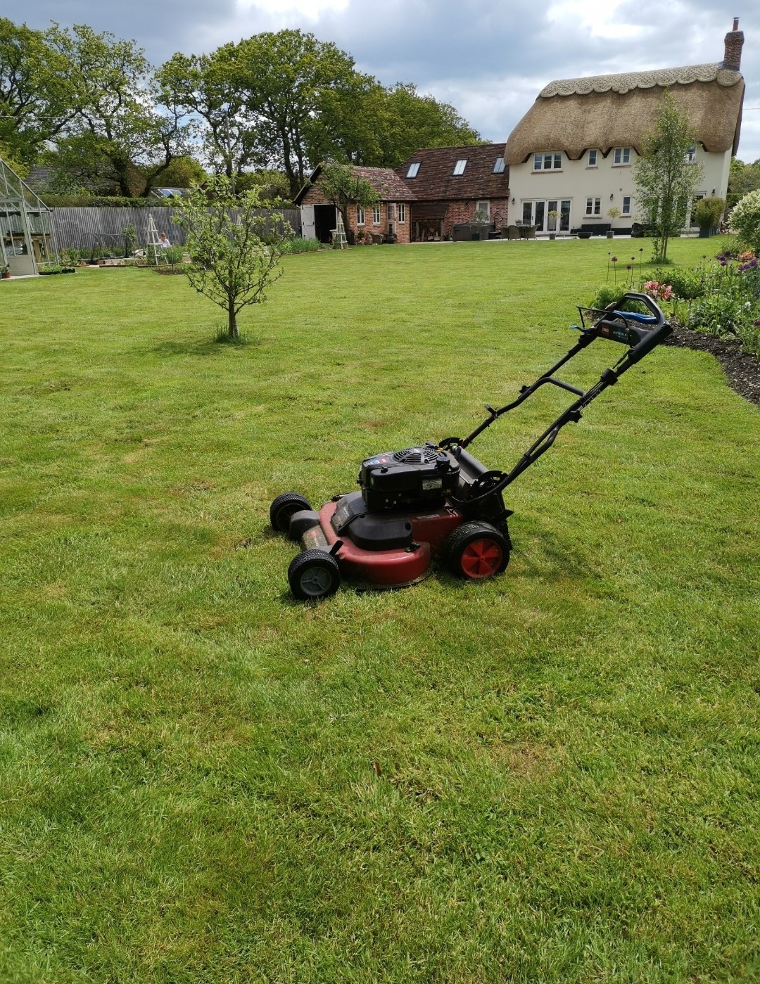

Wow, Looks to me like you need a bigger machine. That is a sizable patch of grass.
I only ever mulch, so no time lost for stopping and emptying.
I think that why the drive belts and pulleys etc have lasted so long.
I engage the blades carefully once.
Cut the whole thing without stopping. Done.
I've never even adjusted them, yet!
That seems remarkable, when I read other blogs and Toro maint threads.
Can do the over 1/2 acre in 35-40 minutes. It's just over a 2 mile walk.
That includes all the trees, flower beds and borders we've put in, that have to cut around.
Nextdoor have a small ride on. I think it's 32"
Takes longer, as ride on first and then a small mower to do all the fiddly bits.
With mulching though, have to do reasonably often.
If it gets very long, I use the side exit and then mulch next time.
Side exit eats grass🙂
It does clog up a bit under the deck, UK moist grass (they are known for that), but it's only to hose off underneath when done.
Don't know what I'd replace it with when it dies - if I can't repair it..
Probably another one.. until I'm too old to walk😂
I've looked at zero turn ones and even big electric ones are becoming more available..

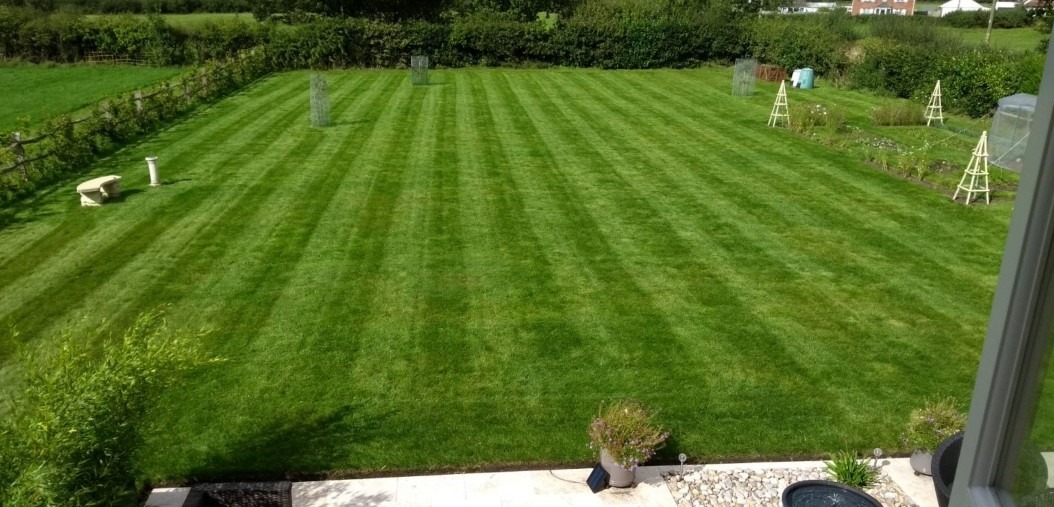

Here's it with the striper kit cut.
Toro make one, I DIY copied it..
A few years ago now.
No wait, that's not it😂
Here we are🙂
This was before we'd done much of the landscaping..
Not like I'm obsessed or anything 😂

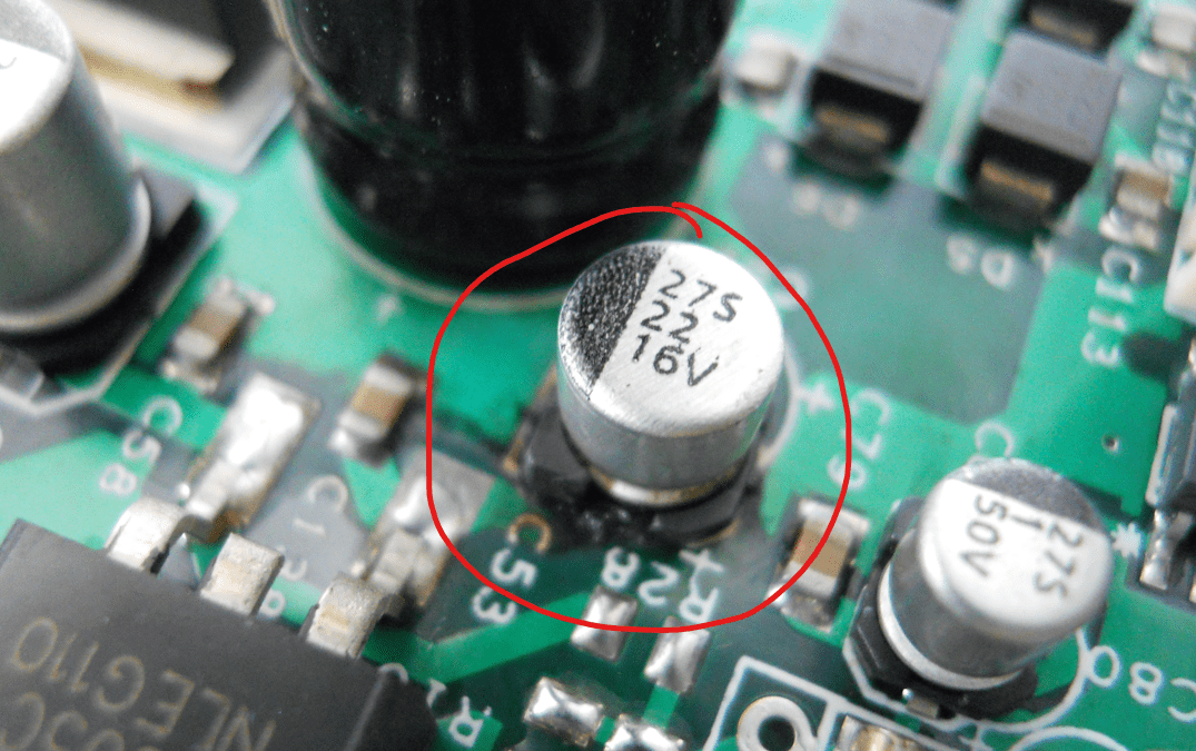

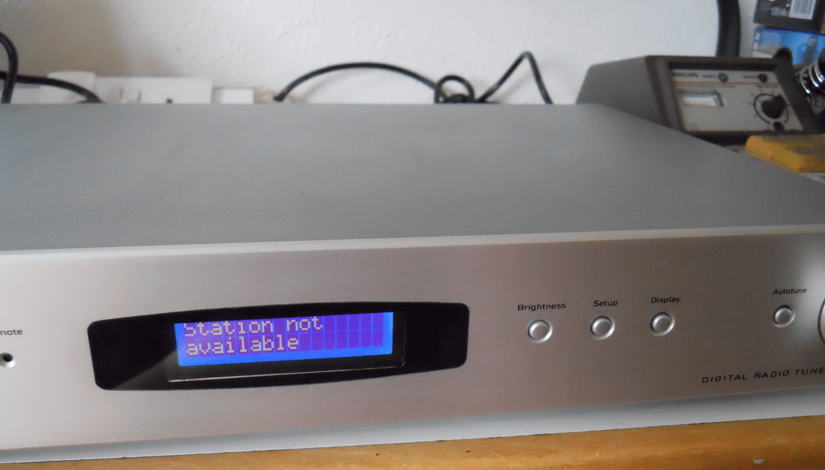

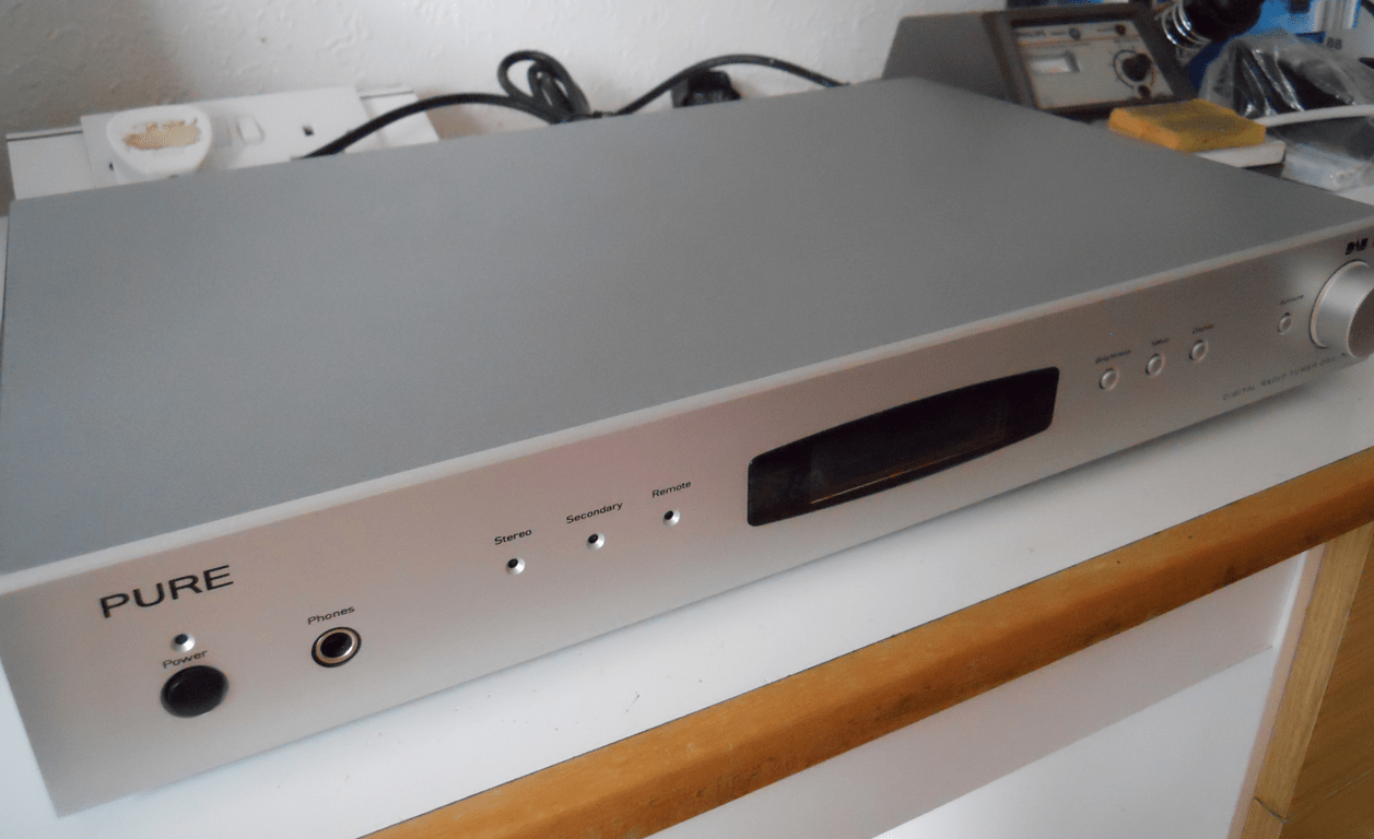

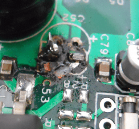

I noticed my Pure DRX-701 DAB tuner was dead yesterday. The T100ma fuse accessible on the rear panel had 'parted'' however it seemed something bad had happened as replacement did not bring it back to life.
Removing the top panel revealed a definite 'burnt something' smell. One of the SMD caps looked a bit suspicious around its base and quickly powering it up generated more smell (no obvious smoke) but lots of heat in the cap. It was well and truly frazzled and fell apart when trying to remove it. Looking at the PCB and it seemed to be a simple decoupler on the input to a 7805 reg.

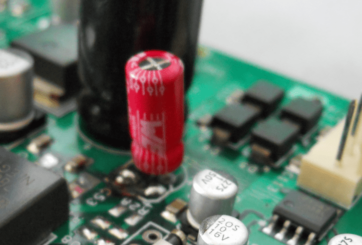

The board has through holes for the caps even though SMD were fitted and so I fitted a new standard leaded variety.
Yay, we have life... all good :)
