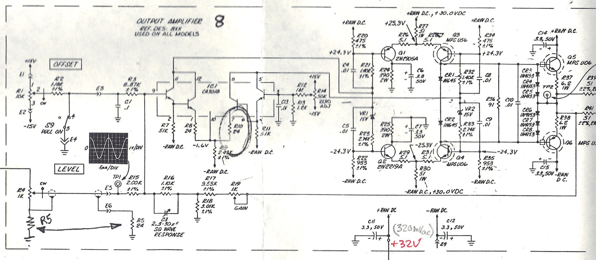

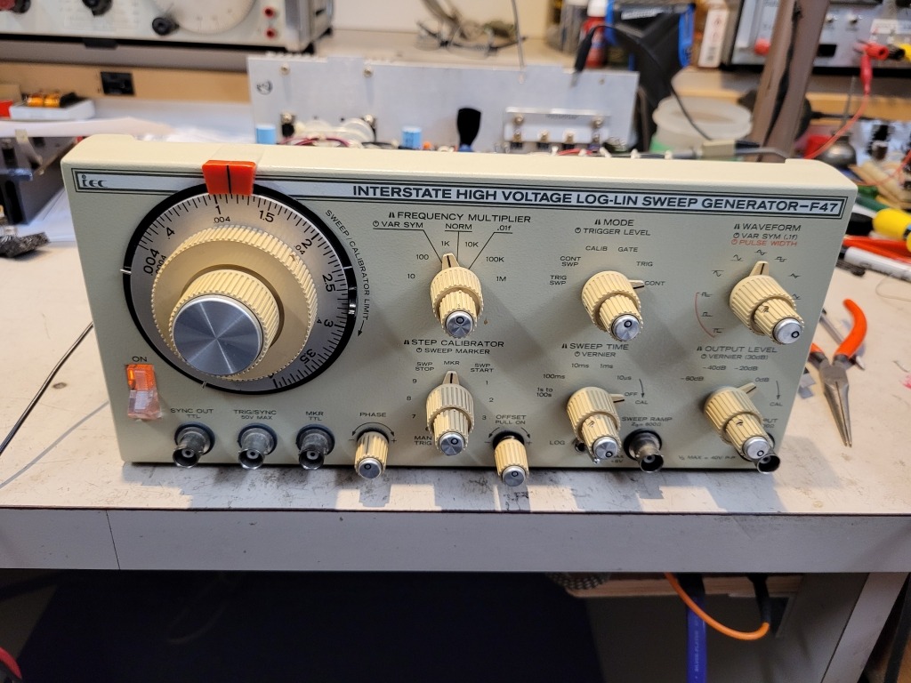

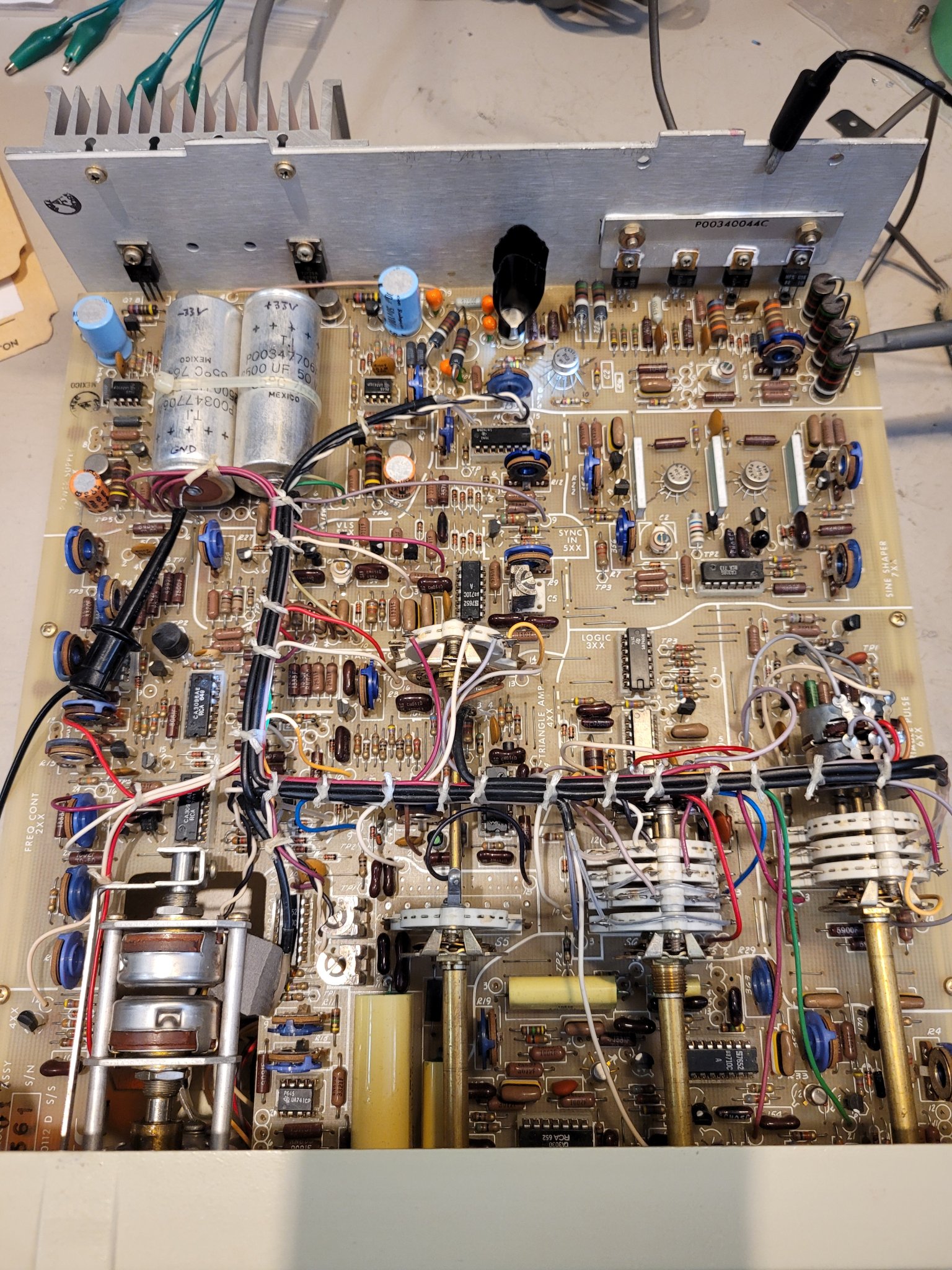

My most trusty audio signal generator I.E.C Interstate F47 stop to work a few weeks back, output was stuck around -25V at the output. I use this generator all the time, so it was a big stop of my testing ability. It has a lot of options, sweep mode, phase, external trig, etc. It is also very high quality inside, high precision resistors, custom film caps, very nice built. I had to fix it...
Was kind of simple at first, Supplies all ok, no ripple, signal was perfect just before the output amplifier. Checked all the transistors, diodes and zener, they were ok. Checked also for shorted tantalum caps, all ok. Voltages were not exactly as the schematics around IC1 (CA3018), it is there that the DC offset is combined with the signal. So order one from Ebay, got it this week.
Replace it, no luck, was still not working, now took the hard road, and started testing all the parts, connections, pcb traces, voltages. First thing I found was R7 connected to IC1, pin2, -RAW DC was open!, checked the pcb, and some kind of contamination was preventing the resistor leg to make a good contact with the PCB pad. Cleaned, resoldered and now good -33V at this point. Amplifier was even worst, solid -25V at the output...
Continue my search, point by point, I had -1.4V instead od -1.6V at IC1, pin 10. Checked R9, OPEN! first time such high quality Vishay RN60 turn bad on me, in such low wattage, low voltage application, completly open... Replaced it from my stock, had the exact 2.43K RN60 in stock.
5Hrs of work later, Bingo amp is not working perfectly.
