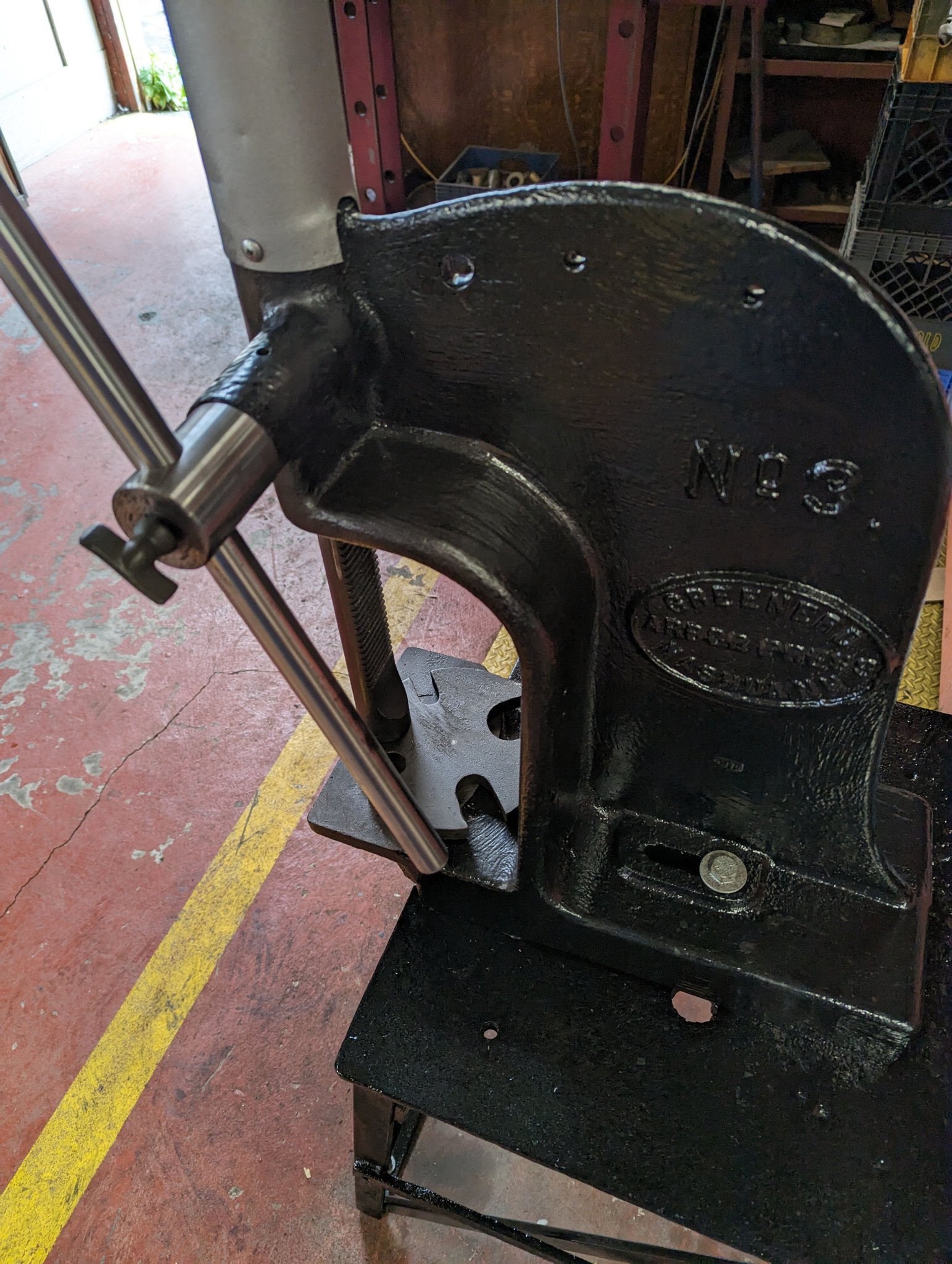

Greenerd #3 arbor press. Out of the hunters point naval shipyard circa 1940, pinion shaft finally gave up. I started looking at domestic ratcheting three ton arbor presses and they are a bit pricier than I expected. I had the thought to Google Greenerd and shockingly they still existed and had all the parts on the shelf, looking for new cast iron vintage style 3/8 - 24 wingbolts I found a reproduction of a fastener used for the tops of army Willie's jeeps that works perfectly.

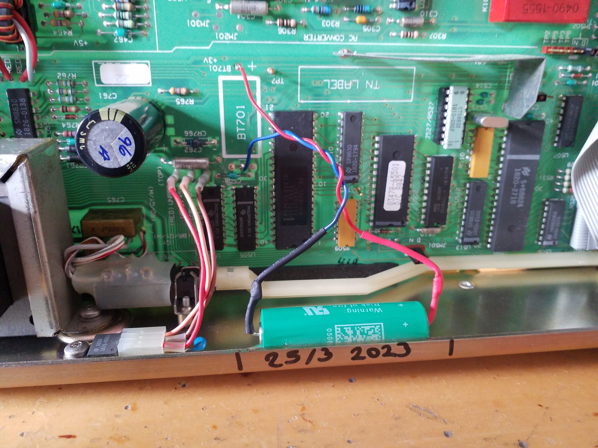

Have two hp3478a that needed new ram batteries before they went below 2 volt and calibration went to smithereens.
Thought I knew battery size .. but originals were shorter, so as true diy I glued them in,, who cares they will hold charge 20 more years, and I will be to shaky to hold a soldering iron.

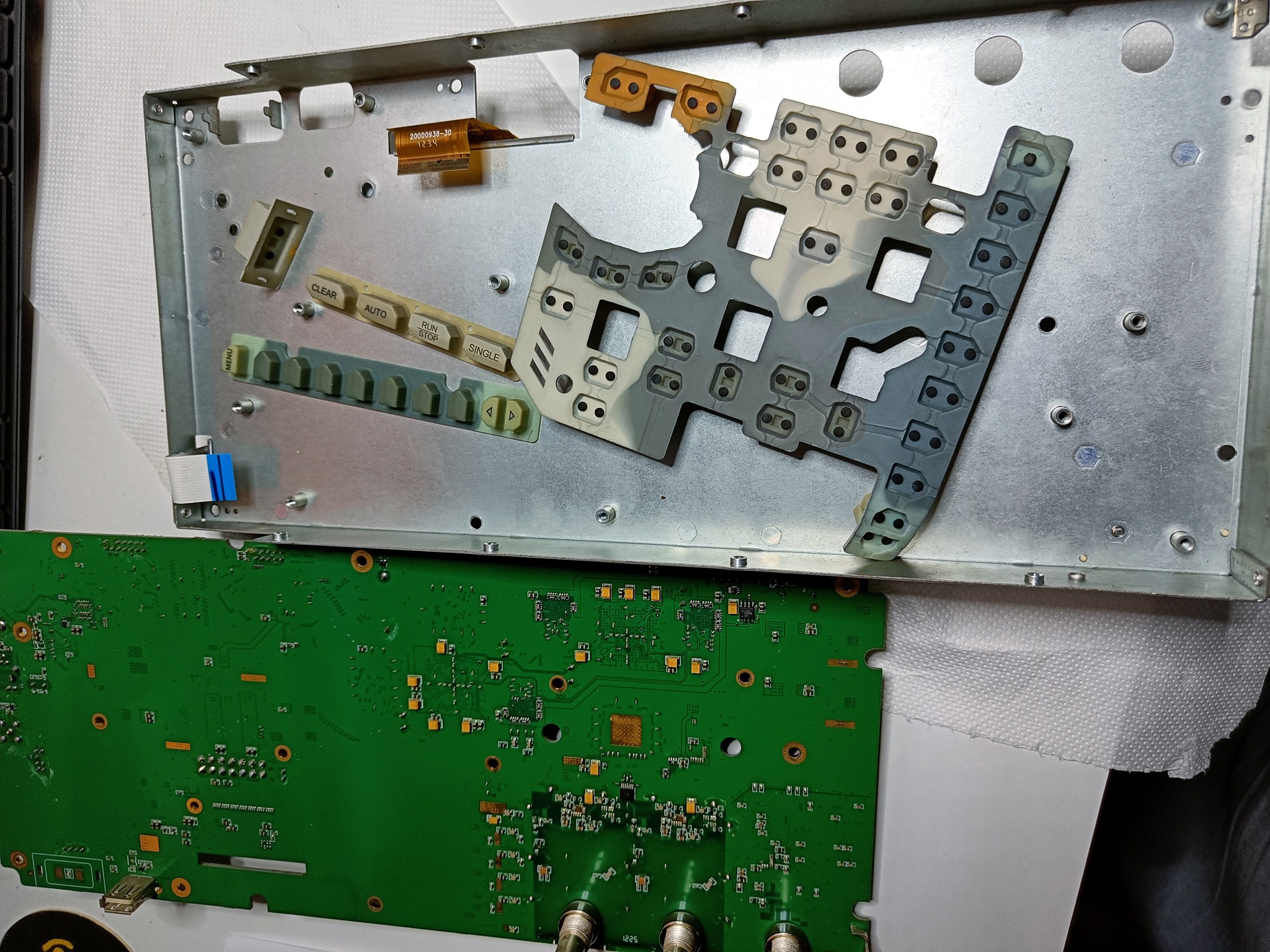

Three of my Rigol digital scope's buttons were refusing to easily respond for some time now. I dismantled it down to bits, then bathed the elastic keypads in warm water and mild detergent to refresh looks. Dried them with hot air. Then cleaned the buttons contacts and control PCB's mating grid-pads with IPA. Original offenders behaved themselves since. But not before long another couple of buttons became difficult.
So today I retaliated. I dismantled the scope fully again but this time I wasn't as gentle to the buttons. I simply dragged their black conductive points back and forth and to the sides on printer tray paper. Pressing just enough to leave grey marks on it. Result is all buttons became as responsive as new! If not better. 🙂
Reactions: Mooly and Siberia
This looks similar to membranes and contacts in synth keyboards. I would be weary of removing the carbon on the membranes as you did. Instead, use a pencil eraser on the PCB-side contacts and then IPA there.
The carbon-side can be redone if necessary with special conductive ink, otherwise it usually can be left as-is.
Done the IPA thing in the first attempt but it proved halfway restoring sensitivity and not preventing next occasions in this case. The carbon contacts roughening drag on paper approach worked impressively on the other hand. If it will also prove long lived, then its a total winner. Else I will next time try some metal particles loaded paint or something similar.

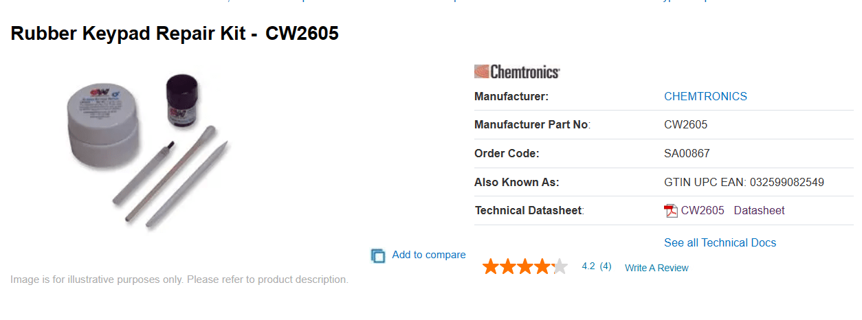

Conductive rubber keypads have often been a bit of a problem. Sometimes the rubber 'sweats' plasticiser with the contacts having a wet and slimy look and feel. I would have thought the membrane would be available as a spares item tbh, it surely has part number somewhere in some manual :xfingers:
As last resort there are some repair compounds available (I have never tried these so can't say how good or other wise they might be). Pricey to at around £32 GBP

Yes, that's it, the rub on paper took the slimy patina away. Easy to perform and cost free, fast. Deserves a chance I would think, especially in onsite maintenance situations. Silver loaded professional coating solution like the one you linked should work even in more advanced contact wear situations and be more future proof. Costly unless doing many such repairs a year, mainly because of its 18 months shelf life spec. It's also quite involving to carefully coat sometimes hundreds of tiny contact dots.
