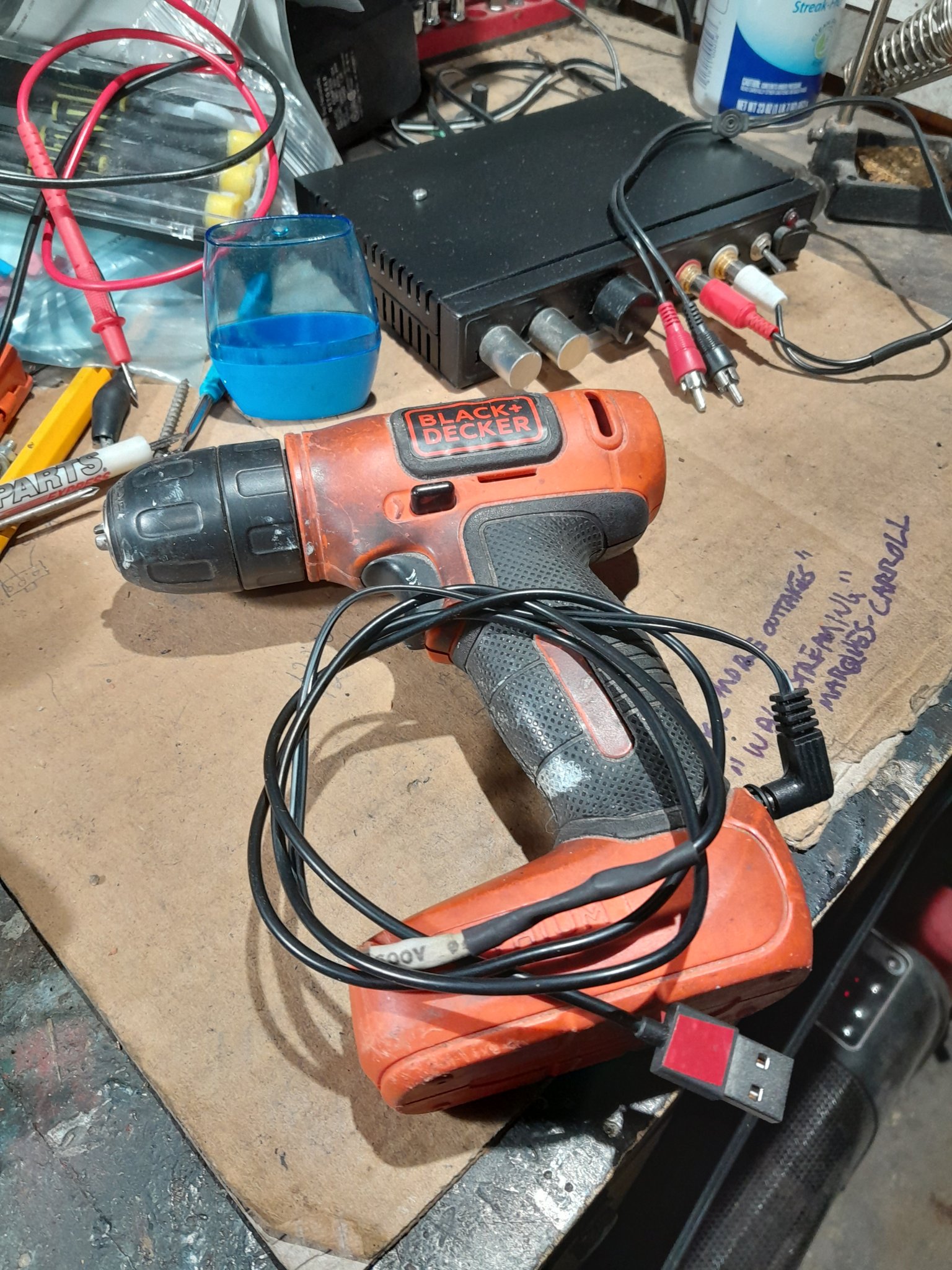

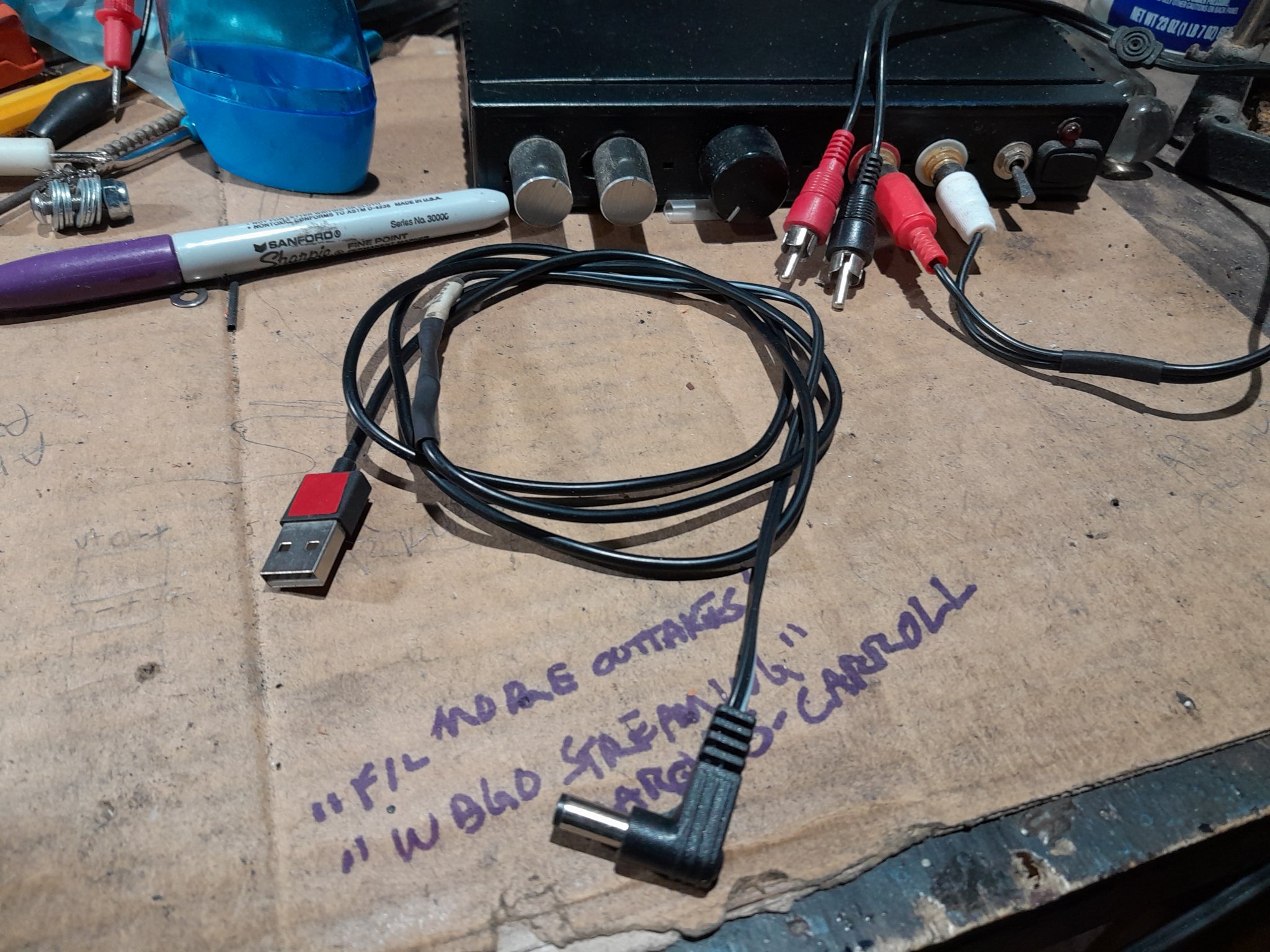

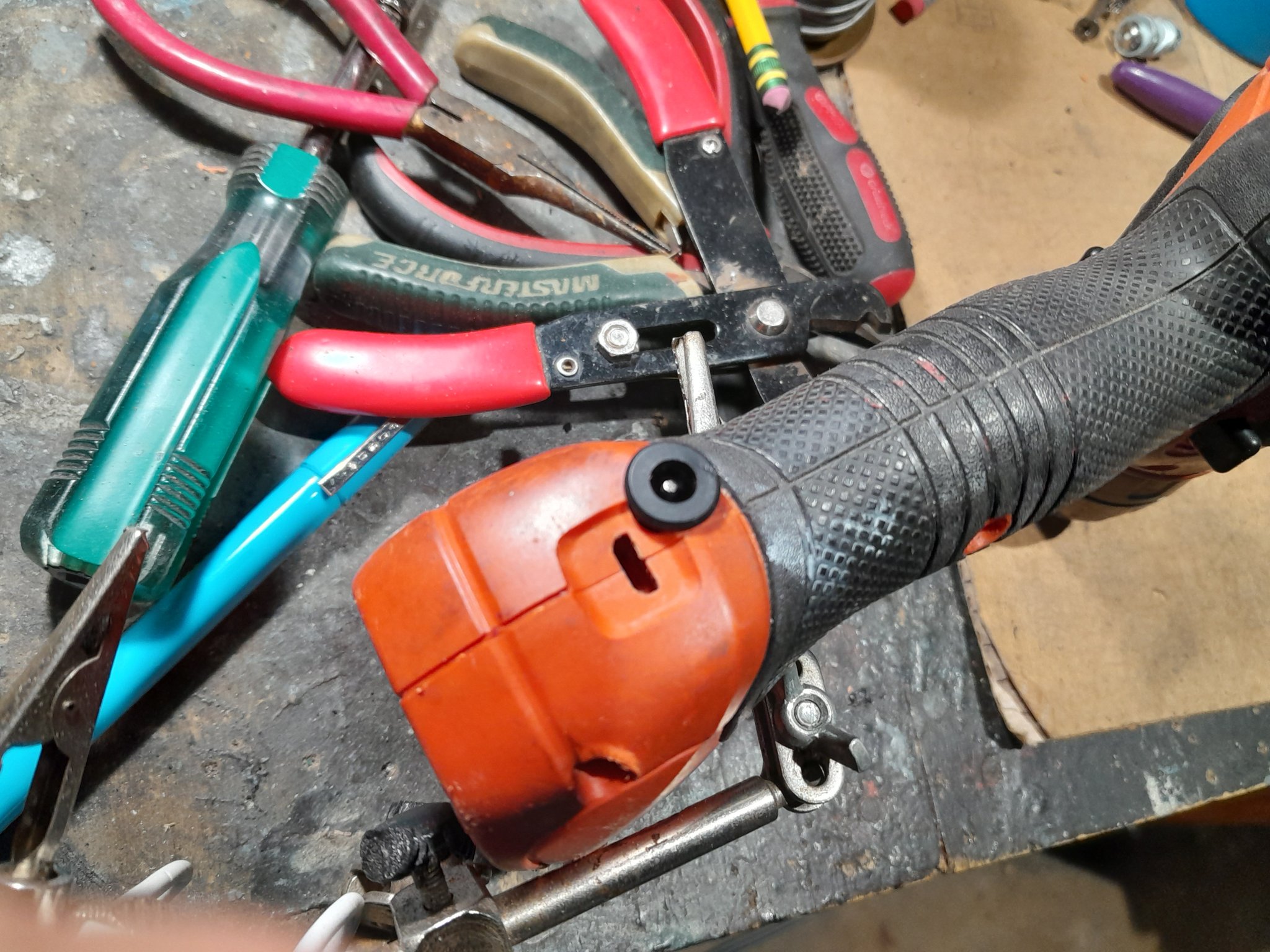

I bought this rechargeable drill years ago for $20. I always liked it but wondered how long it would last. The same drill now is more like $50 last time I checked.
The Achilles heel is the mini USB charging port. It's a very common point of failure on cell phones. So after a couple years of wiggling the plug it stopped working completely. The jack was completely detached from the board.
I installed a barrel jack in the drill and hacked a USB charger plug. It works great.

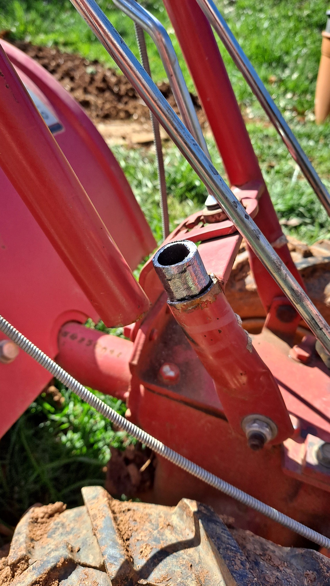

One of the downtubes from the handle/controls for the Troybuilt Pony developed a stress fracture. I bought a short piece of black iron pipe and made a stub to go inside, slipped the two sections back together and welded (sort of) it back. 33 years and it still starts on one pull.

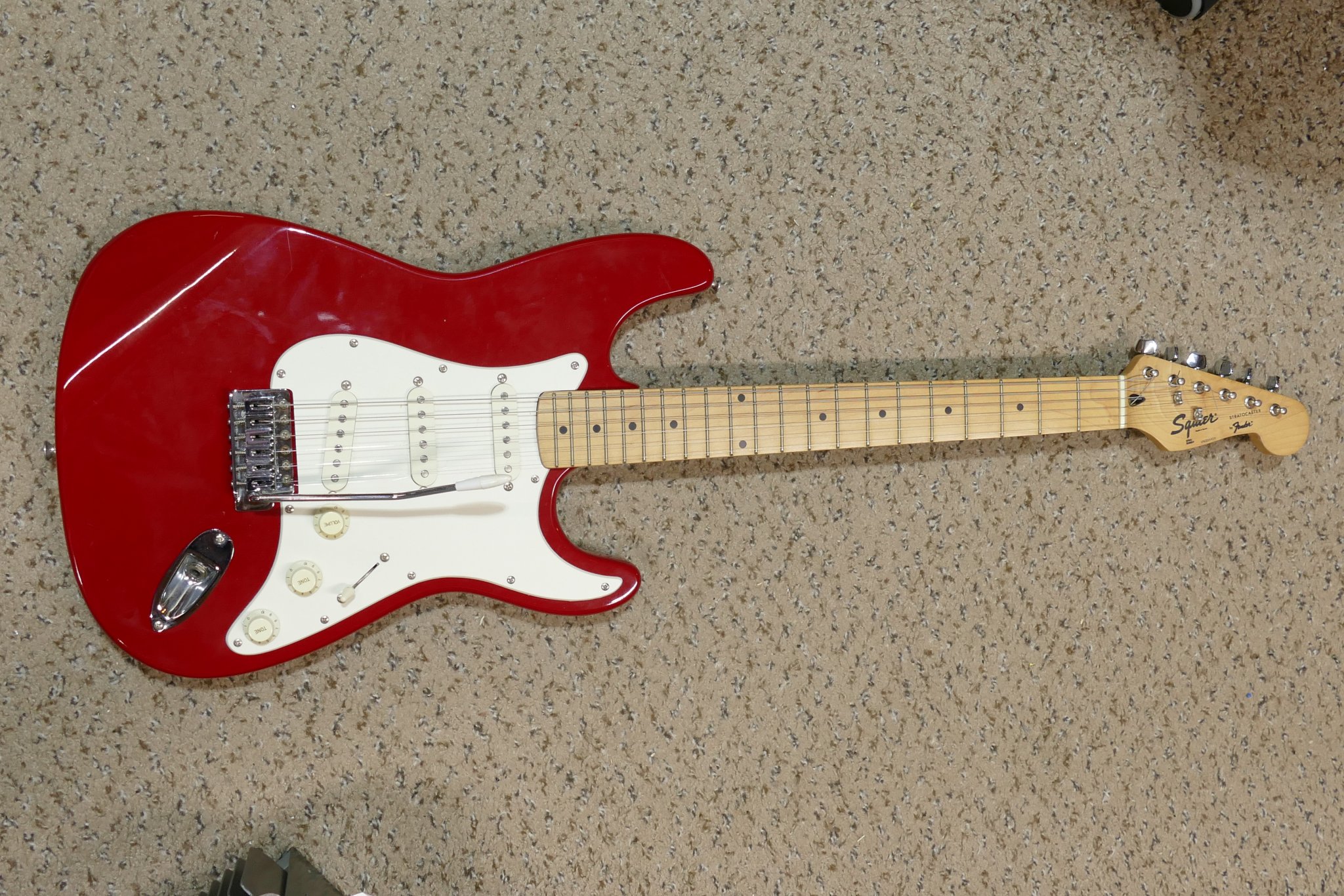

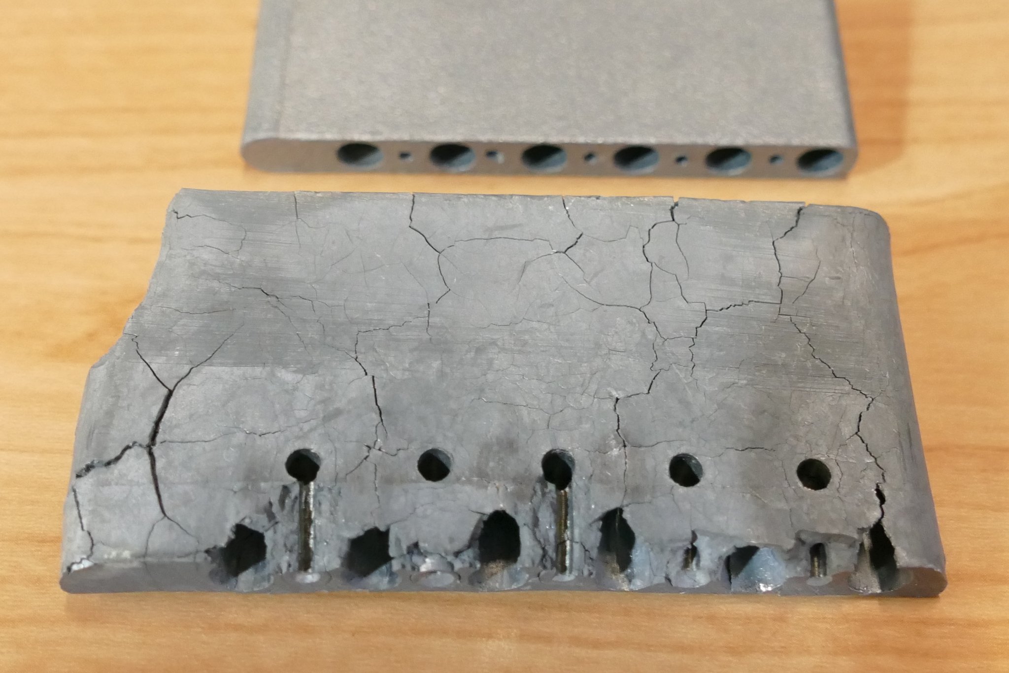

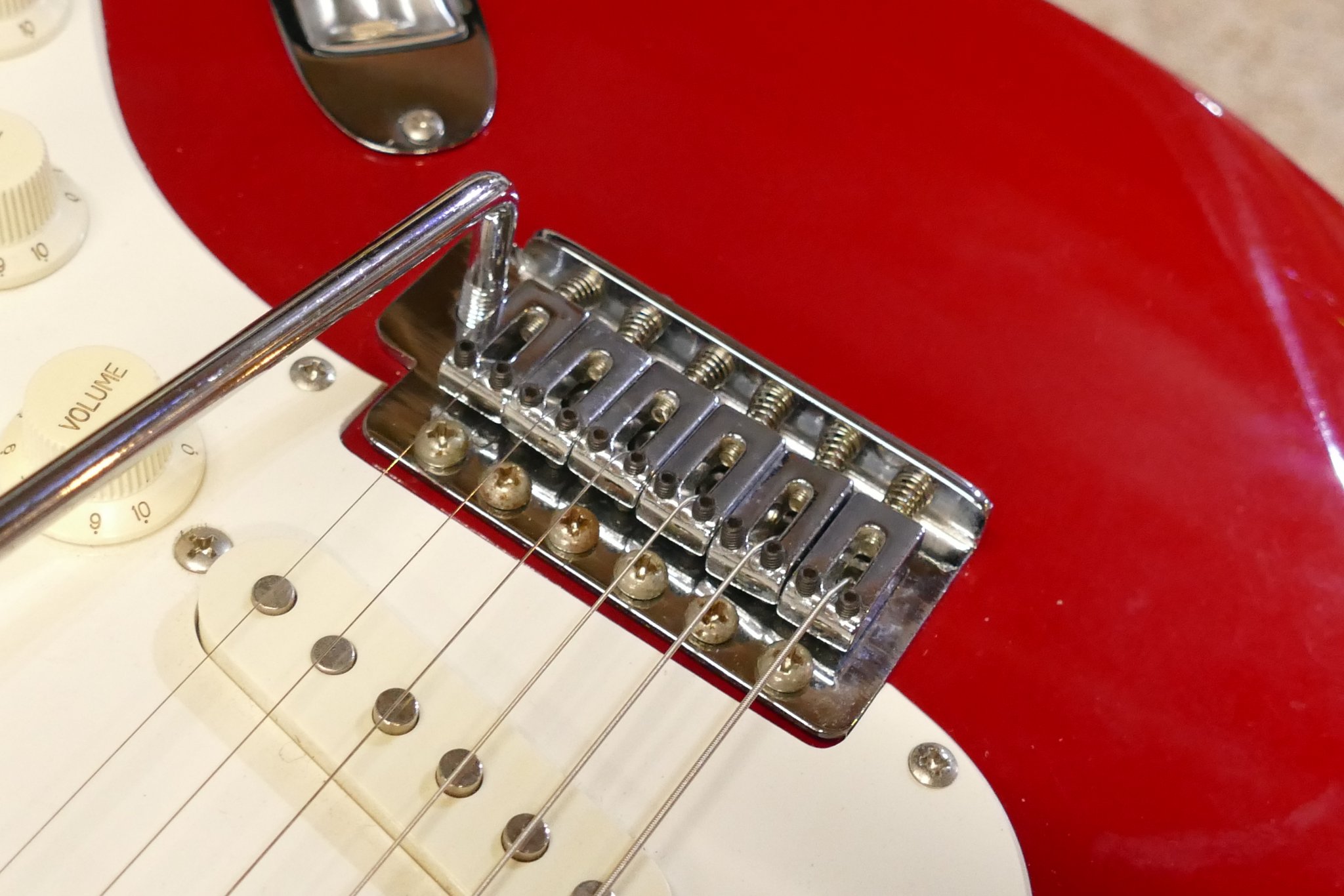

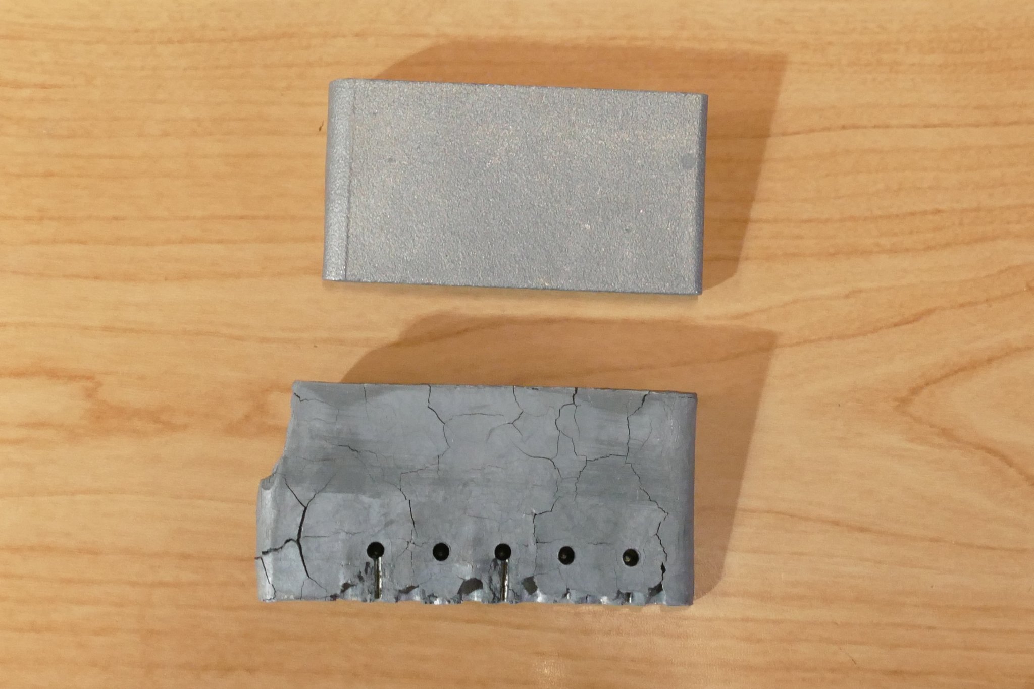

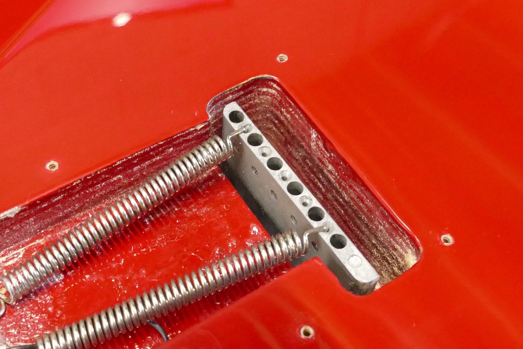

Sometime in the 1980's I wandered into an Ace Music store and left with a Fender Squire Stratocaster for about $130. I know that the guitar was alive and well as late as 2005, as I found dated pictures of me playing it. Sometime after that it broke in a rather rude manner and got parted out. The neck wound up on one of my DIY guitar builds, and some of the other parts got used elsewhere or used to fix other broken guitars. The red and white Strat was forgotten until I was watching a Youtube video last week and saw one just like mine. I thought about it for a while and couldn't remember exactly what happened to it, so I dug through some boxes marked "guitar stuff" that were hastily packed when I had to leave Florida on three weeks notice after living in the same house for 37 years. What was in those boxes? Lots of good stuff and several long forgotten unfinished projects.....and most of the pieces of the red Strat.
I also found the piece that caused the explosive disassembly which resulted in me throwing the guitar across the room in a friend's house, implanting a couple parts in my belly leaving me bloody. This piece is made of cast Manurium. It is screwed to the bridge which is mounted on the front of the guitar. There are six strings pulling the piece in one direction with 90 to 150 pounds of force. There are two to five springs pulling on the other end with an equal amount of force and a vibrato bar screwed into the cast piece to rock it back and forth changing the string tension, and therefore the pitch of the notes being played. You can see that the springs have bent ends that are simply inserted into holes in the casting. The obviously well made casting cracked at the point of insertion and several other places letting the springs fly, which ripped through the plastic cover plate leaving a couple of pieces sticking out of me and the guitar on the floor several feet in front of me.
The casting with all the cracks was the remains of the broken part. A new part is shown next to it. A new bridge, vibrato arm and springs were used in the reassembly process. I still need a new cover plate, but they are cheap. I used light gauge strings so I only needed two springs. From what I found in a large baggie, the guitar had three that were a bit stiffer than what's on there now. After making it all work, I find that the volume pot is mostly dead, and the switch is intermittent. Getting to those requires taking the strings off, so I tuned it and roughly dialed in the intonation, but I won't waste the time on a full setup until I decide if I will actually play this thing.
