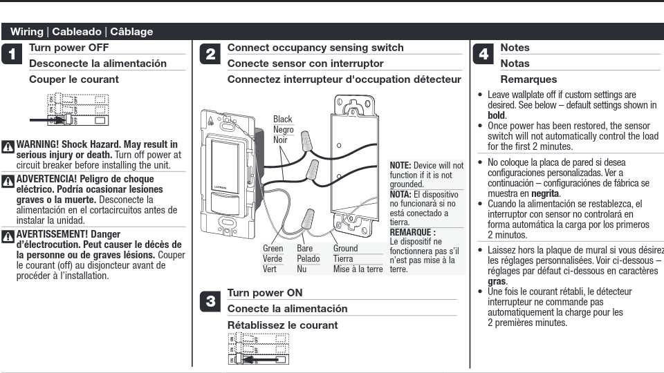

Tell that to Lutron. Any motion sensor with "No Neutral Required" requires ground instead. I use one in my washroom. I connected it to neutral because it was there.The correct fix would be to reroute the timer return wire to the neutral connection. NEVER NEVER NEVER NEVER NEVER use ground as a neutral or "designated conductor."
That's just wrong. You know a neutral wire can deliver a fatal shock if it has a break in it, right? NEVER ground to the neutral wire. It's very dangerous.
I'm not grounding to the neutral... I'm using the device AS IT'S DESIGNED. This device is DESIGNED to run using only hot and ground if there is no neutral, but use neutral if it's available.
Lutron MS-OPS2 if you're interested.

I don''t remember exactly how the circuit is configured, but it seems it might not be a direct connection to the ground pin, and is limited by a resistor or varistor going in. It's still really incorrect. I've never seen that before. I hope I don't see it again. But I do know appliance manufacturers are not constrained by building wiring codes as pertains to internal appliance wiring. Perhaps the current is low enough not to trip a gfi. But that would be 'really' low!You know that's a very dangerous design. It would not be allowed in the US.
It would also trip a GFCI outlet if plugged into it.
I can't fathom what kind of "engineer" would think that's OK. It's very much not OK.
And, in the USA the ground and neutral are tied at the panel. So, I get the basic idea of what was done. It just doesn't seem necessary or judicious. If I can find the manual, I'll scan the schematic. Maybe together we can figure out what the hell is going on!
I am an EE, and I would not connect a neutral to ground. But there are plenty of devices that tie together ground and neutral internally. That can be particularly hazardous when using a variable autotransformer to power such devices, if there is some defect in the building wiring. They tell you to use an isolation transformer just to make sure.

It's a motion sensor light switch. It uses the neutral or ground for the PIR sensor and the relay. Very low current draw, and nobody I know uses GFCI on an entire branch (not in North America, anyway), just the outlets near the sink and outside, so tripping wouldn't be an issue.
The "neutral wire" comes with a green sleeve over it that you remove if you can find a neutral instead of ground.
Yes, really low. Since a timer runs off it, I don't think it can be that low.
