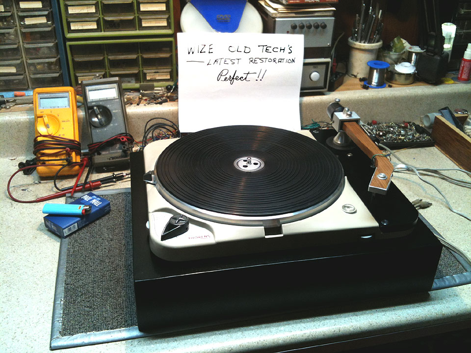

Just finished up another restoration for my neighbor.
Not a car, but built like a TANK.
Bushings, lube, seals, rebuilt motor, alignment..
Thorens TD124/Grado arm-cart.

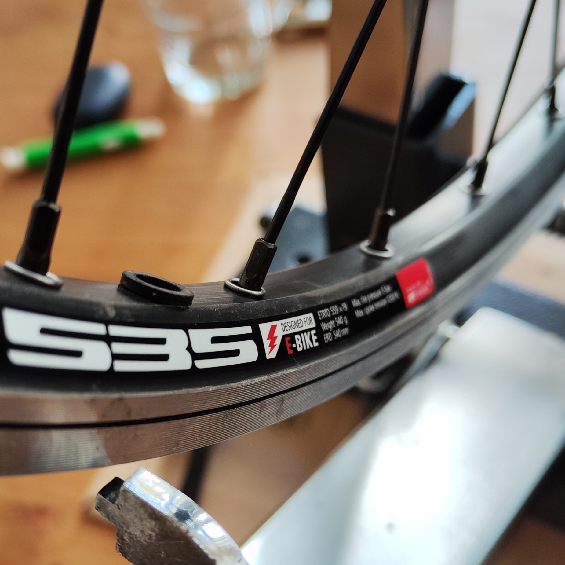

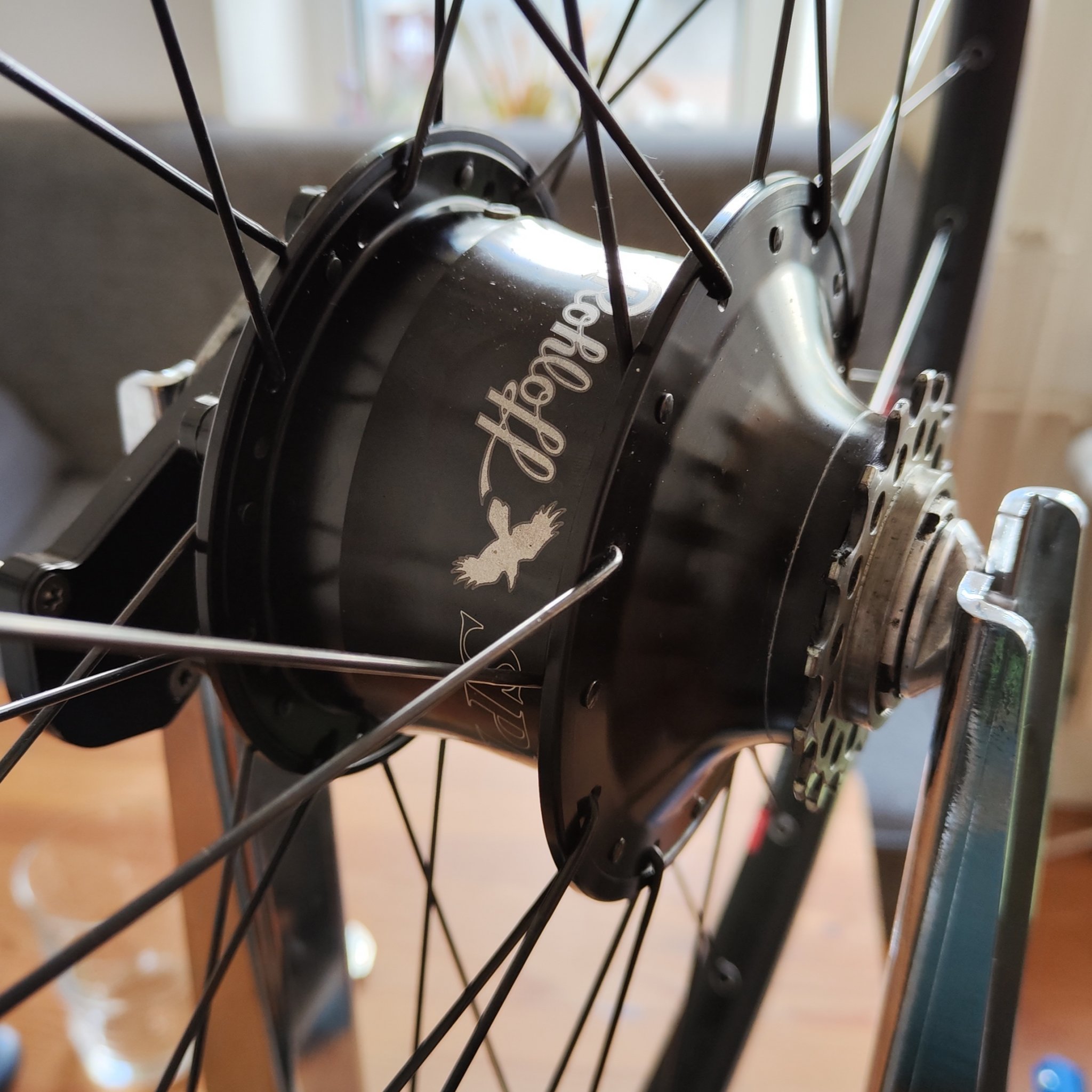

I just laced new wheels for one of my bikes. I have used the old rims and spokes for more then ten years. The old rim was worn out, still using rim brakes for easier maintenance.
