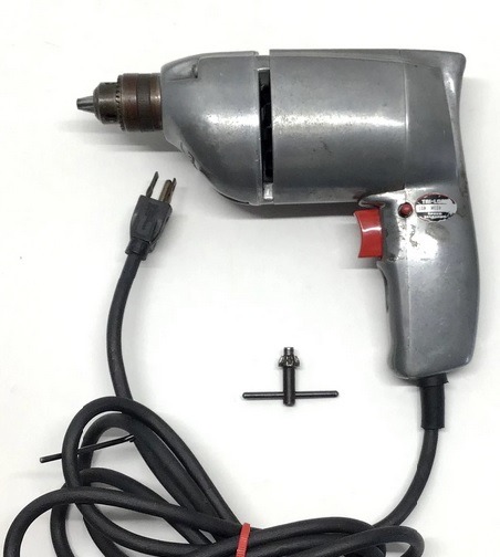

Impact drill, UK made Black and Decker from 1998.
Cooling fan on the replacement armature disintegrated, found the original fan, (I am a pack rat), and while putting it in place, broke the lug from switch to field coil, I had to remove the wires so that I could work on the armature.
That earned me an hour's walk in the market, and the advice from an aged repairman to just solder a piece of wire to the tip of the broken lug, and connect it to the wire from the switch, which I did.
New lugs not available.
Working nicely now, greased the gearbox with front axle grease as well.
But now I will keep it as a second machine, bought another with more features.
The trigger switch says 'Arrow England Jul 96'.
The internal wires have gone stiff, and most parts are not sold any more. The mains cord is still as new, not gone stiff with age as in most cases.
